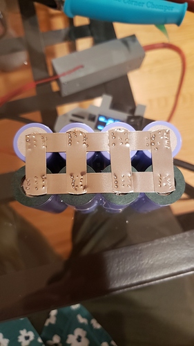

What do yall think about this for series connections between 2 groups? Will use larger copper braid for the rest of the pack, 10s4p 40t
Why the effort to use both copper and nickel? Either should have enough ampacity to carry 30A for 20mm
Just want to be on the safe side, this is a pack for a customer lol
Plus really the effort is minimal and it gives me peace of mind

Call me dumb, but i’m with @Skyart on this one… Peace of mind. I used 8 AWG solid copper grounding wire just for the parallel connections on my pack, then bridged with 2x 10AWG silicone wire… contemplated 3 but it was too much work and too much bulk :expressionless:
I just love the idea of getting some copper in there… makes the feels feel good.
Dude right? After 10 years of being an electrician and only ever using copper, it just feels right :innocent:
If I had enough wire on hand I would double everything up just for the heck of it…
(not an electrician, but…)
I was messing around in some calculators and found that there is a not-insignificant amount of voltage sag at high amps just from wiring resistance.

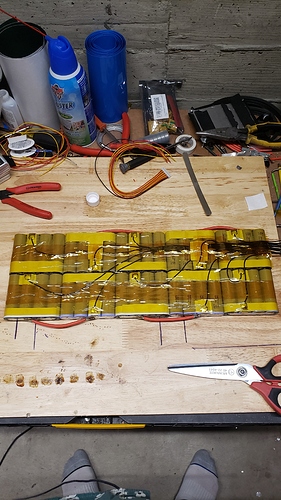

Getting close to finishing!
No chance the balance wire can rub here?
Possible but maybe this is better
Ah yeah, looks better. The balance wires that cross the centre have no chance of rubbing of the nickel either does it?
No, very unlikely I think alot of other things will go wrong before that does
