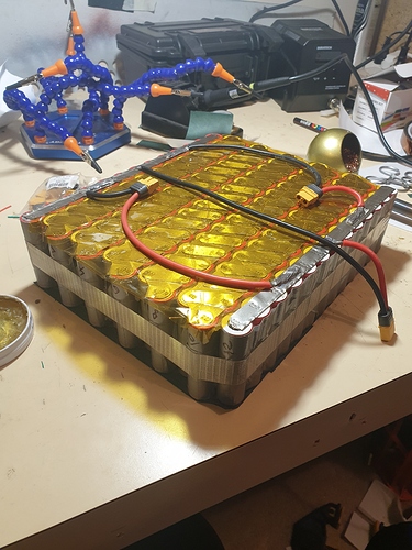

Damn bro, that’s some neat work :ok_hand:
Just balance wires left to go on this sucker. And a bit more tape and shit.
Is that duct tape that I spy?
You got the colors right :scream:
Its cloth tape. The whole pack is fully siliconed together, i didn’t see the need to waste fish paper in this application.
I’ve been off the beers for about a week, helps with my color coordination :sweat_smile:
What size of nickel am I looking at here? Im just getting into spot welding and Im trying to figure out what to buy.
Most of it is 12 x 0.15 with a little bit of 25 x 0.15
I would recommend just getting the 25mm stuff

Thought I’d ask here but can anyone see anything blatantly dangerous or wrong with my pack?
How important is it to shrink wrap? I’m fairly tight on space lol
Haven’t finalized a connector design just yet. Think of going XT60 on both sided to make them modular although the BMS connects everything together so that might be pointless.

Won’t intentionally weld over solder. I know it’s not a great thing.

What kind of enclosure is that pack going into? 12s10p! That’s maaaaaaaaasive!!!
very on brand for @Arzamenable
That’s literally 1728 Wh…what the fuck thats double the battery that can take me across the whole length of my fuckin state
