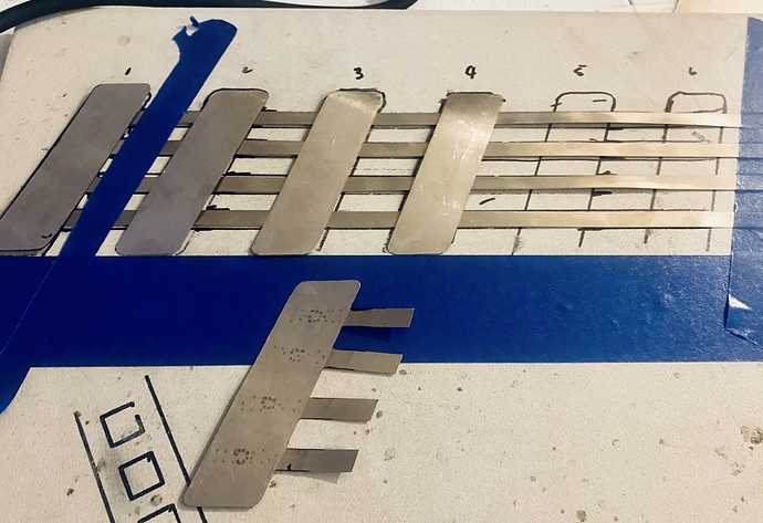

More nickel tricks.
My nickel rail road to do this:
Was nickel plated steel. :confused:
So I made my own, used nickel plated copper.
Except that stuff is hard to weld, I failed to get any weld at all when I first played with it.
Trick is to put most resistive material on top, spot weld over it on to less resistive material. Saw this on a endlesssphere from the bike guys.
Now make many.
(Last pic was a tester. Looks like I took a shotgun to it. :joy:)
Also, stay on target. If you miss the bottom layer, you will blow straight through.
@BluPenguin, the KWeld calculates the resistance and applies appropriate power, preventing this, correct?
Ah no, it calculates energy instead of timing, but if the energy is set too high for the weld it’ll still blow through. It dumps X amount of Joules regardless of what the probe is touching. It only stops if the resistance is too high and it cannot pass the set amount of Joules within a set amount of time…
Came across endless sphere during my hunt for info as well. Copper sandwich welded like a dream

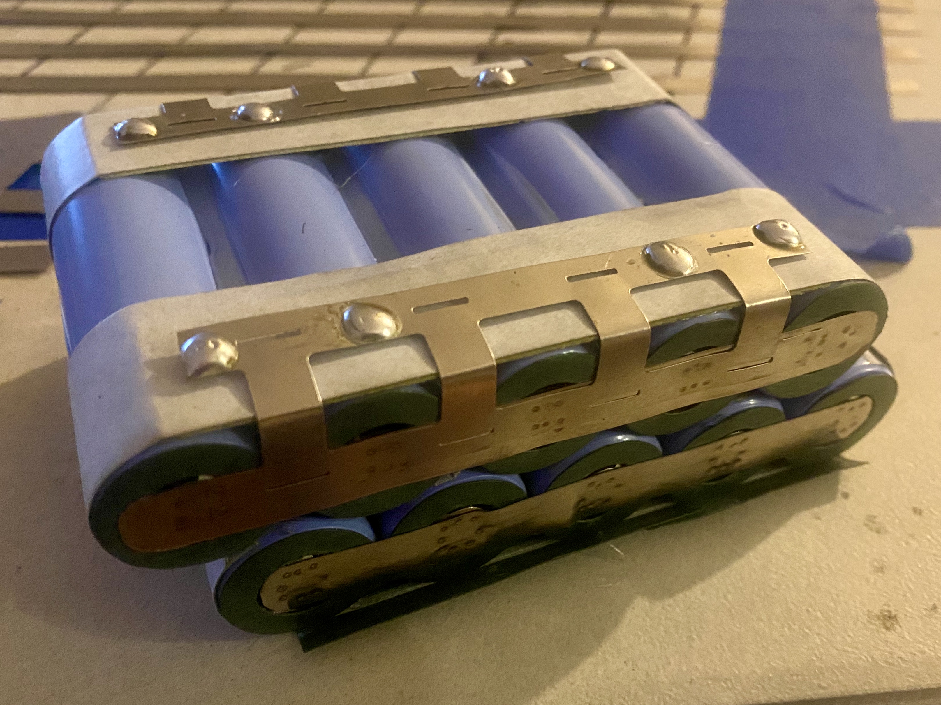

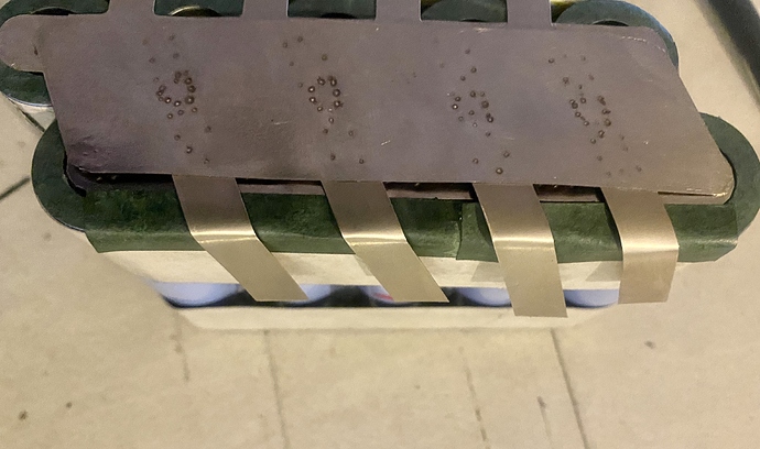

This will end up being 2, 6s packs, 40ah (12s10p, Sammy 40t) will charge with balance chargers. Plan to terminate leads with AS150s, 6s balance lead close to middle, trying to minimize long balance wires.
I only have 1 dead lipo bc connection/user error (crashes don’t count :grimacing:). My library of shitty BMS and packs they (we) killed is extensive.
Could charge each 6s at 15a right now. Only have 1000w total for chargers at 24v.
Will go in a kick tail carbon Gt gen 1 with a CF spacer. Hope to run dual focbox ogs, neobox6’s, and then stormcores back to back.
