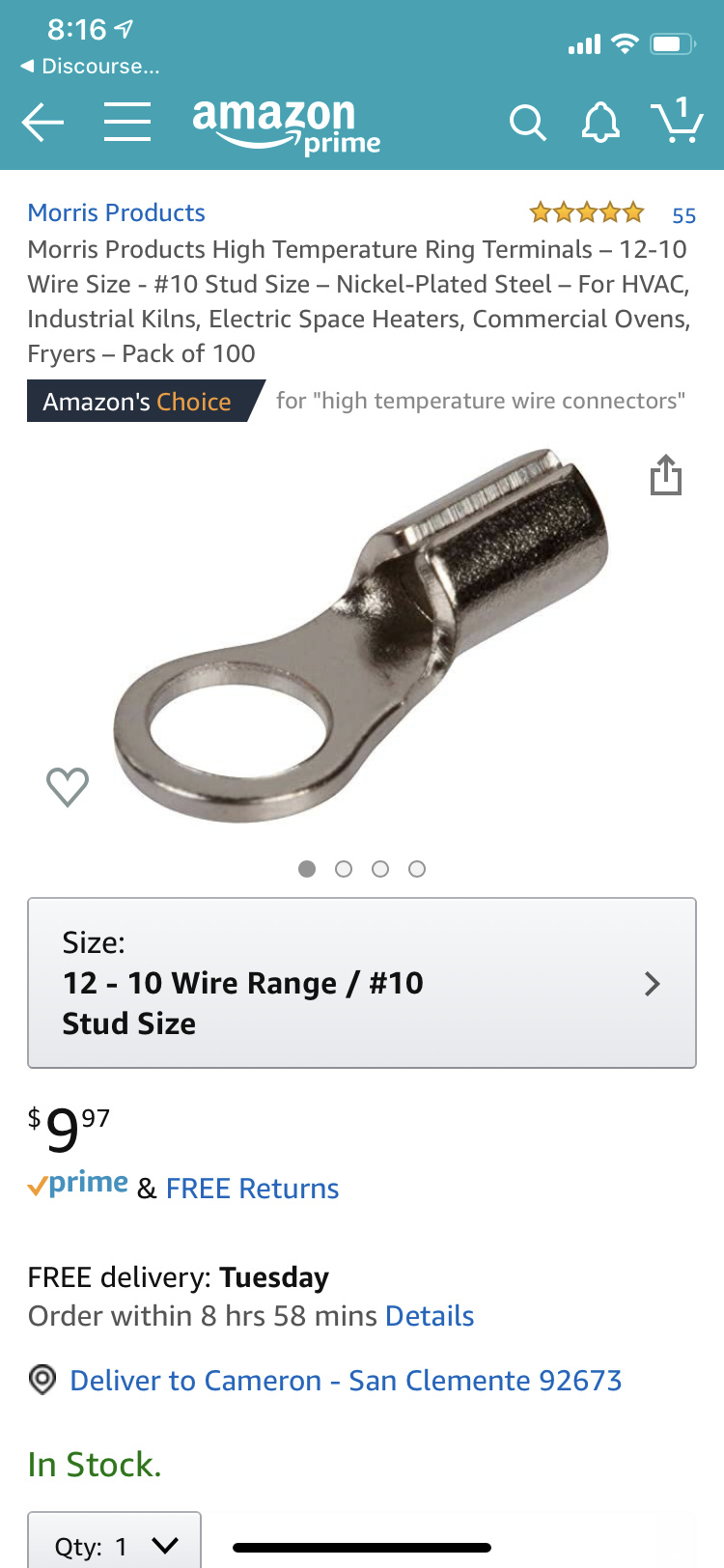

What current are you running through them? I think that’s what I’m worried about. The ones I’ve found state 45A but doesn’t say at what voltage. There isn’t a power rating either. I might just take the chance and try it out.
Battery is 10s4p 30q. I don’t pull anything crazy, I mainly just cruise. Usually not more than 50A on metr.
I couldn’t find a current ratings on these, but they are rated for temps up to 900F, and speced for Kilns, heaters etc.
Hopefully someone smarter here knows.
