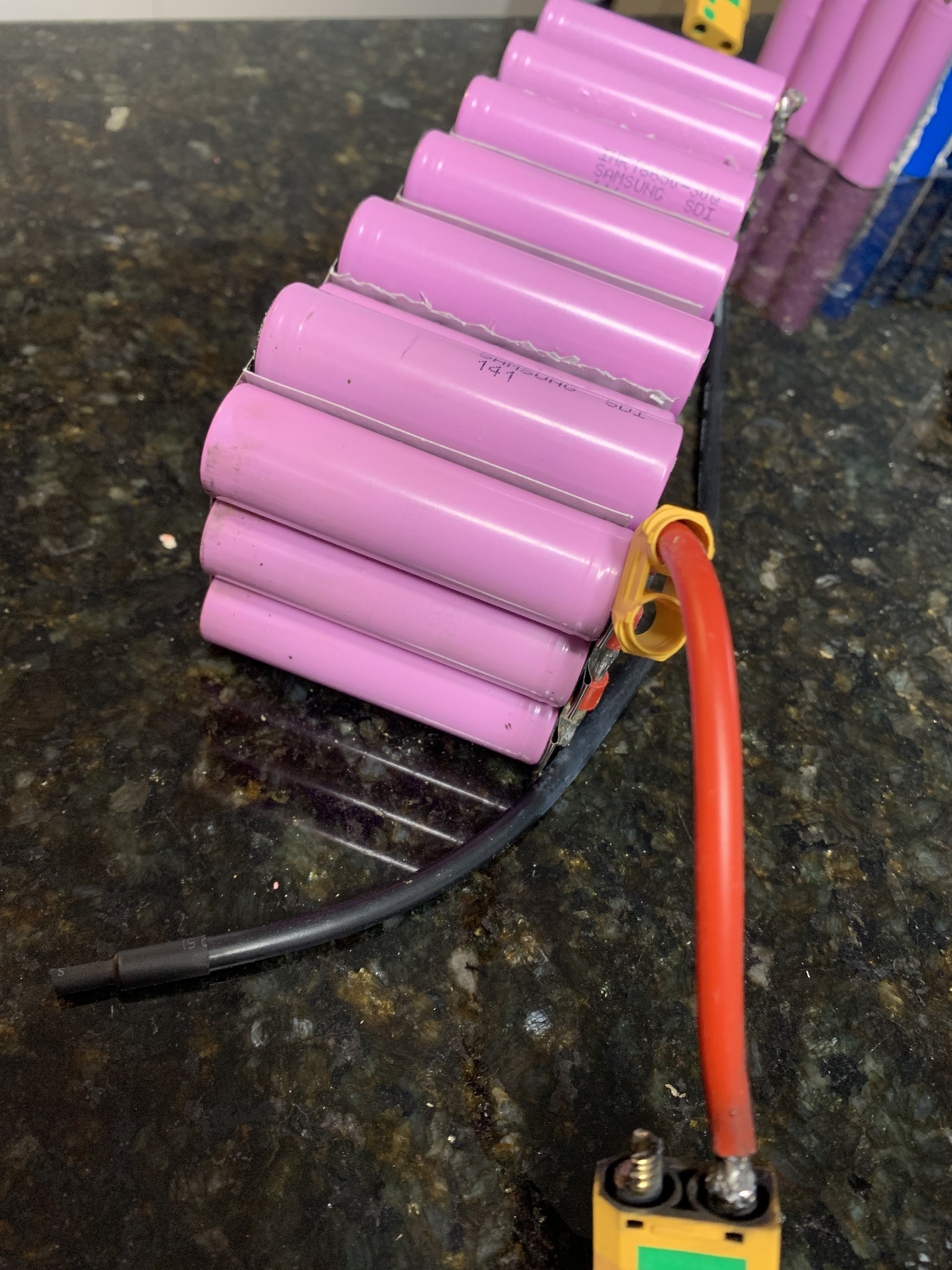

So my 12s3p shorted out…chance of salvaging it?
Cells are still cold, voltage is still 41.4V
There was 0.25" of wire in the negative end I was soldering and I got solder splashed on my hand and dropped the lead…and then it poofed. Big spark, a bunch of soot, be the tinned but if wire is just gone, kinda melted into the other end of the connector
After wiping the soot down
I’d personally check each P groups voltage, but I’m sure it’s still fine. Did you not isolate and only solder one lead at a time? Like, solder one lead then tape it to make sure it doesn’t short? this looks nasty, glad you’re okay.
Edit: those cells on the end look burned… scary… now that I see that I don’t know how I’d feel using at least that P group.
Usually I wrap with shrink wrap but I forgot to do this one
I’ll check the voltages, one minute
Do you have fish paper between each P group?
Yes all parallel groups are isolated with fish paper, it’s siliconed between them so it holds as a giant block
All cells are 3.45V exactly
Nice. :+1:
I won’t be the one to say use this pack after that… I’ll let someone with more experience chime in at some point.
It’s just soot, I gave it a light rub with a paper towel, clean as new
Okay so I put a new connector on and used shrink wrap this time…no evidence of it being damaged at all. It’s only gonna realistically be drawing 5A per cell and all the welds show no sign of damage from the high current spike.
This board will have a 100A fuse on it, packs will be rates for 105A when in parallel
Im not worried about capacity, just about if any of the cells will poof under light use
Nah I wouldn’t worry. But ask @glyphiks, he likes to short batteries :grin:
I really hope so, I can’t afford a fire, or new cells :sweat_smile:
