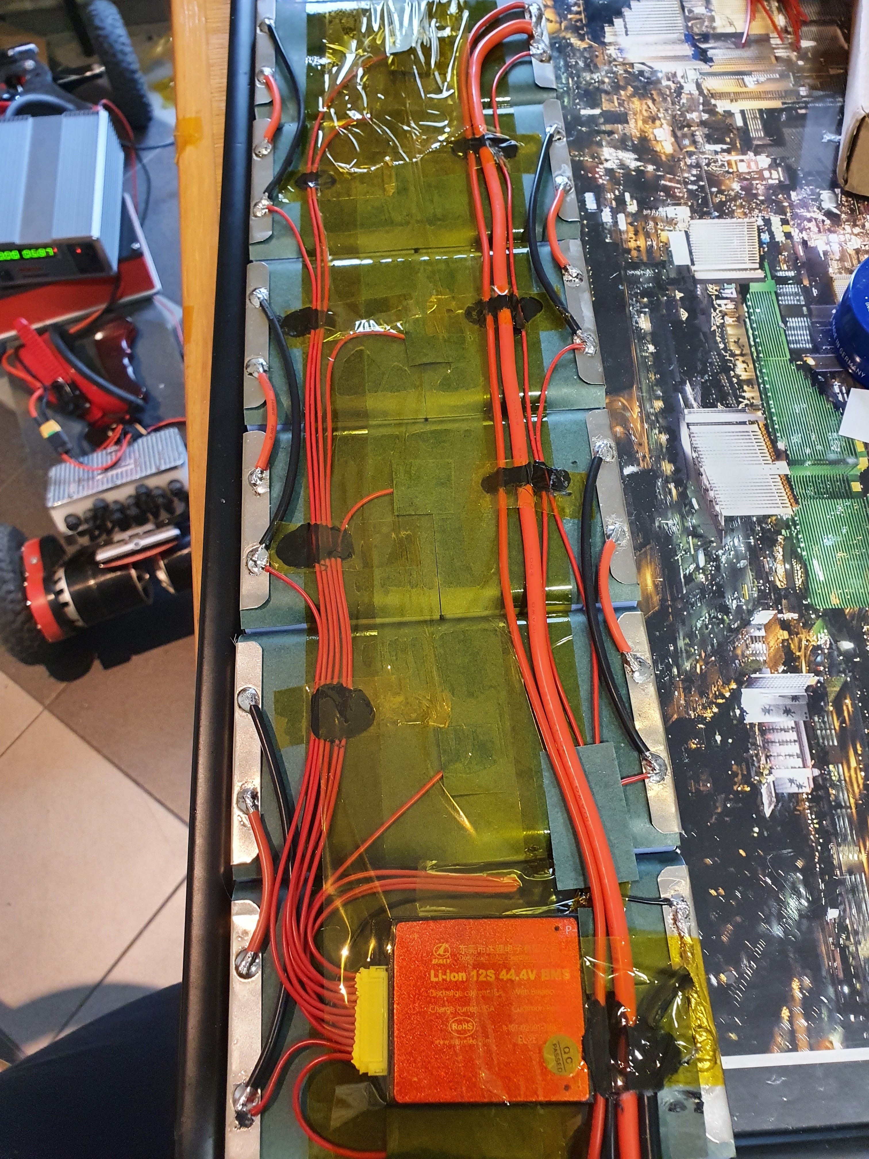

Wait a minute. Doesn’t the BMS go between the Charge/load(-) and the Batt(-)?
Also might be best to wait for the BMS. It’s @Halbj613 (no offense)
This right here :point_up_2::+1:

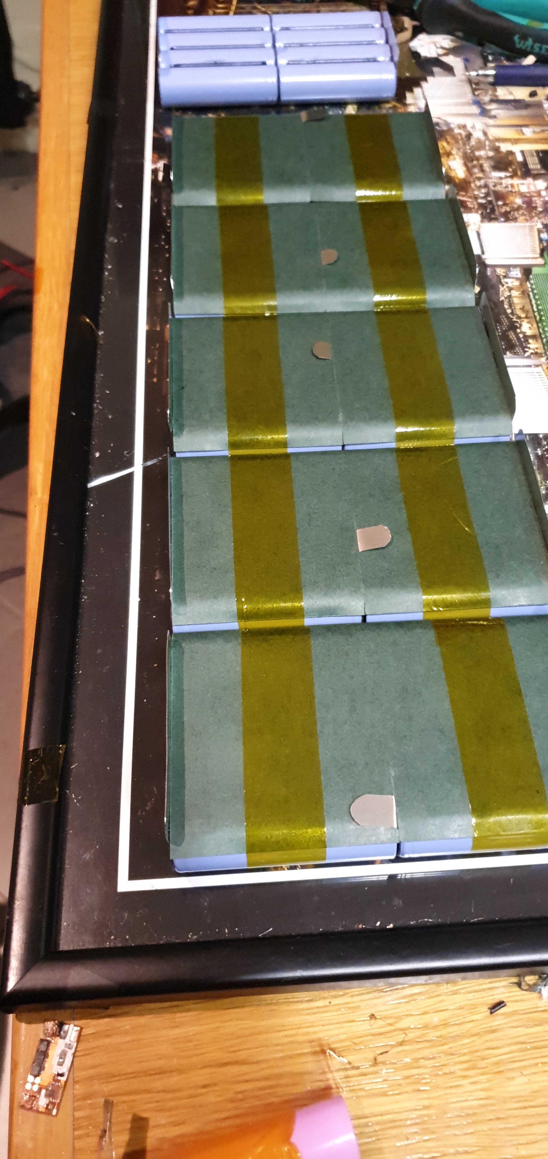

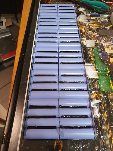

12s4p 40T for @PixelatedPolyeurthan

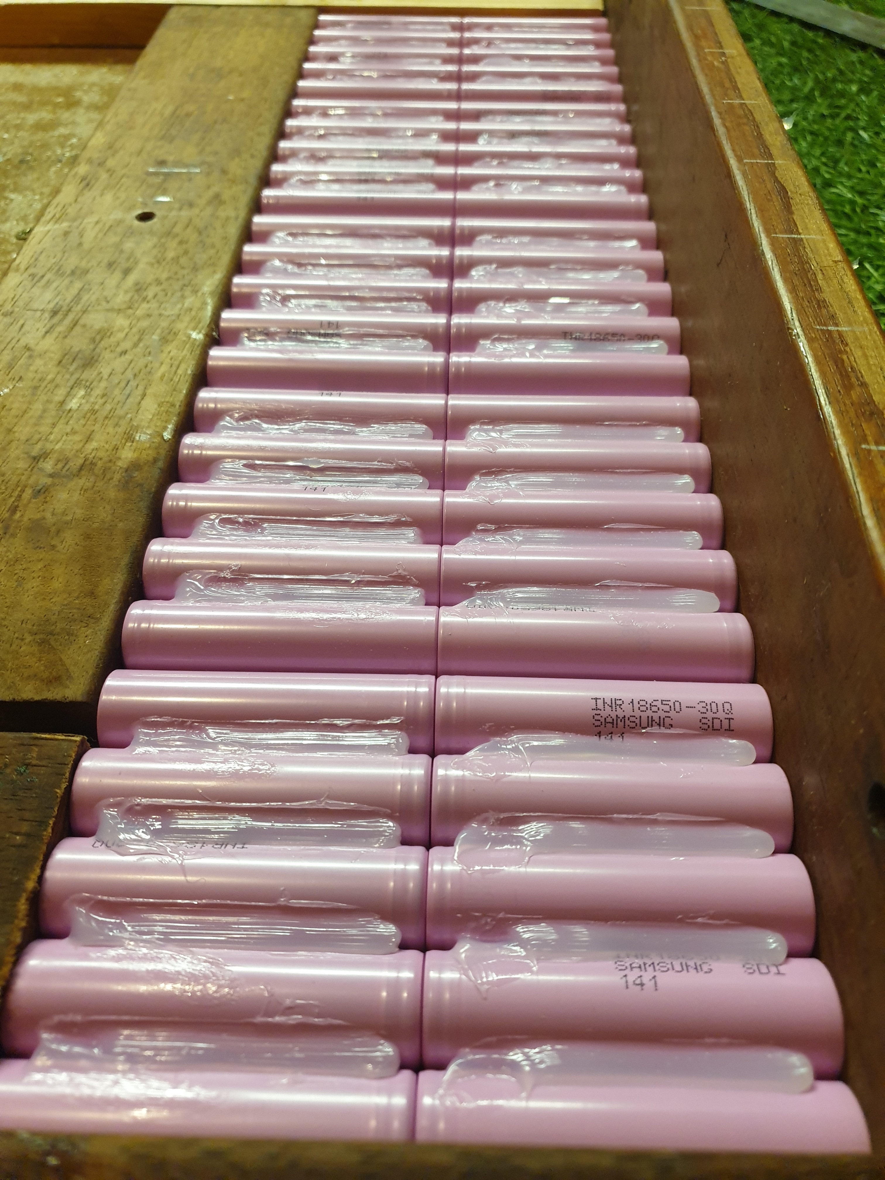

I like to use hot glue and kapton to press it while it’s still hot to secure balance wires in place.

Such a good trick! I do the same thing!

Im looking for some new stuff to hold my cells while welding and something to hold them while glueing as well
What do you guys use?

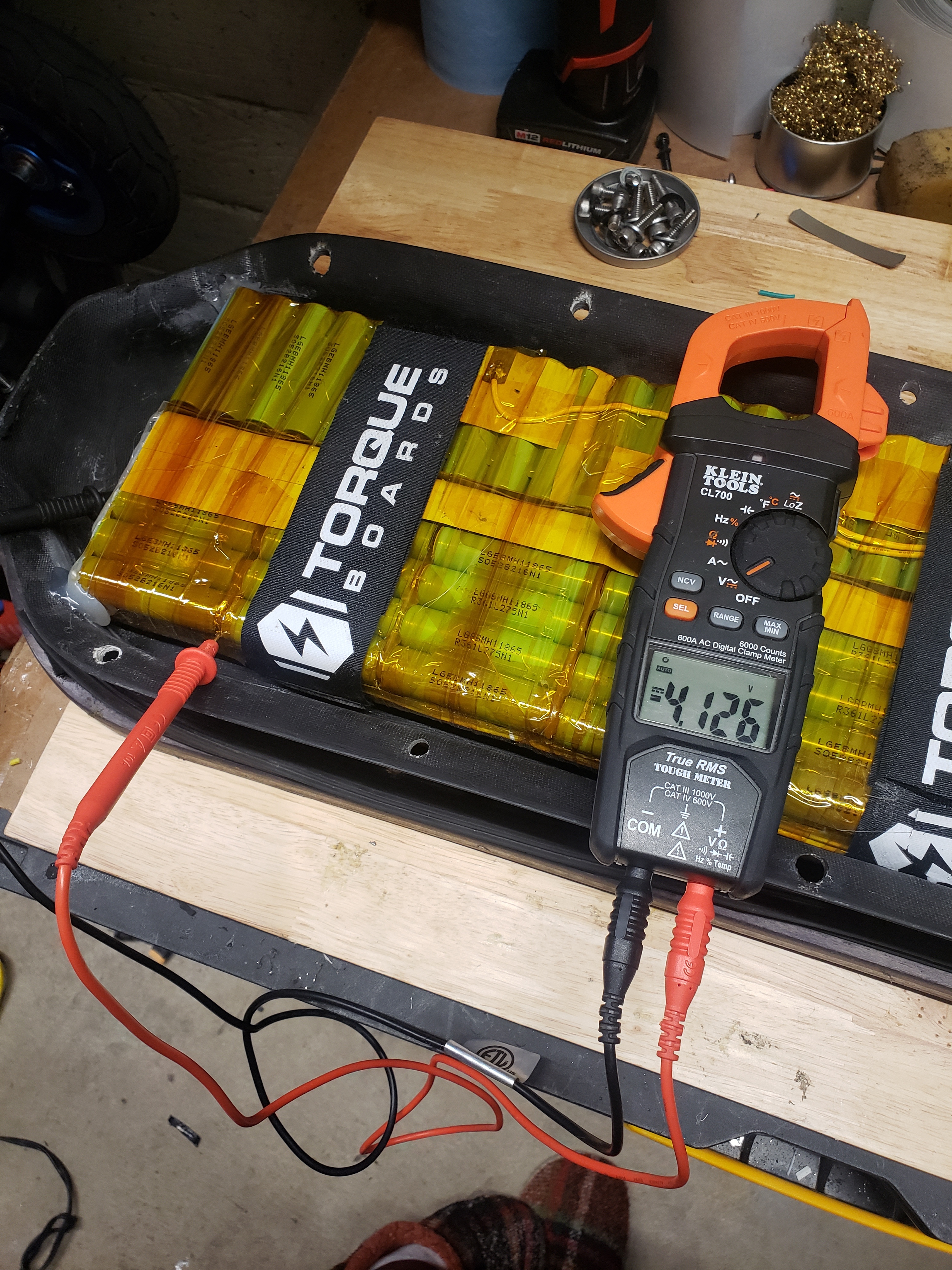

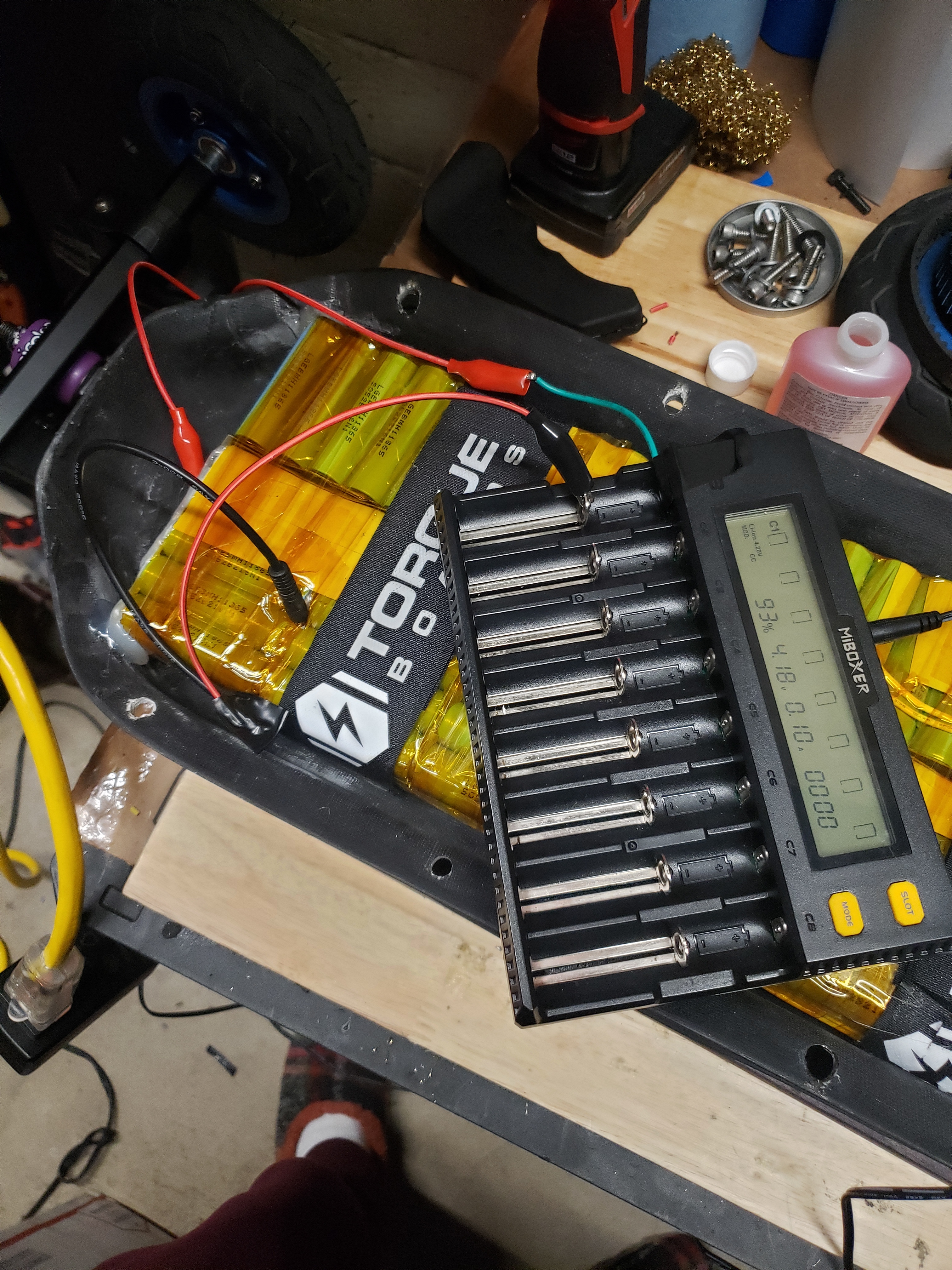

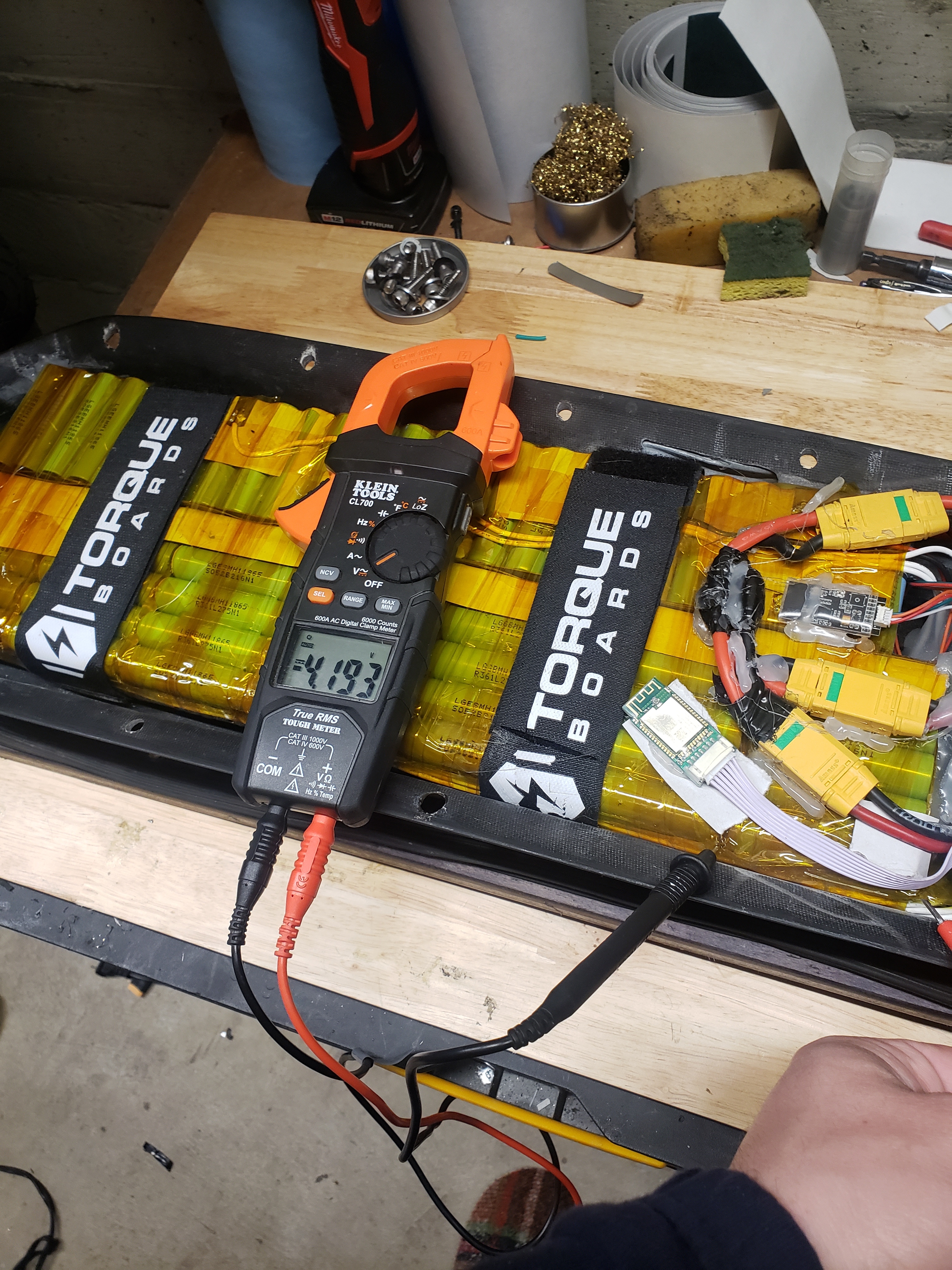

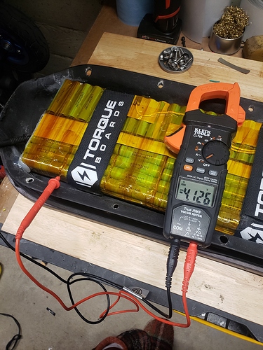

Noticing some variations in the voltages on my p groups, this is the worst one 4.12…any way that I can charge just this p group? Without disassembling the pack lol
I lay them on a bit of chipboard with two permanent side walls to form a corner and screw in timber to hold the batteries tight together while i glue
Use the probes with very low amps?
sure, just apply 4.2v at that cell, and monitor carefully. you can even do this through the balance port
You can unplug the bms connector, and pull out the 2 leads that make negative and positive for that p group and charge using those
Awesome! Thanks for the help guys! Basicly I have lion charger that fits 18650-26650, and I was going to extend some leads from the terminals on it to that p groups possitive and negative.

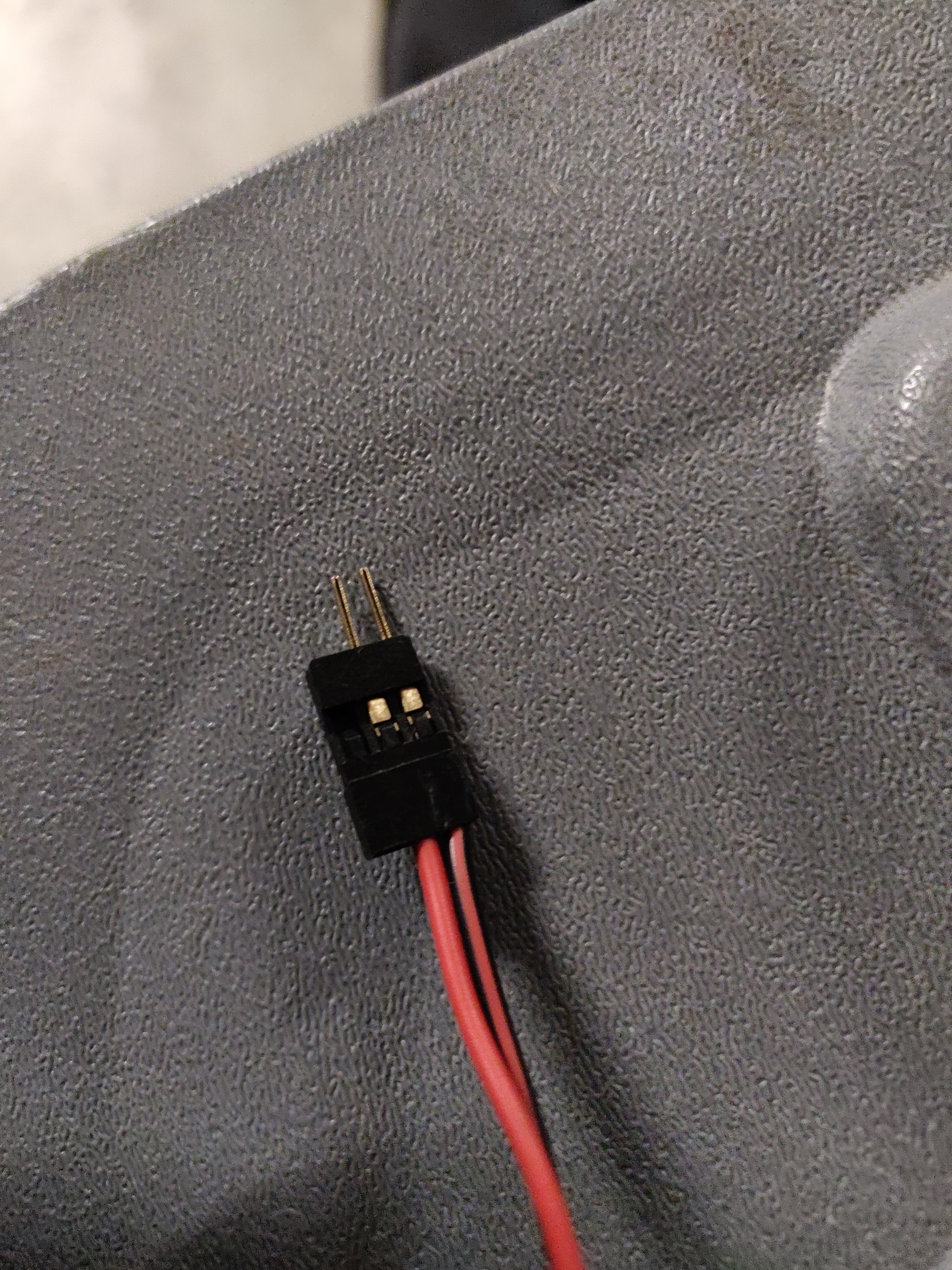

I use this connector to charge a pgroup using my icharger duo.
This seems to be working
