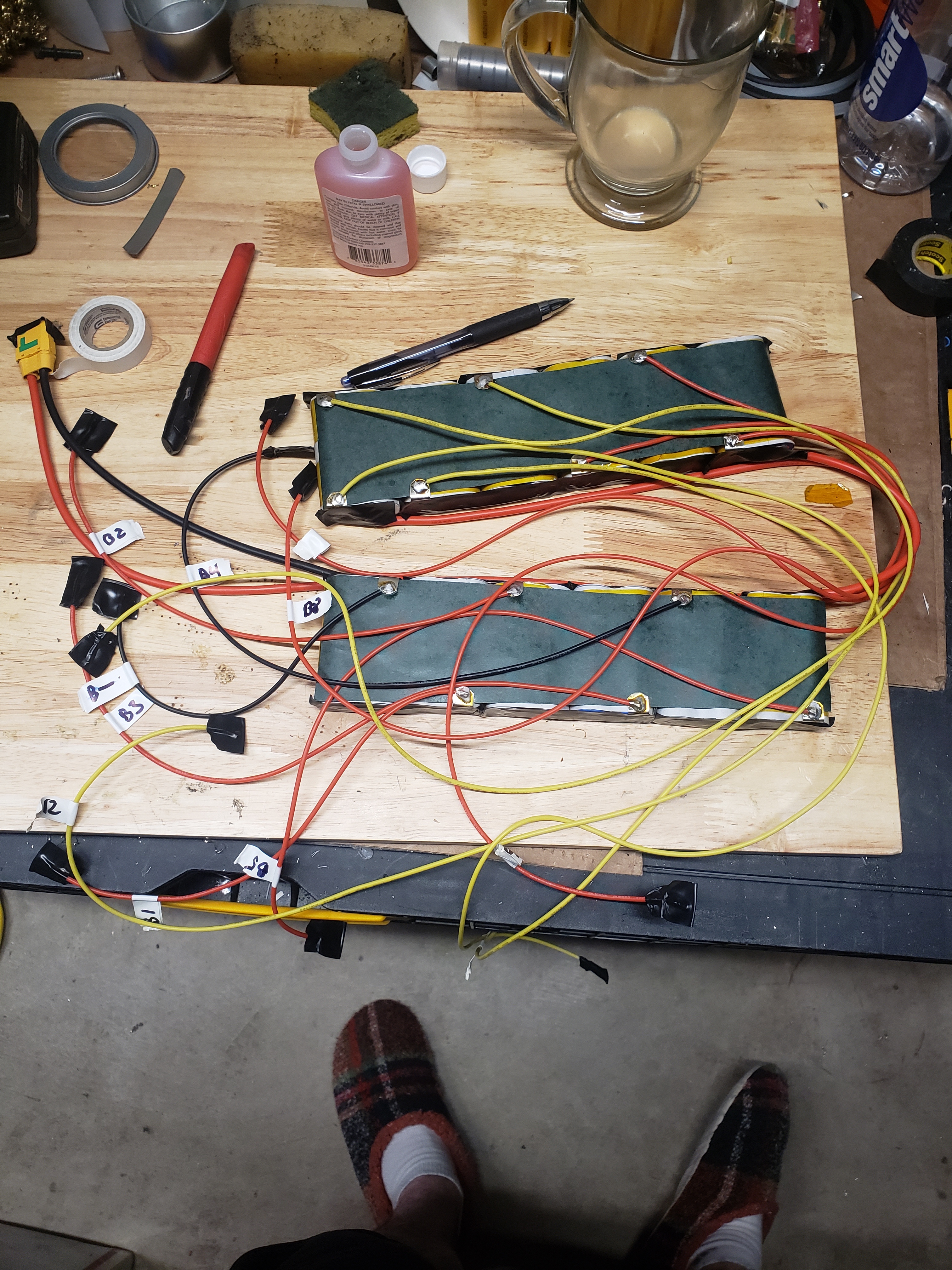

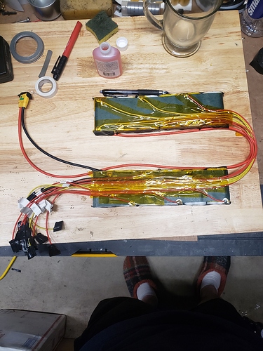

Time for some balance leads and shirkwrap and that will be it fills!

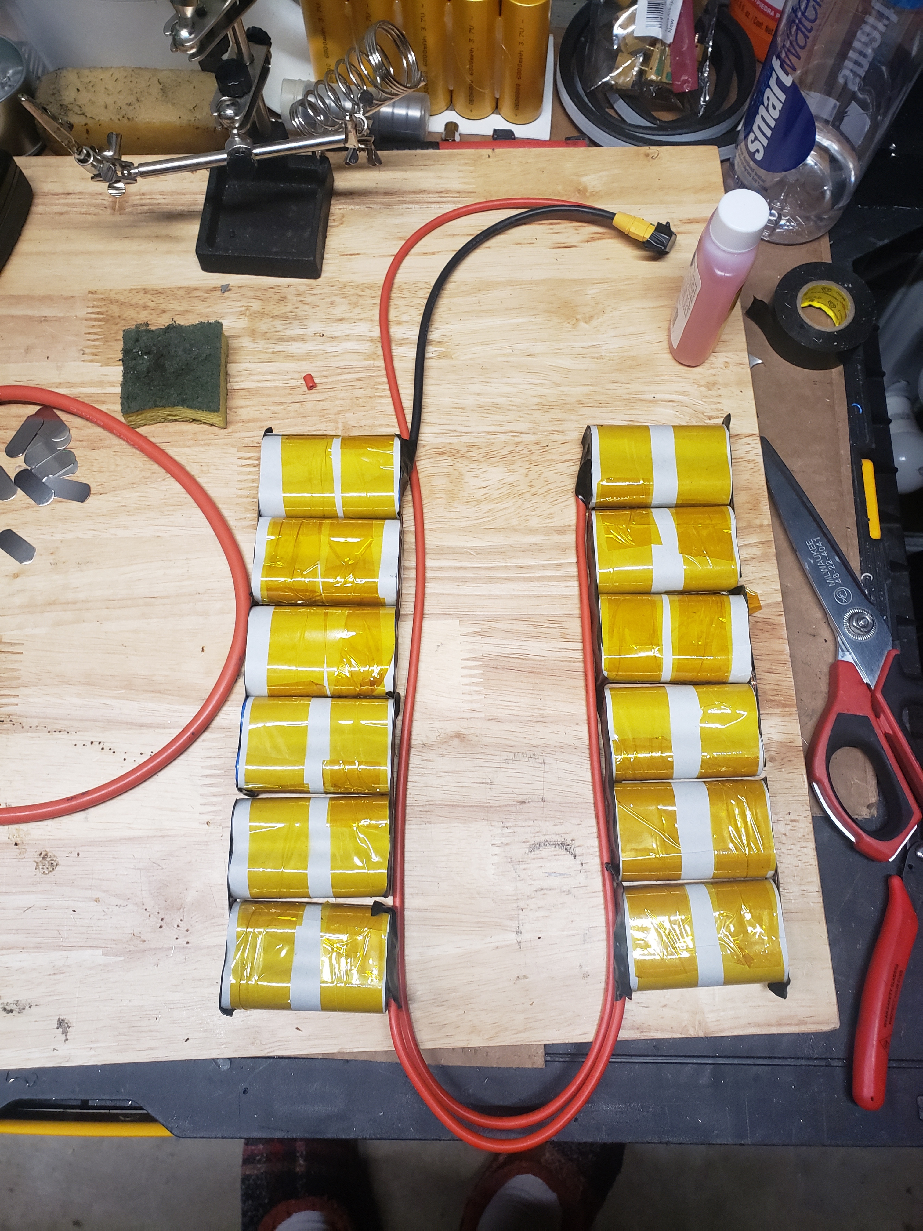

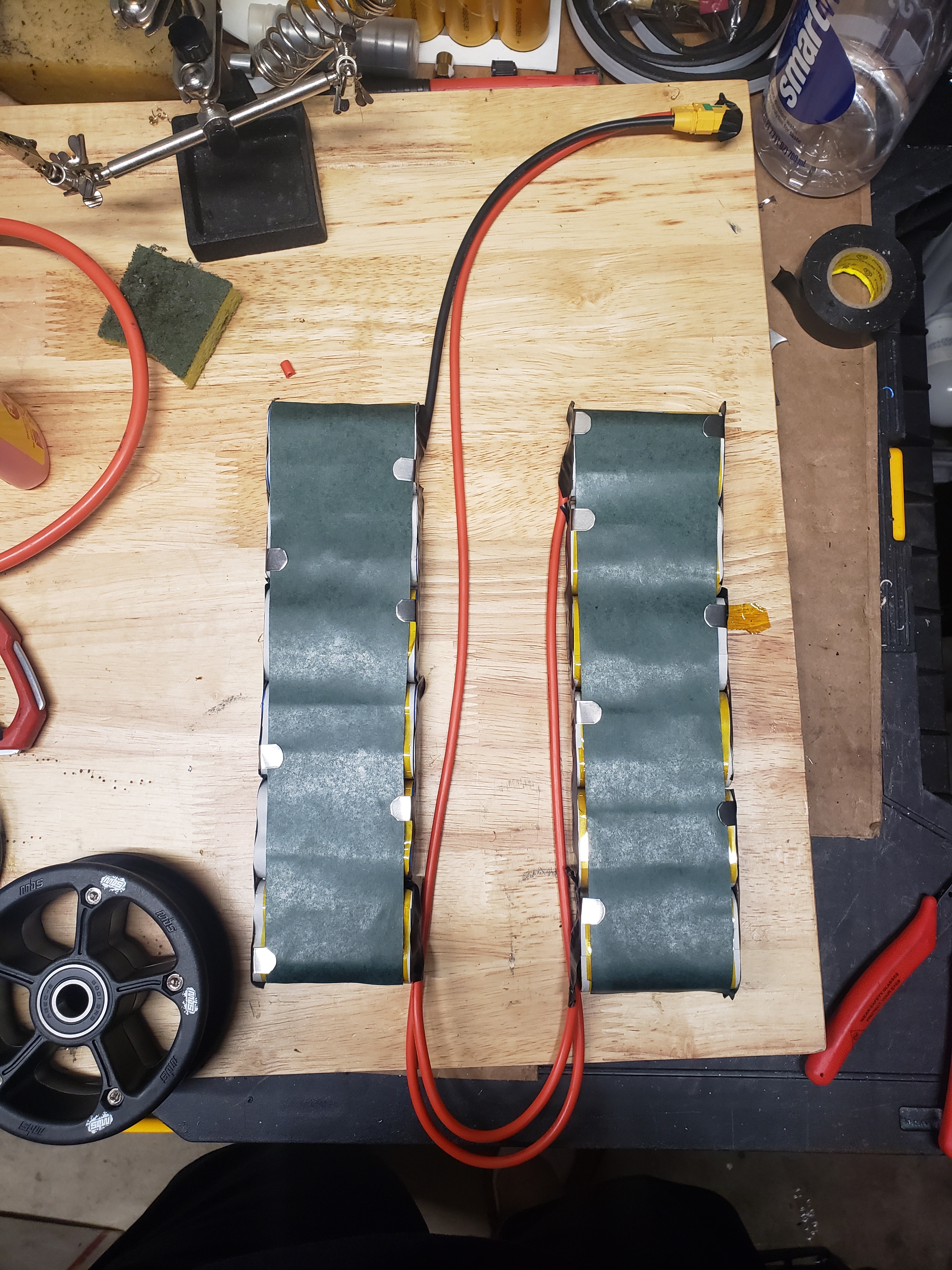

Pack will be in a U shape that way it will be easier to manage wires in the integrated deck that it is going into
Also will insulate that main battery possible lead from all thos battery terminals using some fiberglass insulation @Halbj613
Dude what gauge are those balance wires? :flushed: that’s hardcore :rofl:
Lol 18šŸ˜… all I had

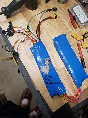

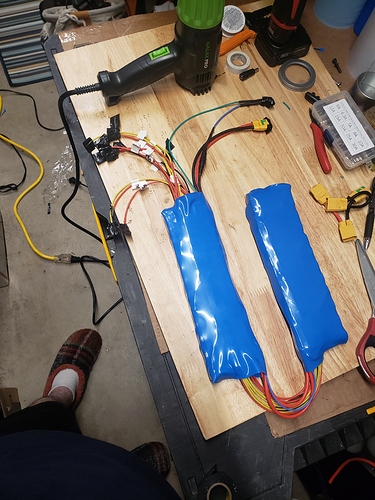

Alright! She is done!
12s2p hg6 cells
60amp max
Fused charge port
And bms by @Halbj613
Oof that means I gotta make my 10s3p :sweat_smile:
Those balance wires have more total current capacity than the whole pack :joy::joy:
Yes, and even then I would not recommend maxing these cells like that. Realistically this is a 30-40amp battery I would say 30 continues to be on the safe side
