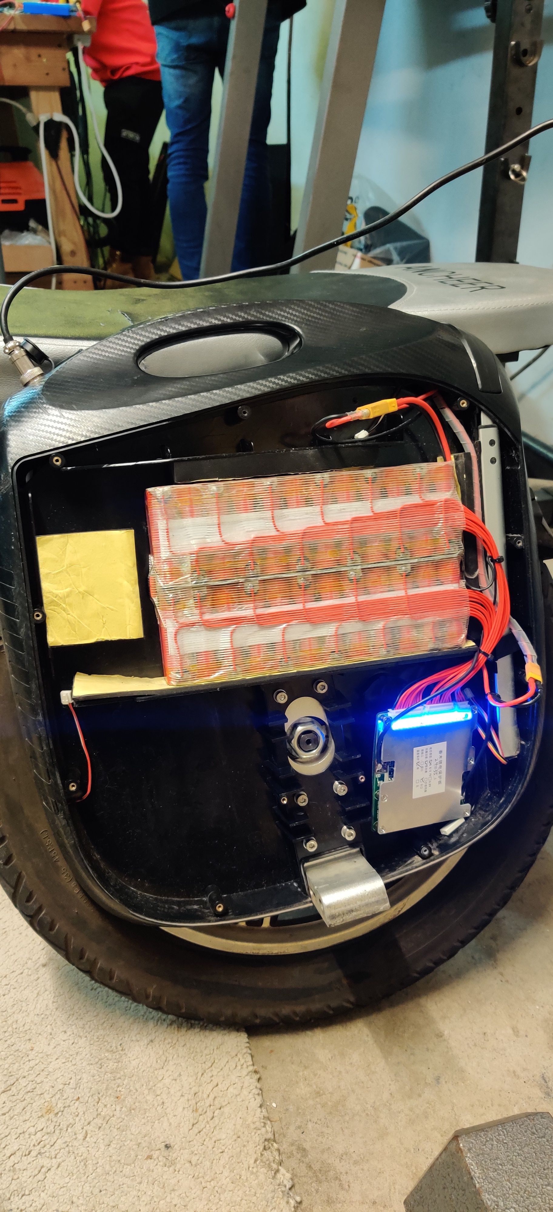

I’ve just avoided the nickel folding problem completely by not folding nickel on my back, but I wanna try nickel folding on my next pack as it’s the most efficient way to layout the cells.
I used 14awg wire in place of where the nickel fold was supposed to be at the end
I don’t really see a way of making a uni pack flexible :sweat_smile:
I think given that it’s a more monolithic blocky pack not strapped to a bendy piece of wood with a person bouncing on the other side, you should be fine. Just make sure the pack can’t bend or flex under its own weight or vibration, even a little.
Also be aware that the series connections carry all the current, whereas intra-P-group parallel connections don’t. Copper is a much, much better conductor than nickel, and I much prefer it for series connections for that reason.
Its been around 600 miles so Im preety confident in the pack, it’s survived riding jumping down stairs and stuff

Did you build a new pack for better range by fitting more cells? Or just replacing with higher quality ones?
New pack, cause the factory one went :fire::firecracker: due to a accident
*Edit and while I was at it replacing the burnt pack I also added another pack for extra range.

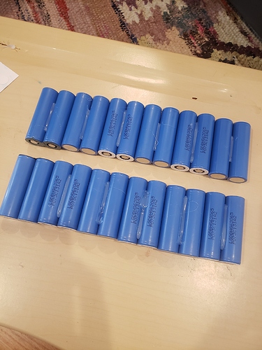

12s2p HG6 60amp battery first official battery commission :sweat_smile: @Halbj613 starting to work on the p groups!
I want to confiscate your glue gun. Lol.
@Skyart
I use this:
https://www.amazon.com/dp/B0000CBJ7W/ref=cm_sw_r_other_apa_i_dWLFEb84G0CG8
Orderless. You just have to wait a few hours for it to cure. Hot glue makes the pack too stiff
You want the pack stiff on the nickel’d P groups though. The nickel doesn’t bend so you don’t want the P group cells to flex either. Otherwise it’s just the nickel holding it straight…
