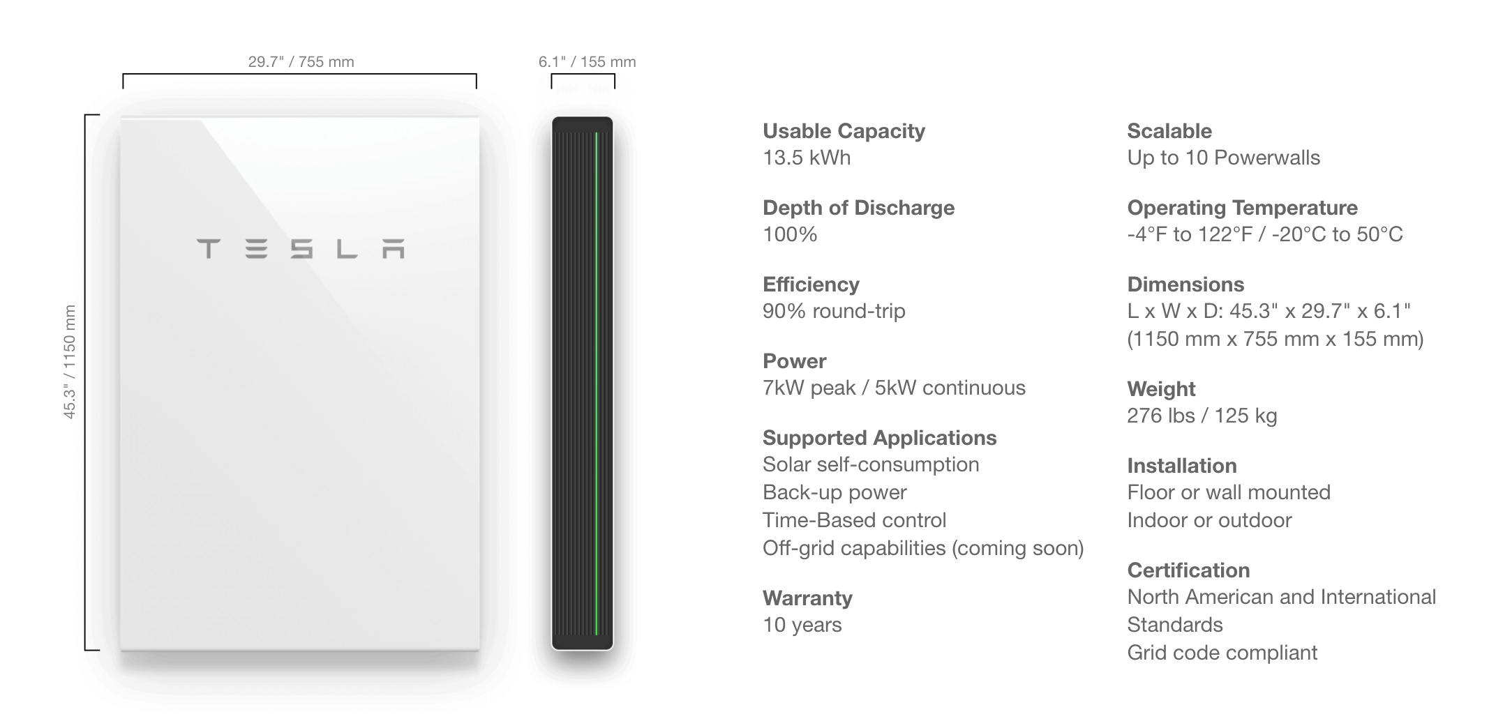

https://www.tesla.com/sites/default/files/pdfs/powerwall/Powerwall%202_AC_Datasheet_en_northamerica.pdf
Internal Battery DC Voltage 50 V
Total Energy 14 kWh
45" long. It’s long board length.
Anybody? Lay it flat on the side… Bolt some shit to it…
Now your thinking!
Might not squeeze onto the deck… a backpack for it would be more suitable
IT weighs 276 pounds. It IS the deck.
You can’t lift 276 pounds?
30" wide too… Pretty useless unless you’re riding a door…
:thinking:
Ah wait you mean it becomes the board :grimacing:
I mean, it’s already in a metal enclosure complete with electronics, BMS. It’s basically a integrated deck with a 10 year warranty. Lmao In a pinch you can use it to power your house too.
Tbh if you cut it in half right down the middle, it’s actually almost perfect size lol

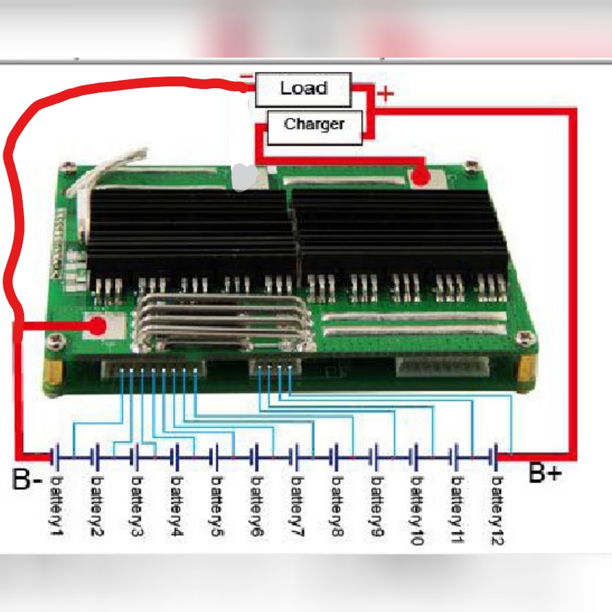

Can someone post a schematic of how a BMS is wired so that charging is balanced, but output is not restricted?
Thanks in advance.
Depends on BMS. Generally you wire it as the BMS instructs, except where P- power negative goes, you put it straight to B-
this helped a lot! as a visual learner i wasn’t gathering the concept quite before i saw this.
It didn’t make sense until I had to do it.
