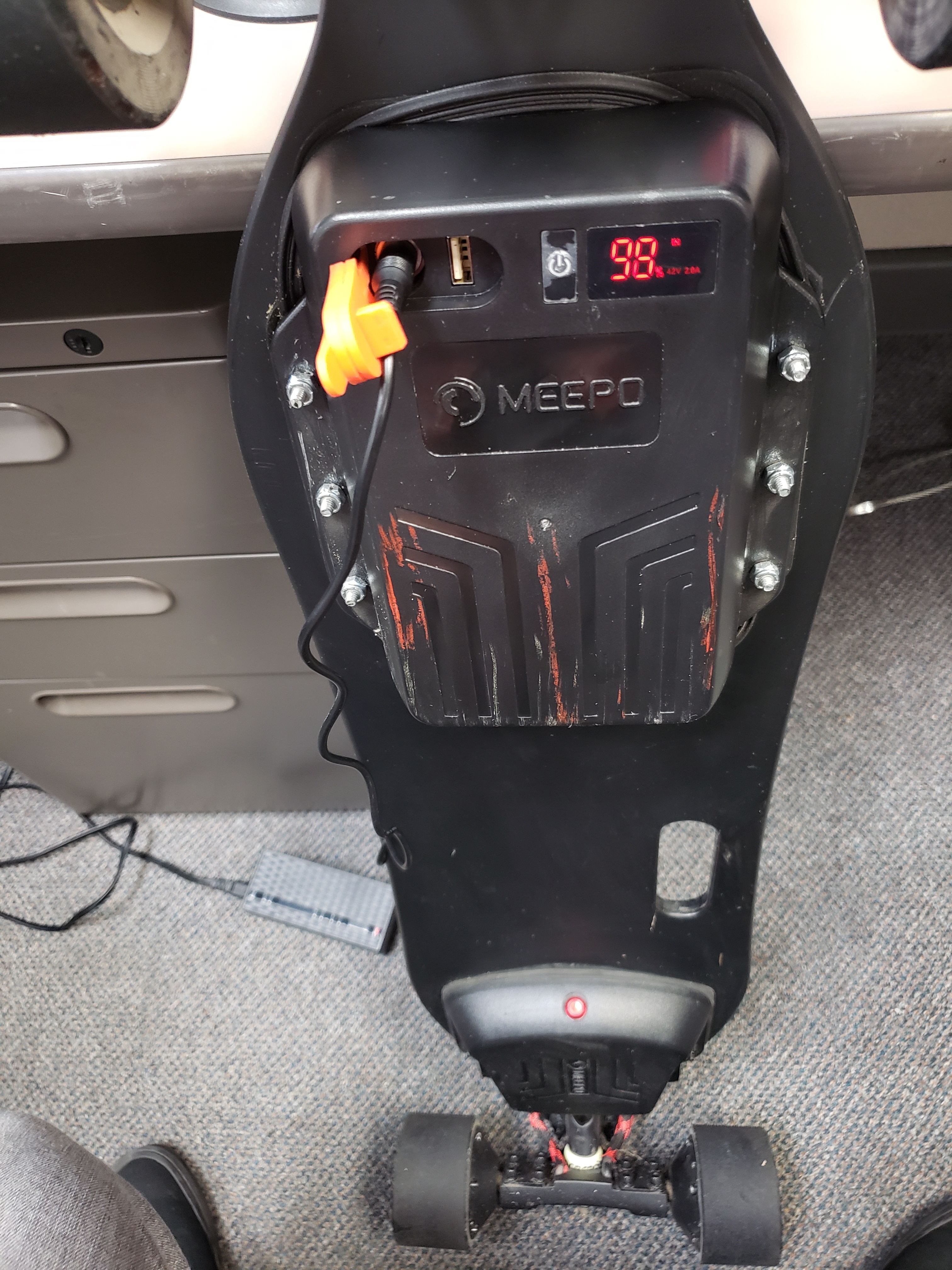

Update regarding my meepo 10s4p battery upgrade, its successful!
Went on a ride yesturday, feel like a normal meepo, only difference is normally after 4 miles I have just under 60 percent battery life
with my upgrade I had 86 percent after the same 4 mile ride :grin: I used 3200mah 10A cells. Next step is probbaly upgrading the esc to a vesc, something small like make maker x dual. The battery can only do 40 amps continues. That should be plenty tho!
Also I am thinthinking I can probbaly get like 10-15 full charges for my phone out of this battery lol.

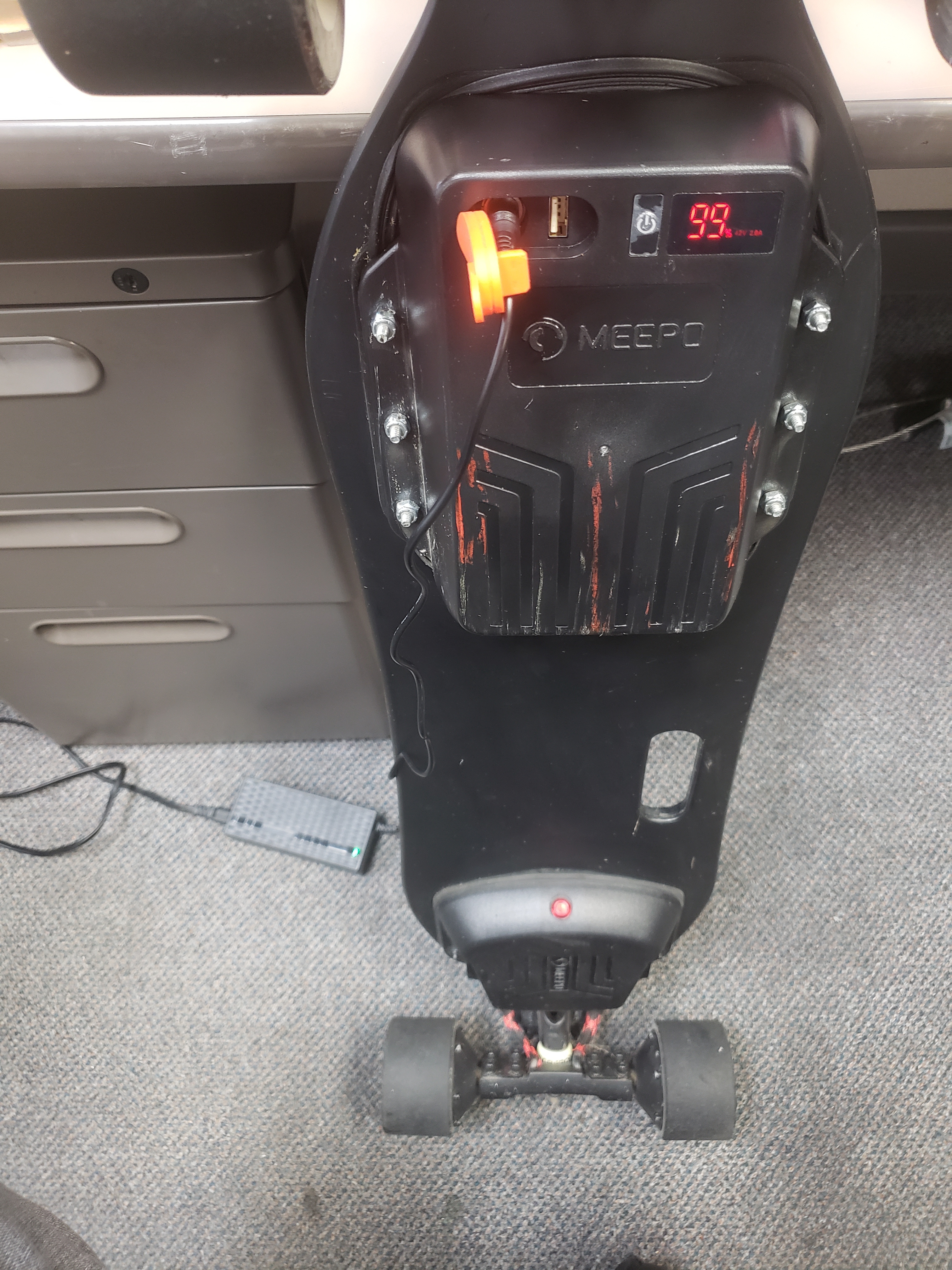

Charger stopped charging battery at 99% indicated capacity
Meepo website says their indicator is +/- 3% accurate. I dont have a voltage meter on me. But this looks good! Original meepo battery stopped charging at the same battery level indication

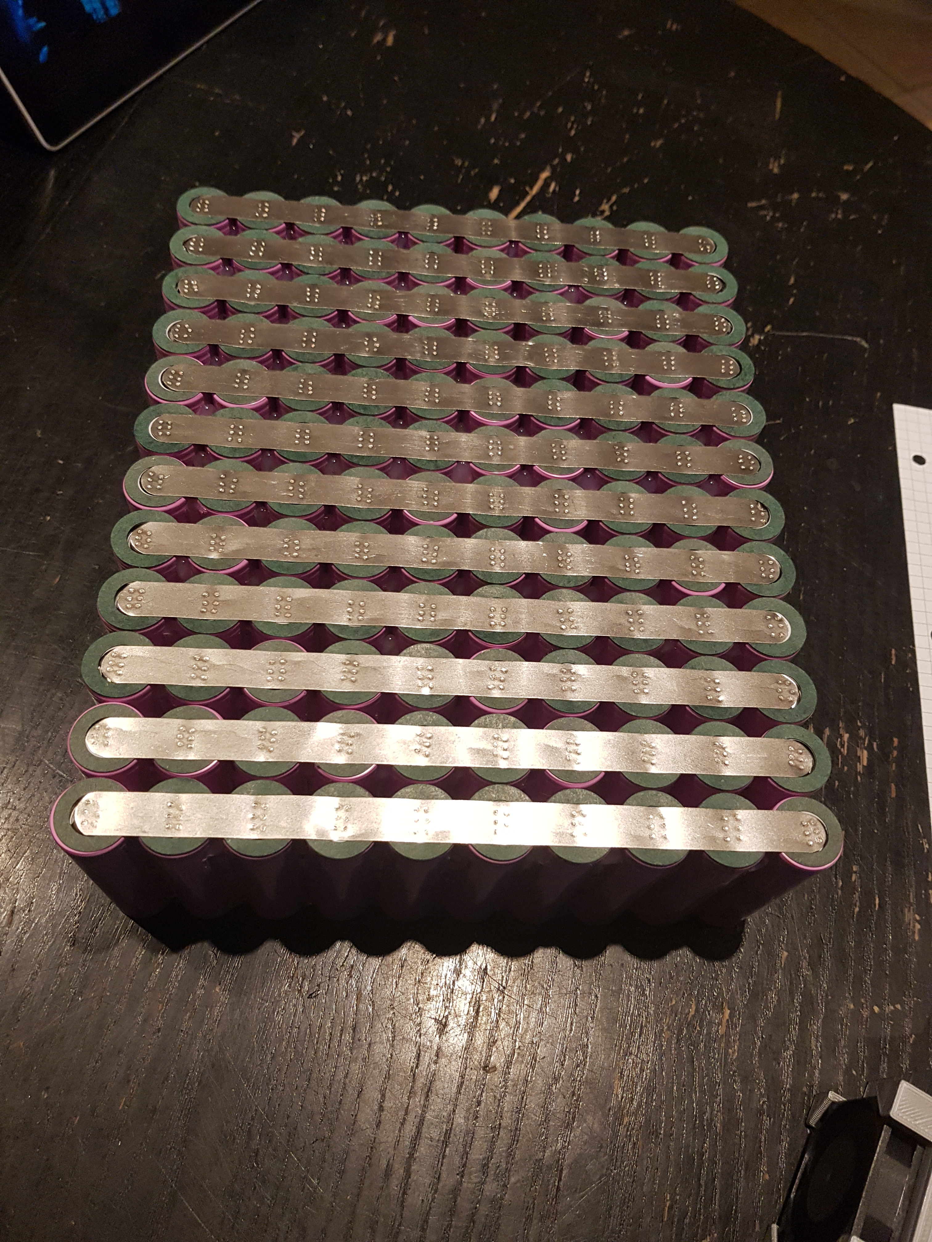

Puhhh, a lot of welds!
