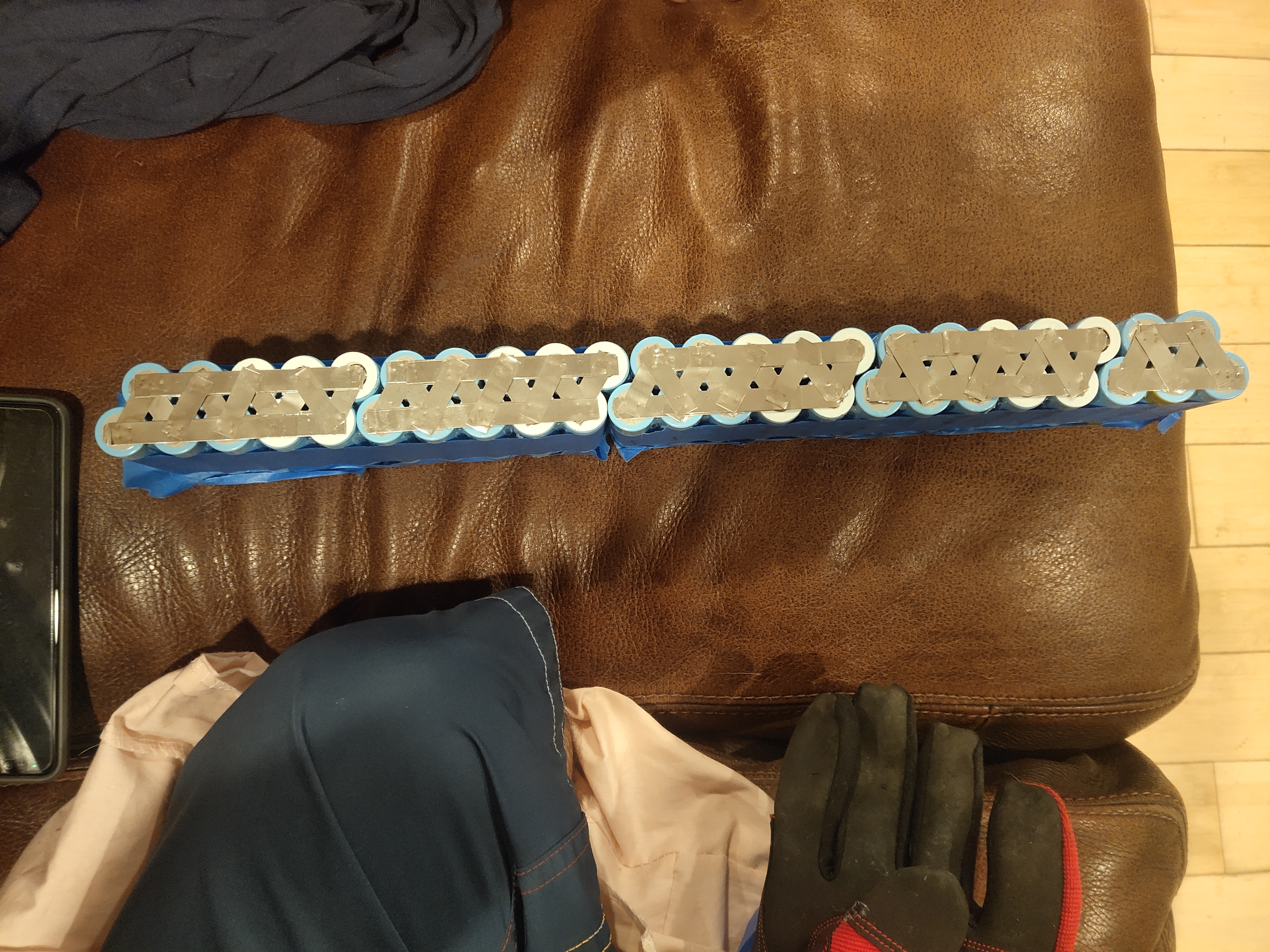

Originally planned for the cells to sit in a square pack so I bought a roll of “H” style nickle. Changed my mind and adapted.
Almost all the slotted nickel I see is slotted for cells held by plastic spacers, not really any nickel out there that is slotted for cells all next to each other, past 4 cells the spacing gets really off.
Very much. Dont use a lighter lol. Cold joint heaven.
The slots aren’t even a concern. It was more of how the cells were laid out. If I had originally planned the cells to sit staggered, I had bought staggered nickle roll.

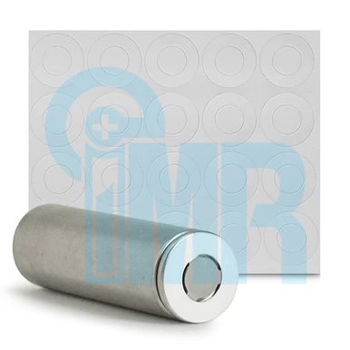

Anyone got a few hundred 21700 fish paper ends or a source so I can get some asap?
Otherwise I’ll look for someone who can cut them with regular fish paper??

Does anyone have 30 of the 21xxx cell rings they would mail me? $0.30 for a stamp is more appealing than $4 for a package :grin:

Looks very tidy tho

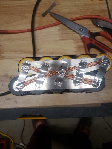

I am new to spot welding and nickel strips and have not idea how to calculate how many strips is enough for a 9s6p 50amp battery. Pls refer to picture. I need some advice. I have 3 layers of .12 x8mm top and bottom and 1 layer in X
. Is that enough? One 0.12x 8mm of nickel strips could Carrey 5 to 7 amps right ?
You have enough nickel, next time for simplicity just use 25x0.15mm strip
