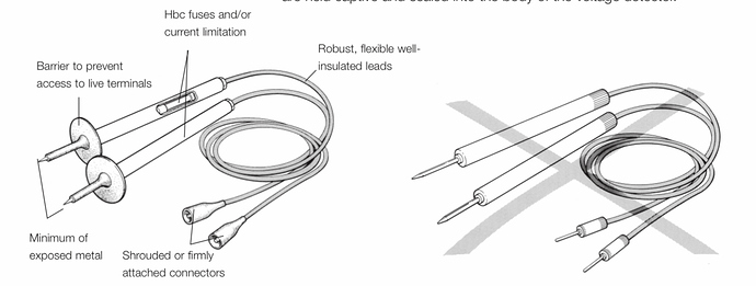

Or you could get proper test equipment in the first place that meats legistration. (It’s a pain in the ass some times tho)
