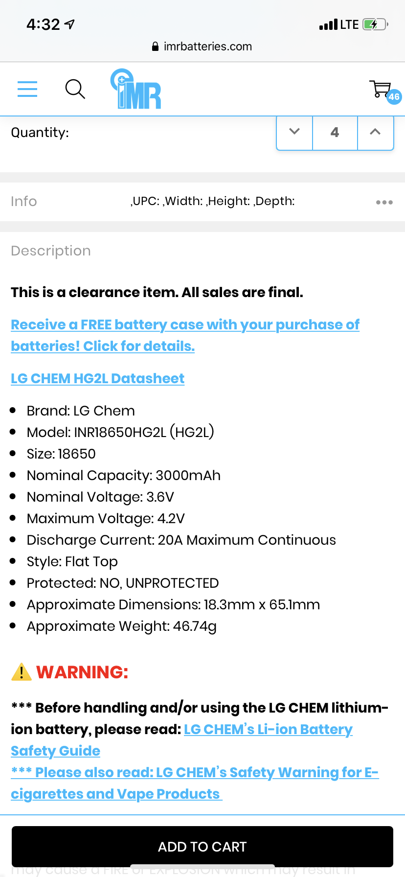

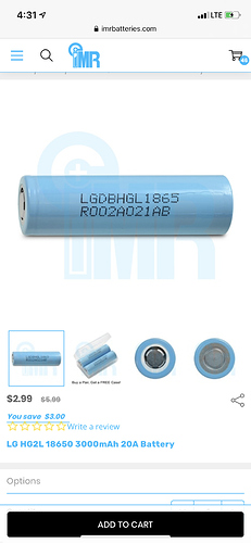

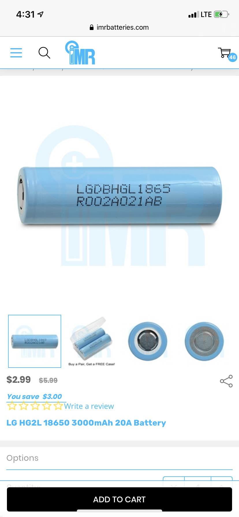

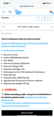

Does any one have experience with this battery? I’m considering it in a 10s4p application
liquid e-tape baby. Conformal coating is also good, but I like the opaqueness of the black liq e-tape as a conformation everything’s been properly sealed
you going to be happy with 80 amps max discharge? what is your set up?
It looks like they are inferior to 30Q or vtc6. Also, they have vent on negative side, I would be scared to weld on that.

So I should prolly suck it up and go 30q for the extra $50

You need 80 batt amps to power a 31ish inch choochoo deck?
Avoid the LG cells for your purpose?
I was toying w the idea of this cell for the savings really.
i have 40 hg6s if they will work for you, 30 amp cells 3000mah but the size is 20650 a bit bigger, not sure if they will work for you
They work but I’m concerned about the extra space they take. I’m also fitting a ttl module in there
I think I’m just gonna stick w 30q. … I have 60 25r sitting around not doing anything but the range would suck
