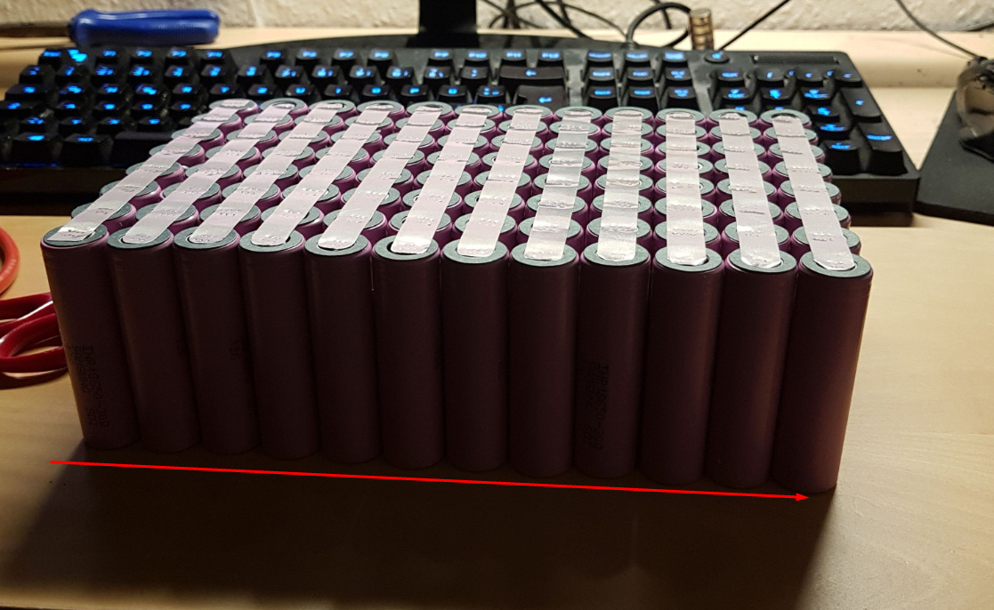

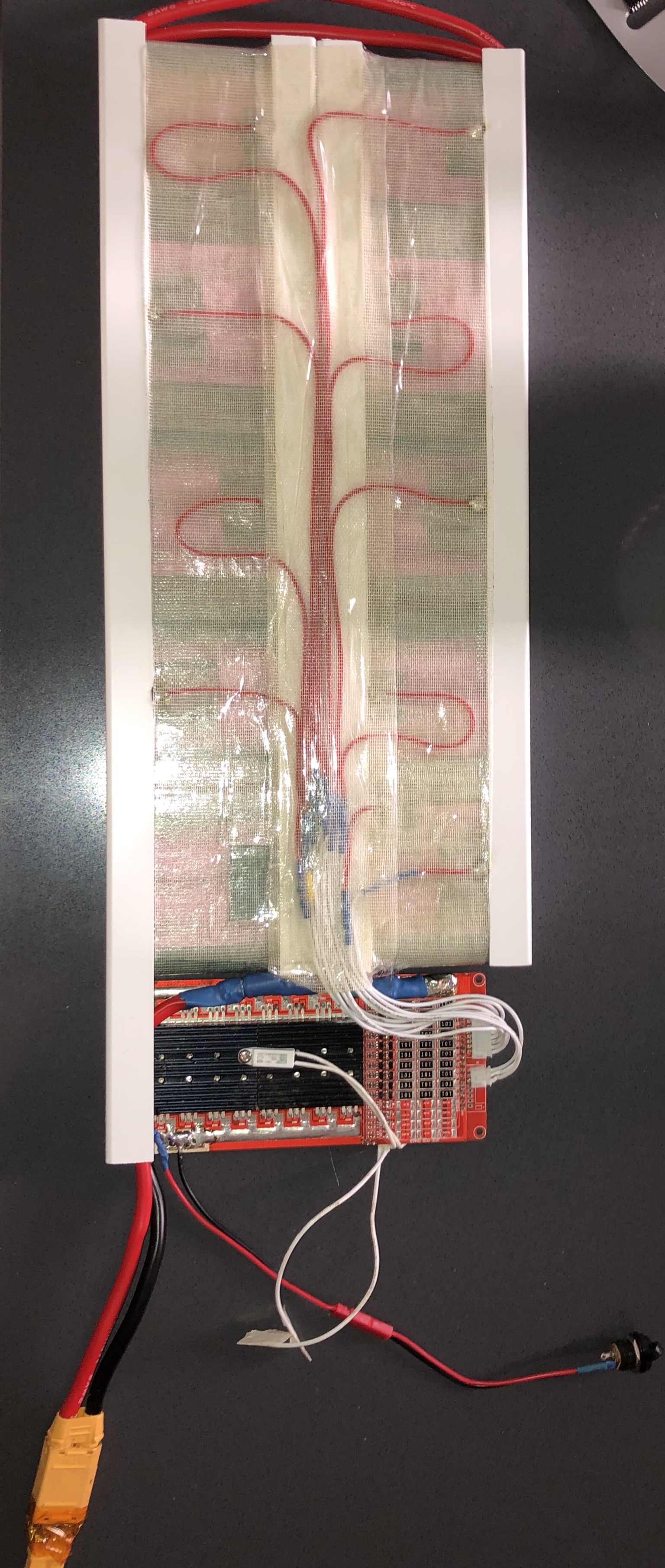

Just (almost) finished this 10S4P🙂

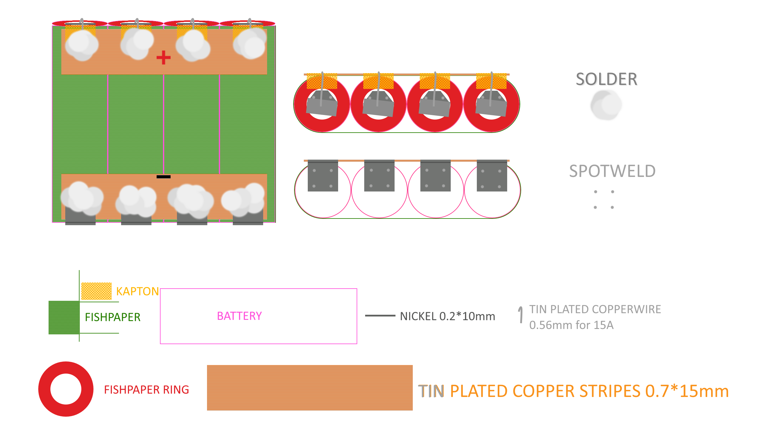

I would appreciate some feedback for this diagram:
(wiring and materials)
I am also curious if you add solder between the nickel and busbar?
From the bottom to the top:(velcro+fishpaper+battery+fishpaper+busbar+nickel+solder+fishpaper and in shrinkwrap) will I be able to fit 30Qs or VTC6s in the 22,5mm Haya with that, I hope so…

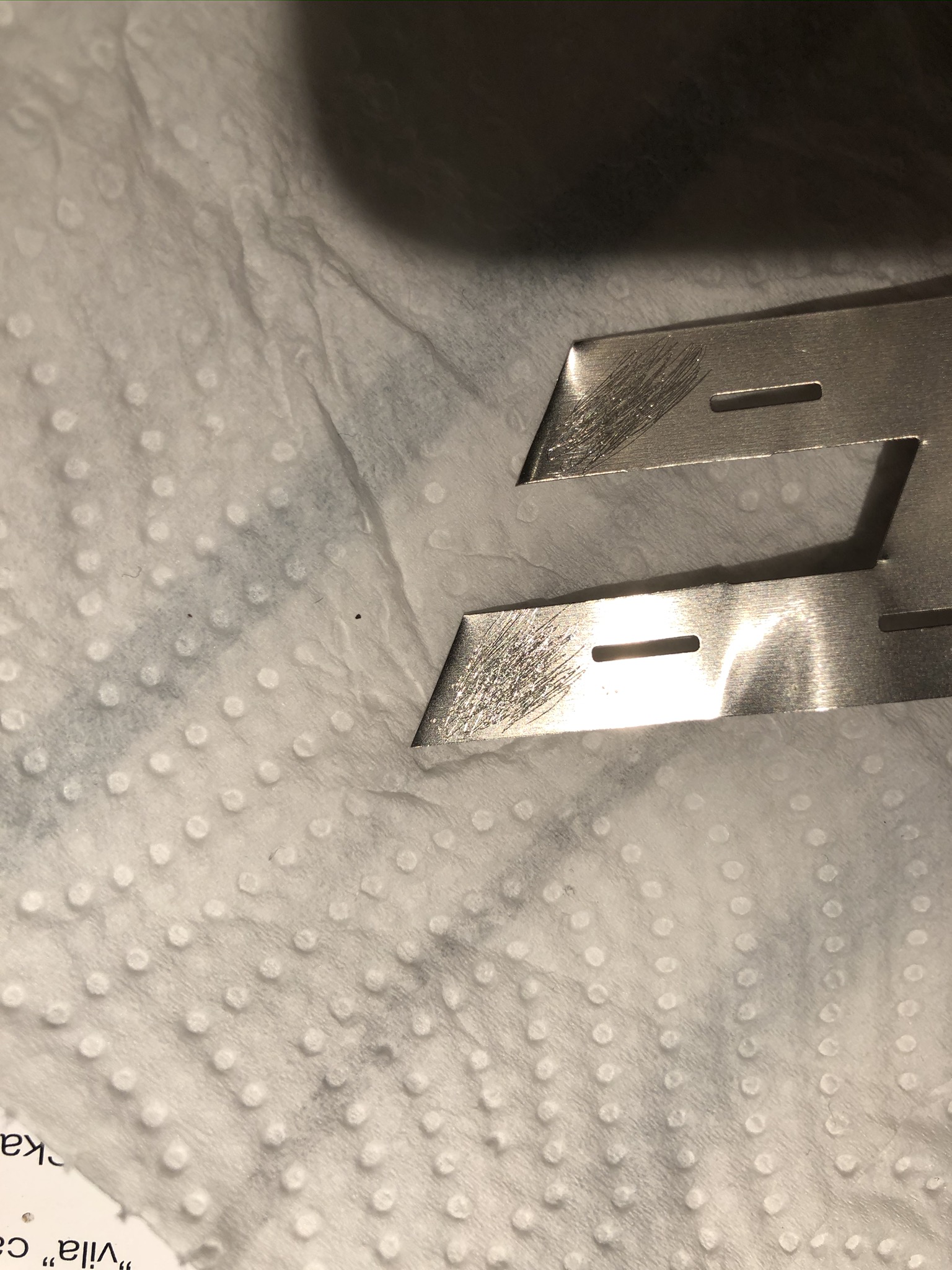

So this nickel as been soaked in salty water for about 36 hours and was then left to dry for like 2 hours. This must be pure right? I see no rust, but maybe it has to be soaked for a longer period than that. Also I do not know how to identify rust on nickel strips.
Looks good to me :+1:
Me in action :grin:
Looks good to me as well, hopefully its not stainless steel but nickel haha :smiley:
Anyways it should be noticeable while welding

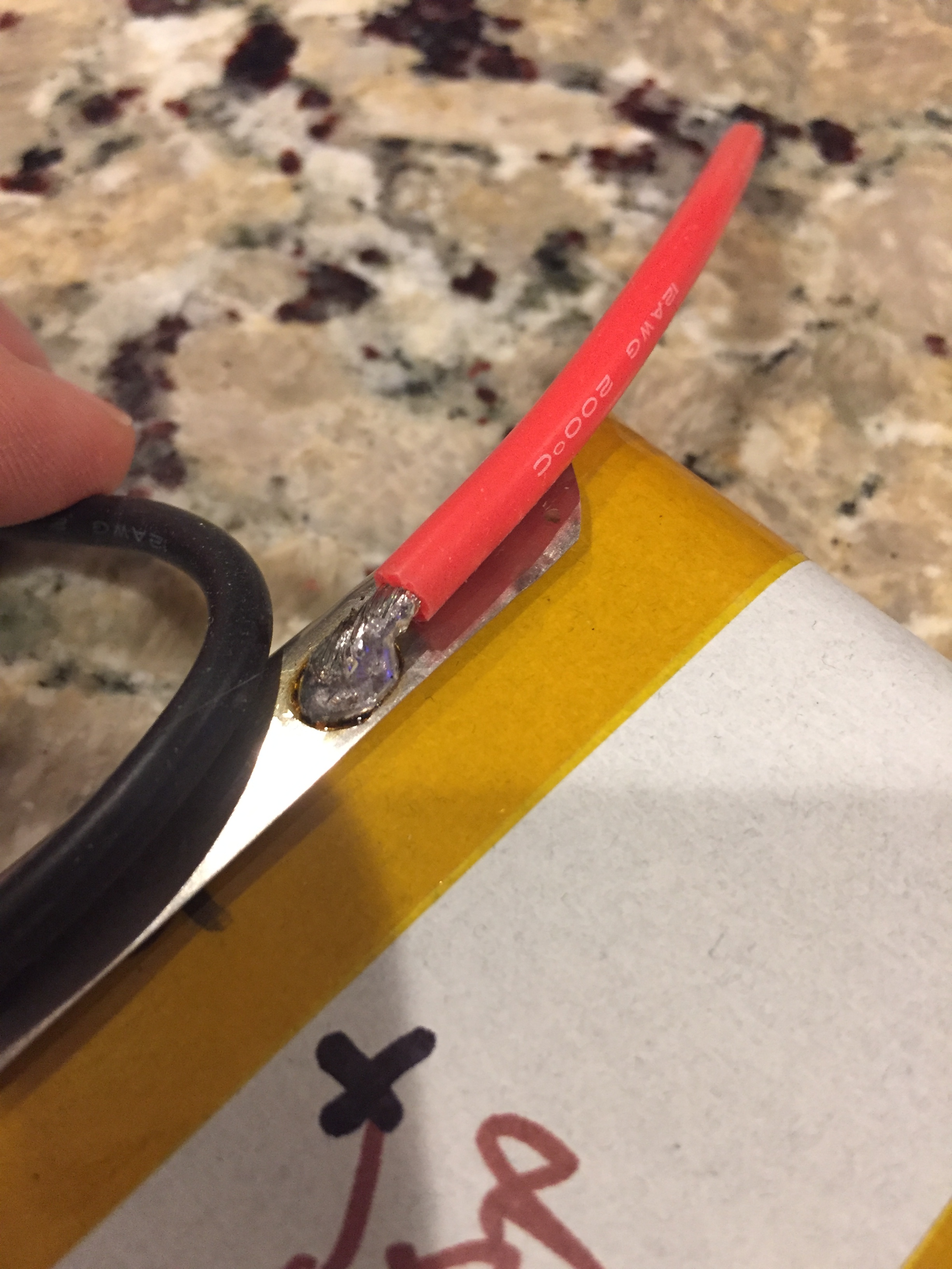

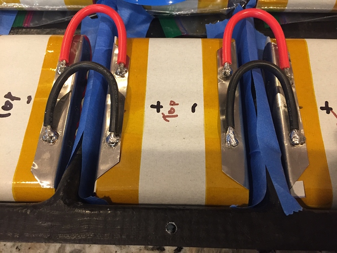

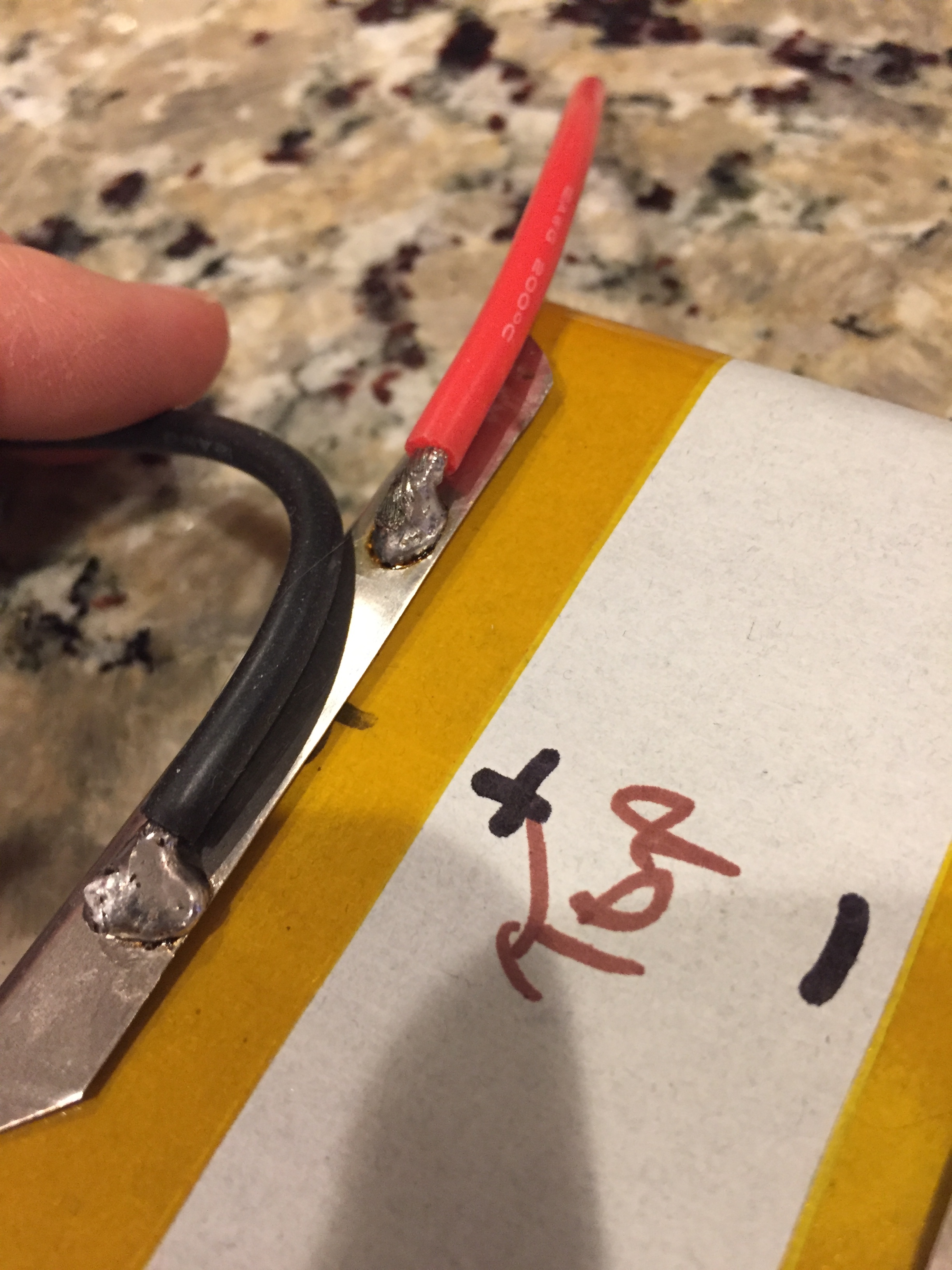

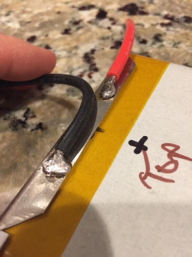

Do theses solder joints look ok or do I need more heat? I’ve got a bunch of the to do so I want to make sure I’m getting this right.
Thanks!
they look a little on the cold side but if they pass the pull test then should be ok.
BlacK looks okay, can’t see red due to flux residue. I think you should get the wire closer to the nickel though. Solder is actually not a great conductor. Get the copper in good contact with the nickel.
Thanks guys, I’ll make sure the wire has good contact with the nickel and I’ll cleanup the flux residue.

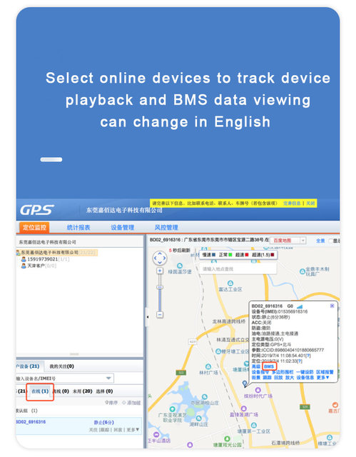

Just recently found this.
https://www.aliexpress.com/item/4000425306829.html
It seems that the GPS module can be connected to Smart BMS. As long as the stolen skateboard battery is alive, you may be able to track it. :sunglasses:
However, it is unknown whether it can be used outside China. Already tried someone?

Looks like a standard chinese vehicle tracker
You can add these to any esk8 if you a 12v buck\bec. They are cheap often >$10.
Catch is they are not super accurate
You geo data isnt secure
Some rely on gsm data (my country turned off our gsm 2G network years ago.) While others dont use data you send a sms to the sims no and it replys with log and latitude coordinates. I would need a 4G version of this and they are 8x the price.

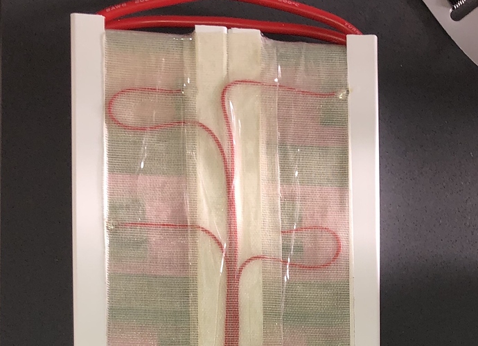

Hi all, I’m wondering if I have painted myself into a corner here. When do you all add the heat shrink to a flex build like this?
I thought about wrapping each p group and then trying to poke or melt holes in the shrink to solder my series wires but that seemed like a PITA.
All advice appreciated.
Insulate with fish paper / harness tape and use heatshrink to hold everything together at the end
Time for the fishpaper and silicone(again)
Trying to do the tour de france on that pack or am I missing something?
That’s a normal (although decently) sized pack for an MTB.
