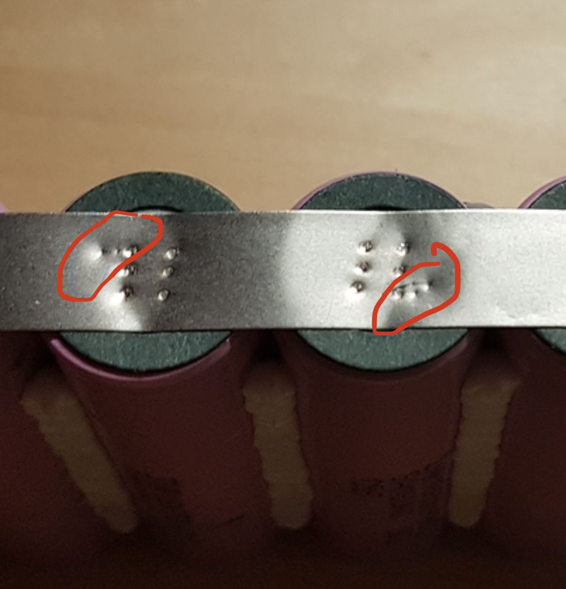

1/24 done
Donā€™t weld next to the terminals, in case those are welds.
I know I knowā€¦ horrible circles :joy:
Clip the corners of them nickel strips. Donā€™t need to round them off just take a diagonal cut on each corner so they donā€™t stick out so sharp.
