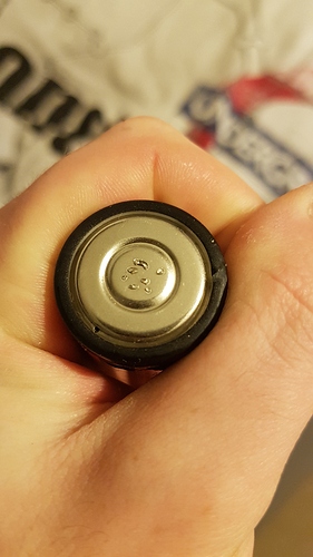

I have done some test welds with 22J.
Yup, that’s pretty solid. Looks like you had to rip the tab off with some pliers, so that’ll hold up just fine. What thickness nickel is that?
0.15mm.
A good amount of force was needed to rip it off.

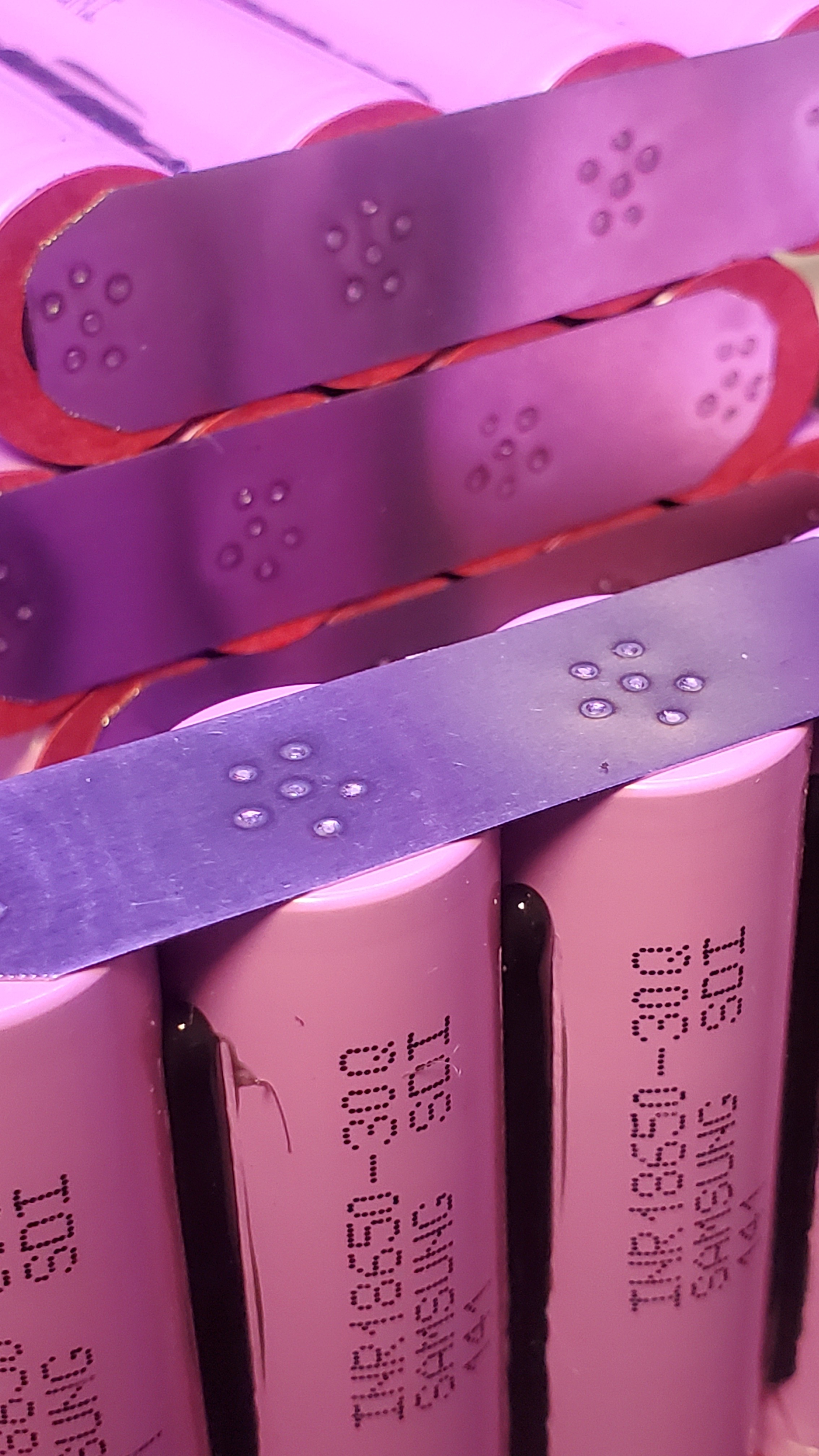

you might find you need to turn it up to 25J or more as the welder/battery heats up. It punches hard when it’s cold but after 10-15 welds you’ll have to compensate for temperature a bit.
Good thing to know about.
Fun Fact. My mom asked me, what in Merlin’s underpants I am doing with the batteries. Is it dangerous with alkaline cells?
Alkaline batteries can indeed explode, but it is very unlikely. They have a venting mechanism that releases any excess gas. You’re more likely blowing up a lithium ion cell while welding, I think.

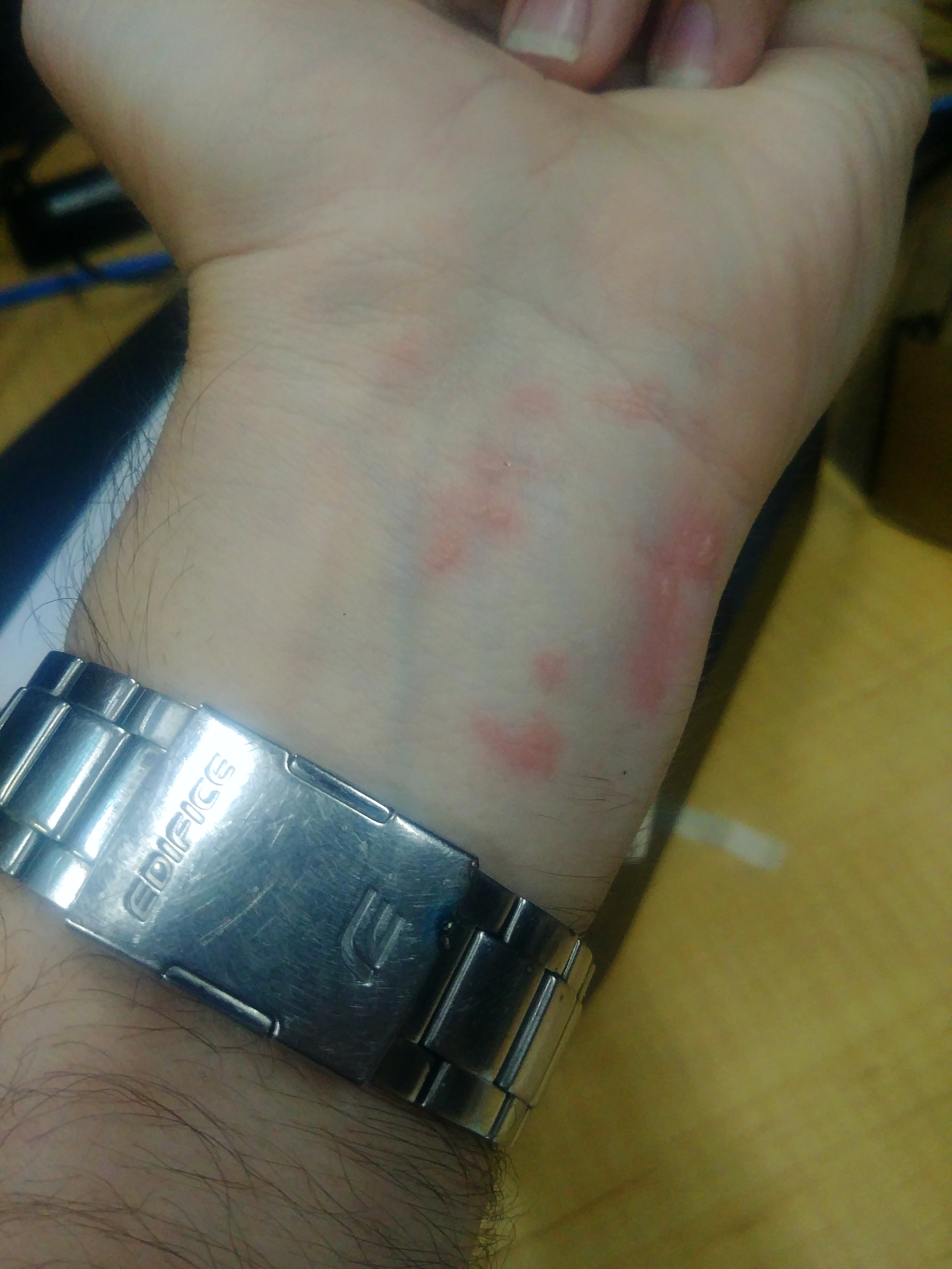

Leason Learned today - dont wear a metal watch band while battery buildind touched nickel tabs spot welded my watch buckle cant remove and burns 12S6P.
no watches, bracelets, rings while welding
also, tape/insulate everything you are not working on
(ouch)
One does not need such caution when you summon the powers of the demons by using pentagram pattern.
pretty flowers!
Lol yeah looks more like flowers than pentagrams
