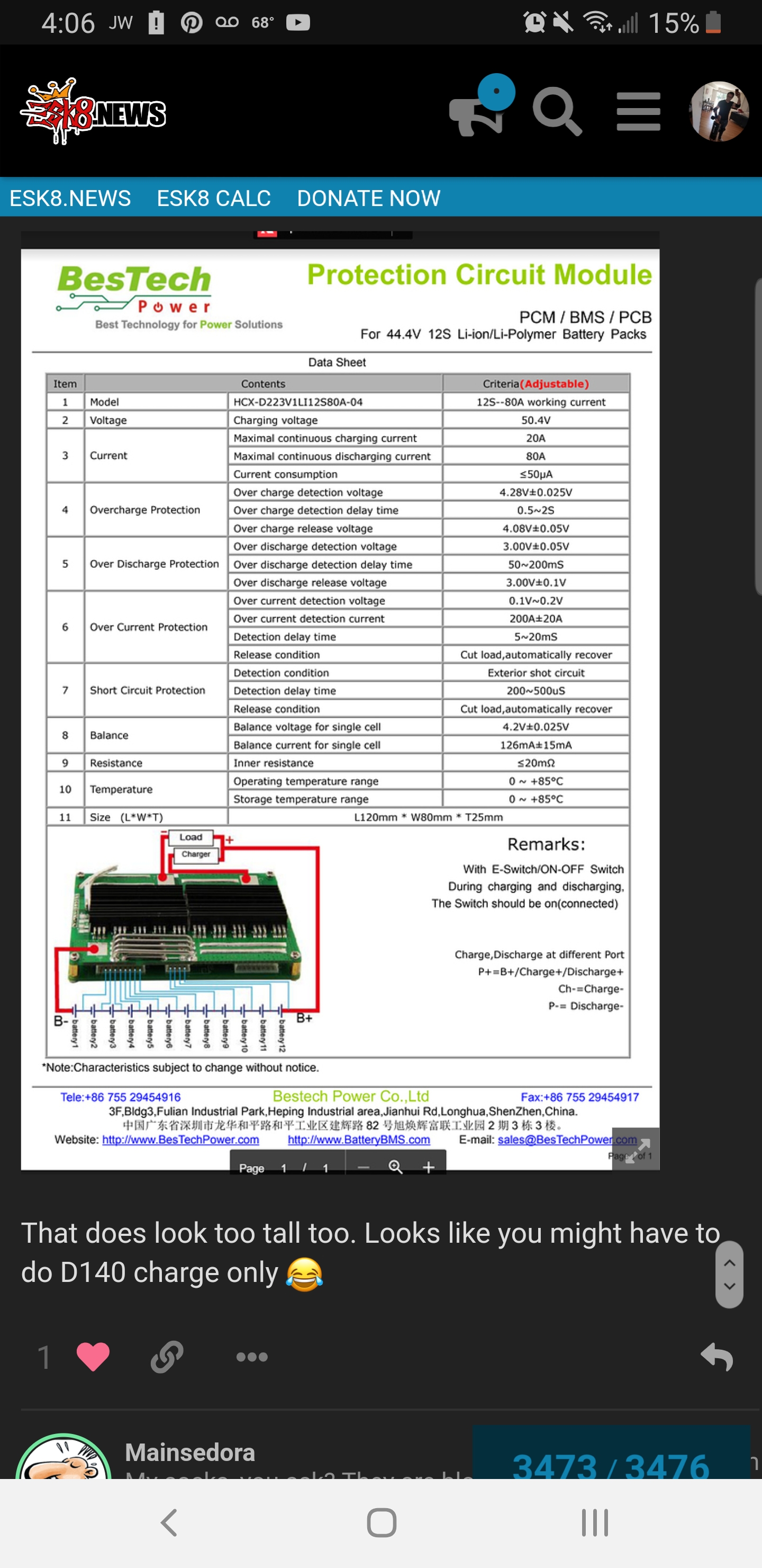

I followed this
Why the fuck are there so many variants of the d596
My balance leads are straight on the other side of mine lmao
Do yourself a favor and don’t use this troll BMS man. Just get something small and charge only…

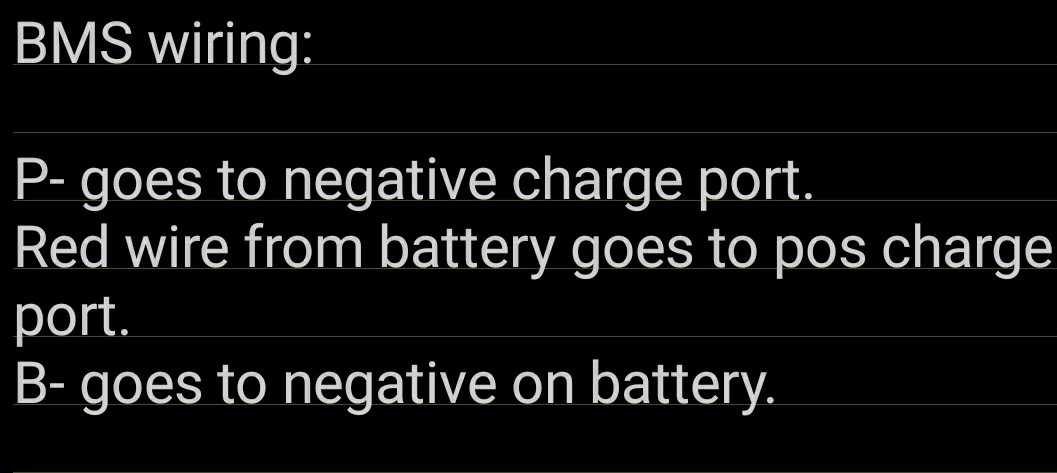

No, C is charge, P is power
This is my cheat sheet for D140. Charge only. Not sure for your model.

D140 uses shared charge/power. his is separate
