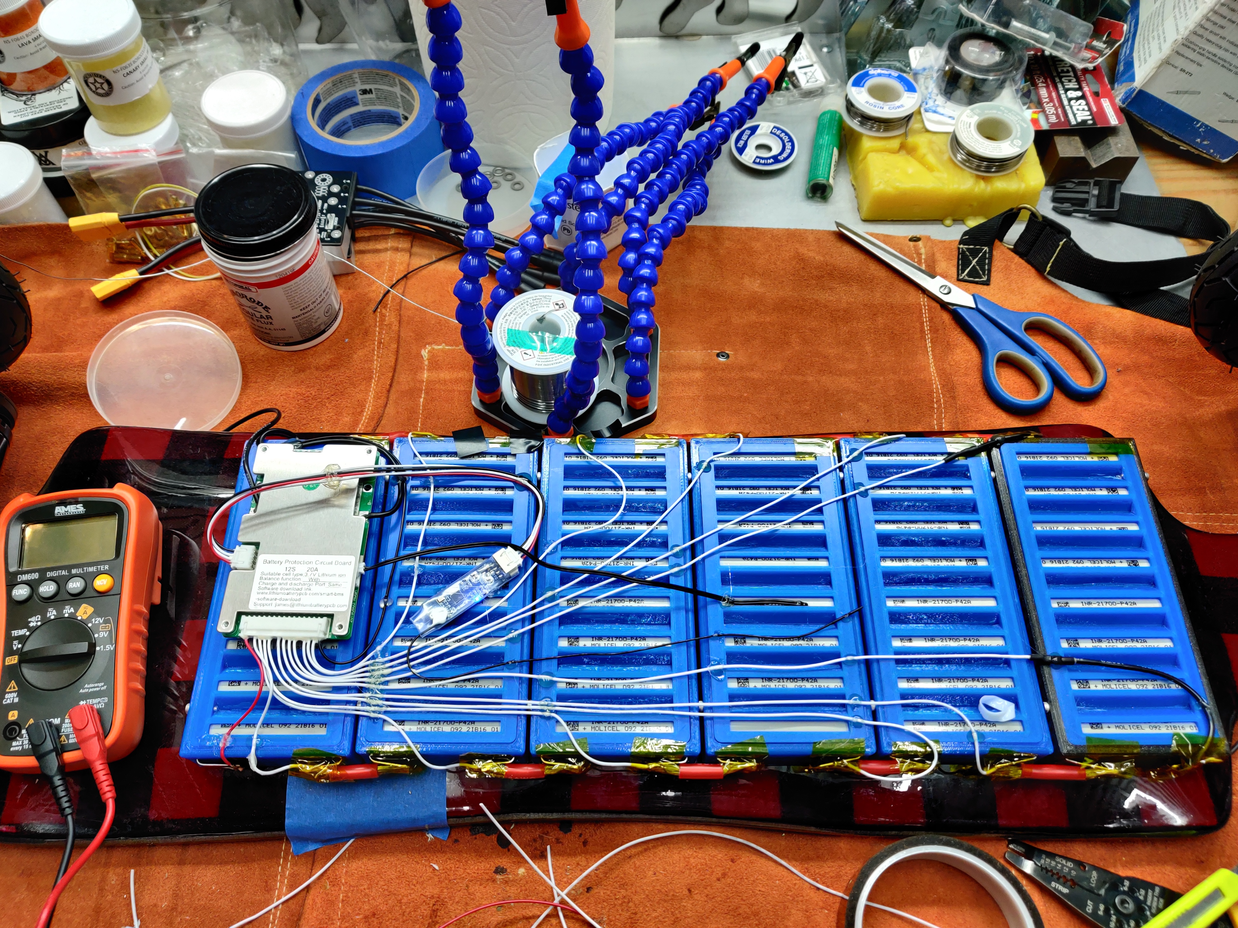

Any and all red circles appreciated
I got some red circles you can have
I can’t help myself, I keep squinting at the circles to see what’s wrong. Involuntarily.
Probably the missing balance wires, but who knows, that’s not my circles :man_shrugging::joy:
Those are next haha, ill post a lot more pics when its fully completed
Circles…
