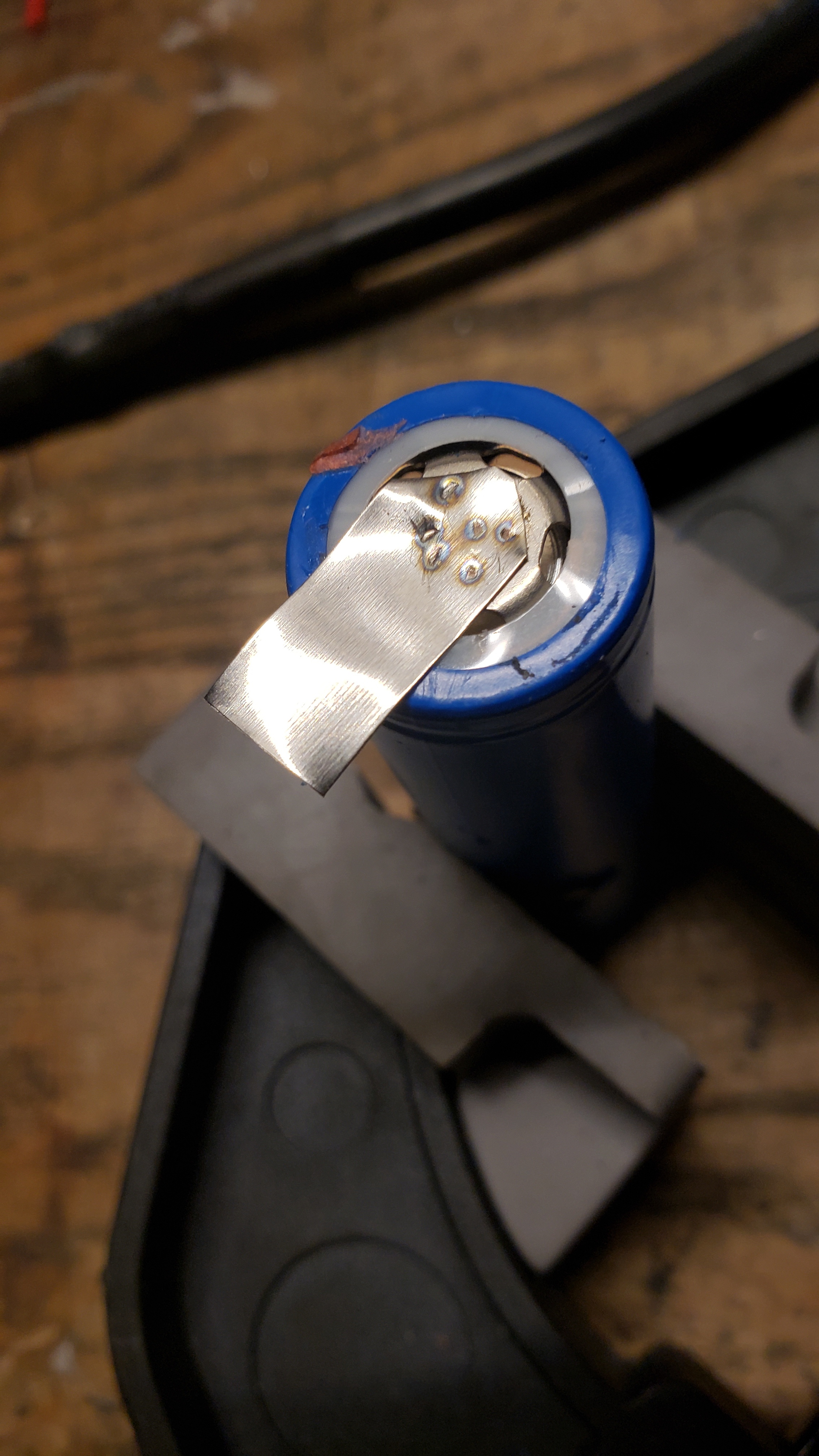

Alright kids. Need your comments on these welds.
Malectrics.
Off 3s lipo.
26ms
.2mm x 8mm nickel
Those welds are looking pretty good bro, but possibly a little on the hot side.
It’s good to practice on the cells as different substrates may have slightly different characteristics.
I can’t view the video for some reason but you are aiming to get it just hot enough that the nickel won’t come off without tearing.
Too much heat not only transfers unnecessary heat to the cell, but it also puts a lot more strain on your lipo. It may even be possible that too much heat is detrimental to the nickel/weld as well :man_shrugging:
Edit: also note that the positive end of the cells accept welds a little easier than the negative end. I usually try to do all my negative welds first, and then turn the power down just a touch to do all of the positive sides.
So here I turned it down from 26ms to 20.
It was still hard to pull off. But on the side of the red lead not much in the way of artifacts left…
nice. they look good from here :+1:
Make sure to sand the tips and round them uniformly
Yes. Thanks. I plan on making them nicer on the actual go
You want it to actually make a little hole in the nickel when you rip it off :+1:

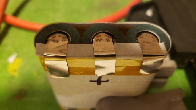

So I have glued and wrapped the p groups.
I have little tabs coming up off each individual cell. .2 x 8mm
I have wrapped the whole 3p group with fish paper.
I’m going to make the series connections next.
I’m going to to solder two pieces of 14awg silicone cable to strips of nickel. .2 x 10mm.
And then I’m going to weld the strips with the wire already connected to the little tabs sticking out.
Nice plan Raf! Just make sure that when you weld the soldered strips to your tabs that you have something beneath the tabs like a bit of aluminium would be perfect.
Your welds won’t stick to the aluminium and it will stop the heat from your welds from damaging your insulation/cells.

My plan there is to use a folded piece of fish paper under the tabs while soldering. 3 layer probably.

Cool bro, just don’t weld directly over the sides of the cells without an aluminium backing :+1:
