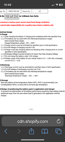

Theory? Trickle charging cells under 3v is no theory and described in numerous data sheets. I just posted one again. But I didn’t even bring it up, again.
If someone is going to bring up something from ages ago, which they obviously still don’t understand, and try to insult me at the same time, again,… yes I will respond.
Here’s what I posted recently. Hardly questionable or antagonistic

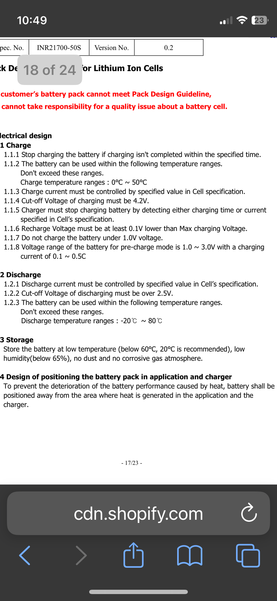

Whoa…whoa…whoa…that is a moderate-nickel-content, all graphite, NMC chemistry cell from years ago. You can’t possibly apply its specs to all cells.
Especially now that there are extremely high nickel cathode NMC cells (with lower thermal stability), artificial graphite and graphite+silicon anodes cells, along with different “standard” li-ion chemistries like NCA (Molicels and others).
There can be other cells with low voltage “recovery” recommendations but the 30T’s datasheet ≠ all datasheets. And also realize that recovering a cell does not mean it was done without damage to the cell.
If anyone is considering telling someone that they can “recover” an over-discharged cell please be sure to check the datasheet for that specific cell before doing so.
I dont know the cell he’s talking about and it wasn’t mentioned as far as I feel like looking. It’s not up to me to tell everyone to figure out their specific details. I’m just here to state there are li-ion cells you can trickle charge n bring back from as low as 1v.

50s. Power cell. No safety concerns mentioned when trickle charging from 1v

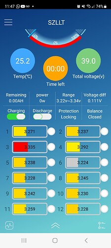

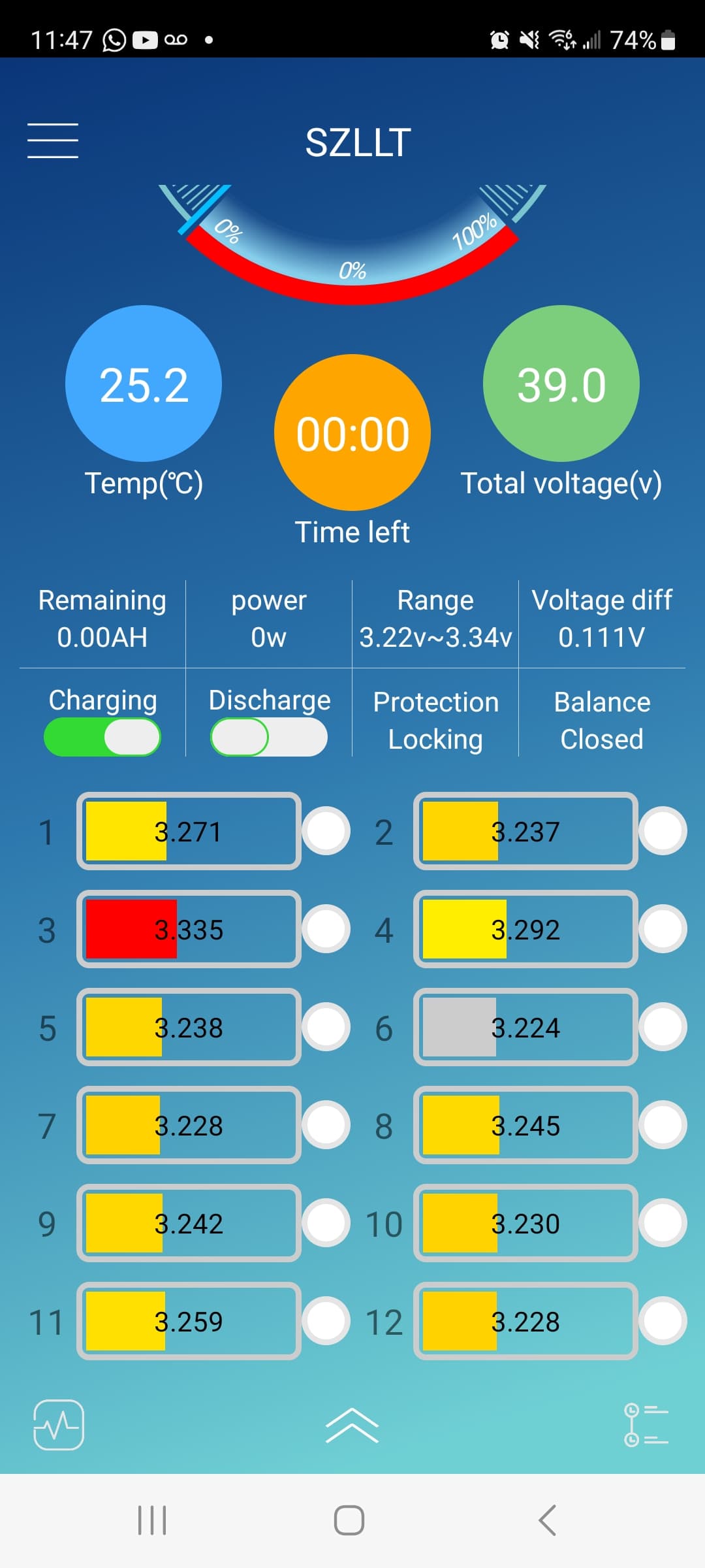

It def is a conservative approach but I’d already started with the 2 lowest groups. The BMS is still stuck in protection mode even though all of the cells are well above 3.0v. Anyone know how to reset the bms? I’m gonna just unplug the balance harness and leave it for a couple of hrs or so unless someone has a better idea. The interwebs have shed no light on how to unlock it through the app.

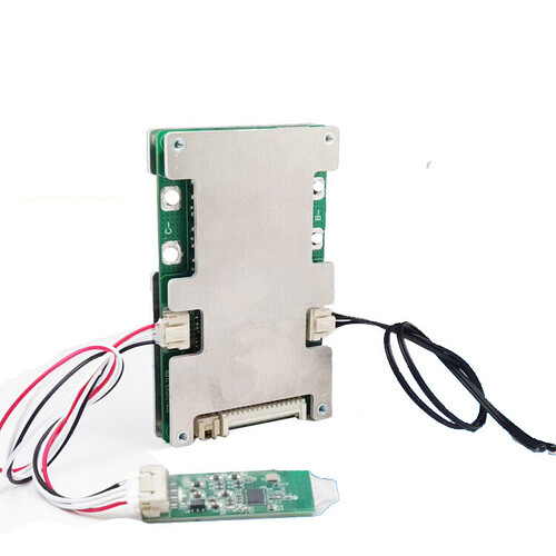

What exact model is the JBD ?? Not trying to insult your knowledge, but have you check the discharging bottom and charging? Try using another app.
Also change to another configuration and set it back again.
I have had luck completely disconnecting the bms and letting it rest a minute or two then restoring the connection. Haven’t had a jbd need this but other bms it has worked when locked down.
You will have to clarify, friend as I don’t understand. It’s this model:
This is a screenshot that I took last night. You’ll note the “protection locking” indicated. On a newer version of the Xiaoxiang app the “soft lock” was indicated as being engaged.
Did you desolder the CH- wires and everything? I’m thinking just pulling the wiring harness should be enough, no?
Its likely because you have a significant delta at 0.111. Try getting that delta below 0.1 and you might have better luck
