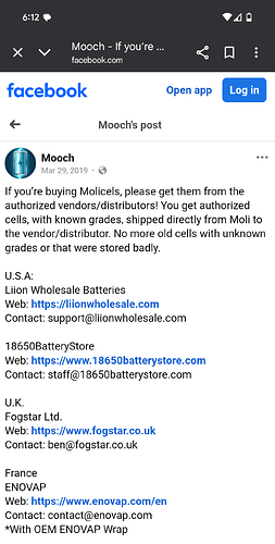

Only one of the three ‘trusted’ sources/stores of Molicel’s in the USA is an ‘Authorized Distrbutor’
For a while, the P45b was likely the most profitable to counterfeit.
Who? Please say 18650batterystore.com
18650batterystore claims the same, no? My research suggests they’re both authorized?
Google search showed this…
I don’t see 18650 BS currently claiming to be an NPE/Molicel ‘Authorized distributor’, but could be missing it, and accept the fact I could be wrong.
That facebook post is from 2019. A lot can change in 6 years.

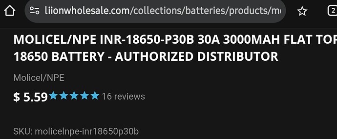

Me and @Pecos bought P45b cells from Liion Wholesale, so we got it from an authorized distributor.
Hopefully that old FB post is still relevant because there are 72 of them from 18650batterystore on my bench right now. No issues with them in the past.
A six year old post? Never a good idea to share. :slightly_smiling_face:
And absolute insanity to use Google for any cell-related searching since it returns the most popular links first…which are the oldest and practically guarantees their obsolescence.
Forget all that “authorized” craziness…badly abused by others. Trusted vendors include 18650batterystore.com (NOT 18650battery!), liionwholesale.com, fogstar.uk, and DIY500AMP.com.

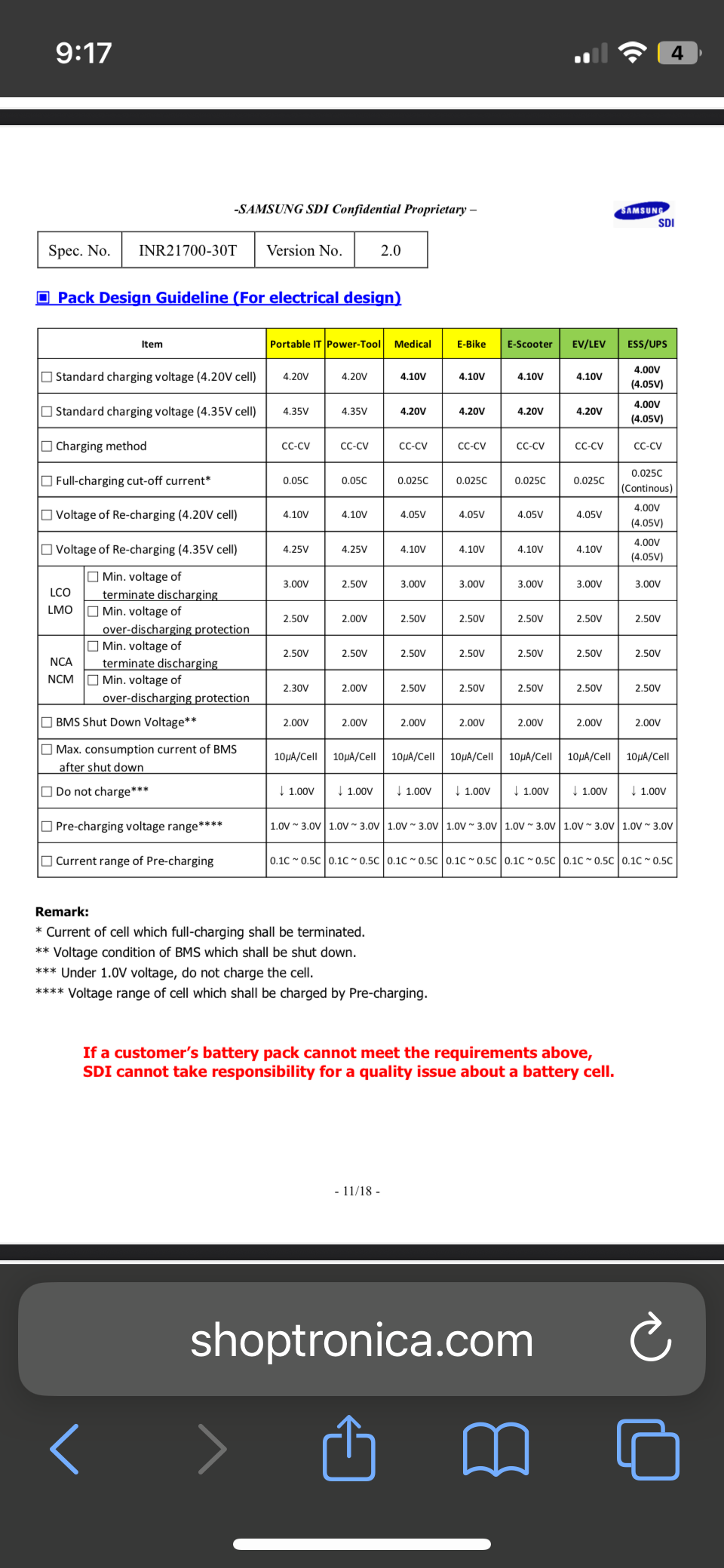

You think the data sheets are fake?
You think you know better than the manufacturers? I already showed u this. Why doesn’t it get through I don’t know
What data sheet.
As I remember it all the Samsung cell data sheets were stated to have a 1v limit of possible reviving. Other companies had other minimums.
You can see my quote he posted above but the whole conversation where the same cast of elitest characters (irony) raged and told me how dumb and dangerous I was for pages is all erased for posterity.
