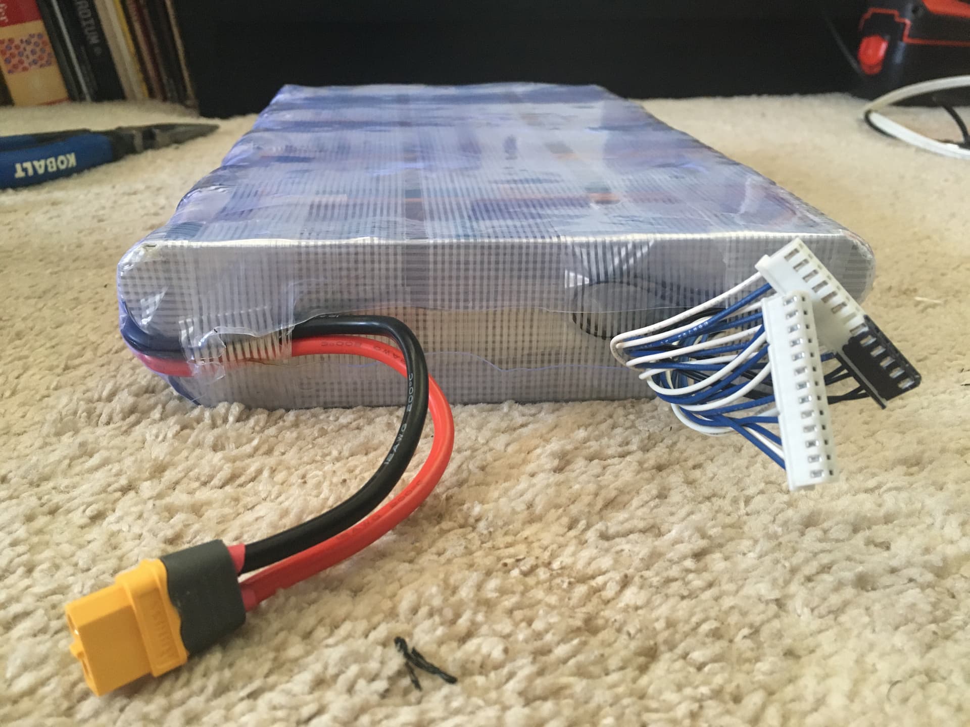

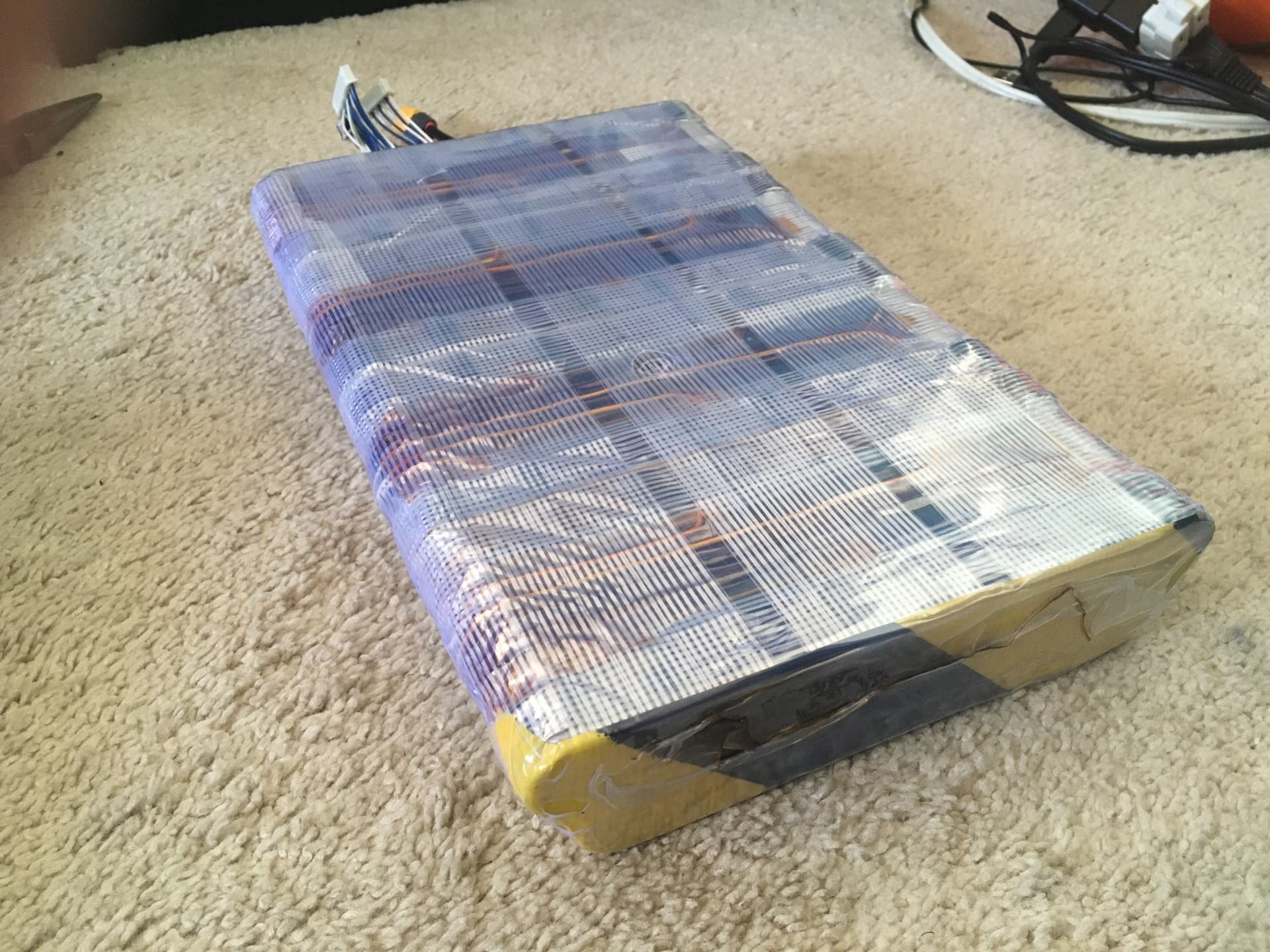

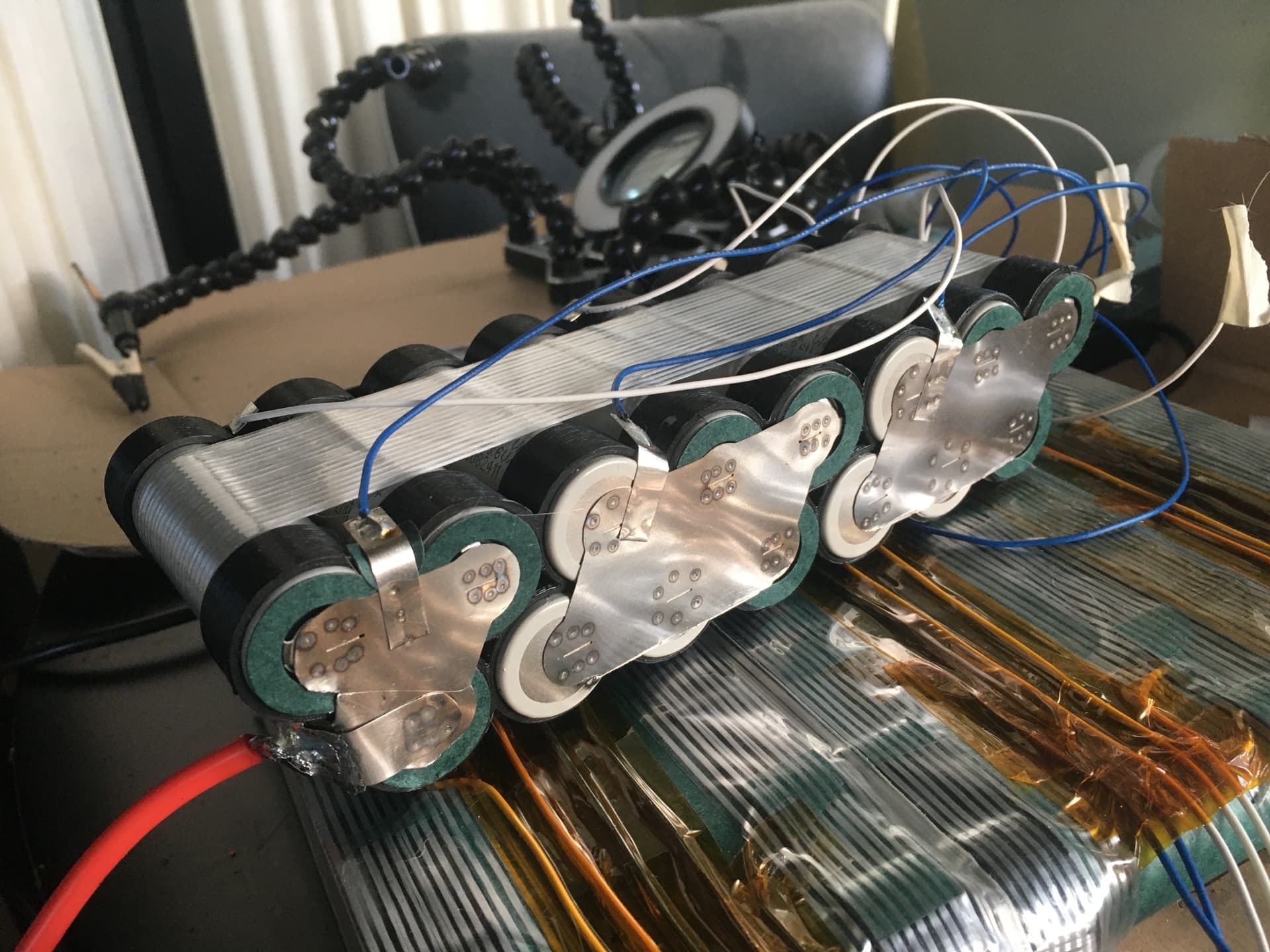

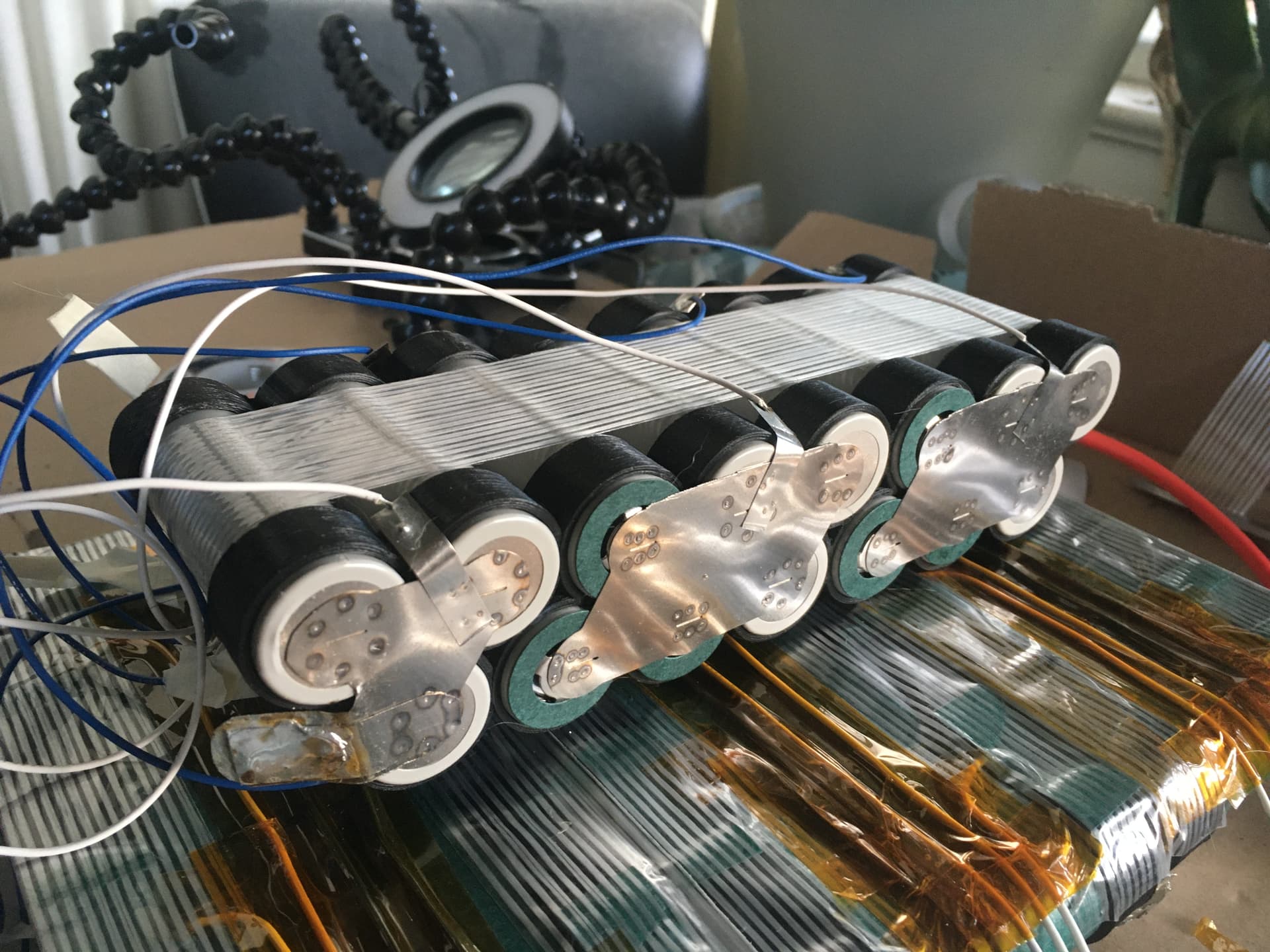

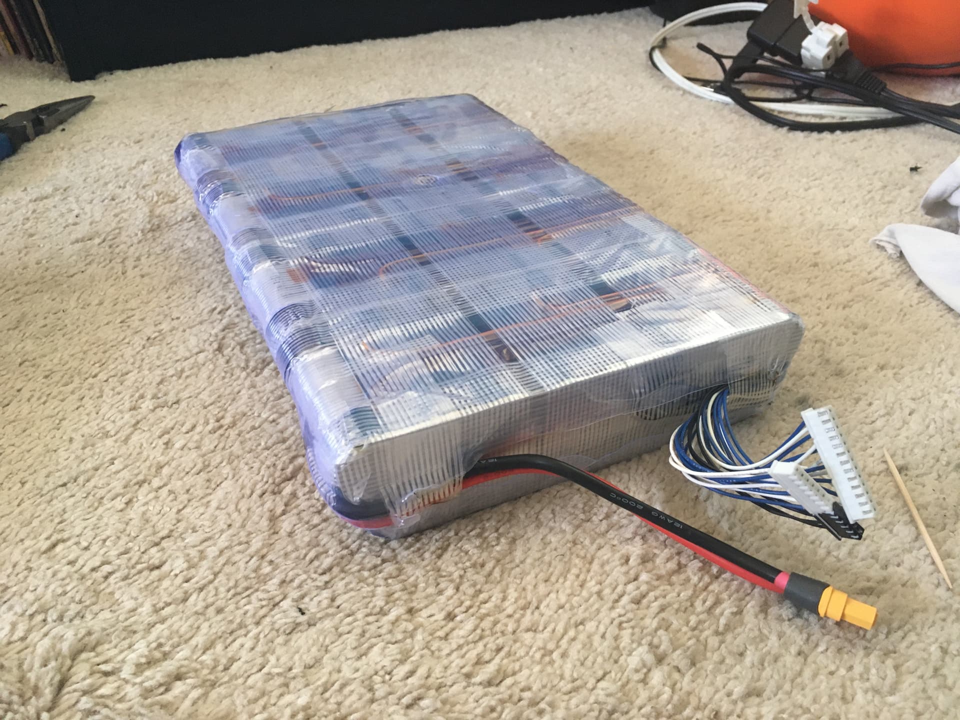

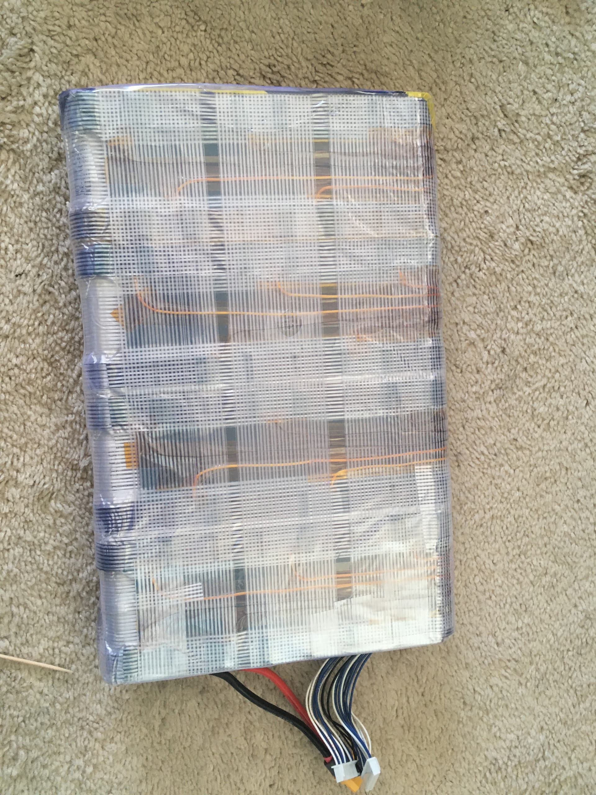

Build: 20S3P, P50b, 50A discharge
Materials: Mboard 6P precut nickel, 0.03 fiber board separators, ABS 3D printed spacers
Application: Backpack battery for trail riding

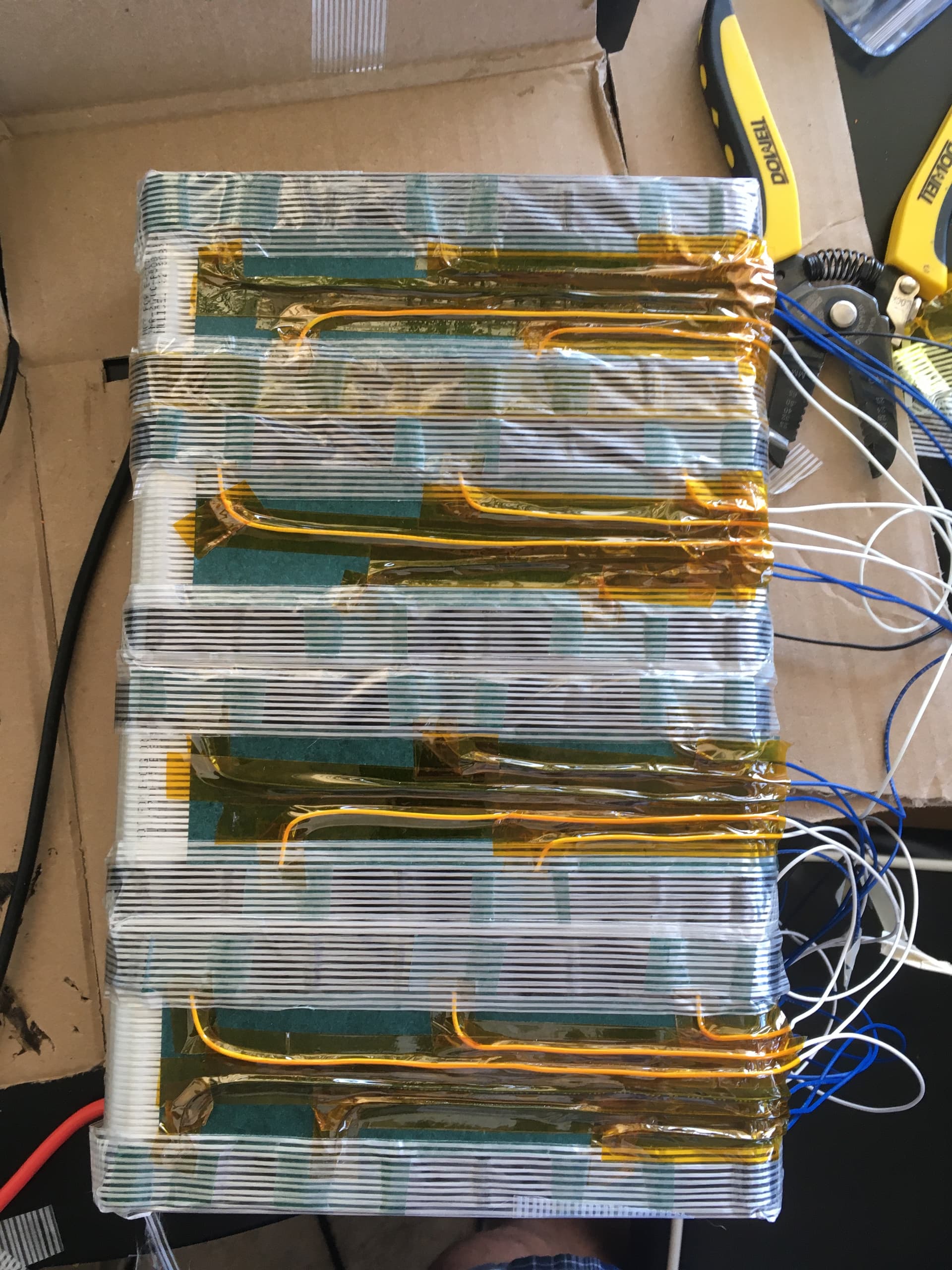

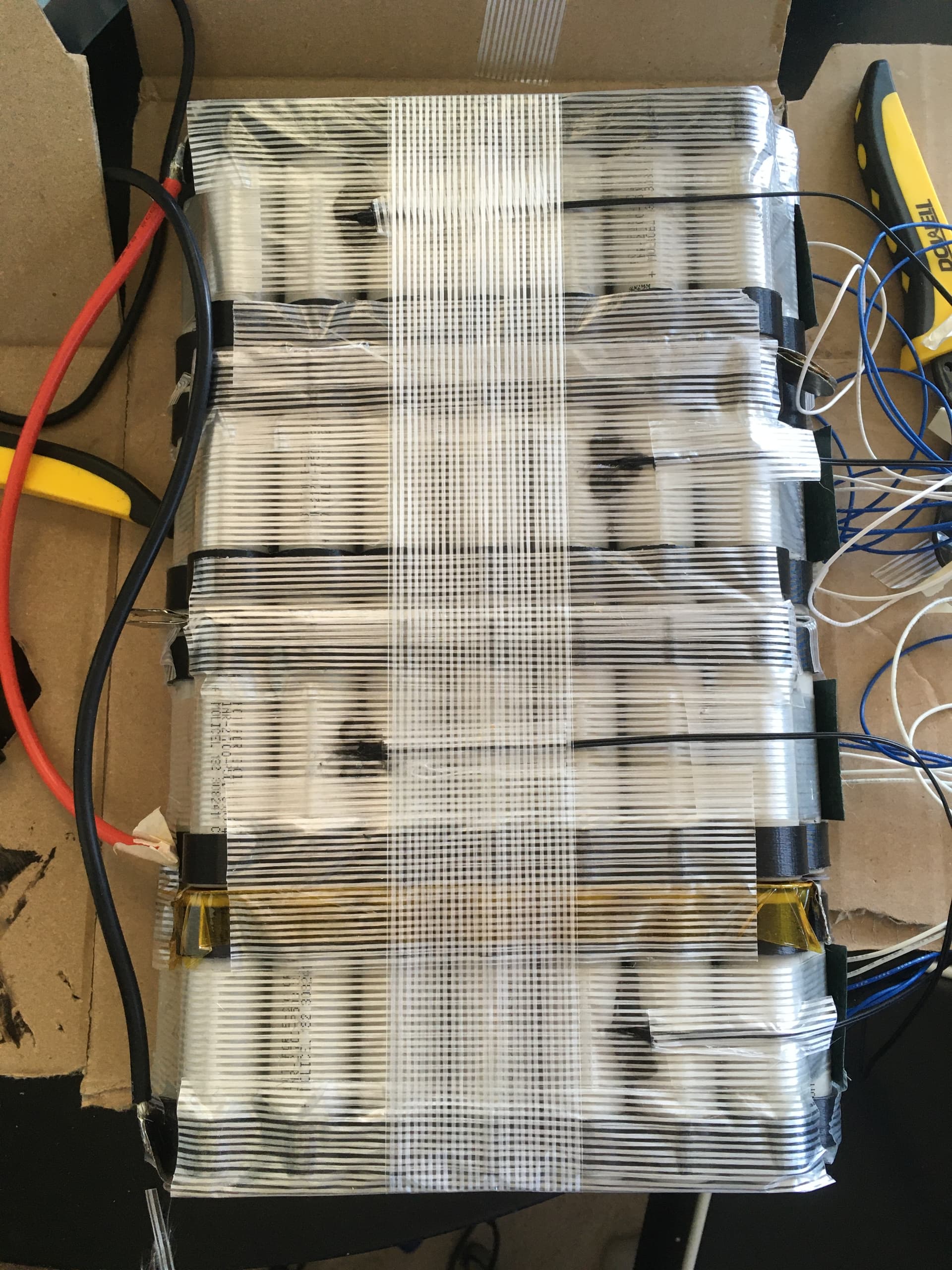

Built in four 5S3P modules. I doubled up on the nickel strips where the modules meet to avoid a bottleneck.
Balance wires with paper and kapton tape.
Four RTD’s. My BMS uses 2 so I have a couple spares.

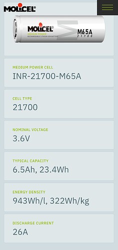

Any news about the p60b from moli that you have heard? I saw that they announced/released the M65A, and the specs are impressive.

About:Energy is receiving their samples any day now (if not already) and I’m working towards doing the same.

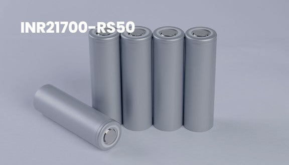

The Reliance RS50 should be in stock beginning of next month.for 5.95$

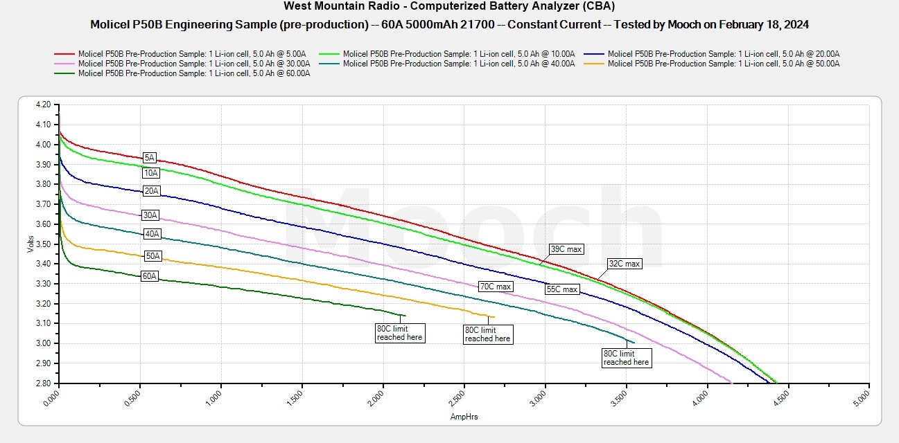

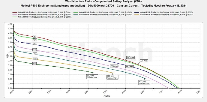

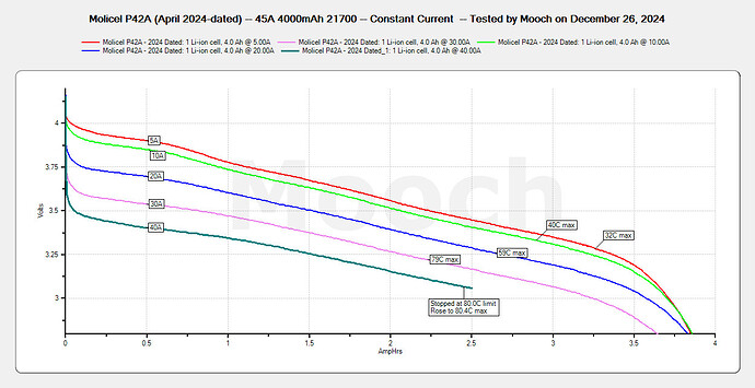

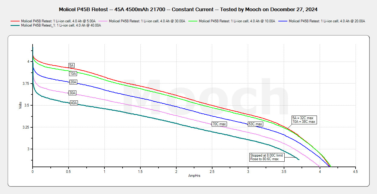

One thing that I dont think we talk about enough in the battery builders club is delivered capacity (mAh or Wh) down to our cutoff voltage.
Most cells are rated with a 2.5V cutoff, and all their capacity ratings are based on discharging all the way to that cutoff pretty slowly. But we dont do that. We discharge pretty quickly, and we set our cutoff at 3.0V/cell (or thereabouts, for most people).
So if you want to PROPERLY compare cells, you need to look at actual (measured) delivered energy discharge graphs, at the current levels you expect to use. Look for voltage sag, and the shape of the discharge curve. And most importantly, look for the delivered energy at the cutoff voltage you plan to use.
It doesn’t matter if a cell is rated for 6000mAh, if it sags to shit at the current you plan to use. In the same way, it doesn’t matter if a cell is rated for 6000mAh if it only delivers 4000mAh down to 3.0V cutoff.

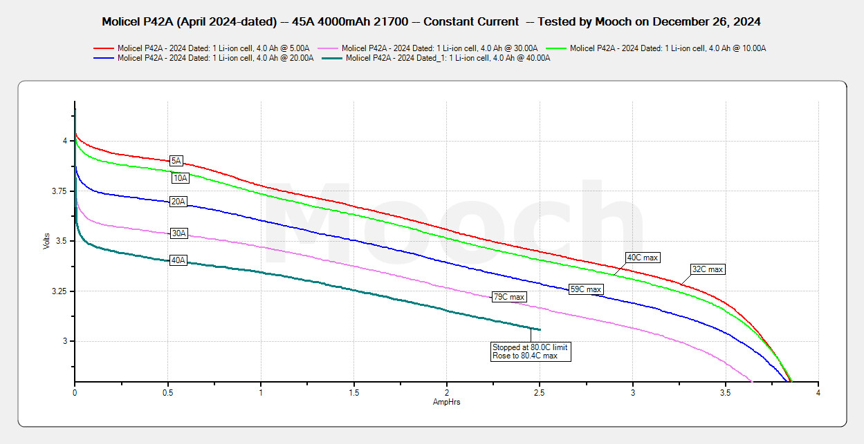

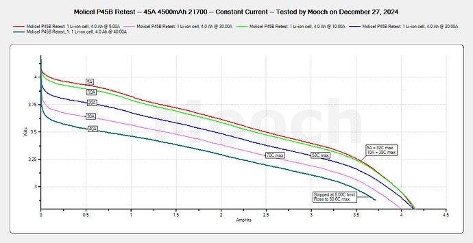

This is a lot more common than I think people realize. For example, when comparing the delivered energy of the P42A, P45B, and P50B at 20A discharge…
Look at the blue curve (20A) in all these graphs. And look at where that blue curve crosses the 3.0V line on the graph’s scale. That cross-over point tells you how much capacity that cell will deliver at that discharge current and at that cut-off voltage.
The P42A @ 20A discharge to 3.0V delivers ~3600mAh.
The P45B @ 20A discharge to 3.0V delivers ~3800mAh.
The P50B @ 20A discharge to 3.0V delivers ~4000mAh.
That’s not a big jump between each cell. Definitely less than the ~500mAh jump on those cells datasheets. Part of that is because some of the remaining capacity lives between 3.0V and 2.5V. This is not me advocating for lowering our cutoff voltages. I’m just pointing out that our cutoff voltage affects what we get our of our cells, and so you cant just assume you’re getting the full rated capacity stated on a cell’s datasheet.

Honestly im aware but have grass is greener or green eyes or maybe just eating the hype. My experience with the 50s cells in an 8p pack consistently provided 4000mah usable capacity at 25a a cell vs a p45b in a 6p pack at a marginally higher draw (30a a cell) which i planned to and should be giving up 3400 but is actually doing closer to 2800mah. Sourced the cells from a reputable supplier and confirmed weight matched the specs within my ability to accurately measure.
Whatever the deal is these p45b cells are significantly under performing for me. Measured wh output is 1.1kwh and i tried to build a 1.5kwh pack which 18s6p p45b should have been able to do.
Temps are amazing but i was trying to thread the needle for 35-40miles of range and im consistently rolling in to charge at 30-33 miles at 3.2v or less. If the performance of the tabless cells is an improvement, at a lower price point, and higher safety factor; then im gonna try em.
@Battery_Mooch i actually have some of the p45b cells leftover from this order fresh and unused but just kept at low storage voltage since the build. Would you be interested in testing a couple of them if i sent them to you? I know they are old news and you are plenty busy im sure but they really do seem to be performing under spec OR im doing my math wrong OR my usage telemetry is inaccurate (vesc and megan).
They just don’t seem to be doing what they should be doing. Maybe i got a batch of mistreated or counterfeit cells? Maybe im just a whiny baby who wants too much from the cell idk
What are you charging to and from? That does seem low. I’m pretty sure a full charge on 18s4p p42 is like 900 Wh for me, and if anything, I’m averaging higher draw and actually higher consumption. I average like 45 Wh per mile and get about 20 miles of range if I’m really hitting it.
Maybe my maths is off, im charging to 4.2v but it settles around 4.18v. Then i am also running to 3.16v for the 33miles of range. That’s probably my oversight. Let me put all my math down here for a little community audit:
P45b 18s6p 30a a cell or 180 battery amps max total for 2wd (90a each esc)
At 30a from 4.2 (settles at 4.18v after 20min resting after charging) to 3v a cell cutoff but 3.2v is where i usually stop to charge. Should be something close to 3.6ah a cell but im just gonna call it 3.2ah to compensate for my narrower band of usage
64.8v (nominal) x 19.2ah = 1244.16wh
27wh a mile light usage, 35wh high. Megan measured average of between 31 and 34 wh per mile.
Edit: my average amperage per side over 5 rides is 17a or 34a total or 5.6a per cell. Maximum draw is 180a peak total or 30a a cell for at most .5 to .25 seconds.
This should net me at least 35 safe miles of range ya? I thought this would be 35 miles of range with a buffer but im sneaking into charge at 3.16v at 33 miles taking the first and last miles hella conservatively
Did i miss something here? Maybe im not topping the cell up enough but i figured reducing my estimated cell ah from 3.6 to 3.2ah was going to create a better margin
Maybe i just need to set a lower cutoff end keep the cutoff start to eek out the last little bit of range
