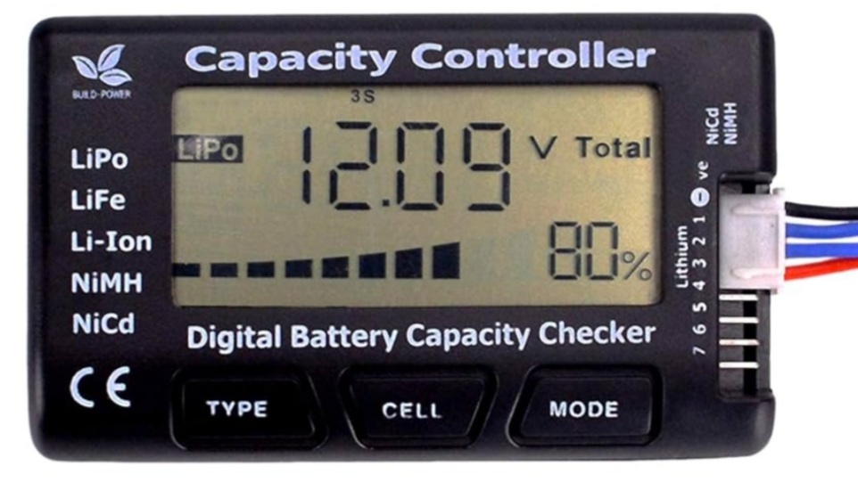

Twice when using it, I let the fan run until the bms kicked in, while also connected to this 7cell ‘capacity’ checker.
I didn’t see the exact moment the LVD kicked in, but sometime after the one low cell was 2.65X v, the other 2 were still 3.15v or greater.
I didn’t disconnect this ‘capacity checker’ though, and some 12 hours later or so that low cell was 2.373, the other two still 3.1 or higher
What I learned is the capacity checker’s drain, is bigger than expected, and there is so little energy left in a cell under 2.65v rested that self discharge and the smallest load can far too easily and quickly drain it below 2.5v.

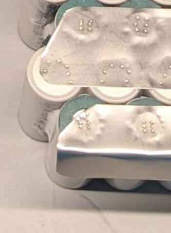

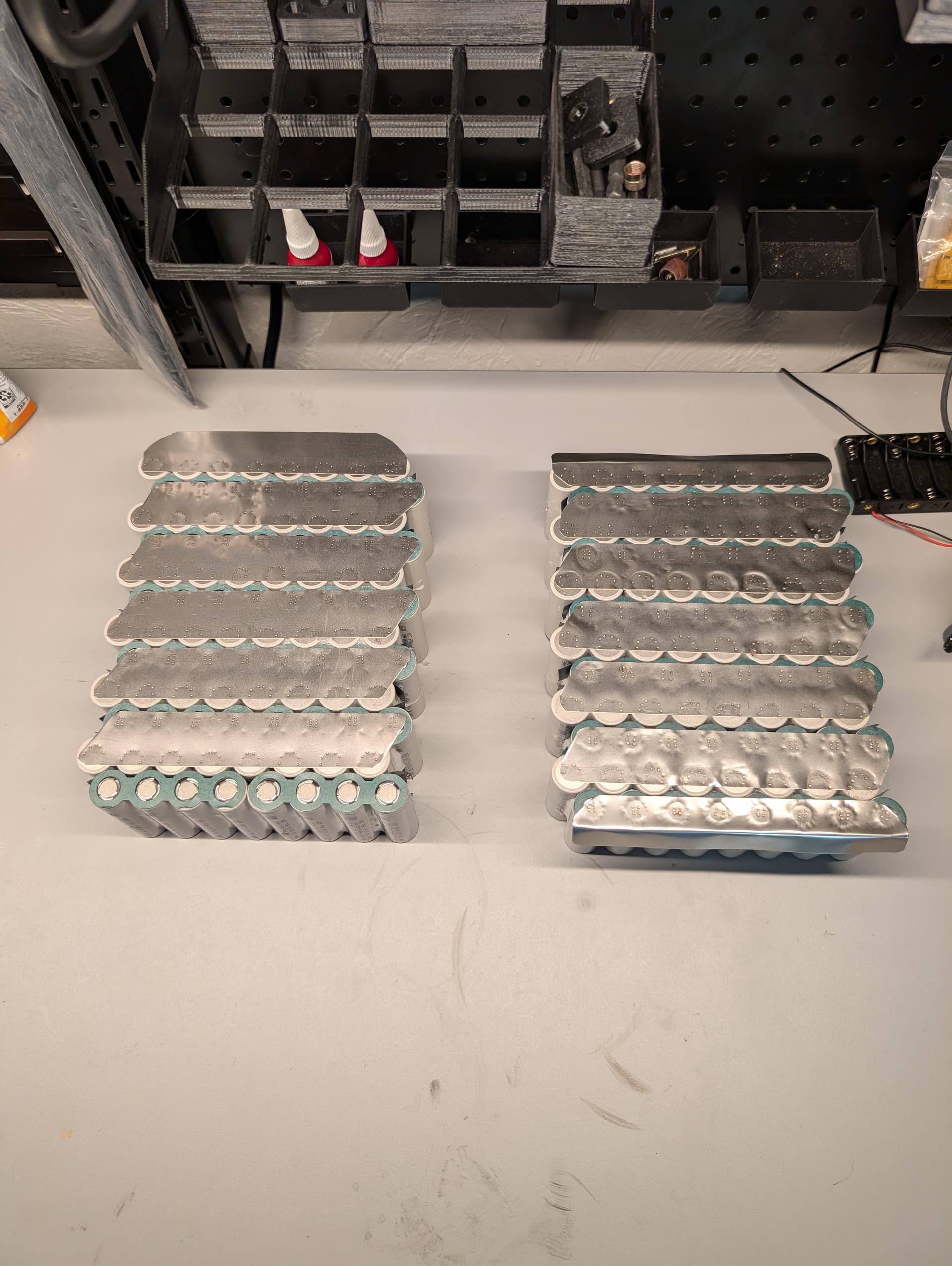

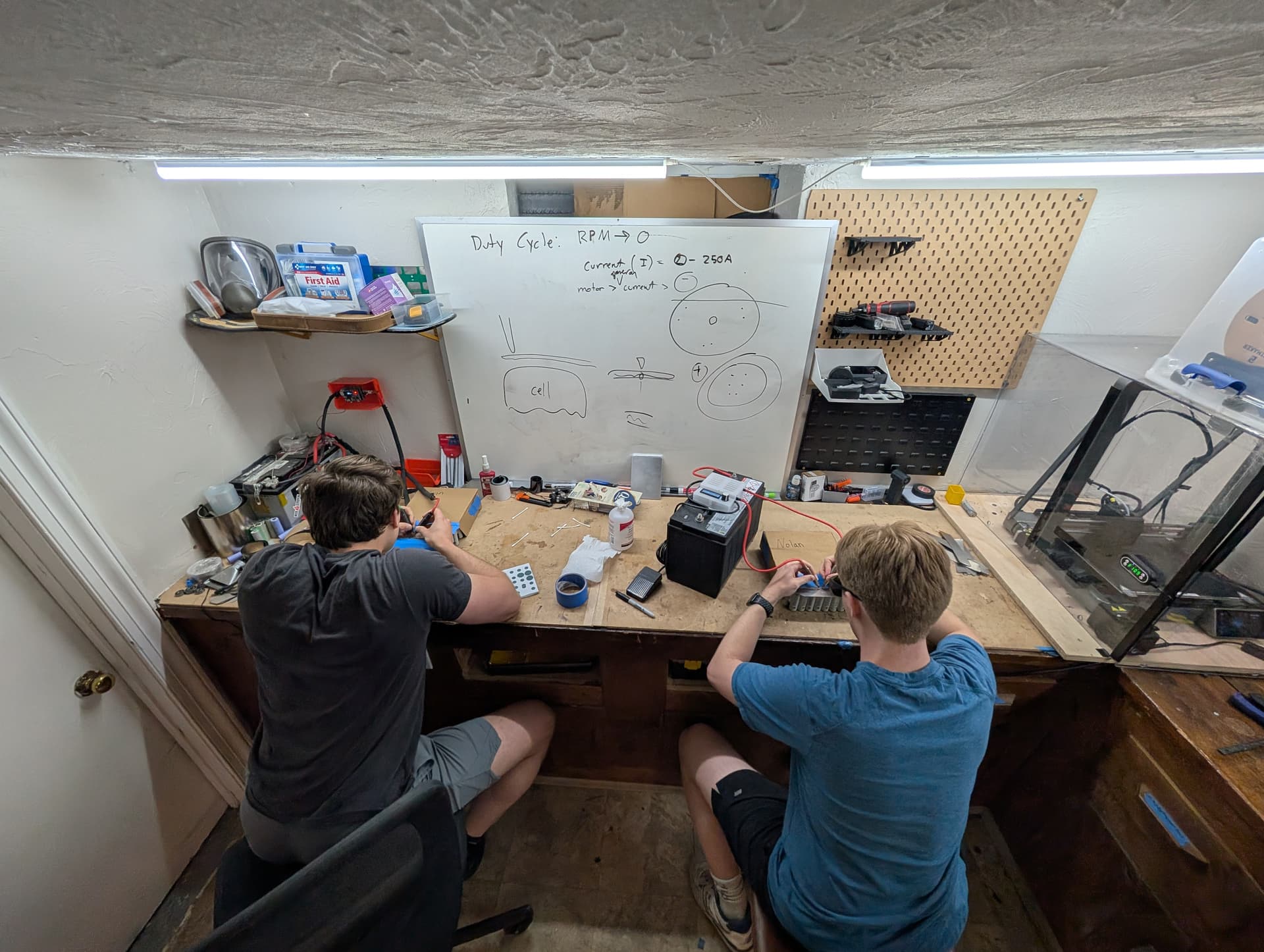

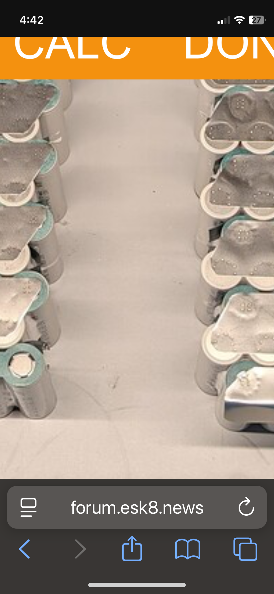

Big thanks to @Jmwilson22 for lending me your spot welder ! Being able to have these two guys weld side by side and share notes was a huge help!

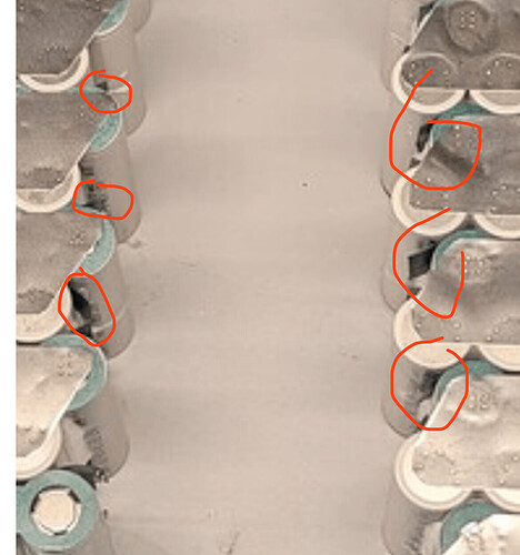

Is level 5 when u can just put a bit of fish paper between series groups?
on the right battery is there not even fish paper in between those pgroups?
Probably if there is fish paper here it is in the other areas of concern too. Just not visible from that angle
Ugh I knew this would get knit-picked. I promise there is a gap that will not allow the cells to rub. There are two strips between each pgroup I made certain.
It’s very funny I told these guys this exact thing would happen. This is why we post here. Gotta stay vigilant thanks everyone for your concern.

Super glue on balance wires, in potted lifepo4 cells aren’t going to possibly cause a fire in a crash.
Not using fish paper fully between groups… we can’t say the same. But you promise there’s a gap and they’re not touching with ur two strips. Bwahhh!!!
The irony is touchable.
