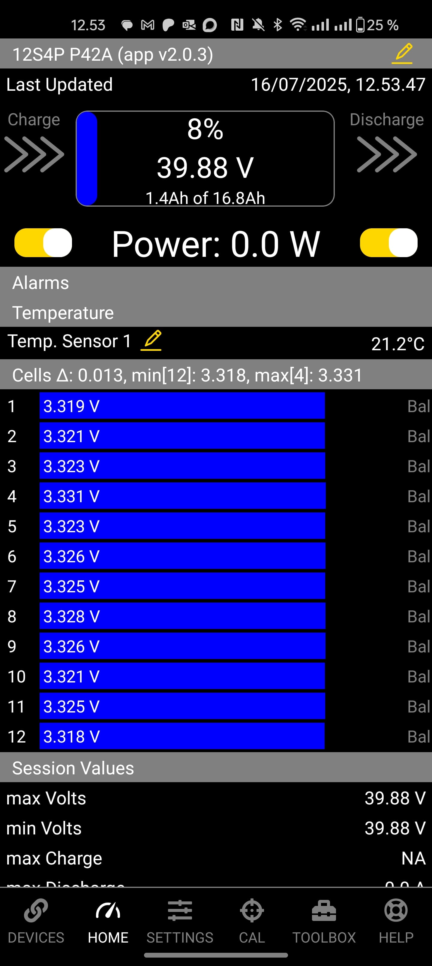

God I hate self discharge.

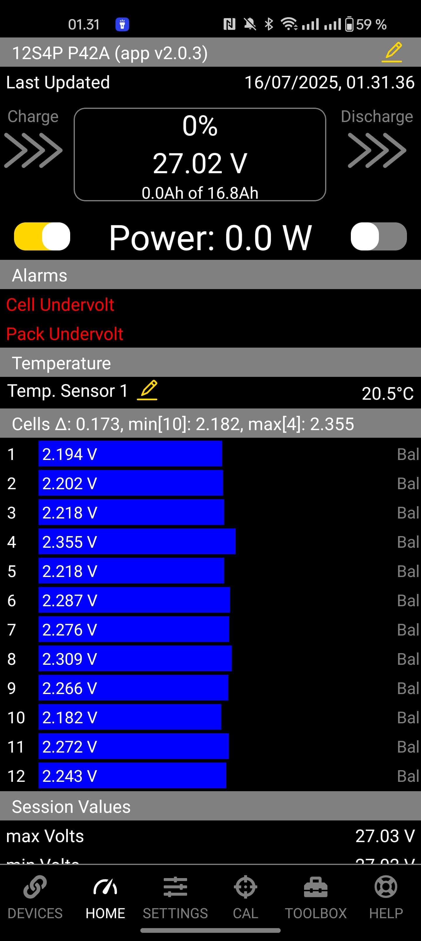

Lowest cell 2.18v so it’s not far gone.
Toss or revive? A couple weeks ago when I last checked it was like 2.65 per cell so didn’t sit too long below acceptable levels, but I know generally below 2.5 is no go.
12s4p p42a for a low power board, so it wouldn’t be abused in terms of discharge current.
Revive, it’s low enough to age but not below 2v a cell. It’s likely going to drop more if you don’t address it immediately. Charge at minimum current. As little as you can and get it back over 3v a cell. There is so little energy below 3v that even the tiniest drain can kill an ignored pack. That they are all still so balanced is a good sign though.
This is my opinion btw - i wouldn’t feel comfortable selling any pack that got neglected like this but i would run it personally
I agree with everything the banana man said

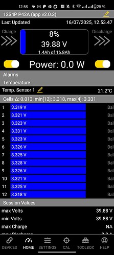

It’s alive! Had to use a 10S charger to be able to charge it. Went back over 2.7 per cell within a minute. By the time it reached 3.3v per cell it balanced out pretty well already so I guess it’s healthy enough still to run in this board!
That’s great and good save. Just don’t judge the balance in the middle of the charge though - top and bottom are where the pack gives you good information -
Because so much of the energy comes from the middle voltage range the difference between p group capacity can be a lot but only showing just a few millivolt difference. If the p groups were glasses of water the shape would be narrow bottomed and topped - you can see the differences in volume (stored energy) and have more precision (volt per watt hour) when you are in the narrow sections. Top it up and judge the balance there, then look at the bottom of the charge and just it’s health.
