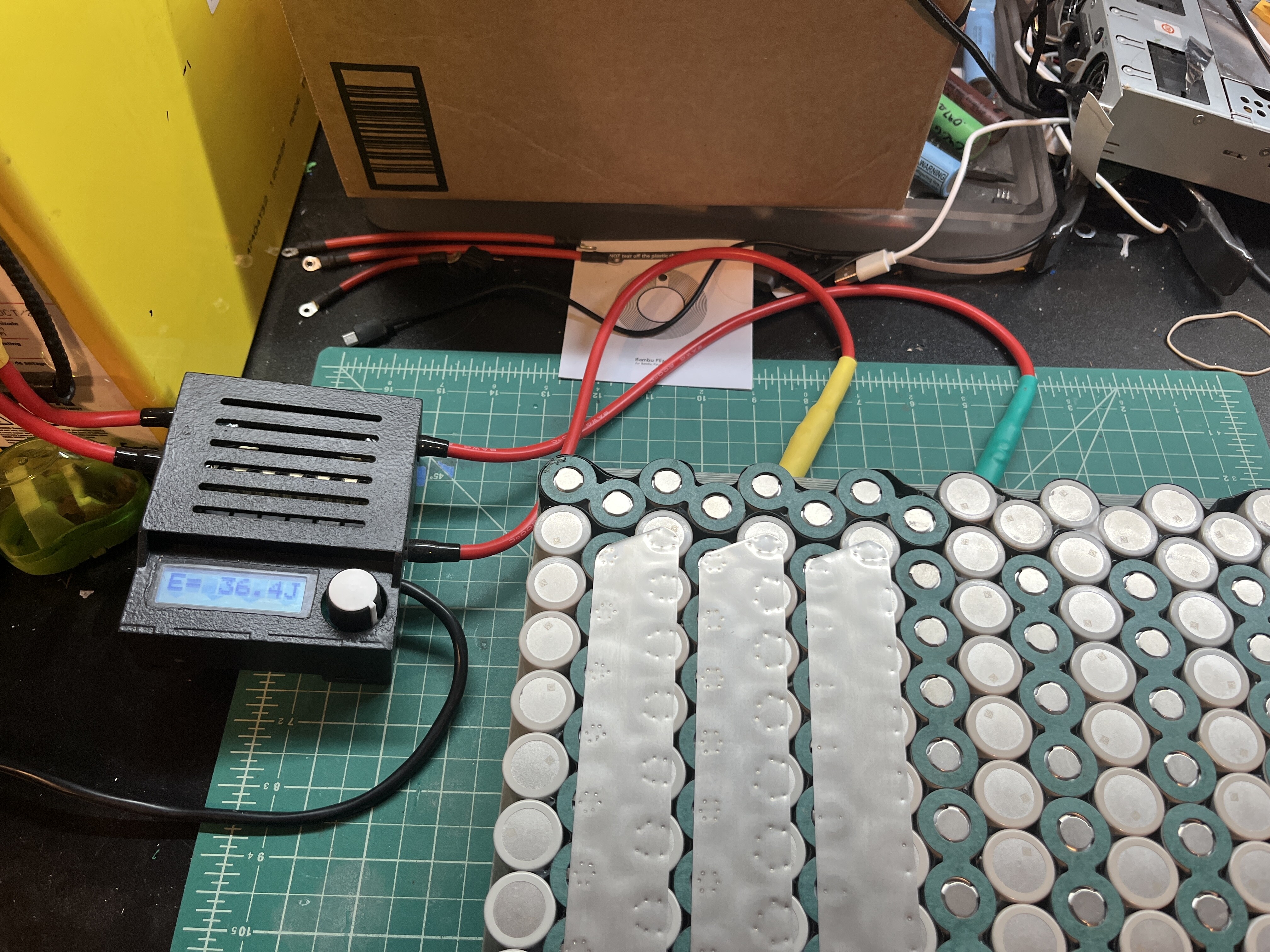

You probably can weld copper at least 0.1/0.15 with copper flux.
I tried with copper flux someone sent me to see if possible.
I was on the edge of successfully welding 0.15mm copper, using 0.1mm nickel plated steel sandwich method, with Infinite slot.
In fact I was successful, on a test cell, whose nickel plating was removed from multiple welds and pull off tests, and then the dremeling off of the copper bits, and scratching the steel casing.
The removal of the test welds increased the resistance, heat, and the chance of achieving a successful subsequent weld, and basically screwed with reality of the welder settings.
When I tried the same combo, welder settings and technique, on a new cell with intact Nickel plating, the welds looked good, felt good, but then ripped off way too easily.

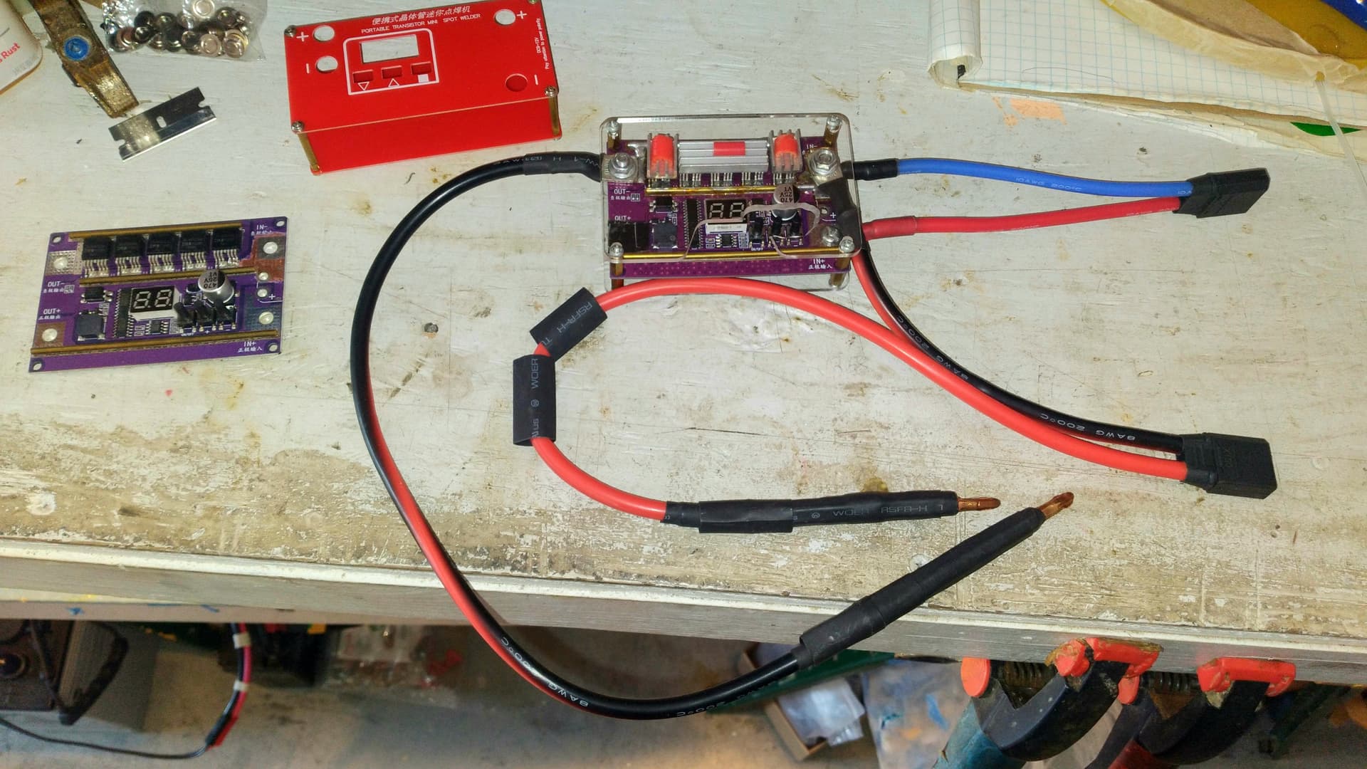

My welder is just a 21$ Purple piece o crap that used a low quality 3S ZEE 5.2AH ā€˜80C’ as the weld battery. I use a separate 12v battery to trigger its mosfets.
I succesfully built 3 small esk8 batteries with it, but using 0.1mm copper and 0.1nickel plated steel.
As the lipo weld battery aged, the pulses needed to increase from about 70, to 95, and the battery needed to be kept warm to very warm, and above 12.2v, and 5 pairs of welds would reduce its voltage from 12.42 to 11.98, and I’d have to recharge it after every 5 welds, and its 12 awg leads were disgustingly hot.
Its last few welds it was emitting the sickly sweet smell of leaking electrolyte, and now it sits completely discharged leads shorted, and awaits recycling.

My welder can barely do 0.1 mm copper with 0.1 nickel plated steel.
I’m sure 0.1 copper with 0.1pure nickel would be near impossible with it.

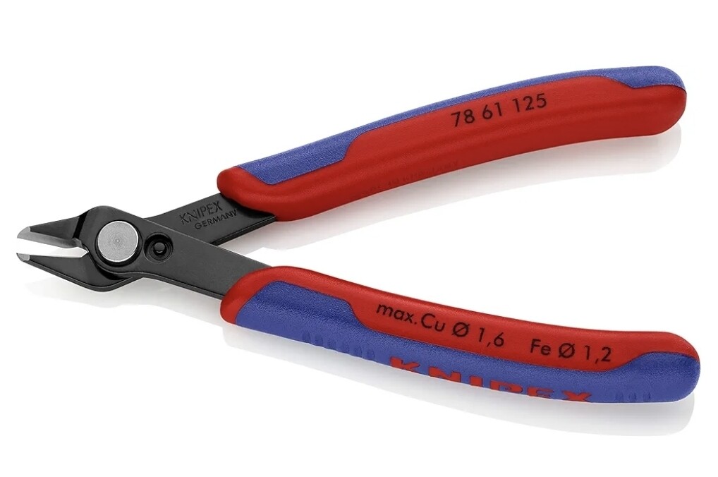

Knipex 78 61 125 are my cutters of choice. They offer a truly flush cut and have very hard steel jaws. They work pretty well for clipping the remaining nickel spot welds down flush.
They definitely have a better cut quality than some of the cheap Amazon specials

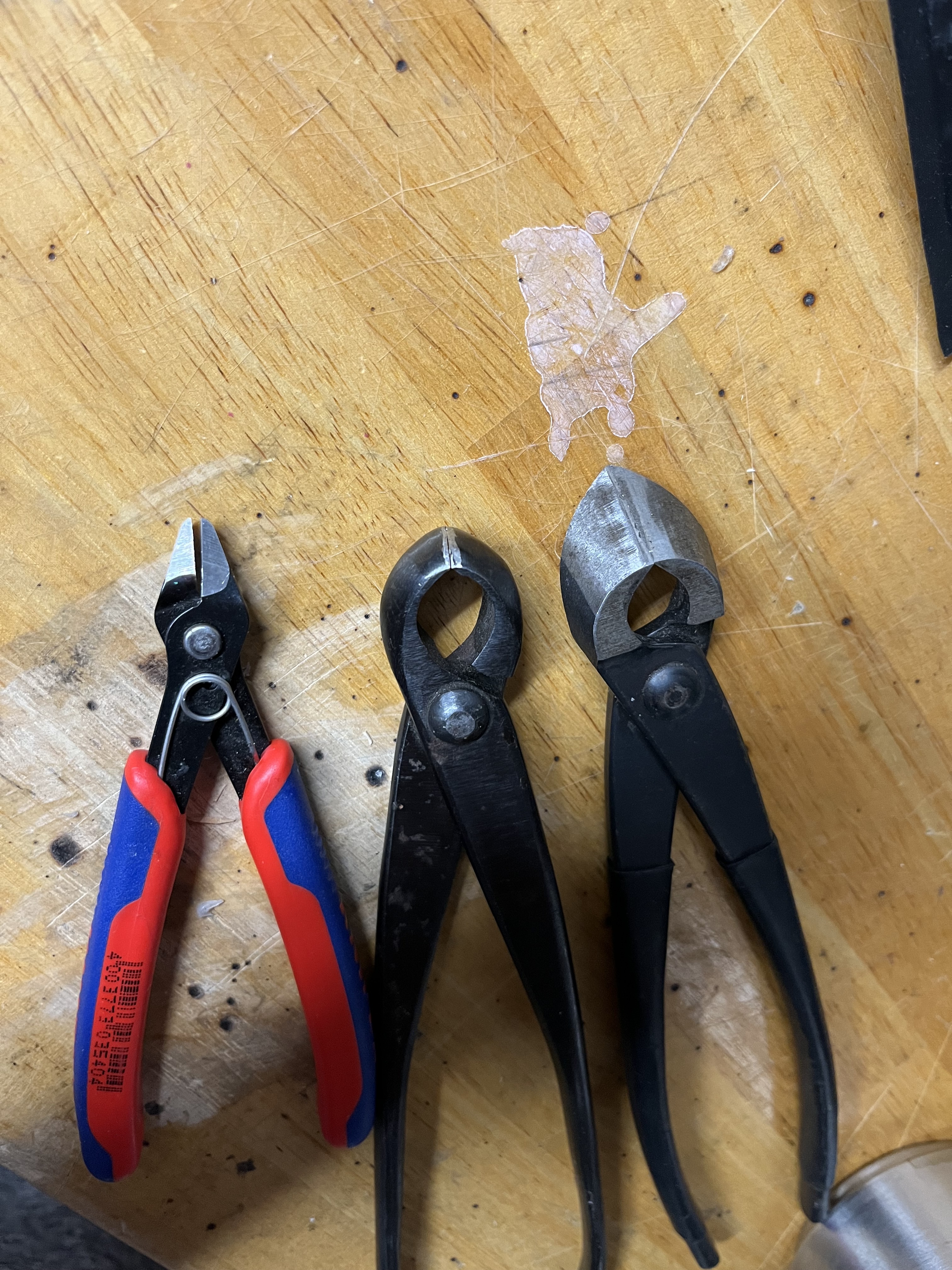

Something i didn’t include are some of the tools that i use and those knipex flush cutters are some of the best ive ever used.
Also i use a set of bonsi nippers and ball cutter:
My advice in addition is to be absolutely anal about deforming the negative. Do everything you can to prep to make the negative come off clean and not apply any pulling or leverage against the negative side. I go so dar as to thin the weld with a dremel before cutting or removing. If you break a cell and vent the electrolyte : do not breathe that poison. It’s worse than you think for you
Awesome thank you for the input and for the tools. And yes those flush cutters are on another level.

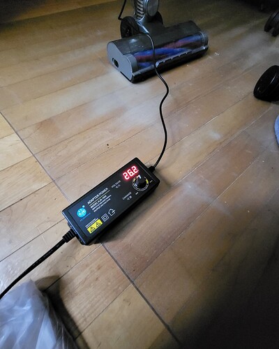

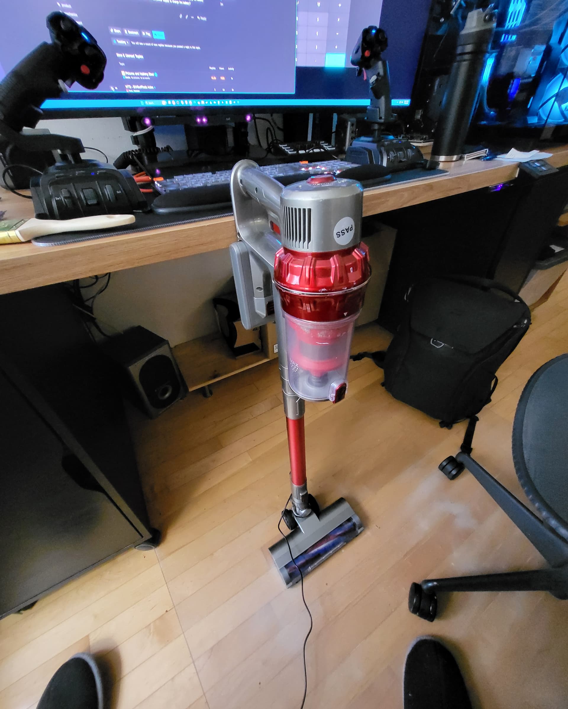

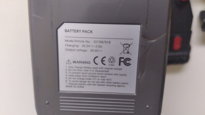

I’m not sure if this goes here or the noob question thread, apologies if it’s in the wrong place.

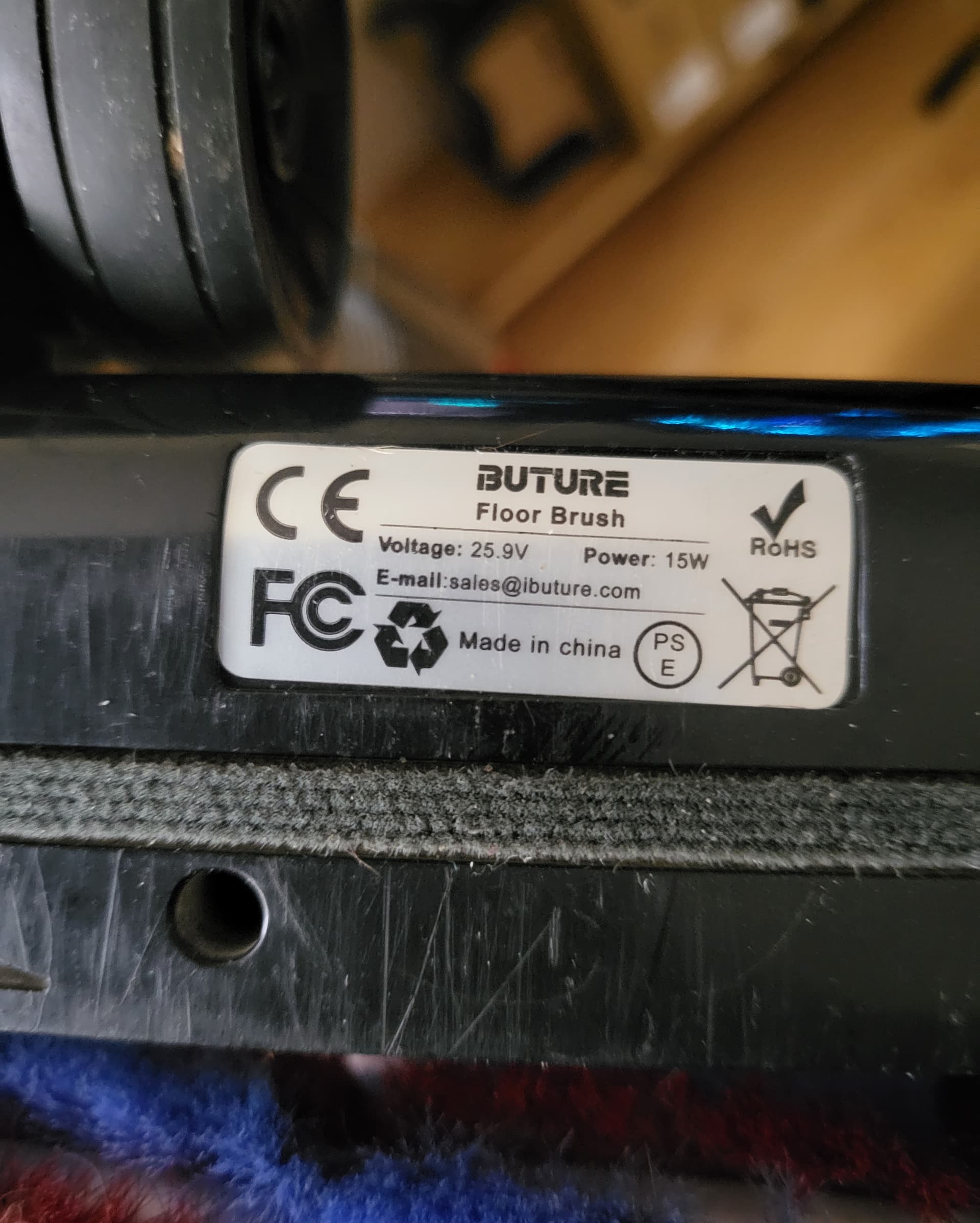

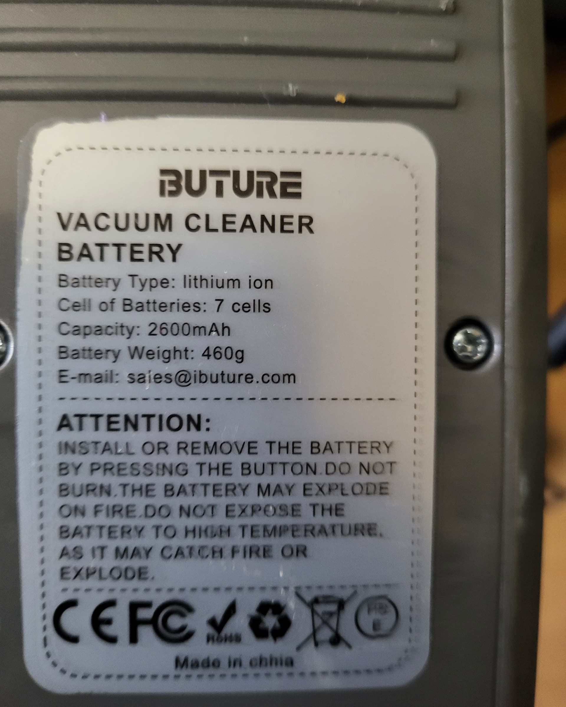

I have a cordless vacuum (Buture). I’m not sure of the model because the company has discontinued it, so there’s limited information on the website. The problem is that I need a charger for it. The only info I could find is printed on the battery pack
7-cell Lithium-ion 2600 mAh, there’s a sticker on the bottom of the unit that says
Voltage 25.9 15 Watts
I have an adjustable power supply, 3-36V, 60 Watts. When I plug in the power supply, the battery will only allow around 27 volts. Can I use this power supply to charge the battery?
i got a 7cell vaccuum,
super slow charging.
says 32v charging.
I measure 32.15v unloaded.
I suspect Diodes reduce max voltage to 29.4ish, or they just completely rely on BMS to disconnect when a cell reaches 4.25v, or both.
Thanks, I’ll keep an eye on it while charging
What does ā€œthe battery will only allowā€ mean?
that PSU looks like an adjustable voltage 1.5A psu.
but not a CC/CV bench top supply?
so i’d expect if setting it to 7s*4.2v = 29.4v and the battery was low enough you might try to pull so much current from the PSU that it shuts down. (or burn out)
on the other hand if it does do current limiting to 1.5A, then it would drop the voltage, and you would see that even whe you set it to 29.4v it dropped to something lower to keep the current limited at 1.5A… ??? I’m guessing i’ts the former tho. as this case woudl be less common for a psu that didn’t mention CC/CV.

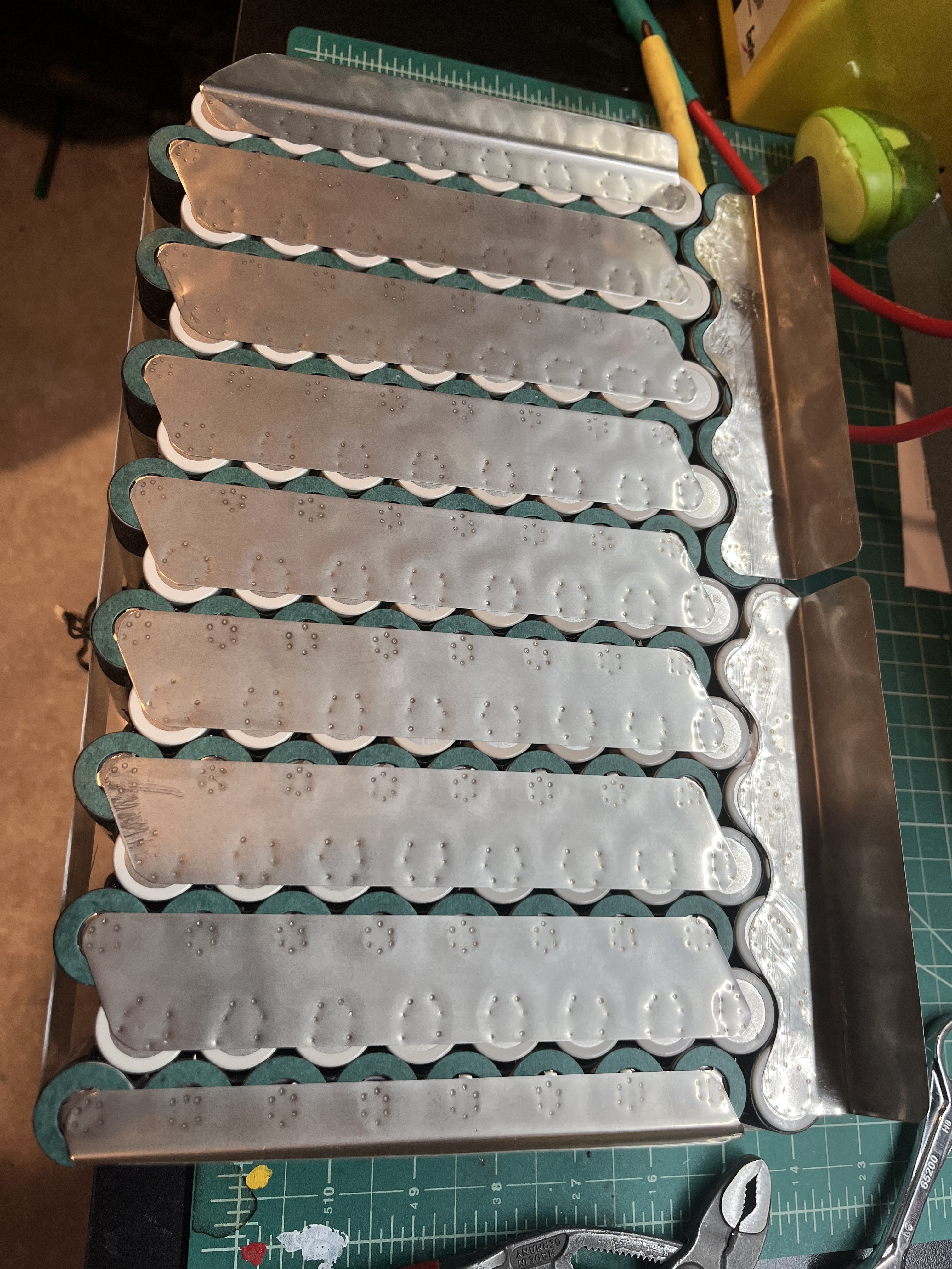

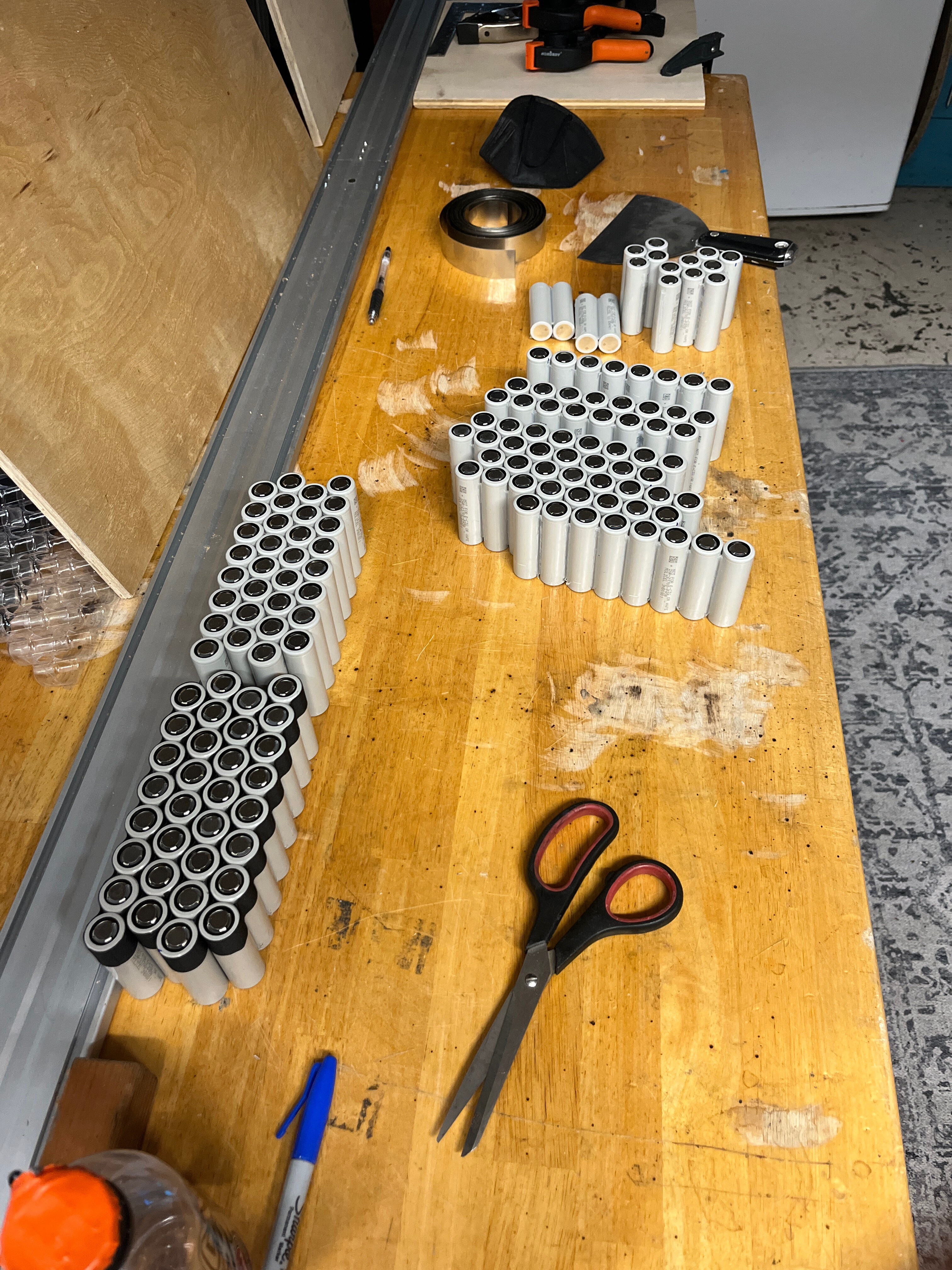

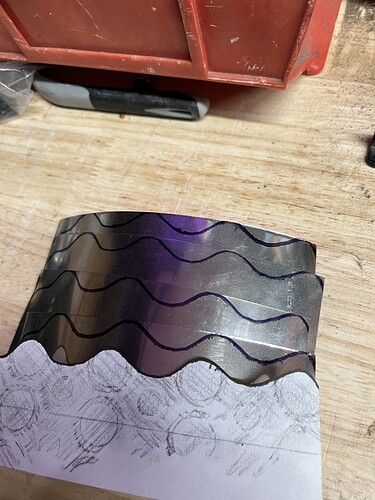

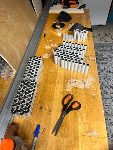

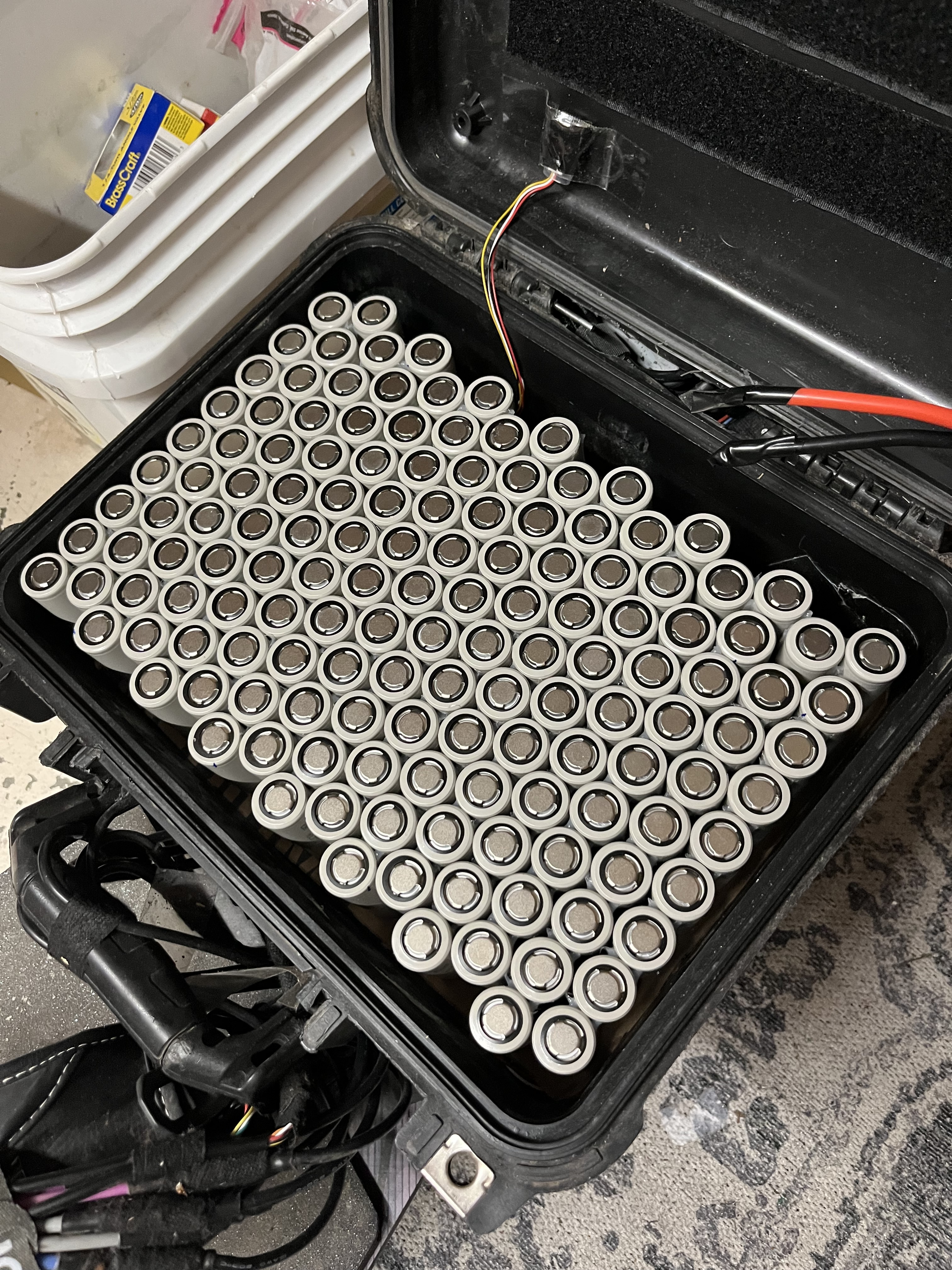

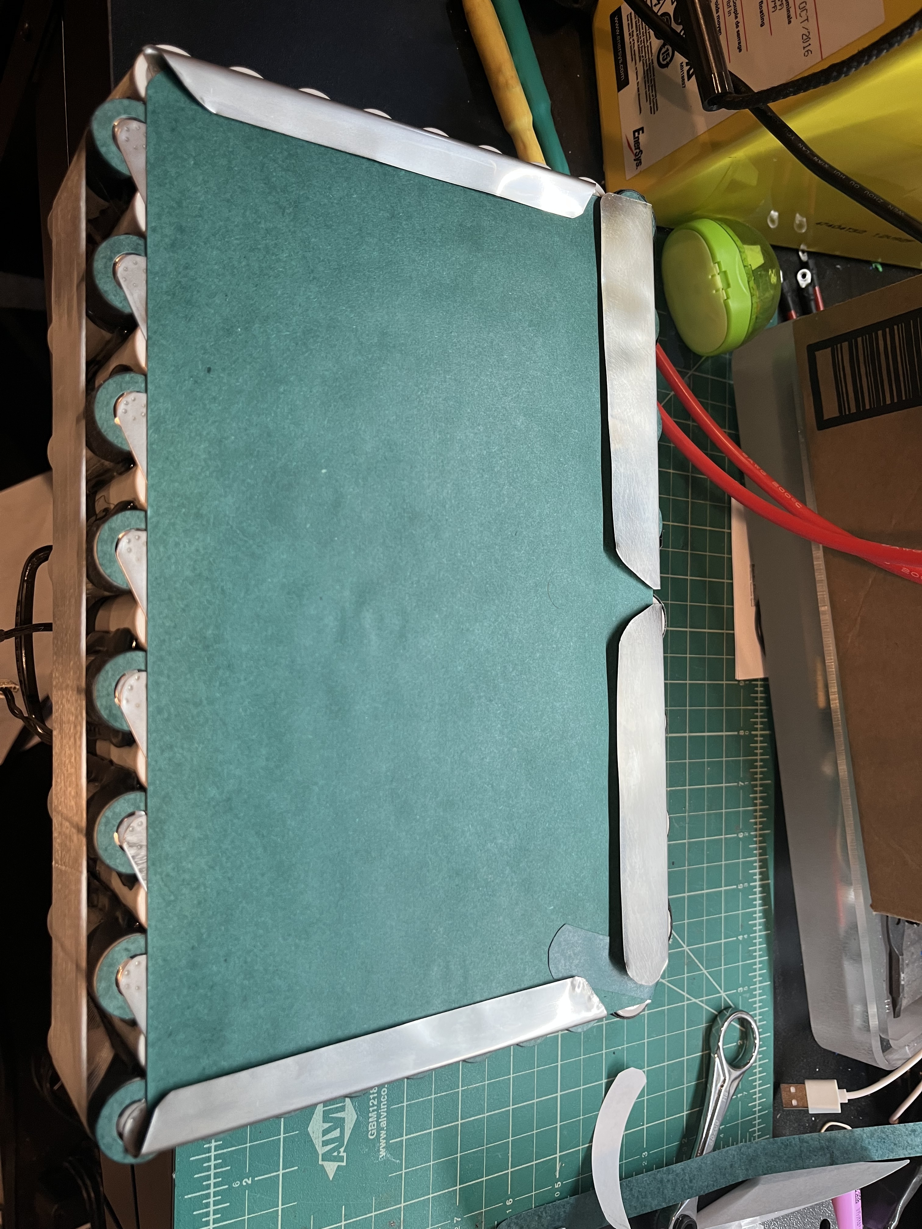

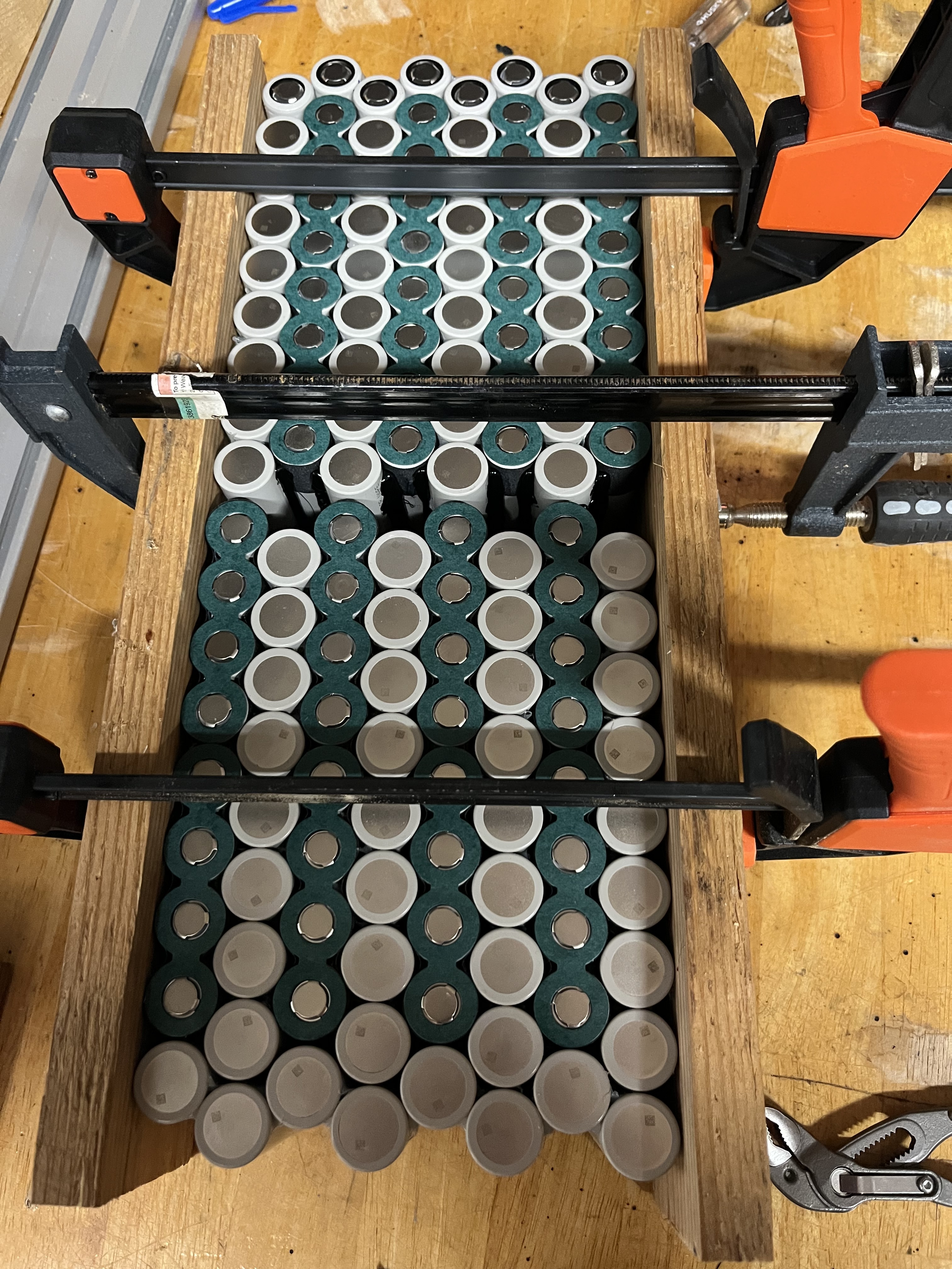

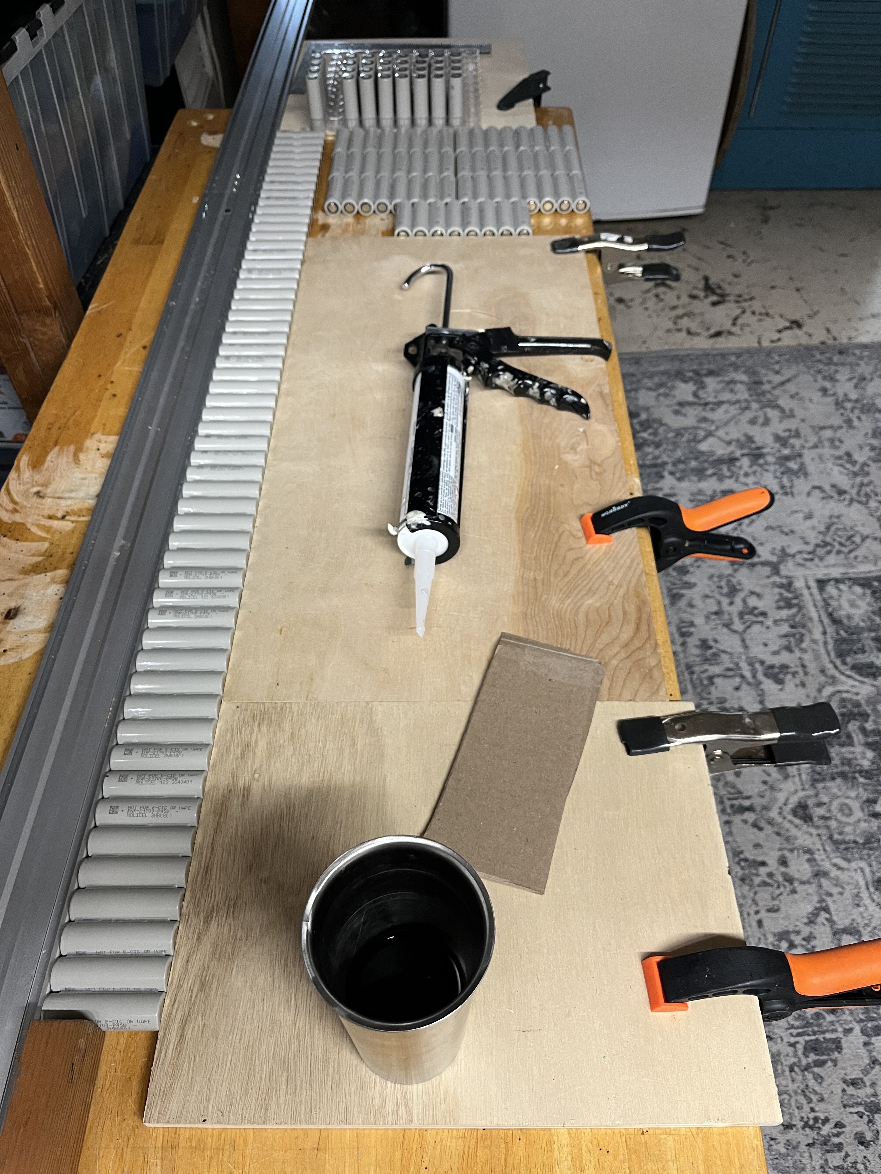

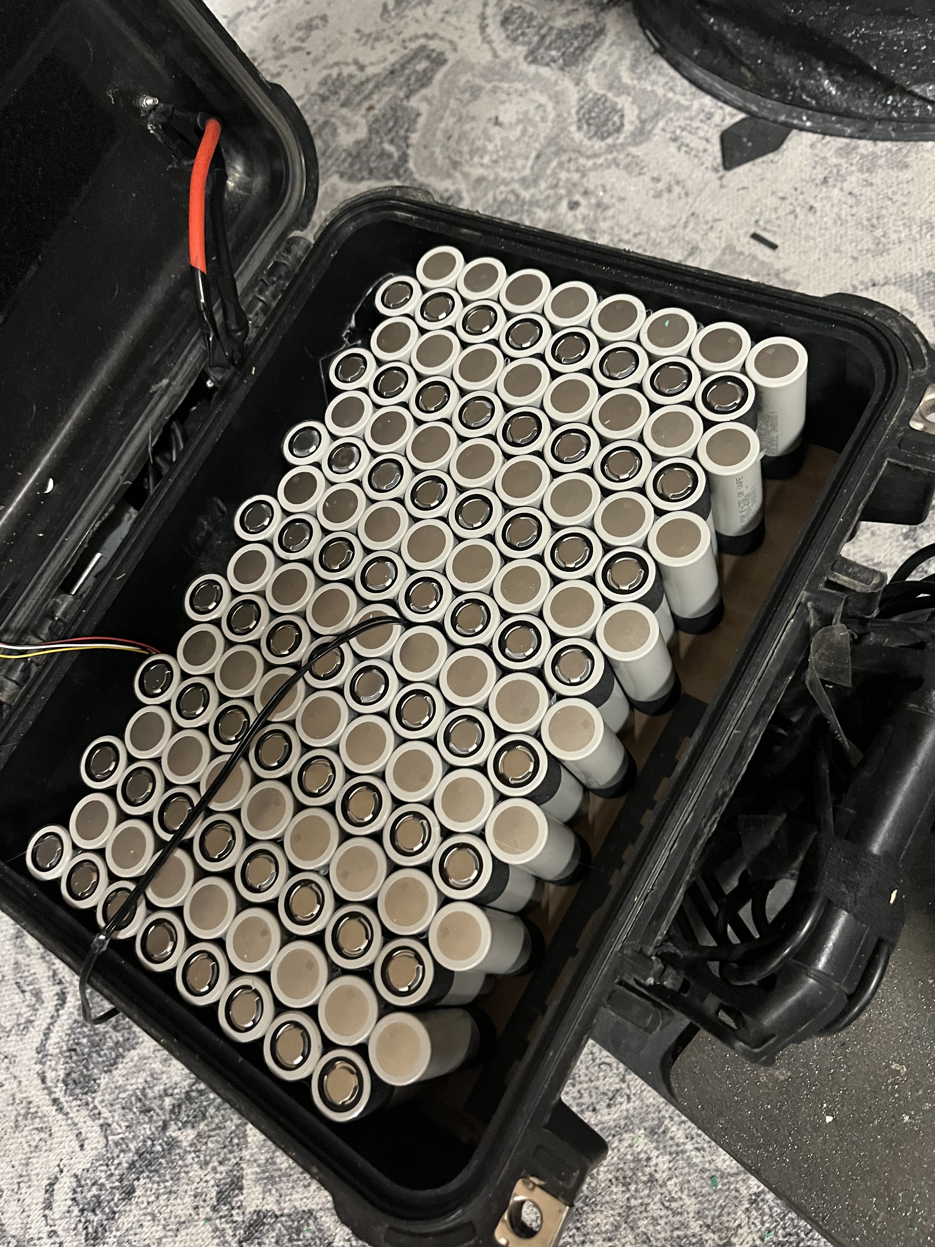

Just dumping some photos here: 18s8p brick to replace the 21s6p that got dented from michaelwa’s 50mph crash. Thought i was going to have to do some funky second layer bs but i was able to sneak all the cells into one stager stack brick with group 1 and 18 turned 90 on the end.
Turnings out pretty clean - insulated with tesa tape except the end groups which have fish paper between them and the rest of the groups. Lots of silicone - thermal adhesive on the temp probes #1 in the center and #2 on group 1 between it and group #5. Doing the danger welds tomorrow or Tuesday if im over subscribed. Might be squeaking it in before carve but im trying not to rush anything.
Yeah, no more 21s for me. I need to be able to free spin it to check for issue. :joy:
The power supply unplugged will go to 34-ish volts. When I plug the power supply into the battery and turn it to max, the read out will display 27-ish volts. It does not shut down. After a little while that reading will increase from 27 to 28.2…28.5…and so on. I turned it off at that point because I didn’t know what the hell I was doing.
correct, I don’t think it’s a CC/CV power supply.
