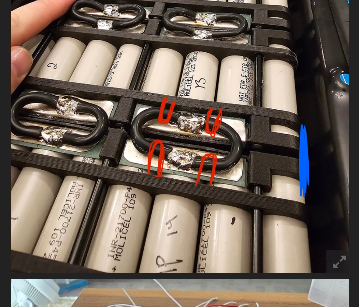

Here’s the 3rd battery that I have built. I have been running it for a little while now, but figured i’d post it here. Just looking for any constructive criticism or advice for future builds. I designed this pack in fusion360
The pack
  • 14s8P
  • Molicel p45b

  • 3d printing material, pa6-cf was selected for its high layer adhesion, strong impact resistance and high heat deflection temperature. I spent a lot of time tuning in the filament profile and tweaking print settings to get the cell holders as strong as possible given the enclosure size constraints. The cells fit very tightly and need to be firmly pressed in place.
  • 8 spot welds per cell (avoid center of negative terminal)
  • kweld was used, approx 1550A on the welds, I forget the J, between 40-60 I think
  • series connections protection - I do not like the though of series connections being pressed hard up against the other side of the deck. For this reason, I had them recessed below the top of the cell holders. to further increase protection, I added the balance wire guides to the top of the cell holders. these are both glued and mechanically fixed to the cell holders with m1.7 screws. These were an afterthought and could be printed in one piece next time.
    I have 1/8" closed cell foam on the bottom of the enclosure and the underside of the deck. this is used as vibration mitigation and to take up any point loads that may occur. when the enclosure and deck are assembled, the cell spacers are clamped firmly by the foam, top and bottom. there is no load on any wires.
  • everything is mechanically held in place. heat sink is bolted to enclosure, vesc is bolted to heat sink, bms is connected to the vesc. I wanted everything inside fixed so that fatigue on connections over time is reduced.
  • balance wires run through, the balance wire guide to minimize risk of crossover or rubbing. The wires leaving the bms are laminated in clear gorilla tape. Not my favorite detail, but I wasn’t sure what else to do. balance wire organizing can be tricky.
  • typical cross section of the nickel is 55 mm x 0.2 mm. The one connection at the back of the pack is (2) 32 mm x 0.2 mm. Looking back on this, I wish that I increased the nickel thickness given how robust the rest of the conductors are.
    I have the temp sensor from the bms resting against one of the nickel connections so I can monitor the temp (kinda). I have thermal epoxy that I am going to use to couple the temp sensor to the nickel ( eventually, next time that I am in there)
  • I think the cell holders being “open air” is a good thing for heat dissipation. The afterthought is that I don’t think that I can realistically heat a 8p p45b pack up significantly. Although the cell holders are extremely tight, maybe glue/silicone could be used to further stiffen the packs and mitigate more vibration. The “open air” design might be more beneficial with lower P count or lower quality cells more prone to heating up. The again, everything is stuffed in an enclosure anyways though, not sure how much heat can even dissipate. Maybe the cells still reach the same ultimate temp, but more uniform, and less hot spots? idk? either way, with this battery config I don’t think it really matters. I think my riding skills and the nickel are the bottleneck for heat in this case.
  • don’t think that I mentioned it anywhere else, but (6) M3 standoffs are used per p-group. M3 bolts are used to clamp the ends of the p-groups together to keep things tight and separated.

Just a small preference thing but would there be a decent improvement in current capacity from separating the series connections? It’s a fairly small cross section of 0.15-0.3mm thick nickel on the edge of where the wires solder on.
Future proofing wise those batteries are rated to a total of 360A and controllers could get to that in 4wd, or as it is now I’m a little afraid of long hard use of battery amps with all the load and heat in one little area melting the solder.
they technically are separate, but i understand what you mean. I should have stripped back more insulation and splayed the wires out a bit to get a more intimate contact of wire to nickel. something like this sketch below. pardon my terrible ms paint skills
I think this explains what I mean a little more
I can already see someone editing one of those to look like something else
ah yes, that too. ideally both concepts are applied. thank you for the input, I may update these connections if i get bored haha
I love this and i think youve done really well. My two suggestions/ponderings would be as follows
In red: little tabs that bolt/screw on after soldering to provide strain relief to the joint while still allowing the pack to flex
In blue: for rigid packs, something to bolt the sections together
Are the cells secured to the holders or each other at al? I repair quite a few manufactured and diy pack where the cells can slide around in the holders (By tiny tiny amounts) and eventually break the nickel or welds. If still trying for an air gap just use a dab of silicone maybe against the holders.
This is usually after a thousand miles or so but the vibration adds up to work harden the nickel and crack it if the cells are only secured by tension and nickel but i haven’t ever seen it on glued cells
That’s good knowledge to have. And something I have worries about. I feel fairly confident since the cell holders are tight and the end caps are bolted on.
The original design was so tight that I was shredding the wraps trying to get the cells in. When I updated the printing tolerances and parameters, it was basically as tight as it gets without shredding the wraps.
Also, the m3 standoffs are shorter than the cells. So when the end caps are screwed on tight, they are putting the nickel cell assemble in compression.
I think about the nickel welds as a moment weld though. Aka 0 tolerance. So if cells want to move at all, even if .001 mm, then the nickel spot weld is experiencing a small loading condition.
I would imagine that my cells are held in place as well as a pack that was siliconed together. Obviously I have no scientific way to measuee such a tiny movement or force.
Not sure if that makes sense or I’m just rambling, but I don’t think the cells are moving.
Each p pack is not physically tied together. But the friction fit in the enclosure is significant, the whole pack or p packs are not moving around at all.
Also, the deck enclosure setup is stiff. Maybe not as stiff as a carbon tub board like a meepo hurricane, but it is not significantly flexing. Just a little bit
