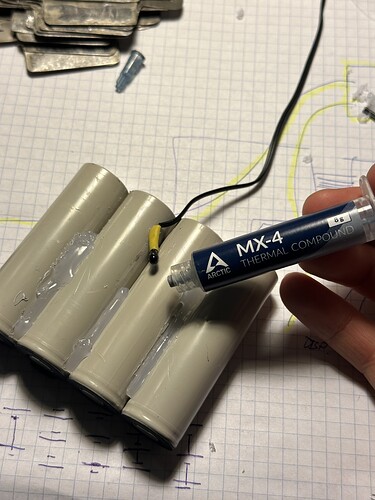

BAK45D 10S2P. My third battery build.
0.1copper,0.1 nickel plated steel sandwich.
Trying to attenuate soldering heat into the cells with a mosfet thermal pad, and a heatsink and a clamp.
The finned heatsink does warm up, so it works, to some degree.
My TS101 soldering iron, fed 25.3v from a 7s battery held there via a V booster, is able to suck up 80 watts.
The thing is a beast. FAST. Was using 400C, but dropped it to 380C as it was faster than me.
Loving the ceramic tweezers.

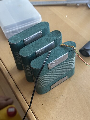

My Zee 3s 5.2 ah weld Lipo hard case battery , bought Dec’23, had near perfect balance, and no significant self discharge, no puffiness, but developed a sickly sweet smell the last few welds.
I had it on a 100 watt 10 OHM resistor with extra heatsinking overnight, 14 hours night, outside on brick pavers under a metal bucket, and it now read 0.000v after resistor removal, but it rebounded to 1.034v after an hour. I put resistor back on and it back outside.
The hard case is puffed now.
How dangerous is it still?
Once it gets to low/no voltage I would short it and recycle. Without any potential it should be fine to recycle safely. No voltage and not punctured is as safe as it can be afaik

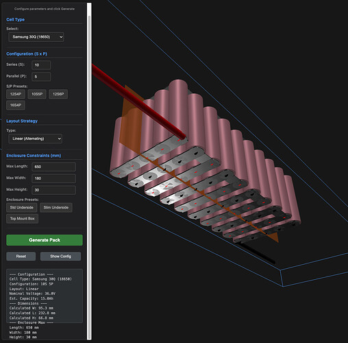

Can I weld copper tabs onto batteries and join each with 3x M4 nuts and screws? Or is current capacity and vibrations an issue? Flex isn’t a concern.
Being able to disassemble the pack and take in a case as carry-on luggage is the only way I can see to get to a race or group ride in the future. And it would be great for ground clearance.
Honestly as much as I usually prefer liions, I think you should give lipos under 99Wh a consideration for a flight safe pack. Maybe like 4S 6Ah lipos and run a 5S2P harness for a total of 20S 12Ah.
Especially since it seems like you’d be going for a 20S8P? There’s a limit on how many batteries you can take with you even under 99Wh and it depends on the airline. Some airline policies for example allow 20 batteries total but that includes the battery in your phone too. On some you can take 20 spare batteries. On some you can only take 12 spares, etc. And also it’s up to the security guy’s mood to let you pass, lipos are something he sees more often than a custom liion pack so less chance for trouble. Also keep in mind some airlines have weight limits for your backpack but not all do.
19S8P there would just about fit, 17S8P would fit easily, be lighter and I can keep a Ubox.
good catch I didn’t think of that, and the remote too.
I would try double check it with the airline customer support beforehand and do a nice job with a case and having it all excessively protected and tidy. I think I would have to be very unlucky to run into problems while making an effort to be as compliant and safe as possible.
To be able to completely disassemble I want to use crimped connectors screwed down for the power leads and middle series connection incl loopkey. Maybe washers soldered onto the balance lead for the bms?
I have definitely considered LiPos and I use them for misc stuff they are near bulletproof and powerful but being both twice the cost for the capacity and ageing faster is a dealbreaker on this scale.
My current esk8 is very stiff largely from the unsegmented cf enclosure and I could router a thin slot for flat bar into the next deck and I’m relatively light so flexing shouldn’t be an issue.
I am really just concerned about a poor connection between the copper tabs, 2 sheets bolted together in 3 places should be great but residue and debris or an angle and bend could make the contact area tiny. Or vibrations and looseness making it arc or drop connection for a moment.
