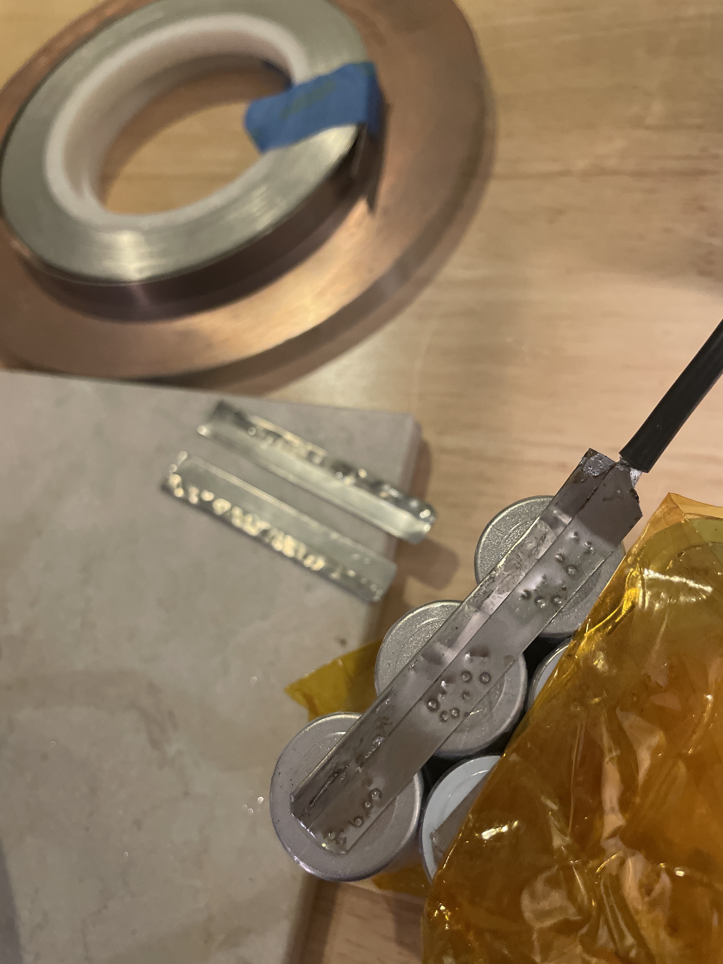

Ok check my work as im getting to the point of pita to roll back and correct my work, shooting for 100a continuous and burst to 200a pack and my bottle neck is in the p group i had to make in a shitty layout.
18s6p p45b with major space constraints because i want to use what i have for the enclosure.
Solder isn’t complete just in place so I don’t have to pump too much heat. Just doing a little then letting it cool and going back.
The 1, 7, and 13 p groups are the elongated non standard ones. The outside most nickel is 35mm wide .2 and is soldered to the long braid under the pack with #10awg equivalent tinned copper. The nickel here should be good for about 60a easy but 100a in bursts so should be fine to move the current from those two cells.
The braid attaches to the lower wings of the center pair of cells (parallel) which is 30mm .2 and is now carrying the current of all 6 cells and stacked with the 35mm .2 that is on the top of the pack that butterflies open.
Because of how i needed to run the braid underneath i didn’t make the nickel at the center connection for the outside two pairs go both ways like i did for the center two cells and i think i might need to derate it as a result. I just wanted more separation between potentials and this is my compromise.
That bottleneck where 4cells are moving current on the 30mm .2 i think should be considered 60a max continuous and only burst for 100-120a and so I should consider this a 90a continuous and 180a burst build.
Just for reference i use the Chart from the conductor current ratings as a reference and green as my continuous and red as my max.
Also separately this is a high potential small gap area and ive since added fish paper to get better isolation:
Just for next time, you should consider welding copper. The kweld does 0.1 easy, I think it also does 0.15 on a semi decent power source. You need a small strip of 0.1 steel over the copper to create the heat during the welding.
Even just 0.1 copper would be equivalent to 0.4 nickel, so for packs where you have a small cross section for large current, copper makes a lot of sense. Definitely a bit more work than just doing nickel but some situations justify it, and it’s a cool technique to have in your arsenal. It’s my go to method for tabless cells.
That said, during real world use I honestly doubt you’ll be overheating the nickel, unless you are racing. It’s probably more so that there would be a measurable voltage drop coming from that nickel reducing efficiency and output power a bit. Since it’s not like every connection in the pack is made this way, it’s probably alright.
Its super easy to go overkill on stuff like this.

just looking to get some input as i was waiting for everything to cool back down after hitting the little braid jumpers and figured Id bounce it around here for an opinion or two. if I was using this type of connection throughout the pack id defiantly get a little copper to play with.

Nickel half wrapped in copper, soldered, then welded
dym copper wrapped in nickel? or am I seeing it wrong.
It’s .2mm nickel plated copper folded over .2mm nickel.
I posted it as it seems the easiest way to mix the two materials and not have the solder n copper get in the way for later welding.
How many joules are people using to weld copper with the kweld? My attempts with nickel on top failed and I was already doing what I think are a lot of jules (90)
