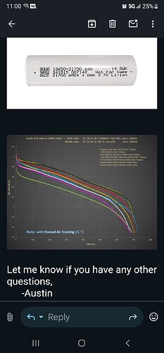

Supposed 35a discharge chart comparing am04
Okay so time to let things shake out before pulling the trigger on these, looks like the chart assuming everything is accurate and true, is showing the same cell.
Why get so lawyery about a rewrap/rebrand? Gives off big “nawwwww man im good vibes” for me.
If ampace can’t produce this cell reliably or they dont want their name on it it throws a lot of red flags. Hopefully not and it works out as the specs and test results look so good vs the price point. Too good to be true?
Just got off the phone with Austin. He guaranteed these are legit jp40 cells.
Supposedly going forward all of the jp40 that are imported will be wrapped as AM04 cells.
I asked why he didn’t just put a batch number on them like flashlight emitter companies do, instead of renaming the cell.
He also said he has a few people that have been testng these cells and they will be releasing their results within the next couple days.
Sounds shady as fuck. This, on top of all the other shit I’ve heard about Austin and 18650-21700, makes me even more confident that I’ll never be ordering from him.
Wait…so he is saying that the AM04’s are actually Ampace JP40 cells? Umm…:thinking: I agree with @Pecos though, performs identically.
I asked if he would confirm they are the same cells from the same manufacturer, he said yes

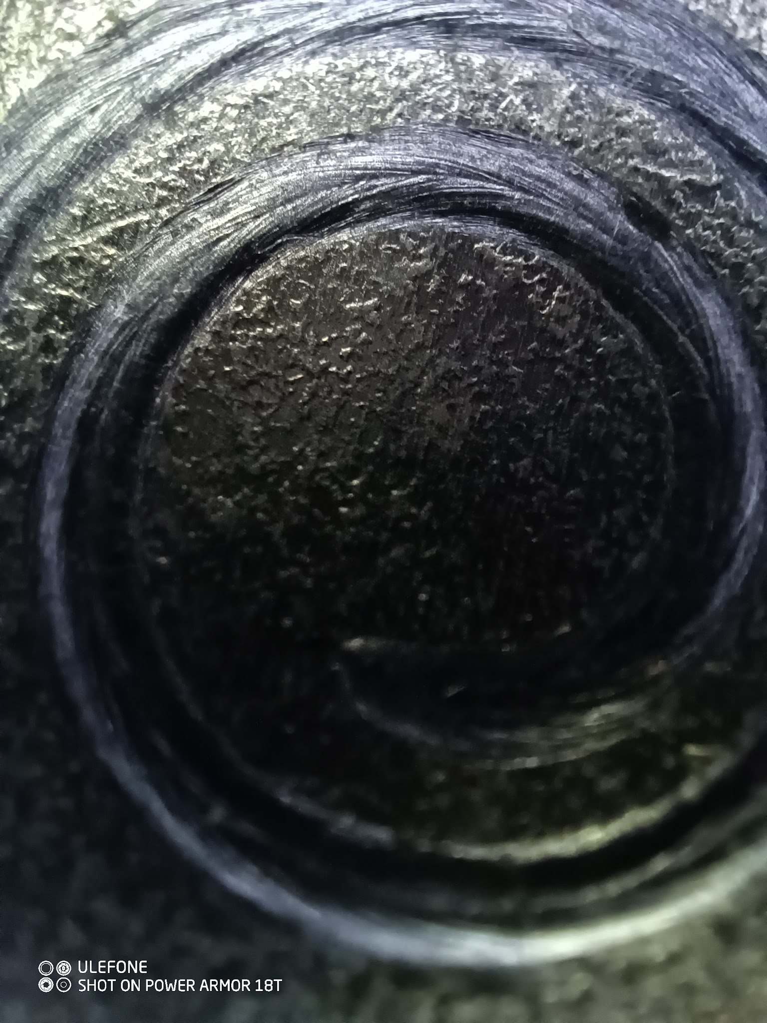

Need to see the bottom of the AM04 too (checking for JP40-style spiral) but I can arrange that.

Any way i could get a picture of the negative in total? Havent seen a good pic of the spiral and negative space available for welding yet
Wrap coverage can vary a bit. Stay out of a central 6mm circle.
