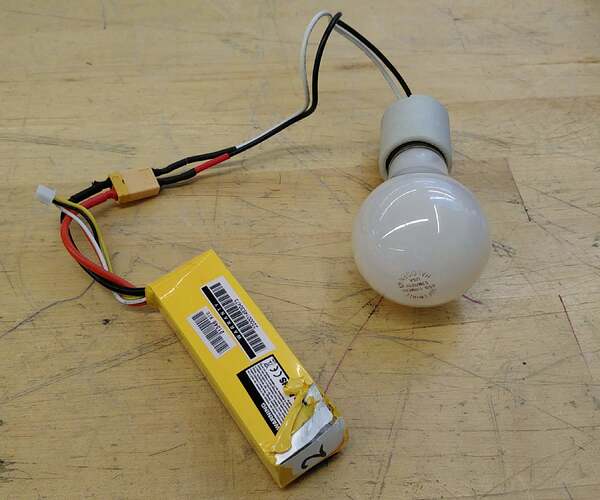

connecting incandescent bulbs is safer. Using salt water the pole metals are ending up in the water and making it poisonous and depending where u live that water needs to be disposed of as hazardous

Third, I disagree with your suggestion to discharge his pack with an incandescent bulb. Or discharging it at all, frankly. It’s in an unknown dangerous condition. Attempting to discharge it is an extremely dangerous thing to do, and its also completely unnecessary.
For the record YOU DO NOT HAVE TO DISCHARGE LIION PACKS TO RECYCLE THEM, AND IT’S OFTENTIMES MORE DANGEROUS TO DO SO.
I think a possibly damaged battery ESPECIALLY should be discharged before handling it or giving to others to handle. It’s up to the handler according to epa as far as discharging though

I disagree. Discharging a damaged battery is extremely risky. It’s definitely not something that I would be recommending to strangers on a public forum.
discharging damaged batteries before disposal is common. Especially if ur not going to follow the expensive procedures intended for disposal of a damaged battery involving buying a container for it and plan to just throw it in the general battery recycling it reduces risk.

Officially, as I posted, a “damaged” battery needs to be packed in this box. I feel safer, and cheaper, discharging it fully and saving my money. If that’s too complicated /dangerous for you …so be it.
Some chargers literally have a “destroy” button
I feel fine with my advice and discharging cells (damaged or not) before disposal is commonly done and understood as a good practice How to Discharge a LiPo Battery? method
https://www.rcgroups.com/forums/showthread.php?1638712-How-do-I-discharge-a-lipo-to-0v-for-disposal
Again, if that’s too complicated or dangerous for you and you have a damaged battery, you’re supposed to NOT throw it in general recycling despite this advice being given.
