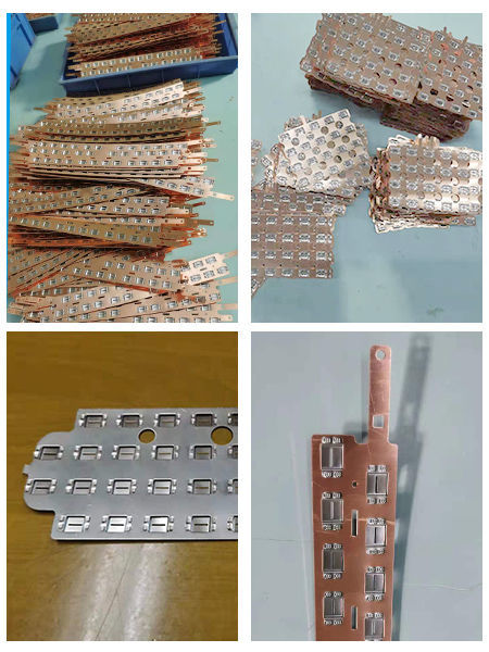

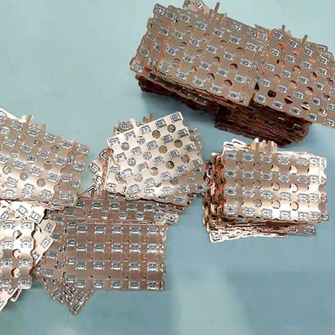

That’s really impressive, isn’t the new meta for high amp connections to run bus copper with nickel to the cells?
With a welder that is as capable as that one making the copper to nickel welds seems quite achievable
Something more diy than this type of strip:
IMG_0115
In my limited experience even a 400a peak pack wouldn’t need anything this burly BUT this is eskate specific. Might be able to make some monster motorcycle or car packs and repairs. So much is limited by the total vehicle and passenger weight - only so many watts you can put down in eskate before you take flight :rofl:

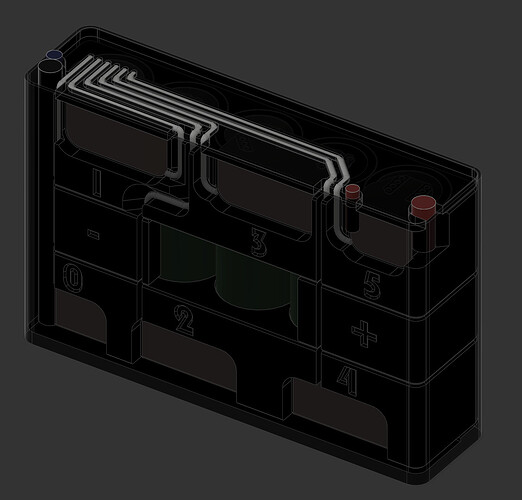

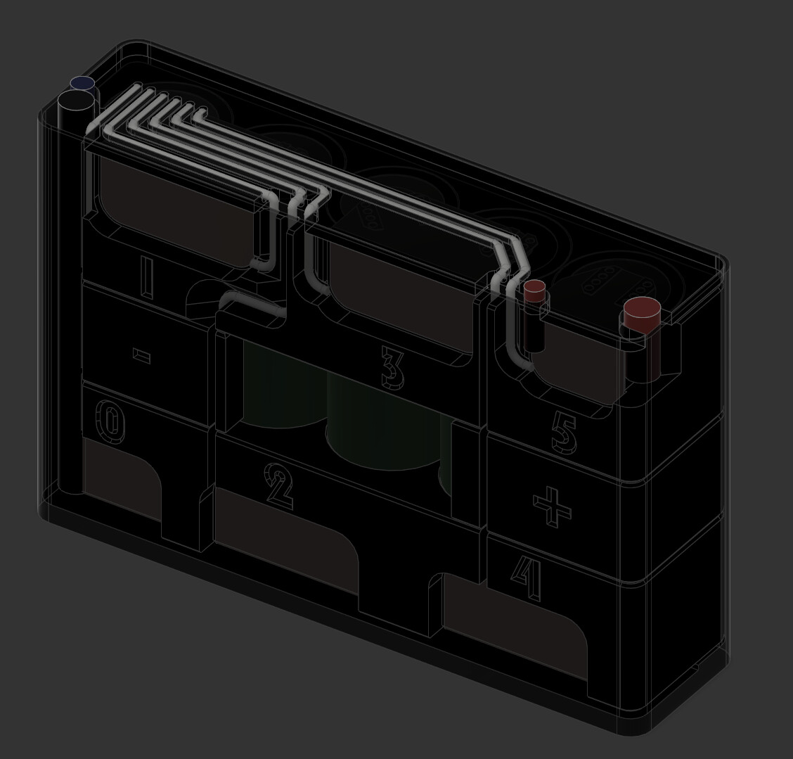

Well the reason I want to go with 0.3 copper is that I have two very unconventional battery builds with new tabless cells that have high promises.
The first one is a 20S1P pack for my jumper / offroad mountainboard. The plan was to shave off as much weight as possible using BAK 45D tabless cells, which advertise 60A temperature limited constant and 126A pulse ratings. What makes these ratings actually somewhat believable is their roughly 3.5 mOhm internal resistance. I do plan to push this 1P pack super heavily. I’ll be monitoring temperatures during testing, but I’m hoping for at least 90A pulses. At that point, 0.2 nickel would contribute significantly to the total internal resistance and heating of the pack. The 0.3 copper should be equivalent to about 1.2mm thick nickel.
Then next up I’d need a new battery for my raceboard. The current one works fine but I can max out the throttle which means it’s too weak :rofl: There’s two things to consider for this one. Firstly I want to push more than the current 13kW (21S 180A with sag calculated in). I can go up to about 270A keeping the same power distribution front to back as I currently do, so that’s the target power. The second consideration is that I want to fly to esk8con (assuming I’ll be actually be able to earn enough money to afford it). What this means is that I need a flight safe battery consisting of less than 99Wh modules, or figure out the battery situation there which I don’t want to do unless it proves necessary.
This is the unfinished version of the model, I still need to figure out the top with not a ton of vertical space to play with. I should be able to hopefully barely squeze in 12 of these modules into my pelican storm im2050. That would mean I max out at 20S3P.
And this means two things. Either I can get that 90A per cell to work, for which I definitely need copper, or I need to build two batteries, one for flying one for racing in Europe. Or perhaps build some modules to be used under the deck, while having some modules over the deck. But this is more complexity than I want if there’s a way to avoid this.
Given the complexity and uncertainty of getting such a modular pack to work well first try, I decided that the jumper’s 20S1P is going to be built in this same way to test out smaller scale if this is a viable idea to pursue further.
So there you go, two esk8 packs desperately in need of copper :grin:

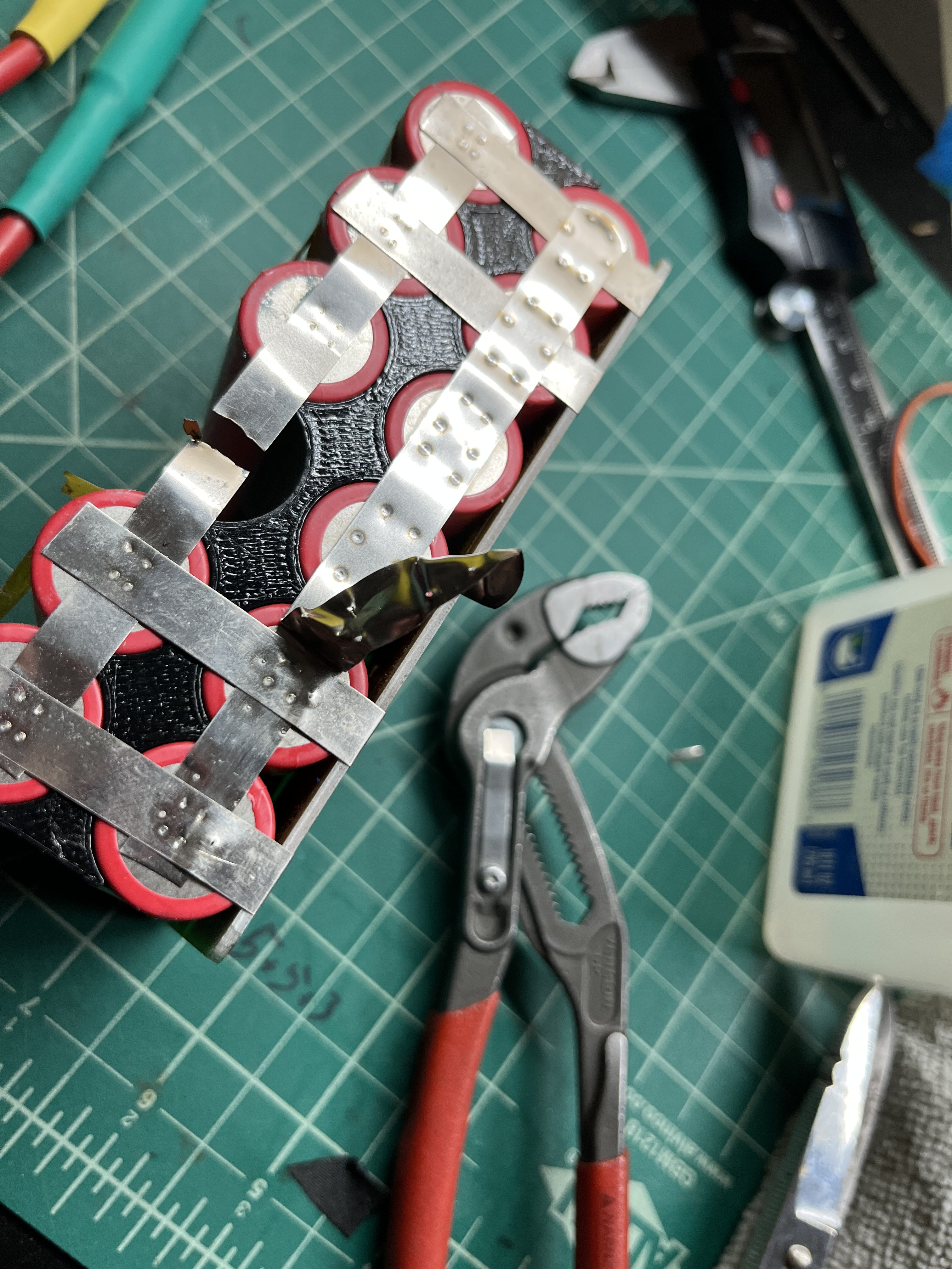

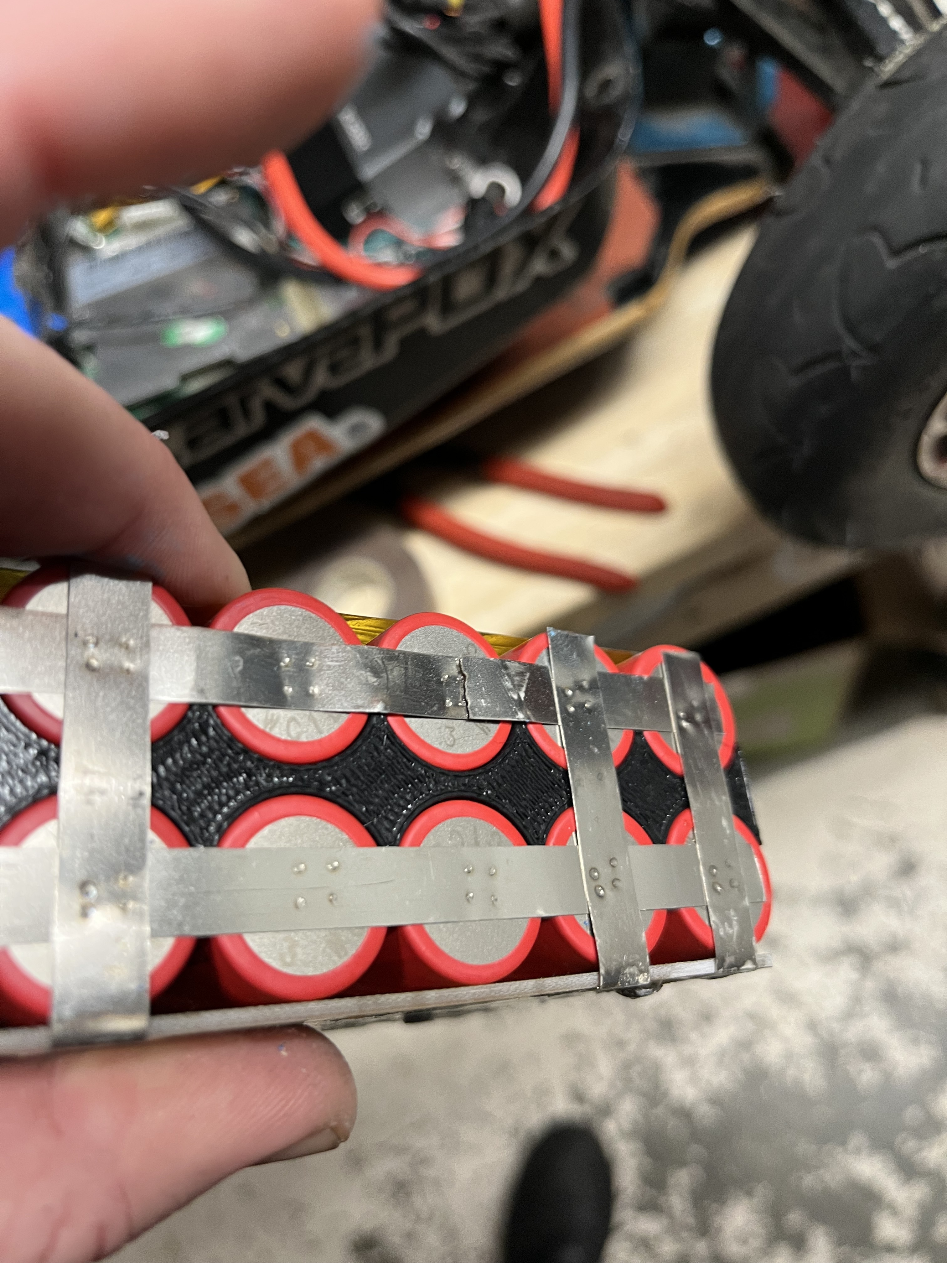

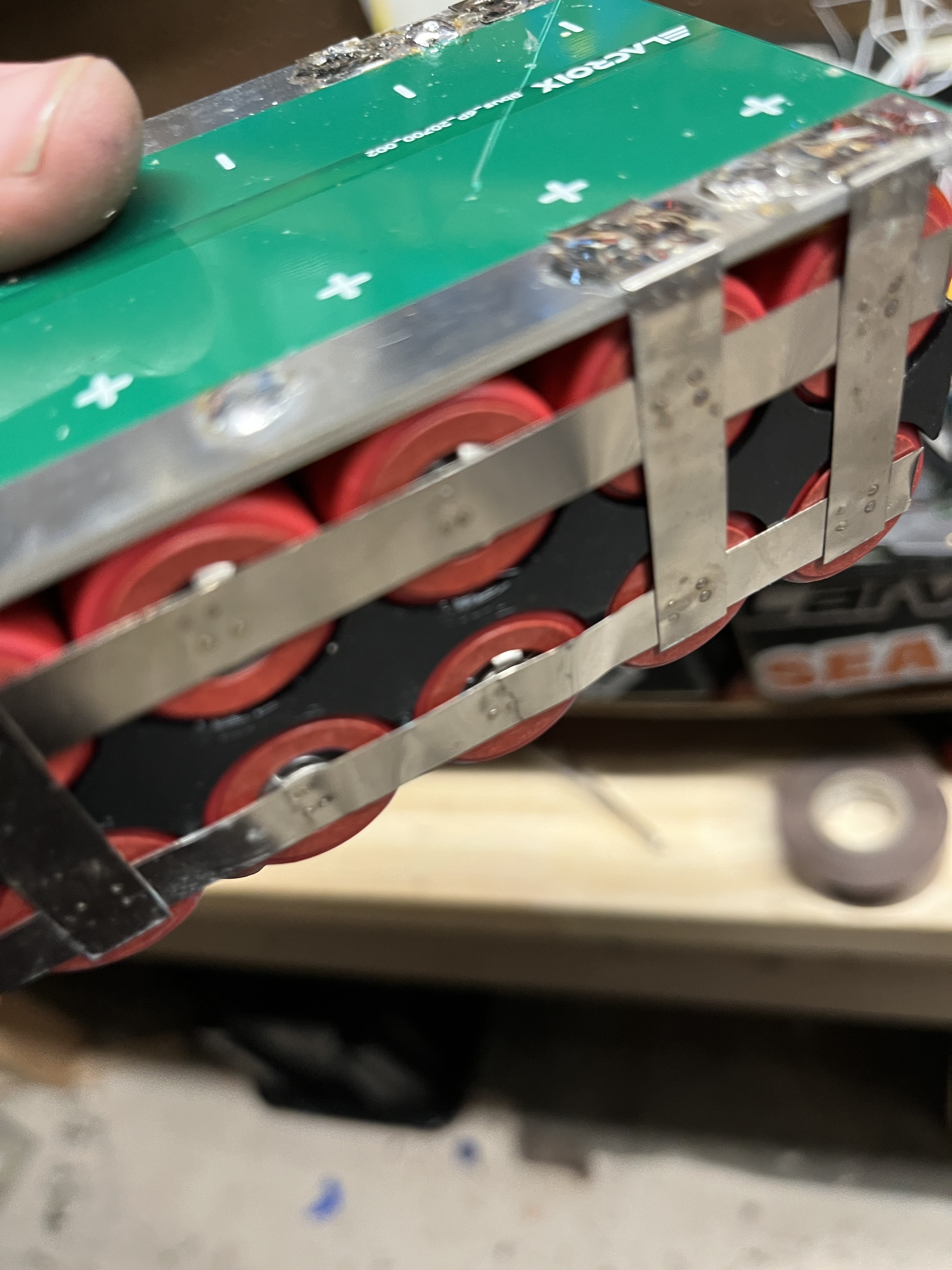

Ok, looking for a second opinion and some additional insight incase i have forgotten something important here.
The story is an older Lacroix loanstar pack using the sanyo 20700 cells had some issues. Took the bad p group apart and it was broken nickel and early enough it hadn’t done anything but disconnect. As soon as it was showing something odd it got put on the workbench so im confident the cells didn’t get abused. Also the breaks were series connections and not parallel connections so everything was still nice and balanced still and no lopsided drama.
because of the style and availability of replacements it doesn’t make sense to make a new pack at this time. Probably has a good 3k miles of use left in the cells easy. They stabilize after a charge at around 4.16 and stay balanced well enough all the way to 3.2ish. Sag is ok but pretty typical for this cell and not bad enough yet to throw a red flag on test rides.
The question: so I decided it needed a thorough once over to make sure everything is in good shape before i let my friend back on it - this means pulling the shrink and inspecting the nickel to make sure all is well and i find 4 cracked spots sprinkled throughout the groups. Some partly 2 fully broken. Im going to repair them but im also lazy and have some old dead packs in the same style and manufacture methods to test some things
I avoid sandwiches like the plague but I don’t think these cells will take to getting Dremel treatment based on a few experiments on dead cells from my recycling pile. Adding welds to the existing nickel and then welding a new 10mm .2 strip on top makes a very solid connection and tearing tests are good.
What have i not thought about here as far as side effects or potential issues? All the cells will get silicone to prevent any future shifting to keep from stressing the nickel for future bumps and vibrations. Seems like it will work well and be the best solution that lets it get to the cell end of life instead of diying an early death due to poor initial construction. Whats the group think
I would reweld all the existing nickel and then layer 50mm nickel over the top. Those individual strips are lame

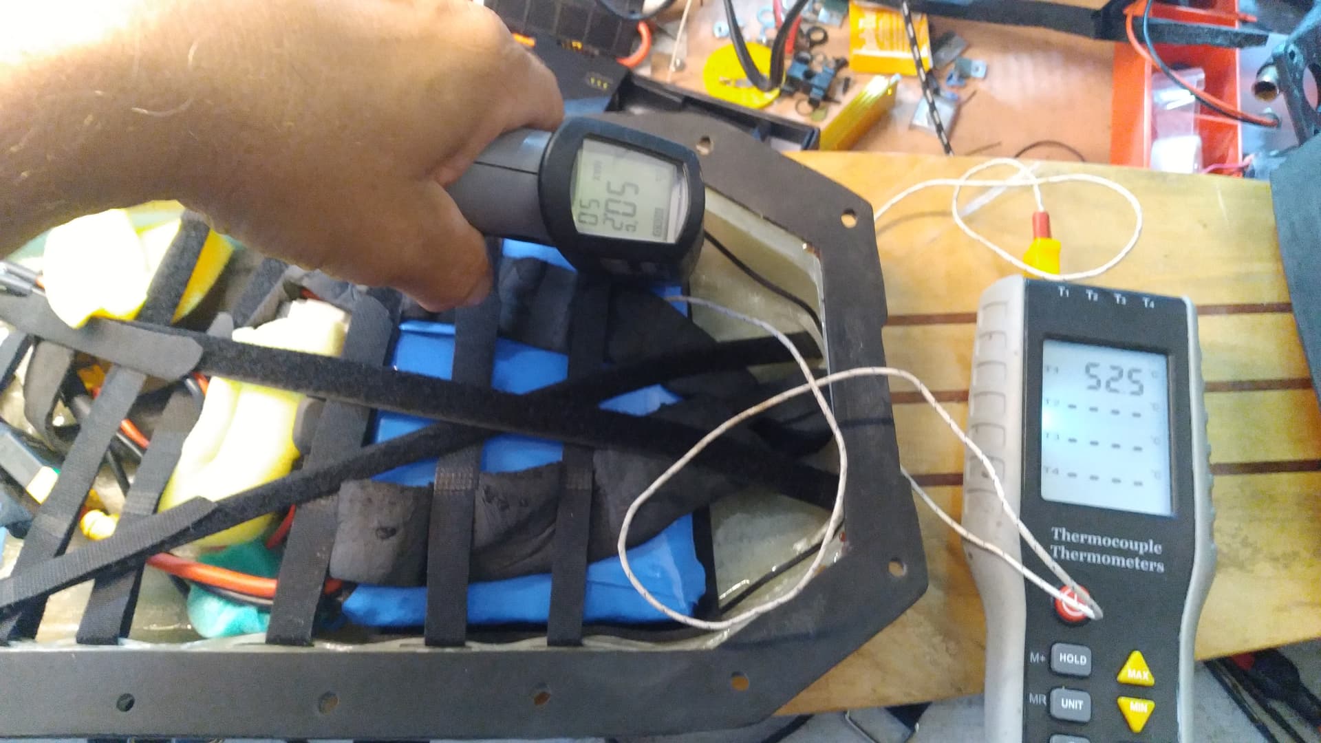

What temperatures are your batteries reaching when you push them hard for much of their capacity?
I ran my 10s2p battery pretty hard yesterday, and charged at about 0.7c during 2 stops via portable cbarger and mostly full throttle towing when rolling.
Noon, sunny day Florida. Ambient was about 27C.
When I got home I quickly benched my board, dropped enclosure, and with IR temp gun, hunted for the highest temperature I could find on the exposed portions of battery heatshrink, and found ~55C.
I pulled up the data sheet on my 15 amp cells and it says 60C is max operating temperature.
Being able to read 55c through fishpaper, 0.5mm G10, kapton tape and heatshrink, pretty much means my cells had to be over 60c.
I am kinda bummed I can’t safely push this battery as hard again, but am pondering methods and products to better wick heat away from cells in future builds, such as thermally conductive foam, instead of insulating foam padding between battery and enclosure.
Also wondering how much less heat a lower resistance cell actually generates.

Your idea of using low IR cells is probably the best approach. EVE 40PL or Ampace JP40’s would be the best choice.
I am able to measure 5 to 7.5 f increase on thicker than average fiberglass enclosure directly over battery, compared to just ahead of the battery. But this is 35f below what I measure on the battery itself.
There is about 10mm of soft squishy neoprene foam between battery and enclosure. Not sure how thick it is when compressed , when battery is strapped to enclosure. It is a single stack, in firm contact.
I went for another roll earlier, a little slower, no charging whilst walking through park, cruised not quite as far, but full throttle the last mile when I knew i had enough juice left to make it back home no worries.
Immediately Slapped board on workbench, dropped enclosure, Aimed IR gun all over battery hunting for highest reading, found 55C. Again.
Motors and esc heatsink temps well below what I have gotten them to in the past
I have a K type thermocouple I am going to tape within a blob of thermal grease on IR indicated hottest spot, try to get some real time readings.
Data to perhaps justify 20 JP40’s
This 10s2p battery has basically been treated like this or worse, since January.
It has at least 2500 miles on it, perhaps 3k.
Still seems to have most of its capacity, and grunt when above 38v, and is never more than 33mv out of balance when I check.
Wish I had some Battery temp data when new, to compare.
My K type thermocouple largely agrees with IR temp gun over two cycles dropping enclosure immediately and measuring as quickly as possible in fan free zone.
The bottom of center of battery is consistently 1.5c cooler than the highest temp I can find on top of battery, with either tool.
The top of my battery has narrow strips of same squishy foam under many velcro cinch straps, and in current set up there is two layers of uncompressed harder foam totalling 12.76mm thickness before the bottom of wooden deck. There is some open air space shared with externally heatsunk esc, and not all that much contact between squishy battery foam strips on top, and full size double gaskets.
So it appears my squishy neoprene foam under battery is conducting some battery heat to enclosure to ambient but hard to quantify precisely. lots of variables.
The foam cradle is probably thicker than it needs to be.
Wicking heat from top of battery, and or protecting it from ESC heated air, might also help, but likely nowhere near enough.
But it seems my battery is now , and has been getting way too hot when I run it from 4.2 to 3.4 volts per cell, and ignorance was blissful, but increasingly dangerous, and I need to build a better one.

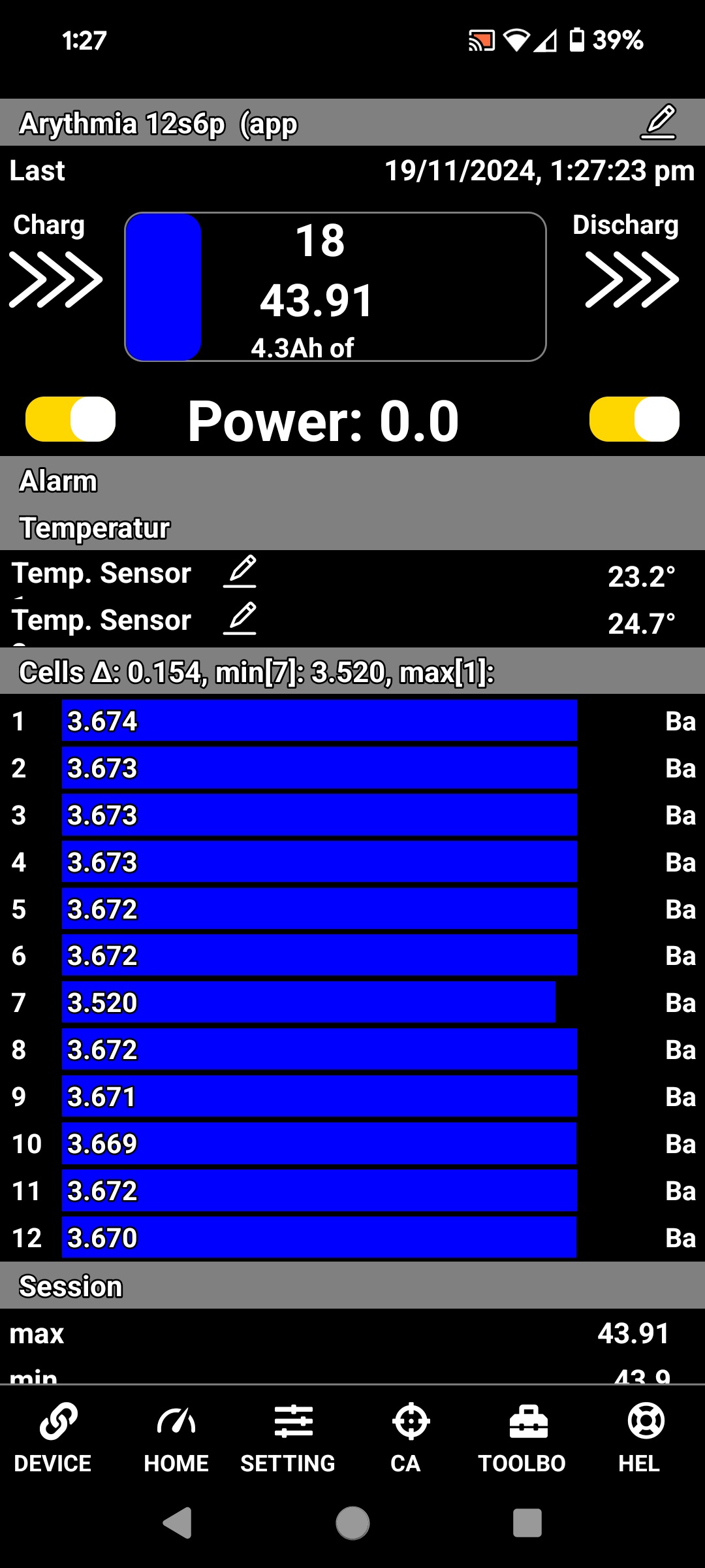

Well this can just go and get fucked.
I ‘could’ charge and balance again, then disassemble the pack for experience. I’ve called the board this belongs to deceased anyway.
I wonder how many cycles you have on that bad boy? Is it just old and an aged p group? Everything else looks so tight i also wonder what the top of the charge balance looks like. Sucks when a pack goes down like this - 11p fix? :rofl:
It has to be a weld in P group 7.
Funny you say that, I was thinking of dropping it to a 10p and using on an electric trike build that’s smoldering away

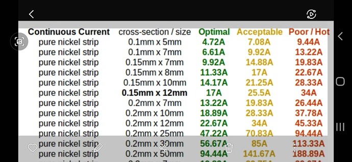

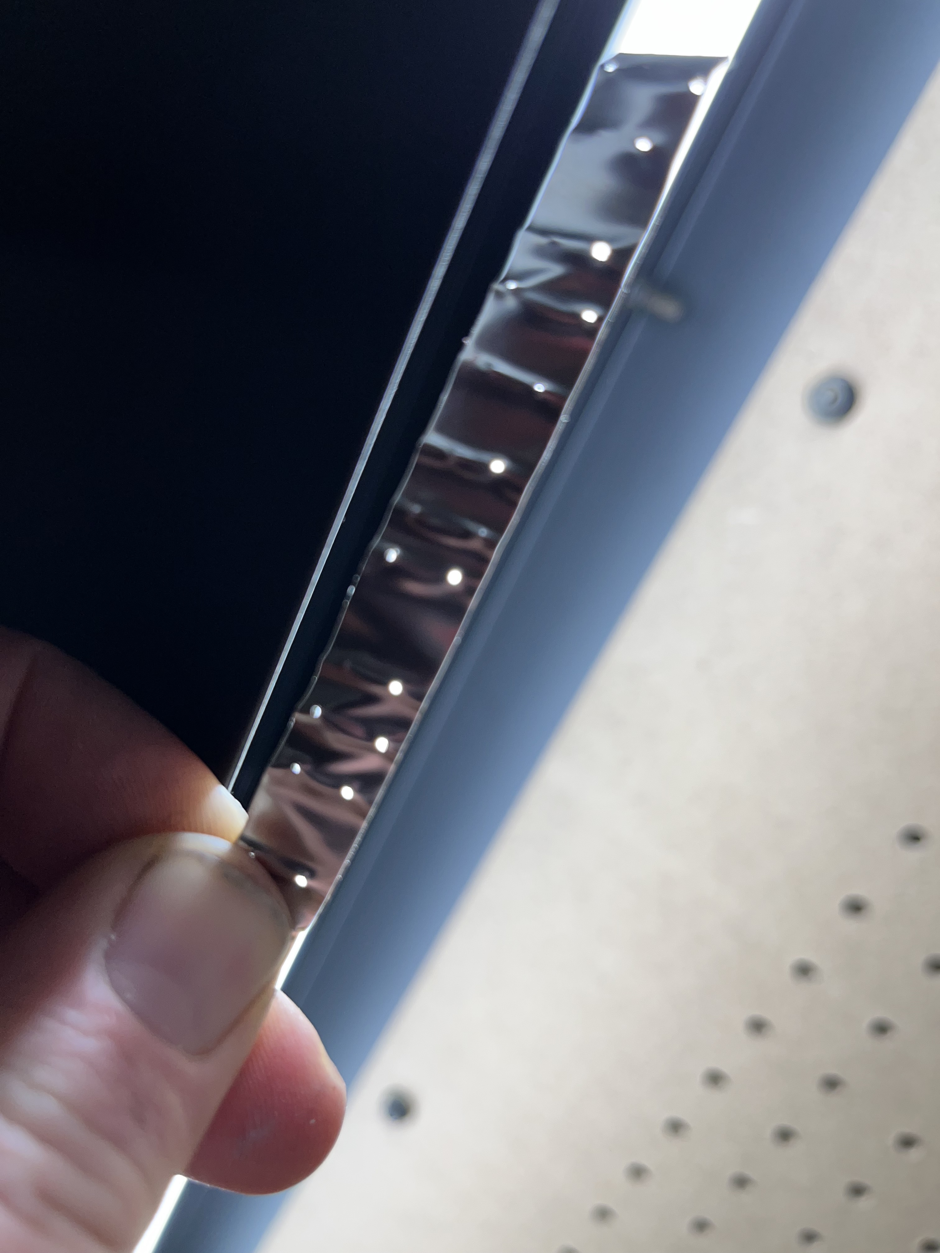

what nickle or nickle/copper combo would you use for a 45a rated 18s 1p tabless pack build.
Is .15 nickle good enough?
It’ll be pulling 20a normally, with short bursts to 40a.
I would use 0.2mm nickel. But mostly because that’s what I use for everything.
What welder do you have? In 1P I think going for copper + nickel plated steel combo especially with tabless cells might be smarter choice
I have a cheap welder and Zee 3s 5.2ah weld Lipo, and can weld 0.1mm Copper with 0.1mm Nickel plated steel atop, without issue, using 75 to 85 ms pulses.
Not including the Nickel plated steel cap, it should be equivalent to 0.4mm Pure nickel.
I could not reliably weld 0.15mm copper, or 0.1 copper with 0.15 pure nickel atop, but wonder if adding a second Lipo in parallel, whether it could.
0.15mm pure nickel requires 35 to45 ms pulses on same welder, but copper makes me eggplant, so copper I will use.
I say go for the fattest conductor your welder can handle with a little headroom.
