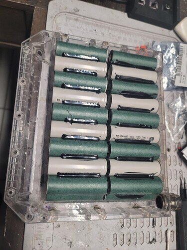

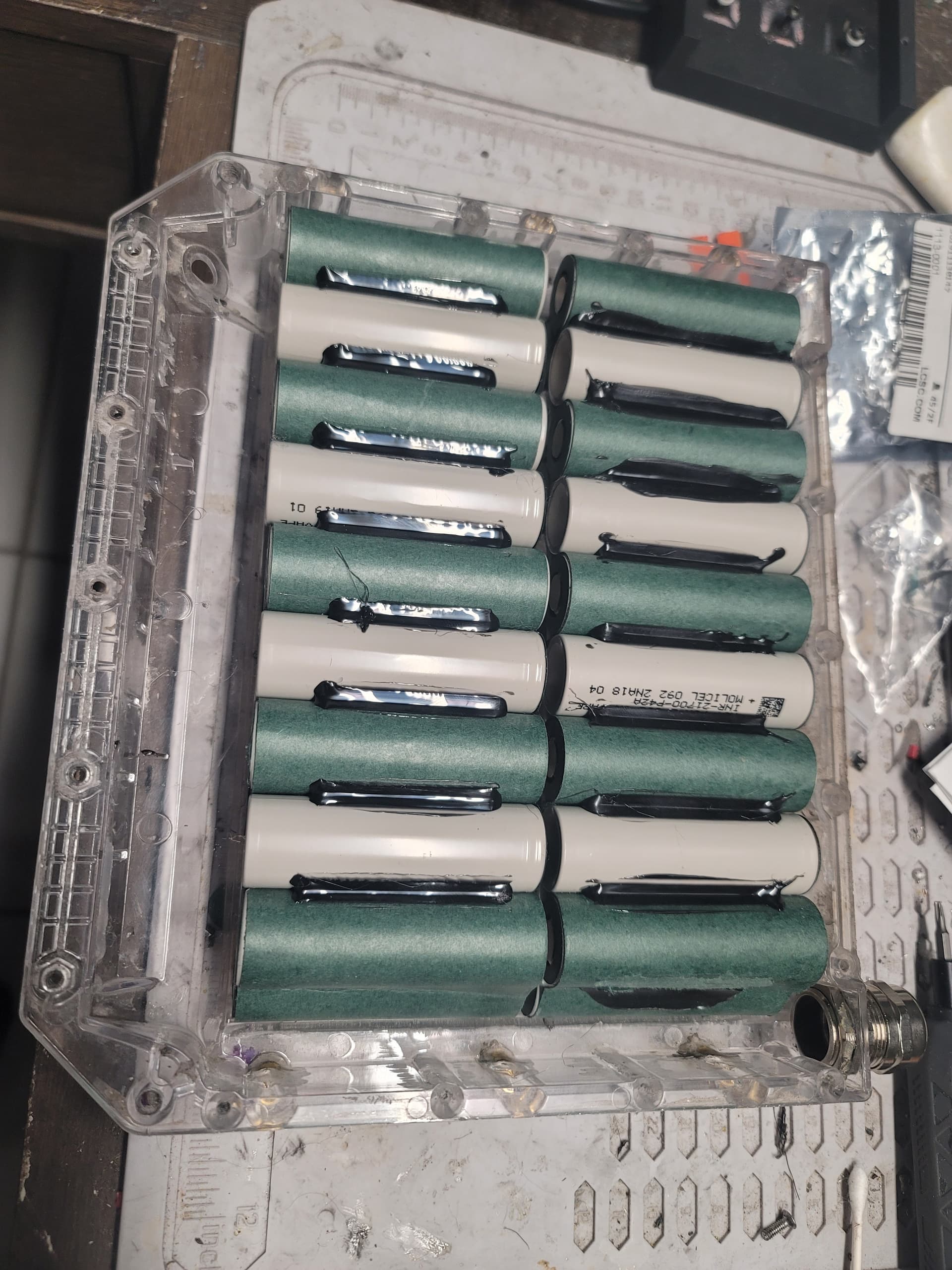

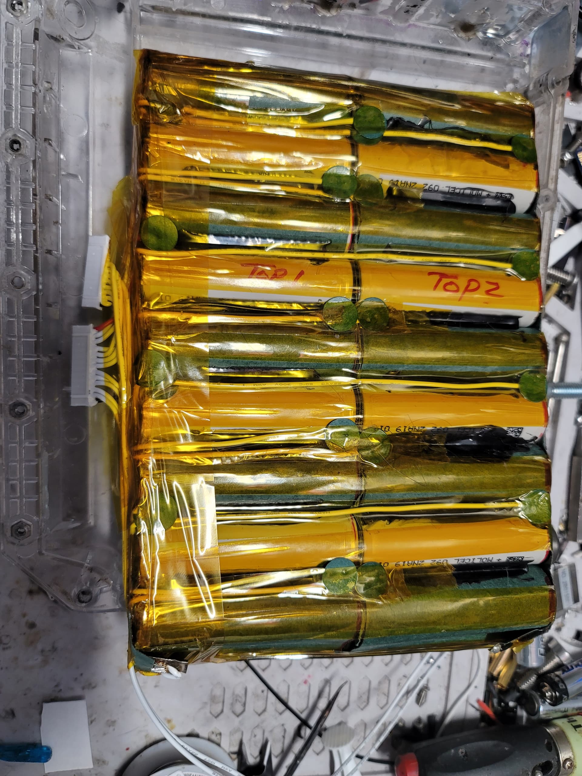

I do largely agree with the people above, but I did it recently by printing a big frame for the battery and epoxying the cells in place so the loads are (theoretically) taken by that.
We’ll see if it holds up and it’s still a sample size of 1 so I don’t want to oversell it. It’s also a relatively small pack at 16S1P, on a short stiff board with a pretty stiff enclosure, surrounded by padding
Just need to add charge/ discharge connectors and heat shrink it! 18s2p
