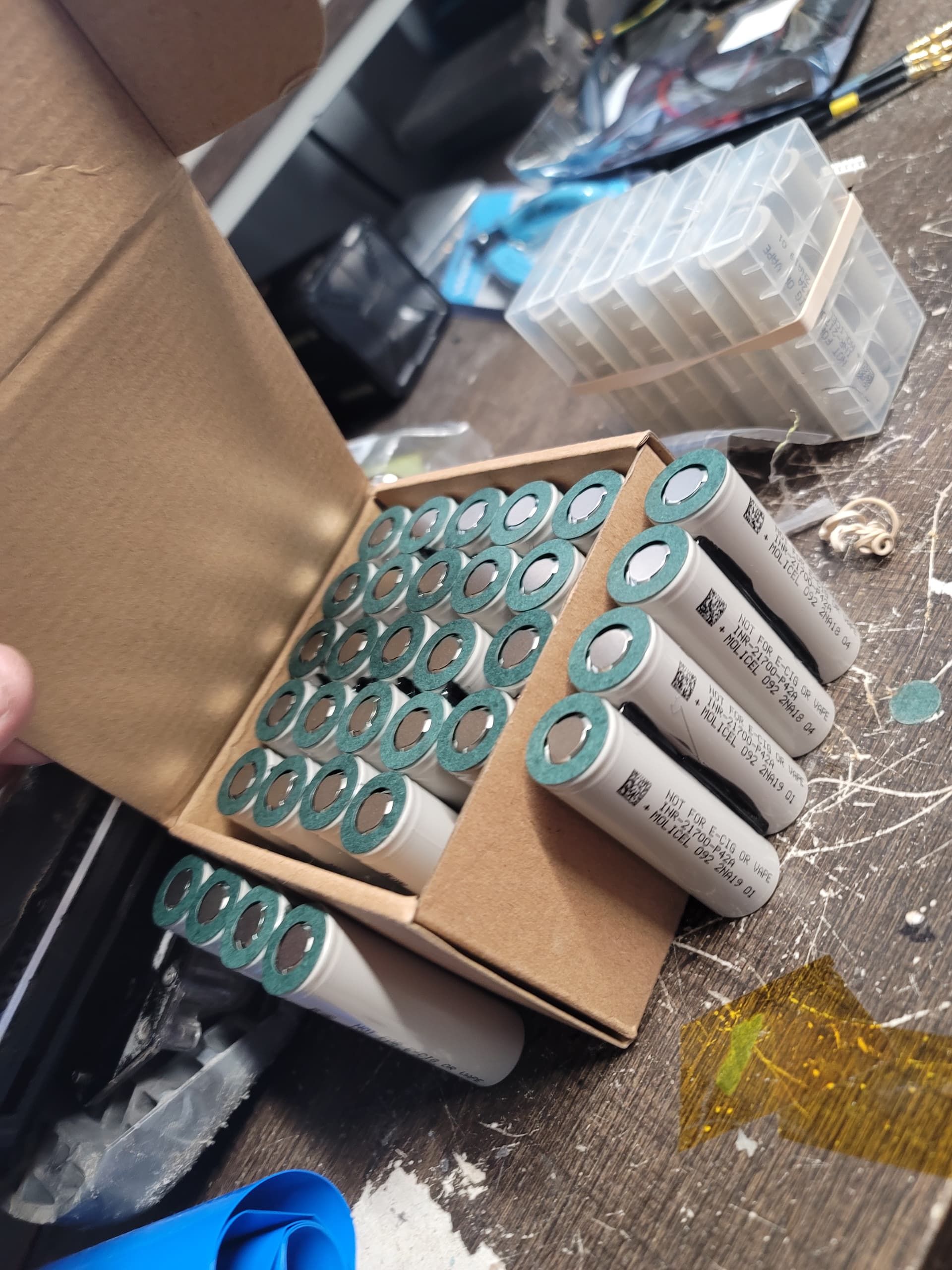

thanks, interesting considerations. Unfortunately I’ve available a 10awg silicon wire for the vesc, and 14awg for charging.

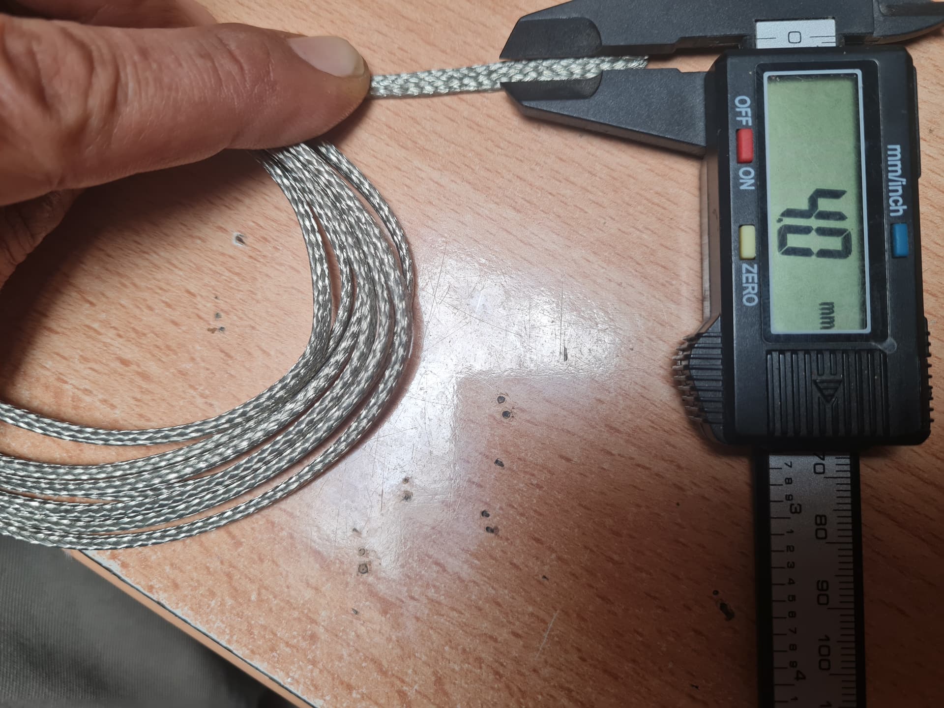

I’ve also a braid wire with a section of roughly 3mm when rounded and 3.5/4 flat, can I use that?
Can I use electrical wire being an internal connection?
I’ve noticed that the core of silicon wires is not copper wire, so I presume have less conductivity?
I found some 1.5mm nickel plates, Is it really better to use wire instead of having just 1 layer of nickel on top of the other nickel layer for the P group?

Layering nickel is a bad idea and especially bad if you don’t already have experience doing it. Also your nickel connections are very limiting regarding the current flow if you are going to go the way you pictured.
A 1.5mm nickel sheet wouldn’t work either, there’s zero chance you can weld that.
Go for the 0.2mm 30mm wide nickel strip that I linked for you from nkon.

Only if you have a proper nickel connection from the cell to wire. But at that point it’s usually simper to just use nickel. For the connections between the 3 packs use wire.

What are the main thing to check or be aware when layering nickel? I can make good practice without the cells if I know what should I check for.
I’ve tuned the welder to make the spot not go below the bottom layer and not to powerful to avoid making a hole in the top layer…
Can I use braided 3mm section wire between the 3 packs?

So I either I do 2x14awg or I have this braided copper wire with a section of roughly 3mm when rounded and 3.5/4mm flat, can I use that?
So then terminate your battery in 10awg for some headroom and you should be good. This looks to be a brick pack. How are you making your Series connections?
yes, I was saying that for series connections, reading your suggestions, I’m planing to use either 2x14awg or that braided 3mm copper wire
If you terminate the main terminals with 10awg you should be using 2 x 12awg or 3 x 14awg for your S connections as a best practice. 2 x 14awg is not sufficient.
