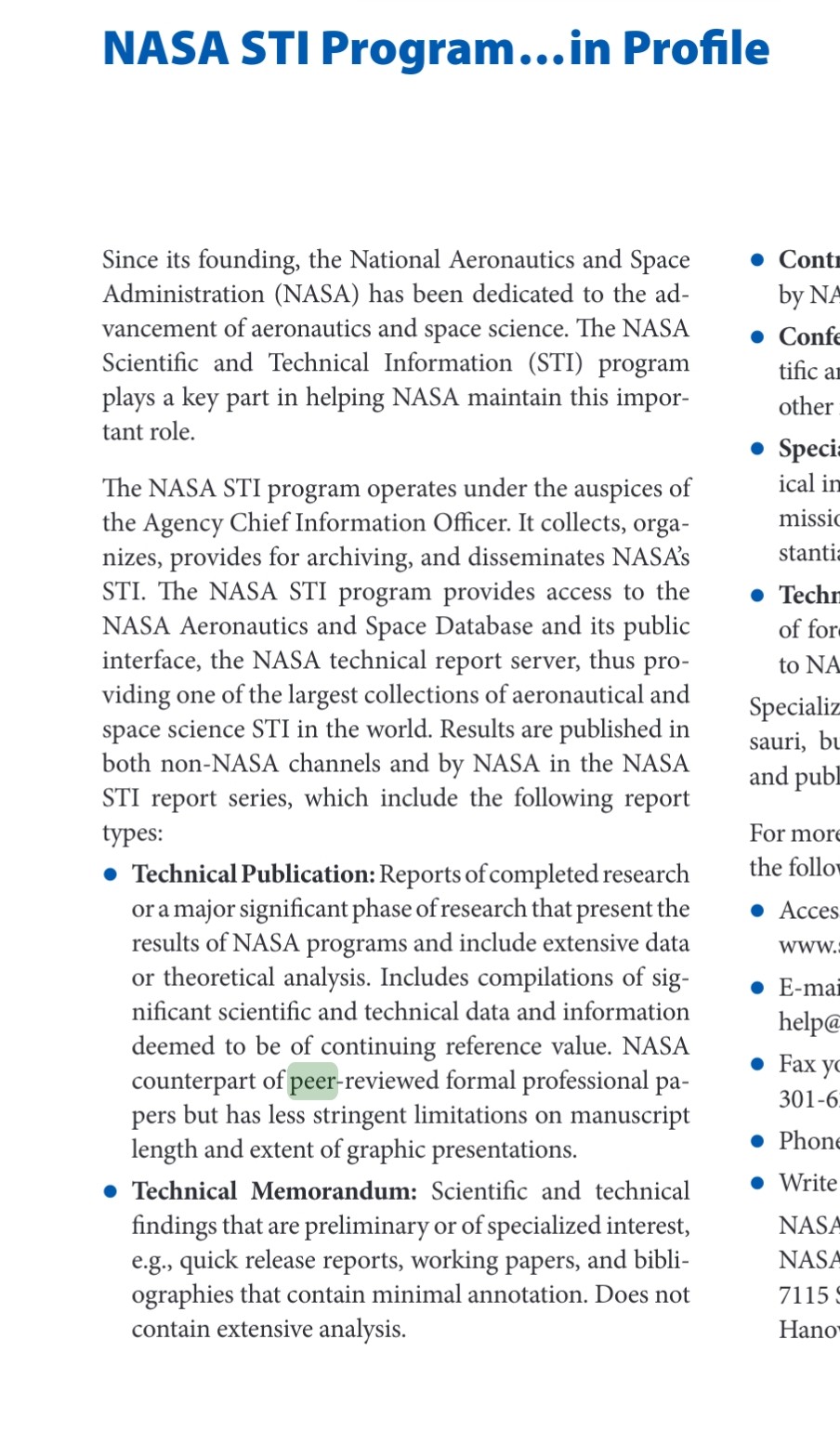

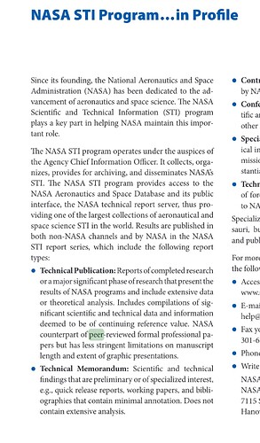

I’m referencing NASA because public research bodies are good at open access, but they specifically note that their Technical Publications include extensive data and analysis but are in some ways less strict than peer review
We’re getting pretty far away from battery building, but your reference is for peer reviews of NASA technical documentation. If you take something like a NASA standard for electrical harness production in spacecraft say, that is certainly peer reviewed as part of the process of publication. As I said before, forums are not that kind of peer review. However what that standard is comprised of is the result of hundreds of thousands of best practices gleaned from successes, failures, and yes, lower level technical reviews of designs by, yes, “peers”. Here, we’re at the lower end of the peer review spectrum. Still a peer review though, just not the one you’re talking about. In fact, NASA still calls these peer reviews and they are not confused with tech pubs peer reviews.
Look, saying that because we are in some way peers means that it’s technically a peer review is not a good idea. Even if it was technically true, it’s inflated and inaccurate language that doesn’t reflect the common usage of the term.
But it’s not even technically true. Who are the referees and how are they decided? What are the review criteria? Where’s the editorial or managerial oversight? Where’s the evidence of follow-up, what’s the retraction mechanism for mistakes, what’s the trust model? I can give you specifics examples of how review processes work and cite professional standards but at the end of the day the key words there are processes and standards. We don’t have those. We have received wisdom, anecdotal experience, and a willingness to help each other, but pretending that’s the same as organised rigour is ludicrous
