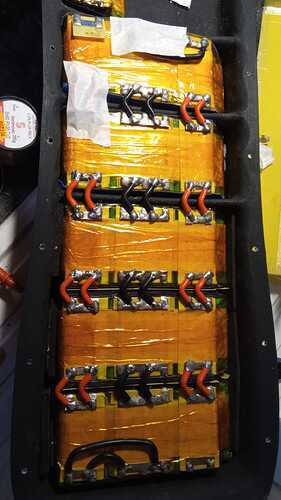

It might be barely passable but it’s def not good. Several obviously cold joints and what definitely looks like solder wicking up the wire. Not to be a dick but this person, whoever they are, needs to practice their soldering. Ultimately, if u r the client and u r happy, it’s all good. Personally, I’d be immensely unhappy if I paid someone for this battery.
Cold joints everywhere like that will dramatically increase resistence in the pack and will likely also create hot spots. They may even unsolder themselves although that’s less likely, but it’s a definite possibility.
Solder wicking up wires is also a serious issue and will often cause failure in an esk8 battery over time.
Will this battery work? Probably… but for how long? Caveat emptor, bruh.

First, I do hope you’re fully aware of the increased hazard and risk of a split onewheel pack. I’m assuming, it’s the 18s2p rear with 2s2p in the front. No idea what BMS you’re using, but either way, you should be fully aware of what the risks are, and why they are that way, before actually finishing and implementing such a battery. If the fact that there are increased hazards is new information to you, then it may be a good idea to take a step back from that project and comb through things more thoroughly.
Especially since the hazards of a series-split pack are much more heavy than whether or not 8 welds is too many.
Edit: I didn’t see the fish paper bits between groups. My bad.
On the subject of insulation, I don’t know if you intended to, but there should be something like fish paper under those balance tabs when they get folded over onto the valley between the cells.
Regarding weld quality, how they look is only going to tell you so much. Really, you should be doing pull tests on either dummy cells or cells you don’t intend to use. The nickel should tear at the weld, leaving some of it behind. This can happen with welds that look cold but aren’t. And a joint that looks hot can be weak from the joint being brittle.
Testing is the real way to tell, especially if you’re not really familiar with the welder and it’s behavior.
Best of luck.

As for the welds i did do a pull test on an old cell and it was difficult to pull off and did leave bits behind, i couldnt recall if that was “too hot” or just right.
I am pretty used to this welder at this point but it is a cheapy amazon special as i travel all over the US for work and live in a 5th wheel trailer so this welder is small and compact but does well for what it is, i just doubt it will last for more than maybe 4 packs, so far though ive been pleasently surprised for 60$.

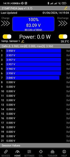

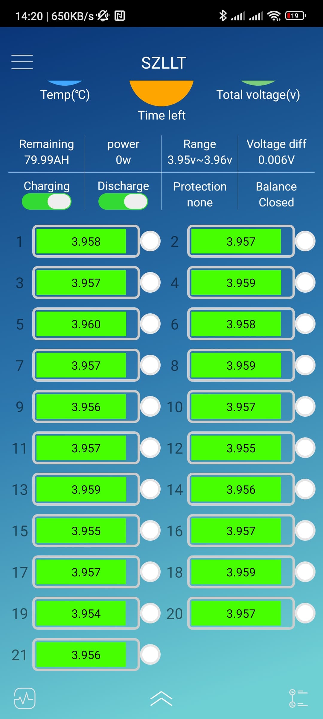

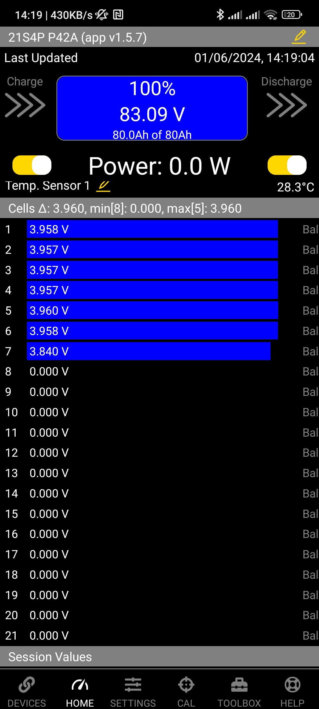

Any reason why the overkill solar bms app could be acting up?
It only shows voltage for the first couple of cells. Interestingly it knows the full pack voltage though?
The xiaoxiang app however shows the voltage of all cells.
I tried restarting my phone and connected to the BMS multiple times from both apps. The xiaoxiang always works, the overkill solar always worked perfectly before, but today I connected to it like 5 times and it didn’t work even just once.

To me it looks more like a combination of a skill issue and shitty solder. The shitty solder is very visible, but most if not all of the joints look like the person who made that pack needs to learn how to solder first.
Also, there’s zero reason for 2x10AWG wire if the nickel is a ladder strip, so the current is limited to about 2-3x 8mm of nikkel. It’s just such a bottleneck in the current flow. That pack is good for like 50-60A assuming the nickel is at least 0.2mm.
It also looks like there isn’t any fishpaper insulation between the P groups. If I am correct on this that’s quite a serious issue.
If I were to pay money for that pack I would be pissed.
