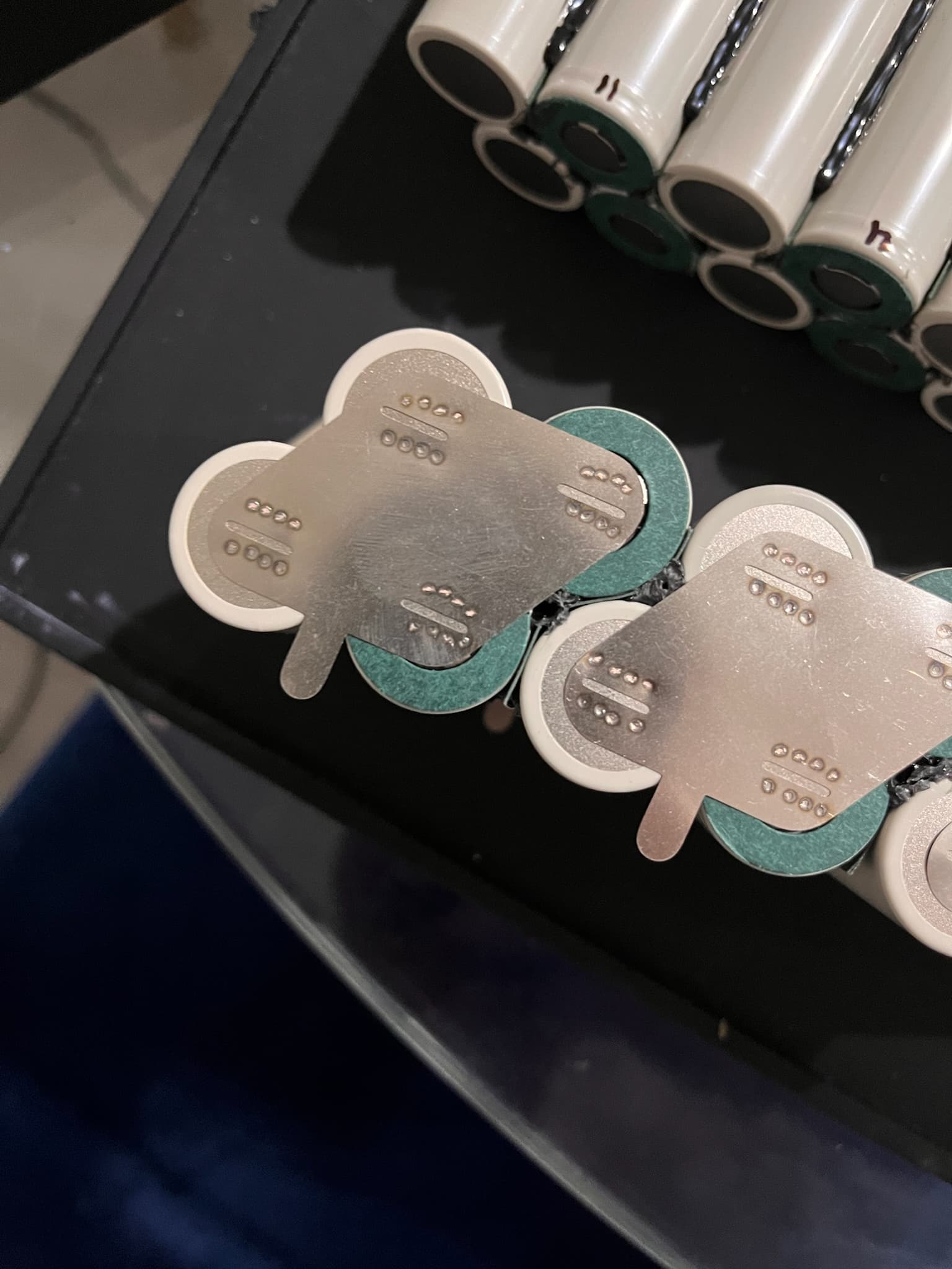

Whats up guys, ive lurked through this thread for quite a while and appreciate the absolute wealth of knowledge you guys have provided here. This question may have been answered before but how many welds is too many? I have built a 20s2p 18650 and now building and 20s2p 21700 split pack for onewheels.
I have been doing 3 on the 18650 build and now 4 on this 21700. Also how do they look hot cold pretty good? The 18650 20s has held up great so far, about 500 miles on that battery and have checked on it a few times now welds are holding and everything is balancing and looking good so i think i got it pretty well dialed…

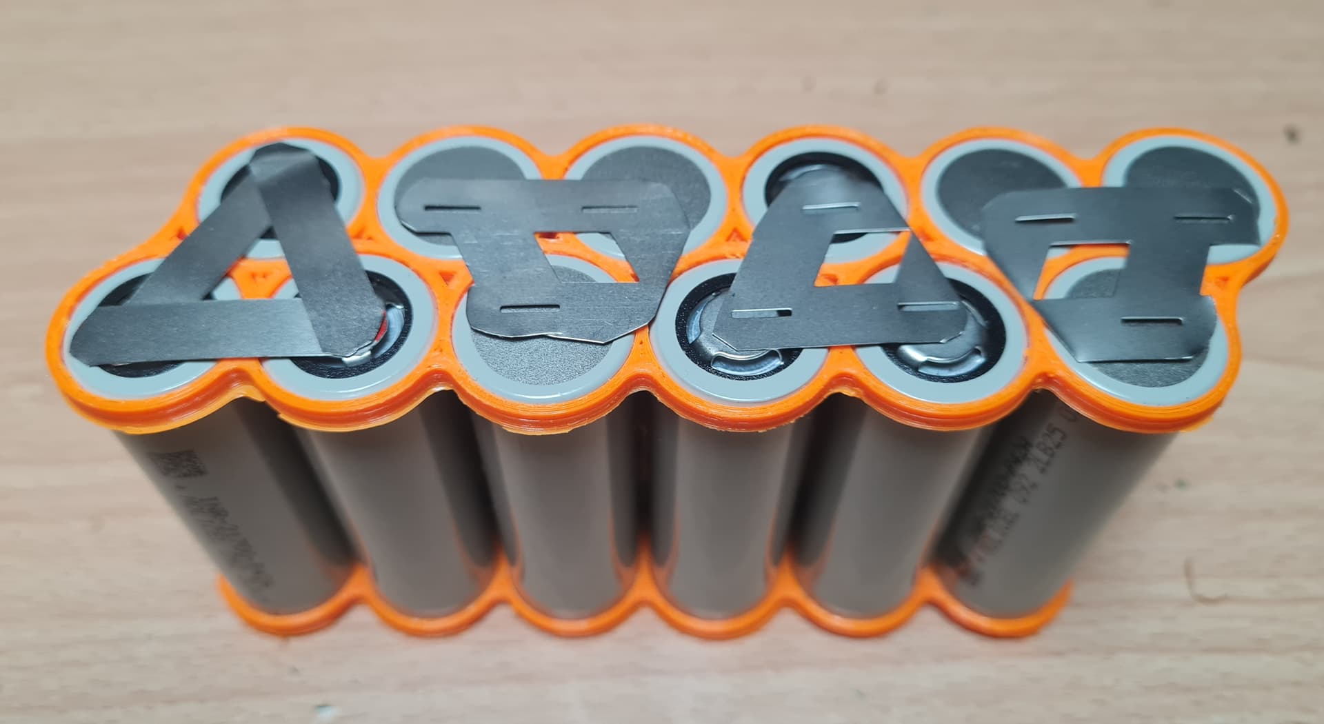

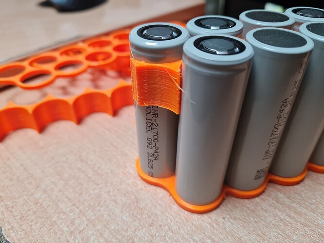

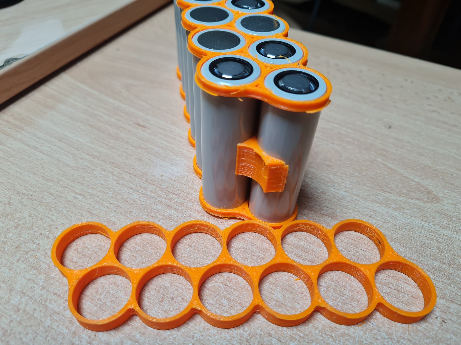

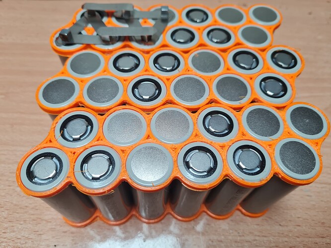

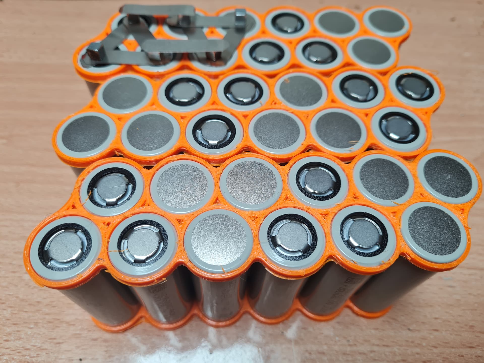

Hello everyone, this is my first attempt to build a battery pack (after so much reading and watching tutorials)

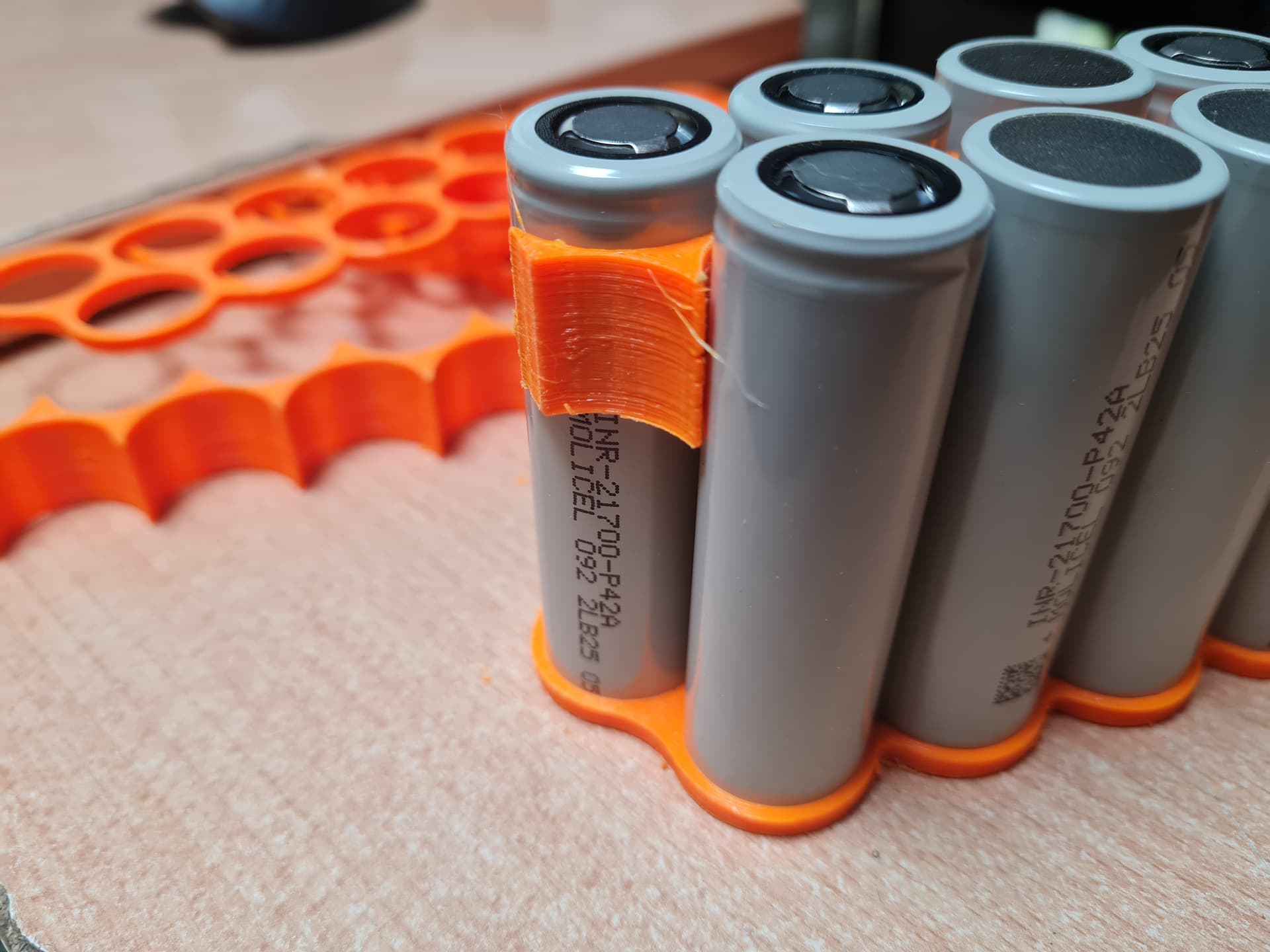

I’ve opted for a 12s3p in a slanted 12 cells configuration, and using these custom printed assembly system that I’m very proud of, it makes extremely easy to line up and push the cells together. The result is compact and solid and no glue is needed!

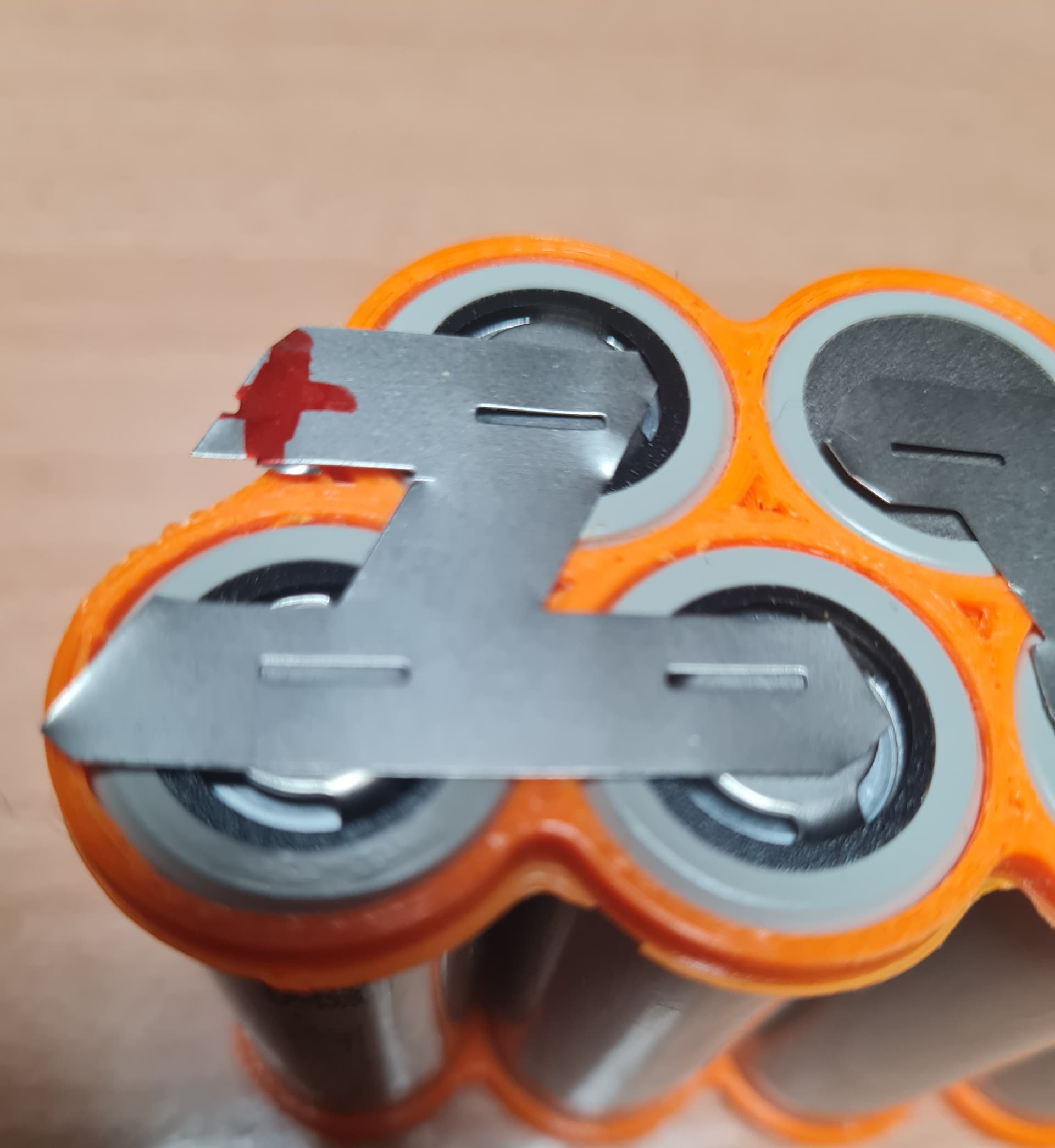

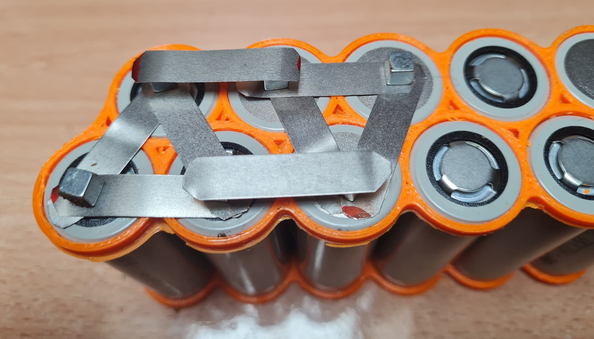

Now it’s time to connect the P groups, and I initially planed to use the pre-cut slanted nickel strips but the offset of the mounting, even if is minimal, it’s enough for misalignment. They also provide less conductivity for no real gain compared to stacked strips, don’t you think?
Since I’m having difficulties at sourcing nickel sheets (here in Italy) do you think is ok to layer several strip together like this?
And similarly across the single packs? Would a single 1.5mm nickel strip be enough?
Or I’m better off using a 8AWG wire to cross each individual packs?
I plan to fish tape and Kapton tape the whole three packs so the wire is not really necessary for flex.
Other small questions:
  1. Can I use other material other then the so called fish-tape? Can I use self adhesive PVC sheets?
  2. Is it necessary to use external termoretractile wrappers if I put the battery inside a case? I’m asking because I wonder the wrapper would act as a barrier for cooling the batteries, and I don’t see it if, for example, I open up a premade commercial battery (say for an ebike). Do people use wrappers for added waterproof safety?
  3. What fuses should I use?

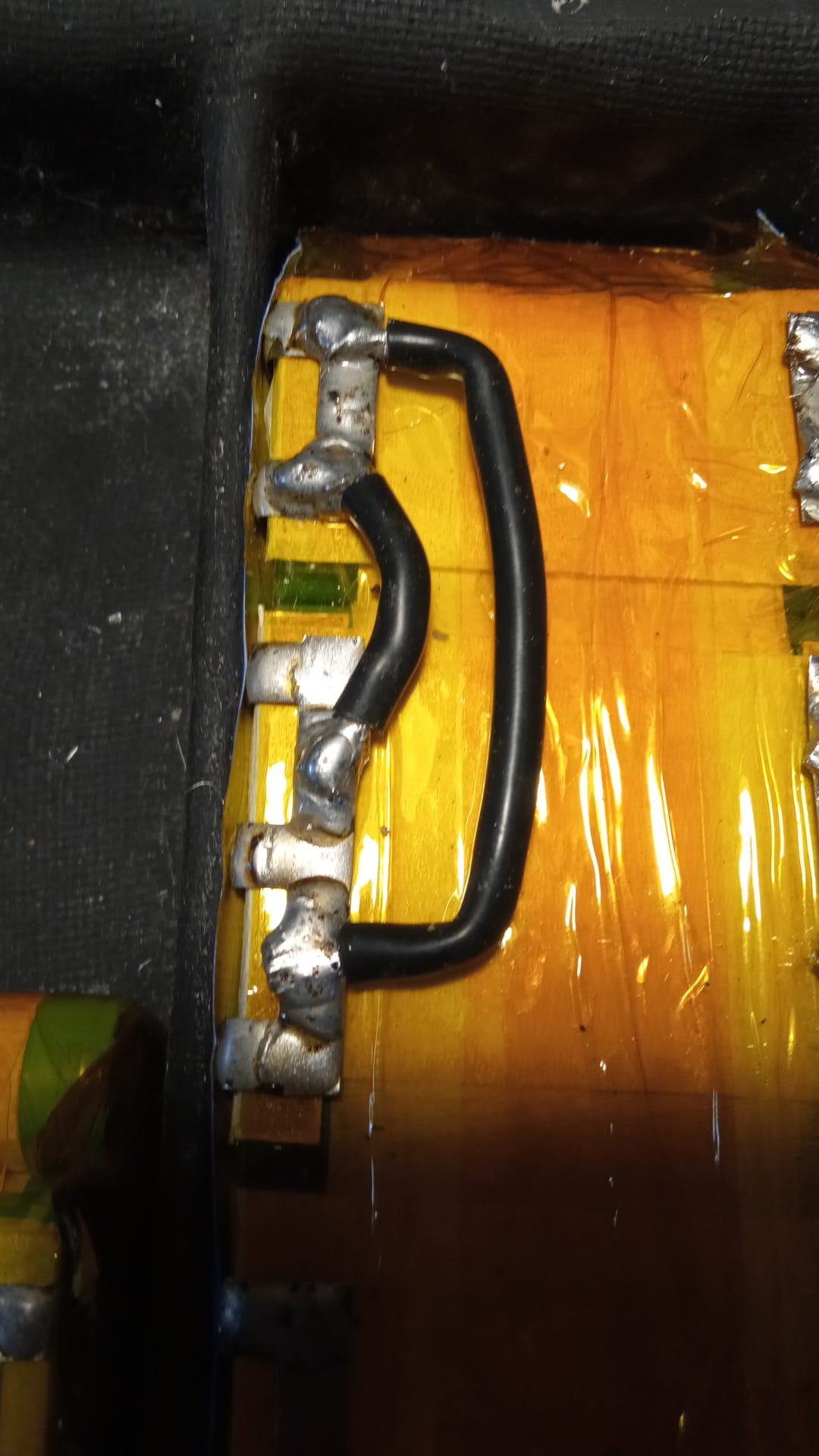

This soldering looks a bit suspect to me. Maybe its a bad pic but joints look cold and also looks like solder is wicking up the wire which will cause a higher potential for failure. What is the spec for this battery? I.e. how many amps will you be pushing, how many cells in parallel etc…

Use a fuse on the charge port that’s rated to at least the voltage of the pack (50.4V in this case), and a little higher than the current you intend to charge at. If you plan to charge at say 10A then a 12-15A fuse seems reasonable. The guidance from digikey (electronic components seller) is 1.33x.
Don’t use a fuse on the discharge lead (power going from the battery to the ESCs). A fuse here will indeed protect the battery from an overcurrent situation, but it’ll cut all power to the board, including brakes. You want brakes, being able to stop a board so you don’t die is more important than being able to potentially save the battery after a crash
I’m in Ireland and haven’t found a convenient source in Europe, I just order from AliExpress. There’s a thread somewhere here of vendors that users have bought from. The term “nickel strip” tends to turn up more easily in searches than “nickel sheet”, if that’s any help. There is a UK based seller of battery supplies who’s active on the forum, but he can be very very inconsistent with delivery times, even though he’s an otherwise decent guy
8AWG is almost definitely overkill. The received wisdom is that it’s 100% overkill. You may find charts of wire gauge and current ratings online that suggest 8AWG, but that is assuming a much much longer piece of wire. They calculate an acceptable voltage drop for runs of wire in a specific application, often building construction. 12AWG is the norm for eskate batteries because the voltage drop is much lower over a 200mm span than 10-50m
I’m much less confident about this, so bear that in mind. I believe any extra insulation provides additional abrasion resistance, fishpaper is particularly good but PVC shrink is better than nothing. I also believe that a big chunk of the heating effect in packs is from neighbouring cells, and that unless there’s forced airflow it’s unlikely to get a significant amount of cooling with or without an extra layer of insulation
I’ve learned something new… but I don’t have it at home (maybe the toaster have it inside) Can I use a something commonly found a bit less conductive like a coin?
if is 0.2V difference? Should I put them in parallel before hand? Or should I put them straight to the cell pack and don’t worry at all and let the BMS do the job later? (Molicel P42A)
