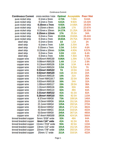

So if I have a 30amp BMS I can use 16awg?
Should be okay

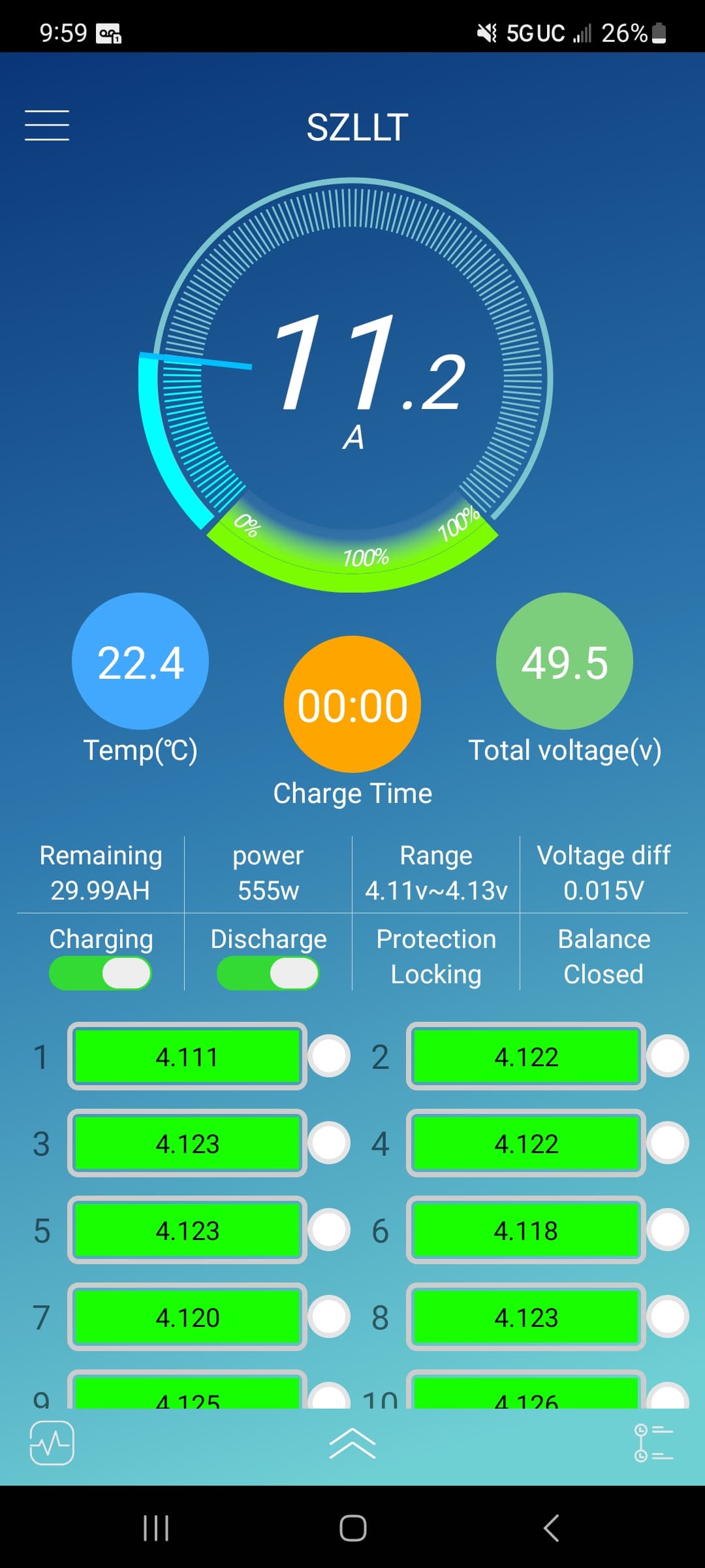

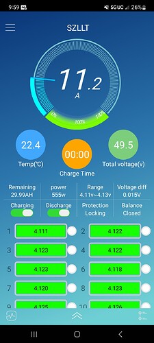

Almost forgot about this.
I love this thing! It’s nice and compact, easy to carry in my backpack if I know I’ll need to charge. The fan is barely noticeable and according to the LLT app (maybe inaccurate?) it’s actually charging at close to 11 amps rather than the advertised 10.
It has a built in slot for a fuse, right?
I’ve found that those bms aren’t always entirely accurate when it comes to that charge current reading.
Yeah, they’ve got an easily replaceable fuse.

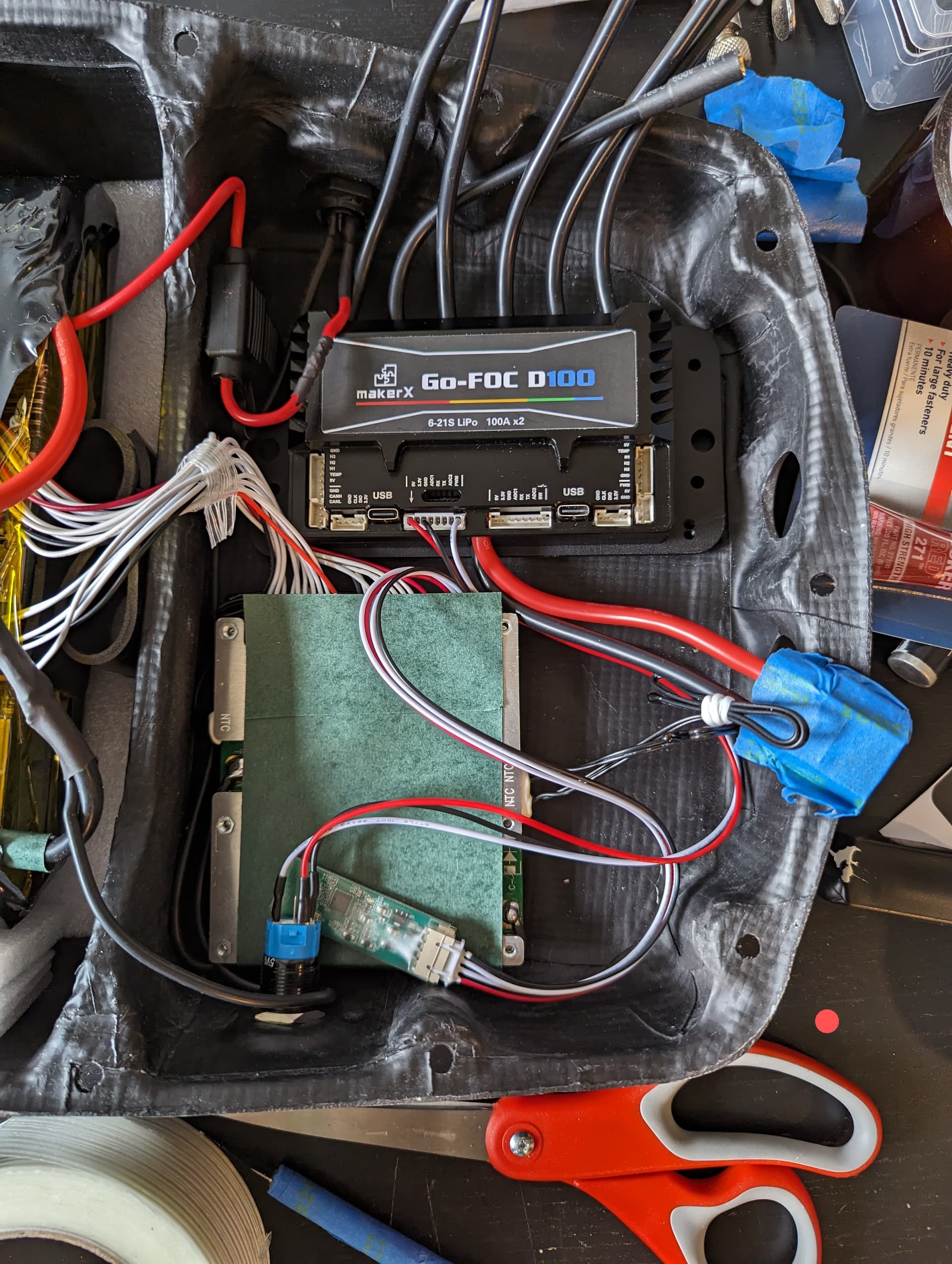

Do I need to run an anti spark or anything? Starting to get lost in the build haha. I feel like I know what’s going on and all of a sudden I no longer know what’s going on.
20amp fuse from positive charge to positive on the battery.
Negative charge port to C- on BMS.
Negative battery to B- on BMS.
Am I missing anything?
Looks great. Now to change and get that first balance charge baked in.
