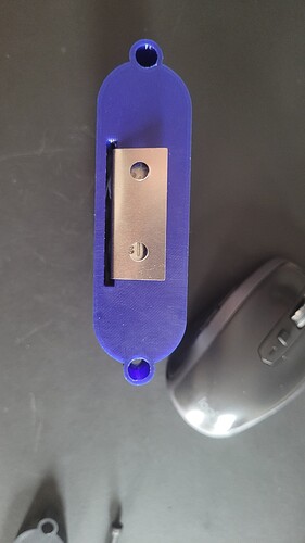

steadily heading towards punching the button on a K-Weld and I see most people cut their own Nickel strips, are ladder strips like Nickel Strip Ladder 2P 3P 5p 6p Pure Nickel 0.2mm for 18650 Lithium-ion – Battery Physics not much chop or is it an expense thing?
does the vesc bluetooth thingy show battery volts?
The ladder strips have been used with success but we long-ago moved to solid nickel as this has much better current capacity. 25 or 30mm wide is the standard here.
My vote, however, will always be pre-cut nickel such as that offered by Duck Battery Systems, Mboards etc… they make life much easier. Unless you have unique needs that wouldn’t be met by the pre-cut tabs, I’d go with that. Having built batteries a variety of ways, the cut tabs save a fuckload of time and energy and weld easily.
Yeah those are certainly the most convenient, unless you are building brick packs. I have 30mm nickel for that
For me it’s half lower trust in purity of ladder type nickel. Majority of buyers gotta be e-bike or off grid people, they probably won’t find out in practice that they have some fake strip bc lower currents, lower vibrations. That’s my theory. I’ve seen several fakes of die cut stuff.
I feel like the flexibility of having a wide uncut sheet.
Get the kweld. Print a good case. Don’t sharpen the probe tips. It’s great.
:face_with_raised_eyebrow:
I barely sharpen mine either
*don’t sharpen the beryllium copper probe tips for the kweld.
I sand mine with fine sand paper or steel wool (depends which I can find that day) to get the oxides and deposits off but I don’t sharpen them either, I try to rotate the tips as I’m welding so it has an even wear pattern and it’s been behaving
Thay don’t carry many amps compared to the 0.2mm sheets we use. All depends how you build the pack to the series connections CSA of nickel and your intended ampage draw.
Having the probes on opasit sides of the slit dose create a better weld. So way up the pos and neg depending on what spec you pack is to be used for
