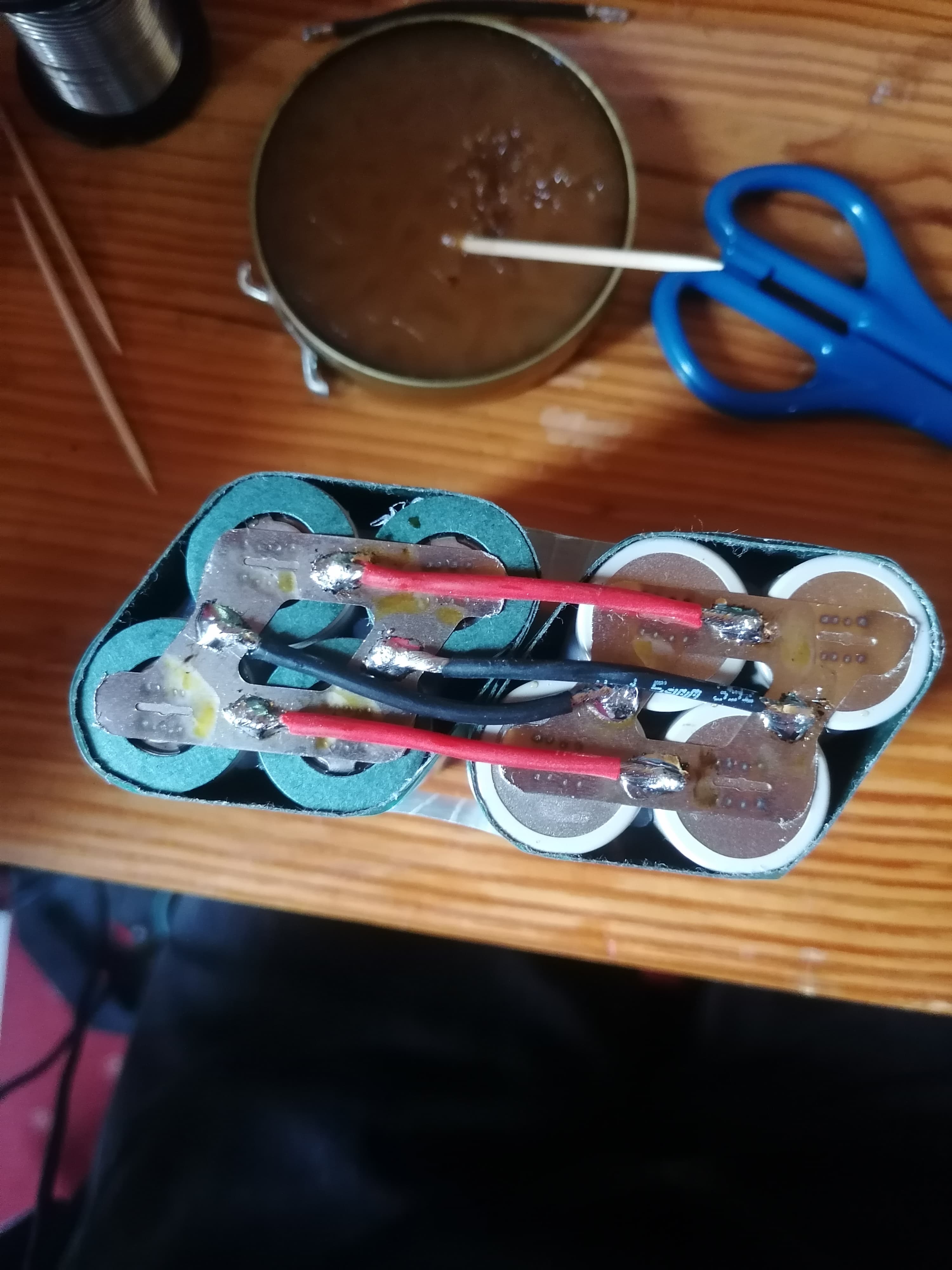

Made these S connections, opinions?
Lol yeah that was from their old china supplier
It took me a second to realize this was a printed guide and not a battery with chicken pox
that looks familiar
Holy hell, it’s insane to me that someone was actually willing to sell something of that “quality”.
