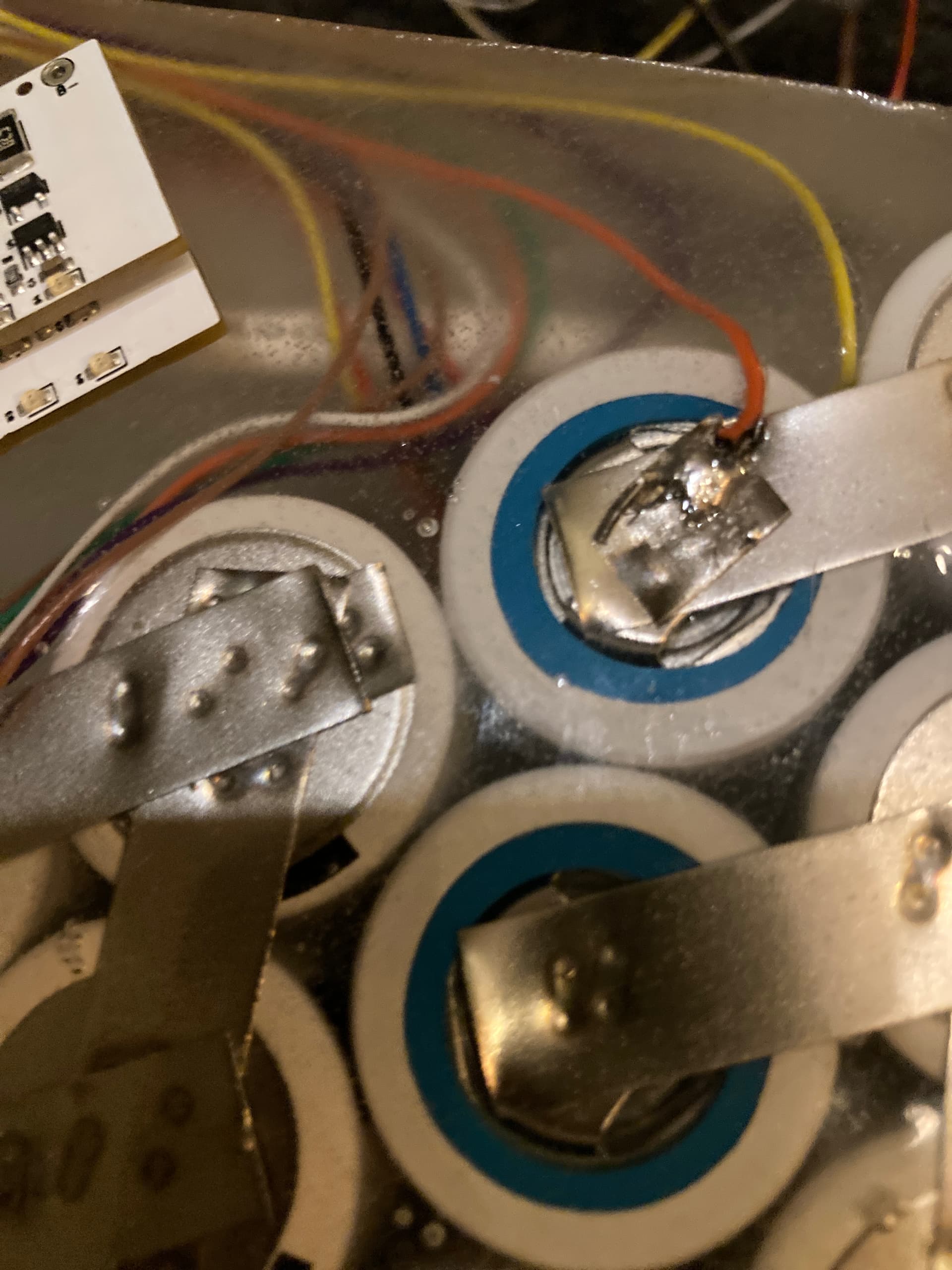

Hi guys, looking for advice in terms of AWG wires for balance lead. I have an existing 20S 8P Samsung 50E and am connecting all 21 balance lead in parallel to an other battery (20S 4P Samsung 50E) soo I don’t have the problem of having many BMS’s. I wanted same charging and discharging and it was the only option. What type of AWG wire should I choose do I want something a little bit thicker than normal balance lead perhaps smaller ? :thinking:. Just want to make sure am thinking about this logically. Maybe it dosn’t change anything just want some more qualified opinion than my own.
Maybe thinner balance wires are better because if they did short they would be more likely to burn up n break the short instead of dumping huge amps and possibly start a fire?
Thanks, do you know what type of AWG wire would do the job ? I don’t really know what wires are topically used in JST-XH.
I don’t know what’s standard or what’s good.
I’d say 24AWG would be a little on the thinner side. 28AWG i would say might be too fragile
This is not based on my battery cred, just my experience breaking 28AWG with road vibrations lol
Ive never heard of vibrations breaking wires if they’re multi strand. The thinner the inner strands the more flexible and there’s some thinner available. Makes sense to tack down whatever wires so they’re not repeatedly flexing if possible, but then again if the battery is meant to flex and the wires are tacked down then they’ll flex along a smaller area and a bigger angle and the inner strands are more likely to break. Maybe be sure to get silicone and not plastic sheath
Along the wire length…yea…that would take a lot.
But a soldered connection really concentrates the flexing stresses and stranded wire often breaks where it meets the solder.
I think the balance wires are the most dangerous part of the battery. So many of them and if one gets loose and shorts it can be big bad news. Maybe not but I think thinner wires are safer so they burn up before the battery does

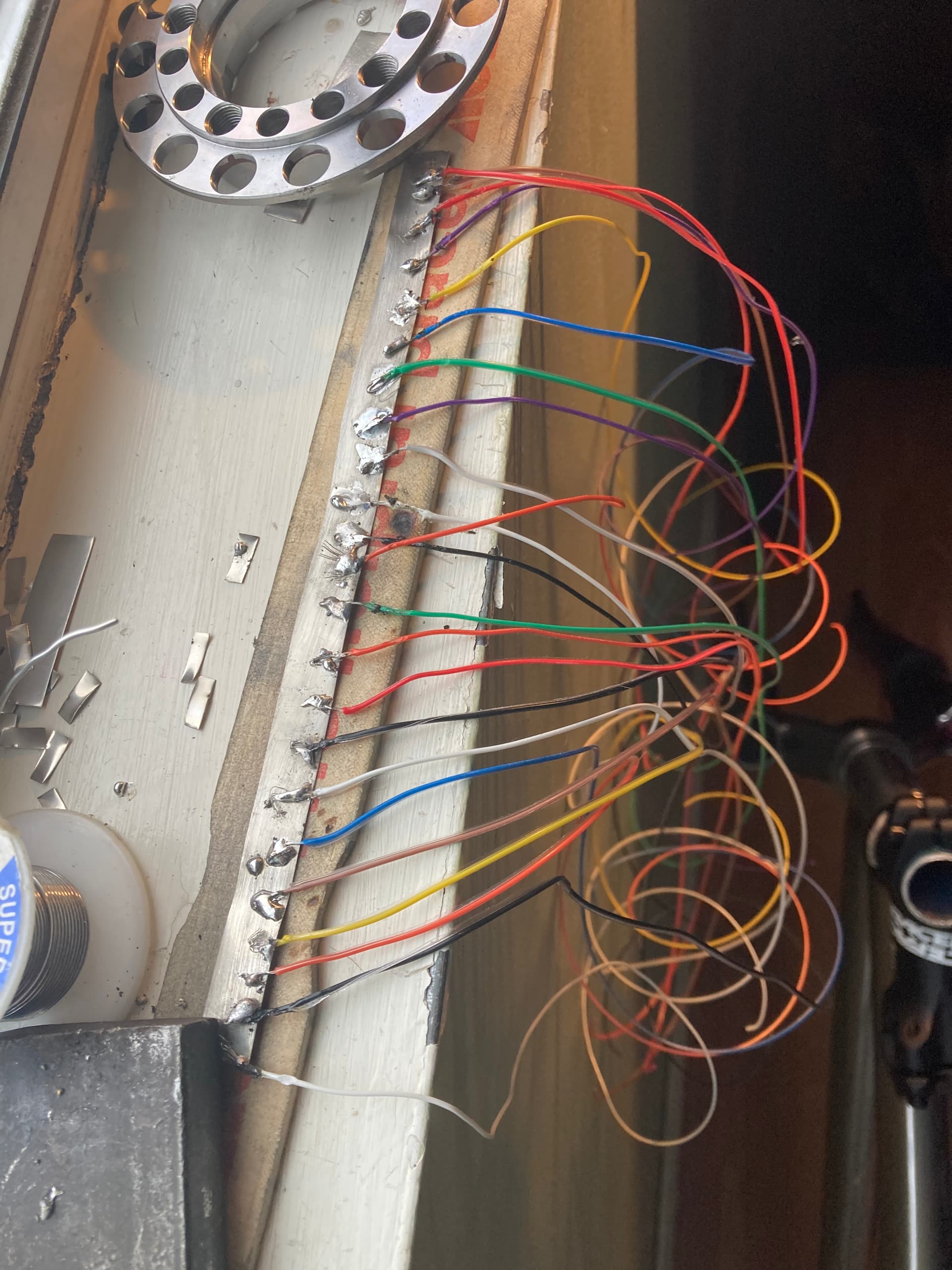

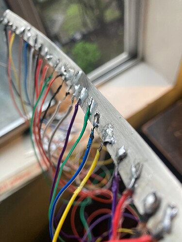

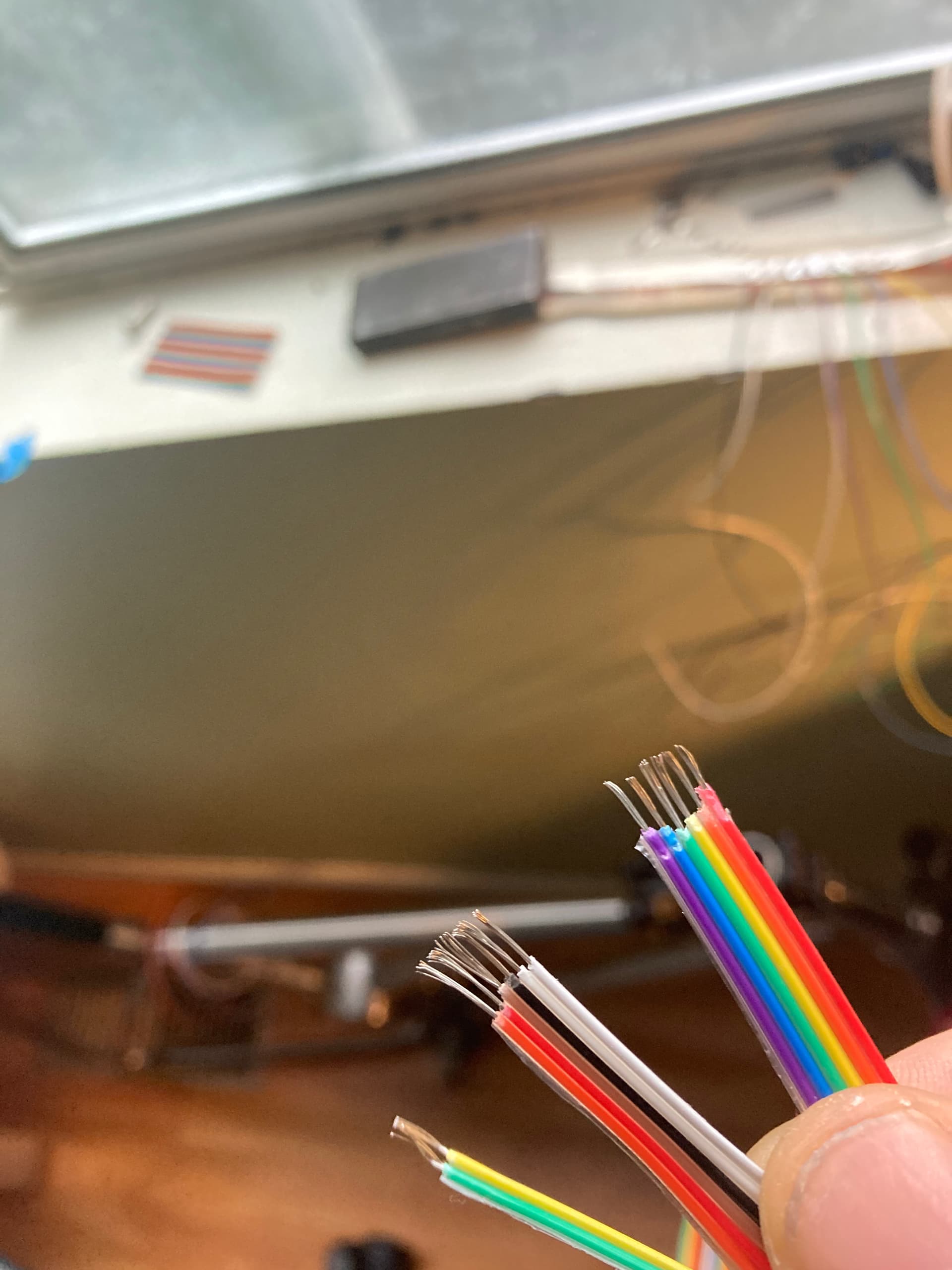

I soldered my balance wires this time.
It takes a long time 24s.
Sand, bite, solder, cut.
No wonder u hate soldering mate
What on earth are you using to solder? Metal rod heated in a caveman fire?
60/40 lead solder.
Does it have a flux core? This is pretty much mandatory for good solder joints.
Looks to me you might need a bigger soldering tip to have more thermal mass
