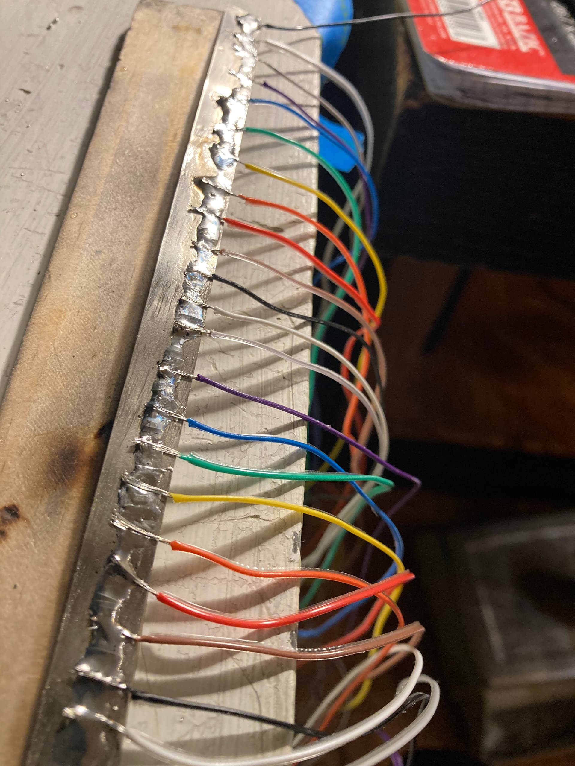

Yea flux core.
It’s a small point iron. It’s a tiny wire. It’s not beautiful but solid.
A lot of those joints look cold and ready to snap off :grimacing: Definitely not safe enough for the vibration full environment PEVs live in. A different soldering iron tip should work wonders
Nah bro just better technique, you can do balance wires with about 2 seconds of heat on a small iron, using proper technique
IDK, with a decent iron I think you’d have to work to get results that bad. @hummieee are you using a small 15 W non-temperature adjustable unit or something? A better iron will make all your soldering easier if you are. Either larger or more powerful and temp controlled or both. They aren’t expensive either. My current iron is https://www.amazon.com/gp/product/B09GJ2NJVX which also requires tips and a DC wall wart if you don’t have one, but can make solder joints to nickel much better than those in a couple of seconds each easily.
I forget what iron I have bit a simple single temp n single small pointy bit. May not be pretty but they’re solid. Wire this thin I find springs off the nickel and doesn’t lay. Strong enough to last till potted for sure and then has no stress on it

Oh that is a very bad sign, sounds like more a fire starter than a tool for high power electronics.
Jokes aside, there really is a strong line between efficient DIYing to cut costs, and saving a penny to lose a pound. Soldering a $10 arduino project that runs for two weeks powered by a 9V cell is very very different to a multi-kW battery pack for an EV. The tools are expensive, if you’re building a single pack and don’t already have gear it’s not cost effective to DIY it the majority of the time. I know you’ve made packs before (and provided excellent decks and motors for the rest of us to use), but using a dollar store death trap is not going to yield good, safe results. Especially if you’re not going to invest the serious time and luck into technique needed to wrangle an iron like that.
You have said yourself you don’t like to use soldering because it pushes too much heat into the pack or doesn’t give good results; this is why.

I think these look much better and went much faster

Use a chisel or truncated conical tip, not a pencil type. I guarantee you will have better results.
Even when doing small SMD shit or breadboarding, I basically never use the conical pencil tip. It’s always a small chisel, or a truncated conical. It just works so much better.

I first put a bit of solder on the nickel, then on the wire, and then mash them together.

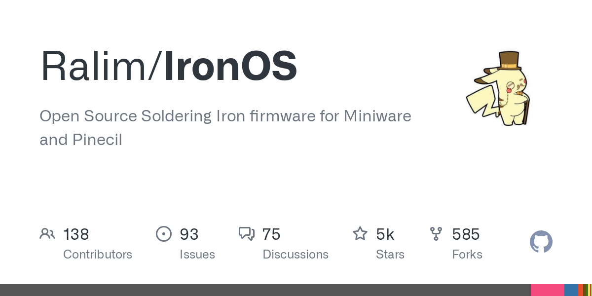

Did you install custom firmware on the TS100? Enables up to 450C vs 400C

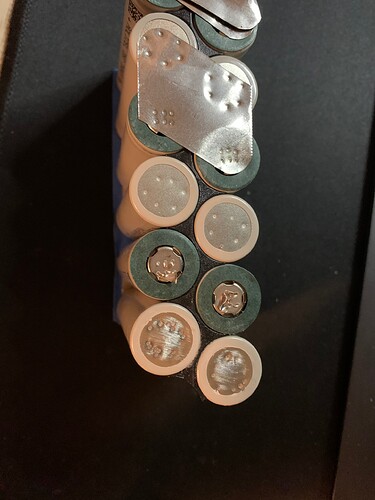

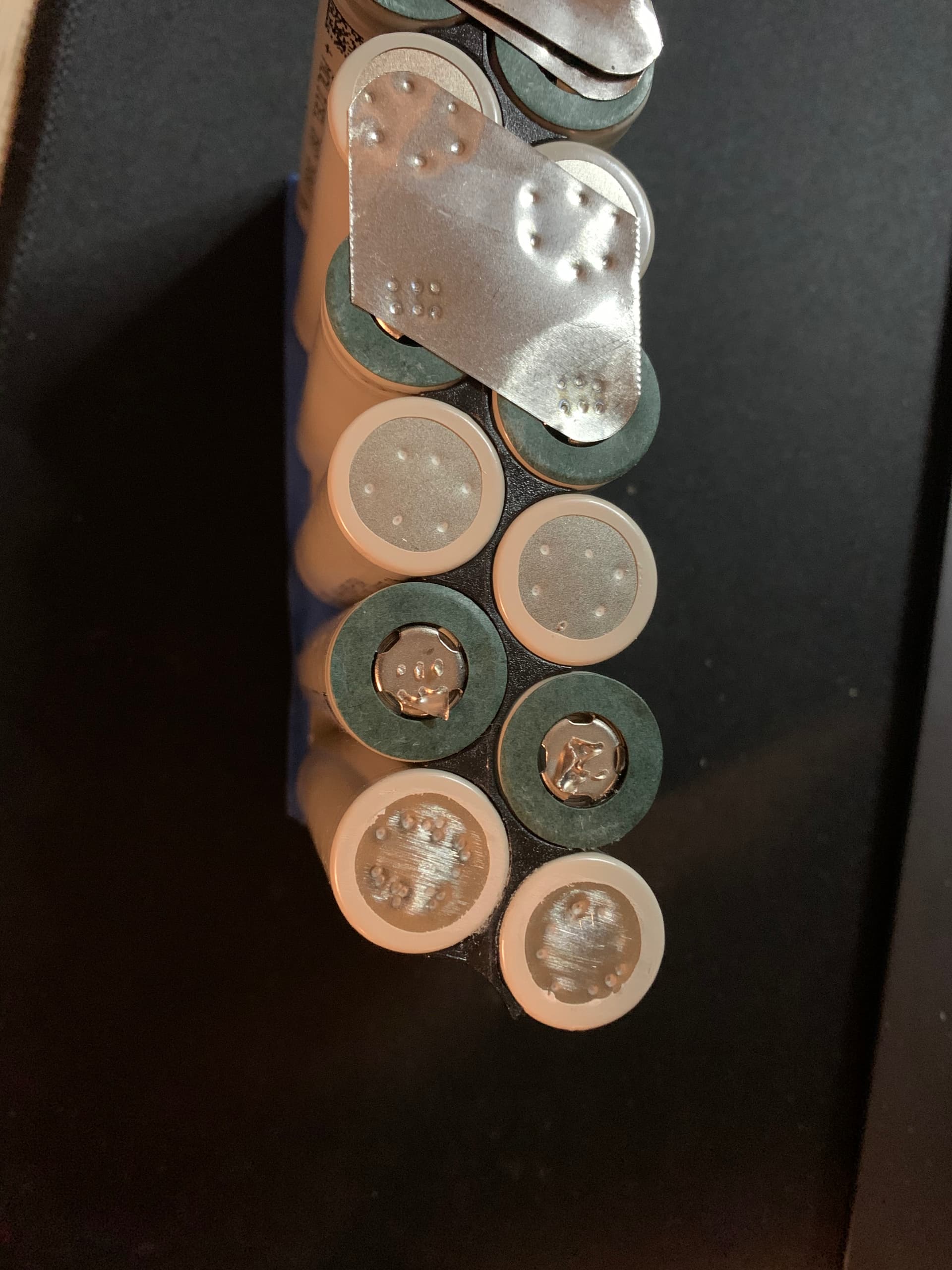

For the life of me I can’t get this batch of P26A’s to weld, the positive side is totally fine but the negatives are refusing to hold even at 50J
Kweld with 6Ah lipo, 0.15mm nickel
Was supposed to be a quick and dirty 12s2p while I procrastinate the 15s5p but now it’s deciding to be a bitch :expressionless:
try 60J
if no bueno
70J
