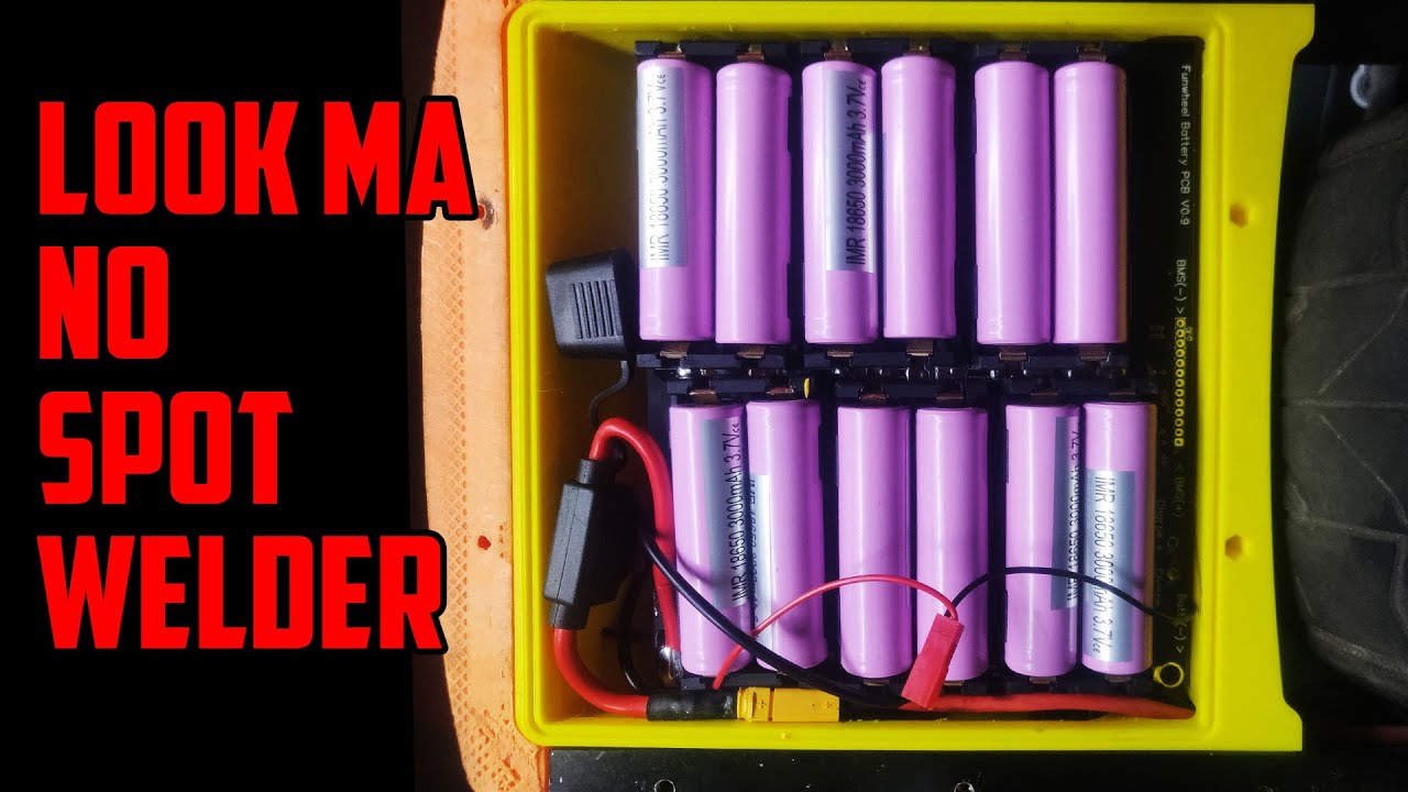

Has anyone tried one of these on an esk8?
https://www.fungineers.us/products/pcbbattery

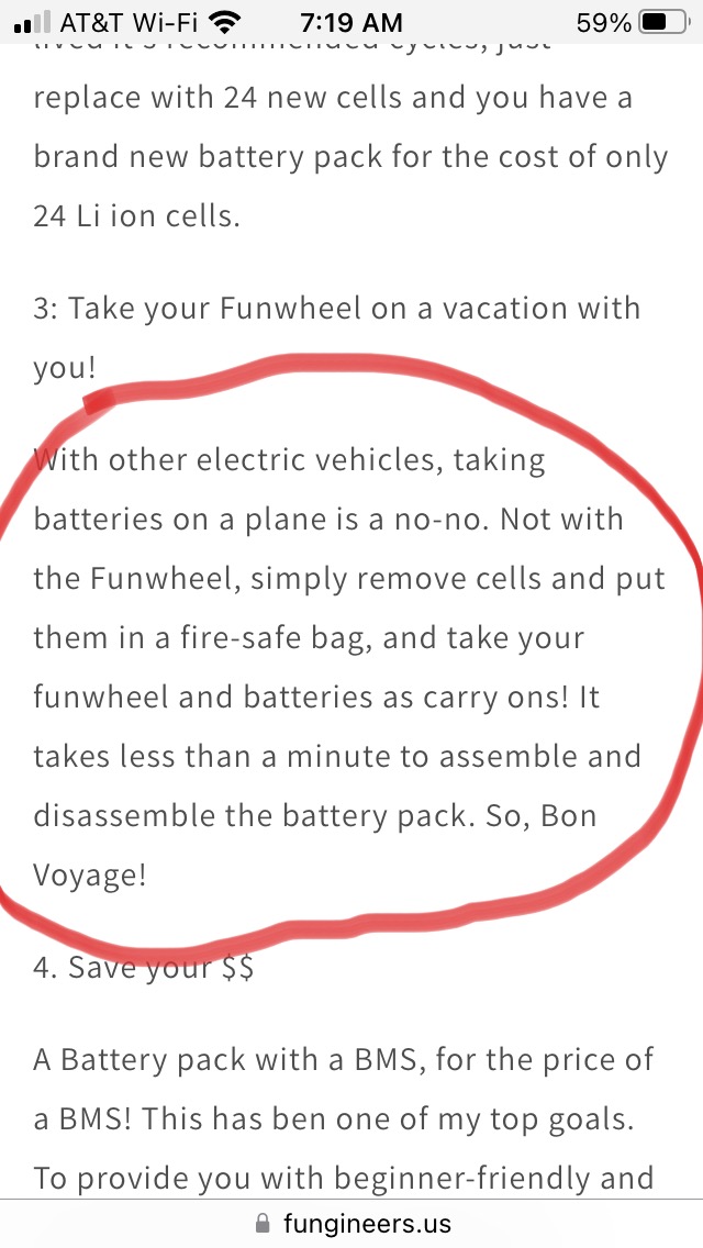

How dangerous is a bag of loose cells? Even in a fireproof bag I think 24 cells smoking up a plane cabin … makes me not want to get on the plane.
And states 30 amps output from each cell through a leaf spring?
Leaf spring connections on something prone to shock like a skateboard?
