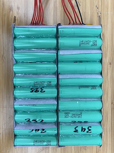

Does everything look fine with this?

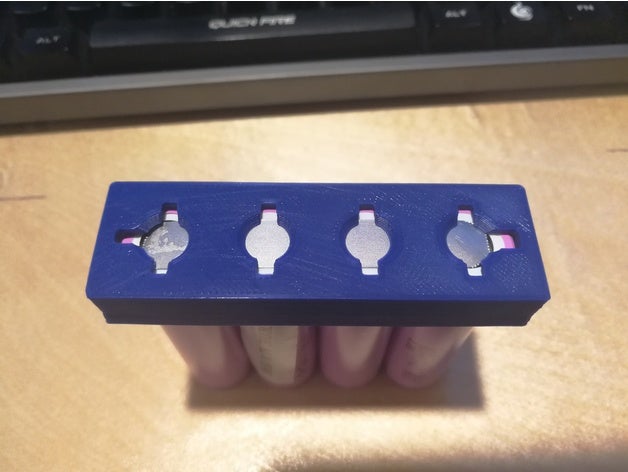

I made this thing to help with that. There are a few remixes for different cell size and nickel pattern if you search here and on builders.
Cool idea!
Pack two finished.

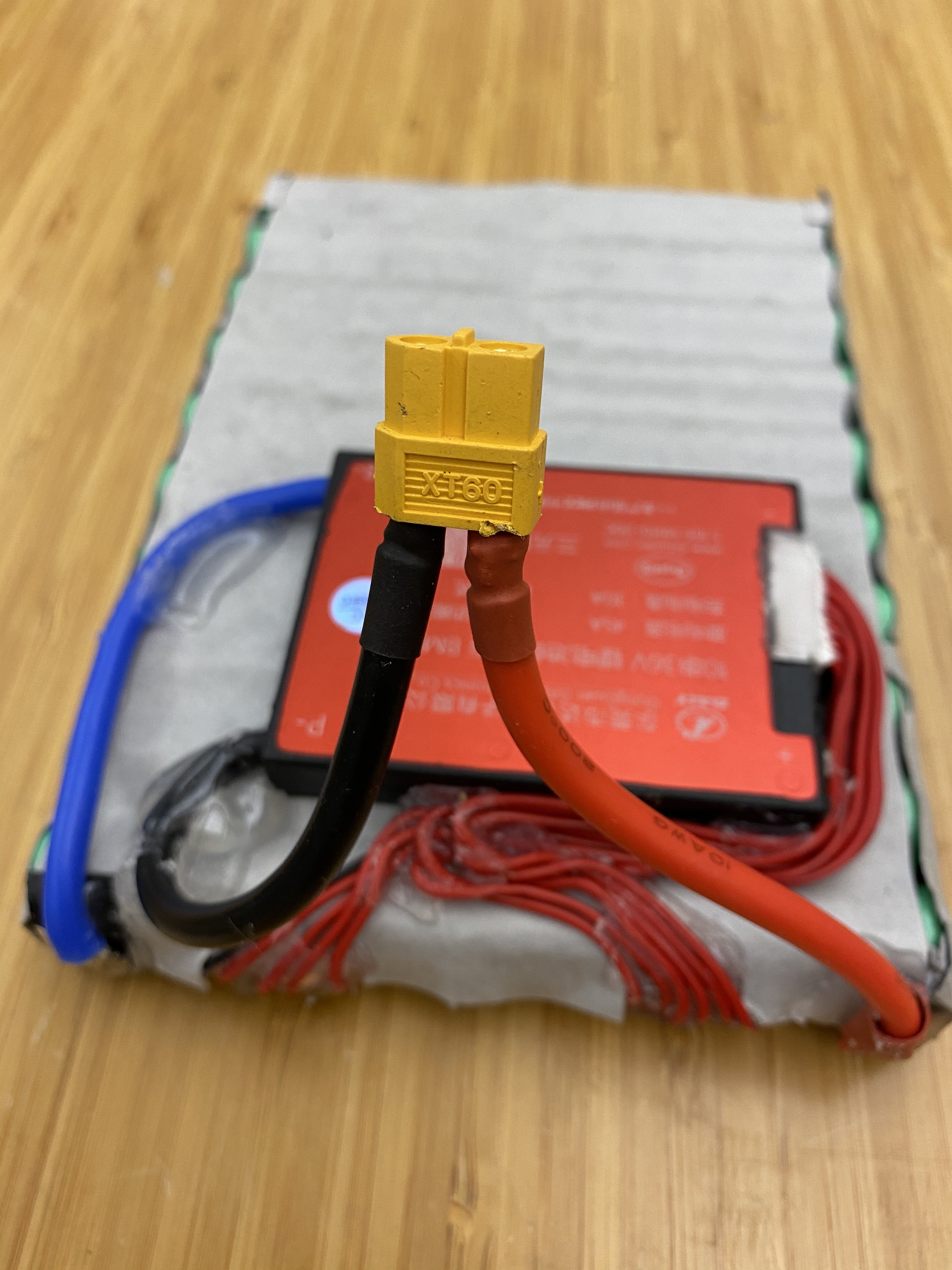

I’ve not used that welder but I’ve seen others being advised to use the internal rather than the external for consistent welds
Packs made that way can break at the series connections due to lack of flex.
Make sure it is securely mounted and that it is not submitted to any type of flex.
That’s what I actually used for my first battery. It was way worse than this one…
Thanks for the tip.
It will be mounted in a stiff enclosure on a stiff short board. :ok_hand:
