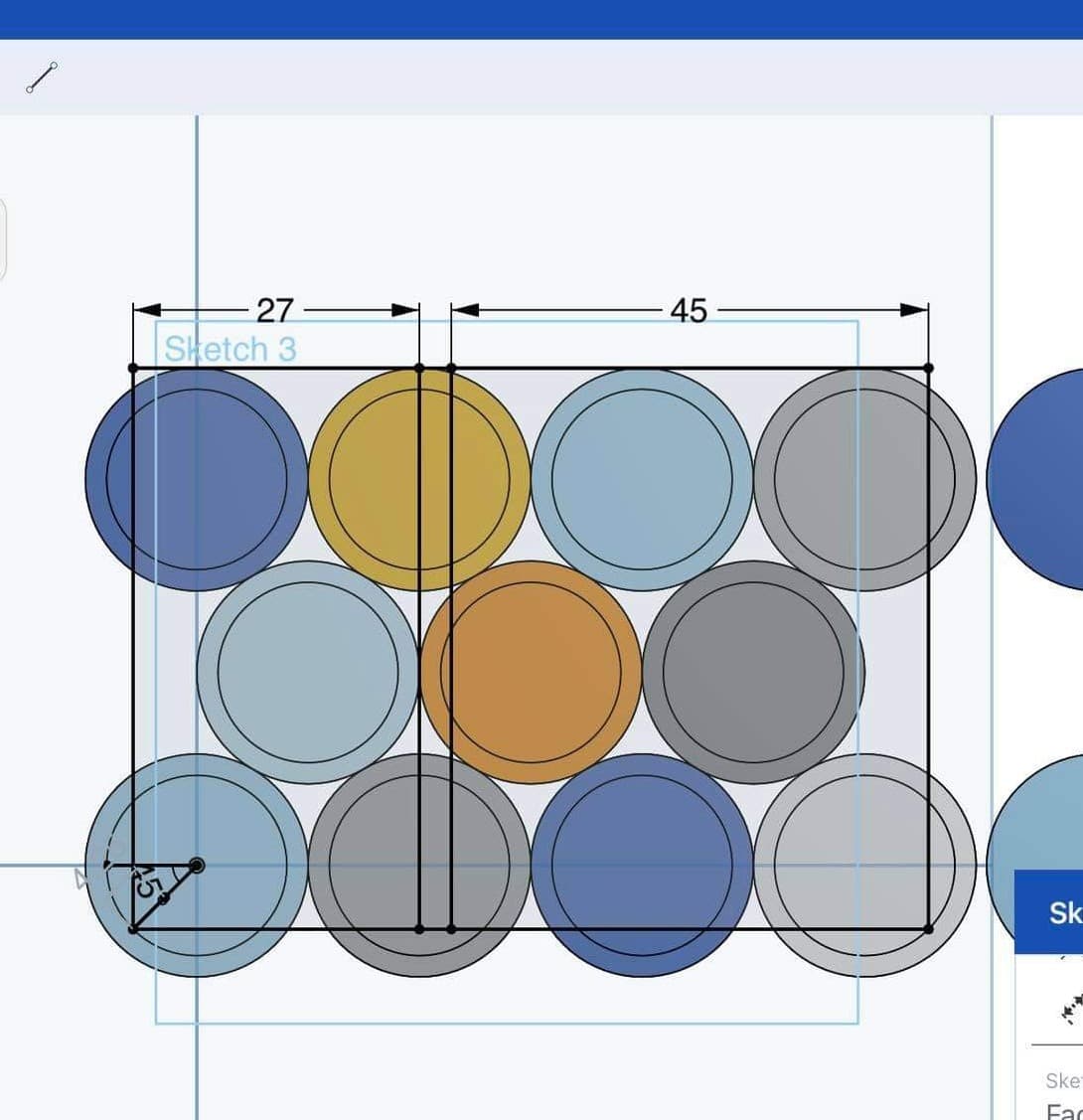

Hi folks, sourcing nickel for my next build and wanted some feedback.
I’m planning on triple stacking M50LTs in a staggered pattern to form an 11p group.
The challenge is finding any reputable nickel strips wide enough (~65mm) to overlap all the cells and fold over the top with enough real estate to solder wires to.
Instead of using one beefy strip, would 45mm and 27mm strips be good enough for esk8 standards? Should I overlap the strips (only soldering spot welding the strips together, not to the cell)?
My only concern might be balancing if the nickel doesn’t overlap, but the currents are super low for that so not a real issue.
Sketch below for illustration.

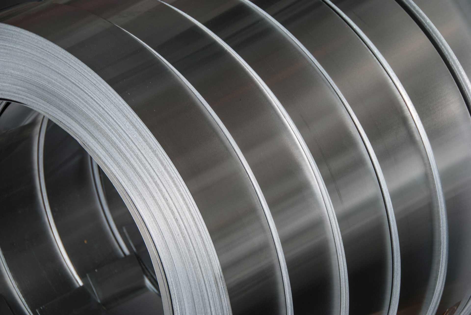

I ship 200mm wide nickel from the UK if thats something you’d want… lets you effectively cut any shape you want
This might be it.
@Anubis, one question though, if I were to order 5 pieces, would it come as a single continuos 1m strip or 5x20cm?

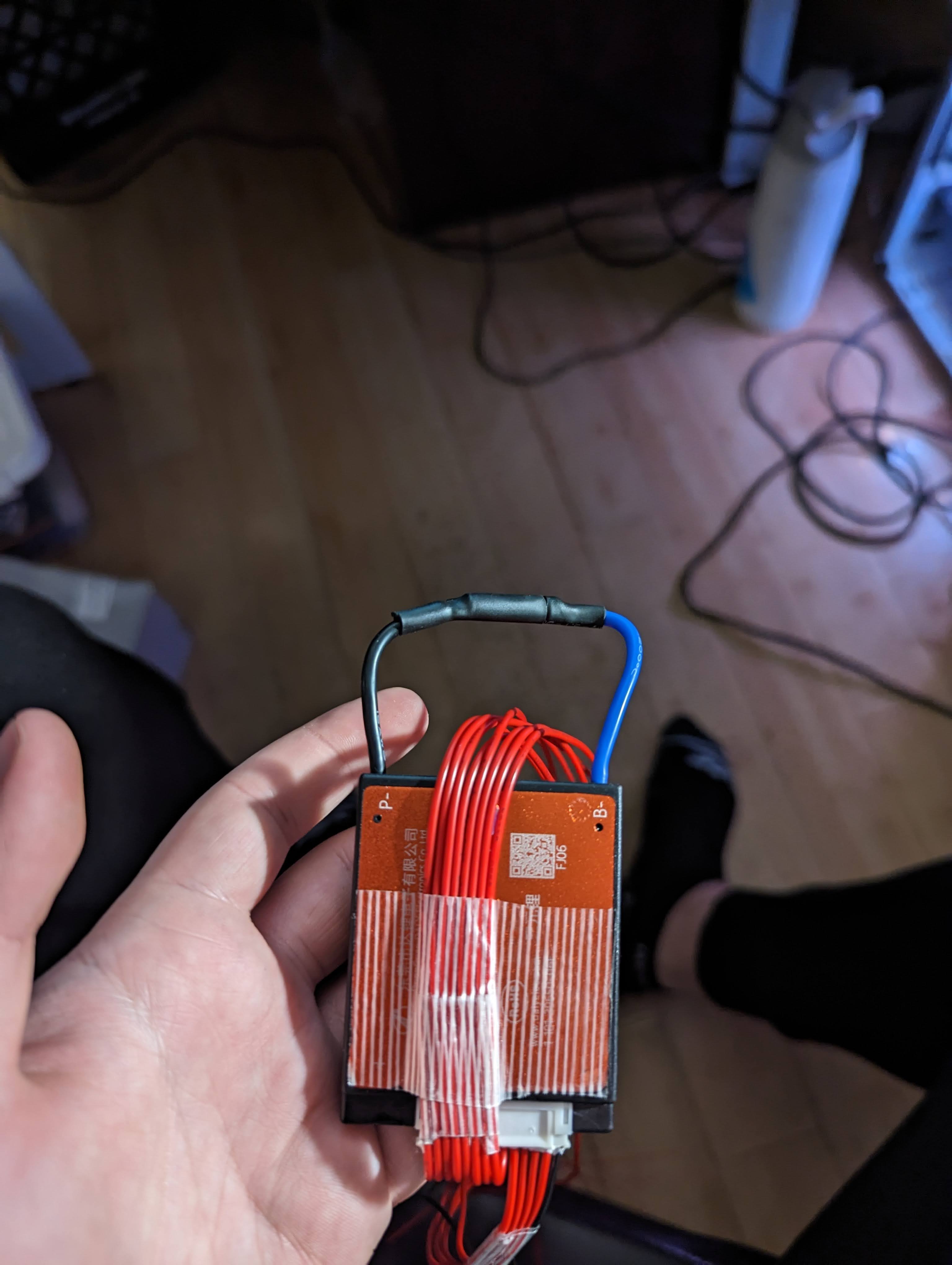

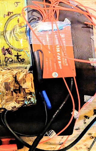

Anyone familiar with Daly bms with the temp sensor? Built a 12s3p, all bms pins add up sequentially, voltage from the discharge reads correctly, but I don’t get a usable or even stable voltage reading from the charge port… I’ve always been able to read voltage from the charge port, but I’ve checked everything and battery builder friend has also looked and we can’t figure it out other than this style of bms with the sensor is causing the problem…
Is there a specific reason that you need to get the overall voltage from the charge port? In my experience getting voltage from the port can be a bit dangerous.
My only thought would be that the bms blocks discharge through it in order to make sure that it is wired for charge only.
Also I see that you are using a 13s bms on a 12s battery. Did you take the proper steps to ensure that this would charge right?
I have a battery meter that I plug into different boards’ charge ports over the winter to more easily/quickly check voltage. And, I joined the 12th and 13th balance leads near the bms plug and connected the one lead to the 12th group/main positive. We even checked it with thermal camera after connecting it all to a 2.5a charger and nothing was getting hot.

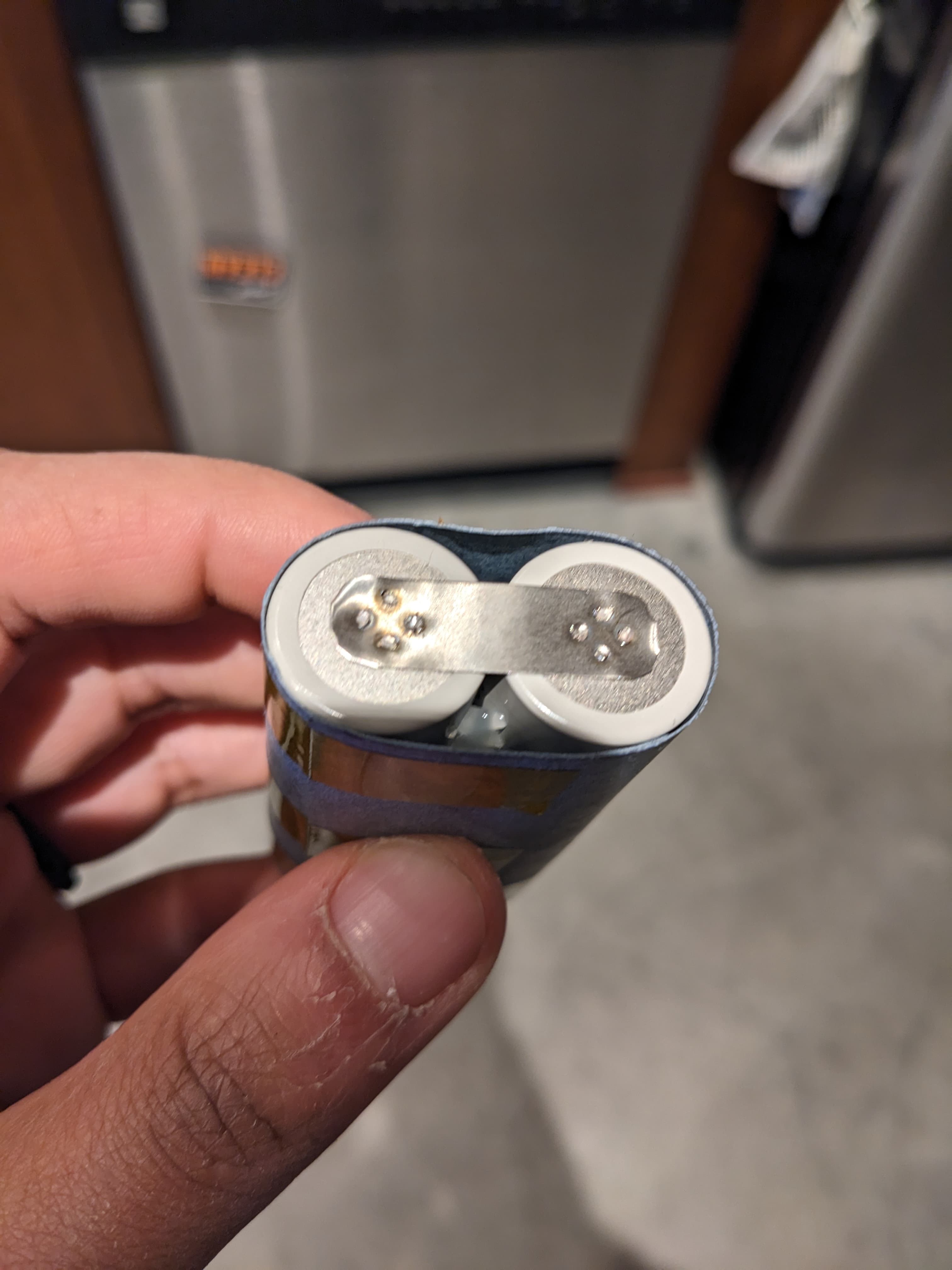

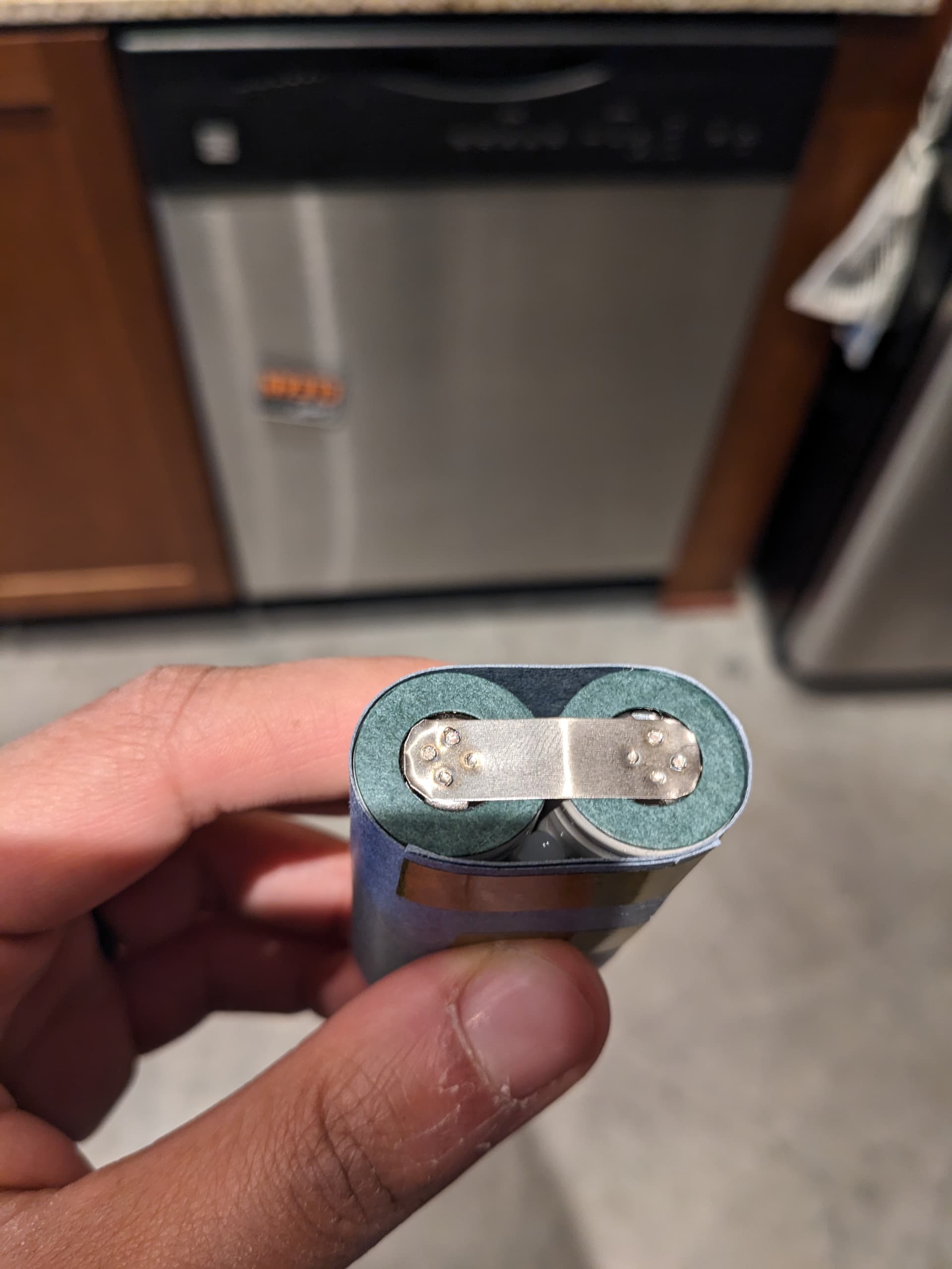

Howdy folks,
How do does this look?
Should add more welds?
