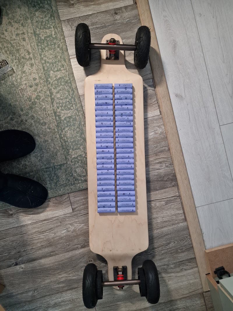

I have a couple of questions.

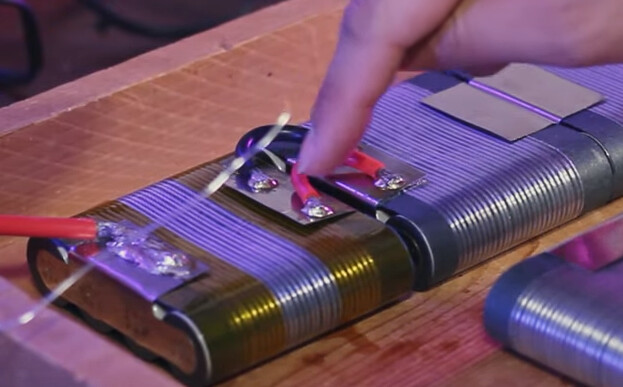

By my understanding, most flat battery packs are built like the image below. I can see how this is better for space efficiency and flexibility. Out of interest, does there need to be insulation between the P-groups (below where finger is) or is it fine as is? I’d imagine there is a risk of sparking if the two groups accidentally contact each other.
Anyway, my battery is going to look a little different:
This is for a couple of reasons. Firstly, my soldering iron is a bit shite, and I don’t want to risk loading excessive amounts of heat into the cells, hence why I’ve minimised the amount of soldering required. Secondly, my deck is rigid, so I don’t need flex in the battery.

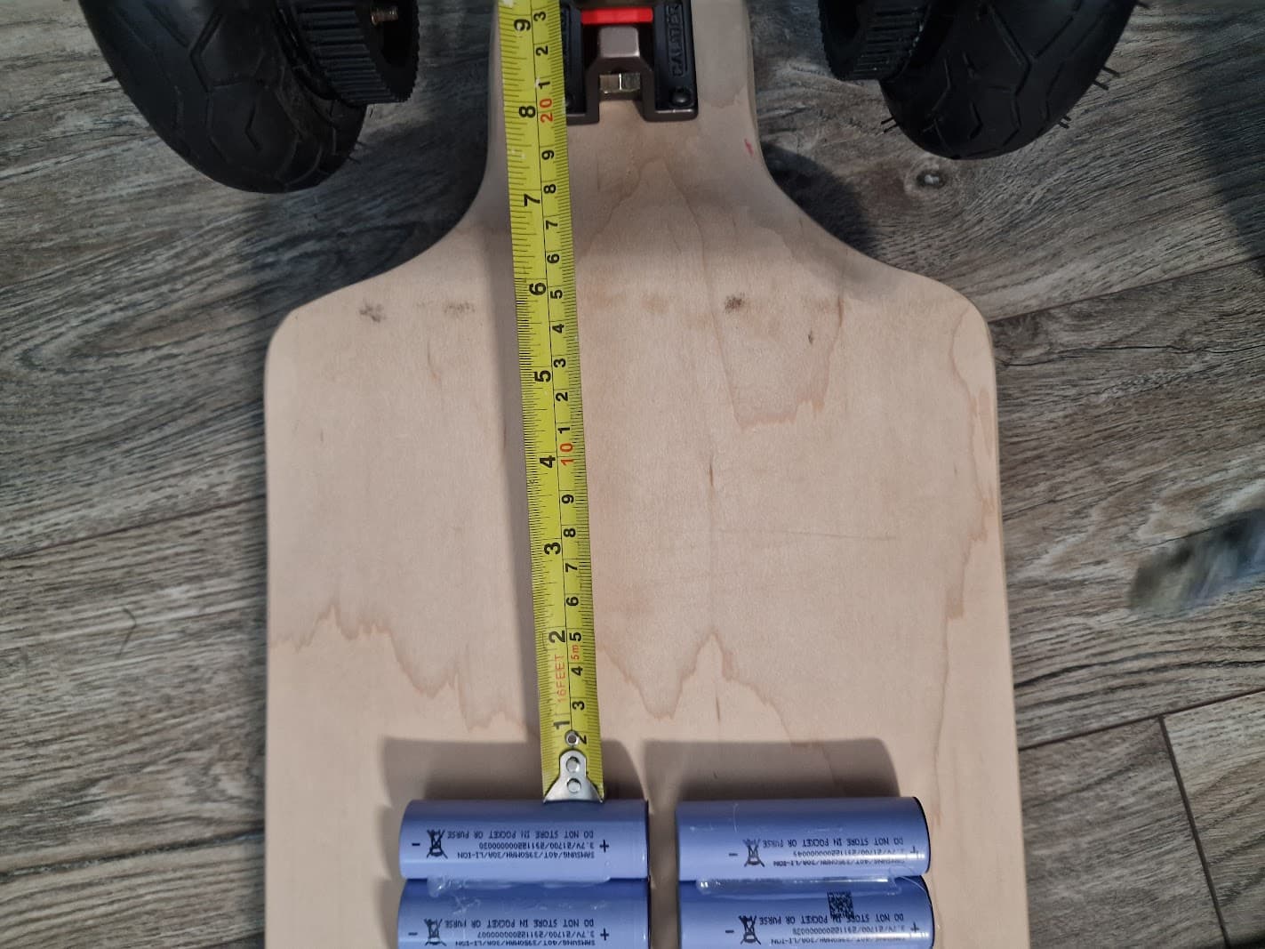

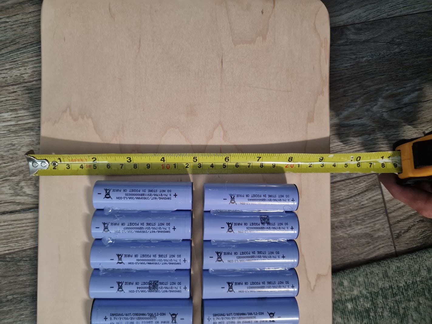

I am a little bit concerned about the space this will take up.
I haven’t yet decided on an ESC, and I will be building a custom enclosure. Do you think an area of approximately 17cm x 13cm would be sufficient for the rest of the electronics? (BMS, VESC, cables & connectors, etc) The enclosure height will be 4-5cm maximum (I may shape it such that it is tighter around the battery, and has more space around the other electronics) . These are all estimated figures.

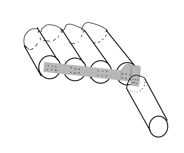

Secondly, would bending the nickel here be a concern? Could someone provide an estimate for the minimum bend radius of 0.12mm thick nickel? Or would I be better off soldering a wire between the two strips?
I’d also like to mention that I will be insulating over the top of the nickel strips in each P group to prevent the groups coming into contact on opposing sides. Would a single layer of Kapton tape be sufficient for this?
Finally, I’m a bit confused about wiring the BMS balance leads to the positive terminal of each P group. As the groups are all connected in series, how can the BMS distinguish between the groups?
I have ordered the fish paper, kapton tape, nickel and spot welder but most of the items won’t come until later in the month so I have plenty of time to ponder over this before committing to the build.
Thanks in advance.
No, as the wires bring both sides to the same potential.
Gonna be close, but depends on your BMS and ESC.
Bending is not a problem, however the cross section for that nickel is very small, hence it will heat up with current draw. Its not uncommon that it starts to glow red in those locations. Avoid such a setup at all cost. This is also the reason why the wires-on-top setup became popular, with the added benefit of being able to flex.
The voltage will rise with each group by a specific amount, enabling the BMS to distinguish and balance all groups.
Boards tend to vibrate quite a lot, so one layer of fish paper would be a minimum, a hard plastic spacer would be preferred.
Thank you for your reply. Regarding insulation between each side of the pack, I was considering 3D printing an insulating container for each P group anyway so that clears that up for me. For the nickel at the end, would something like this work better?
