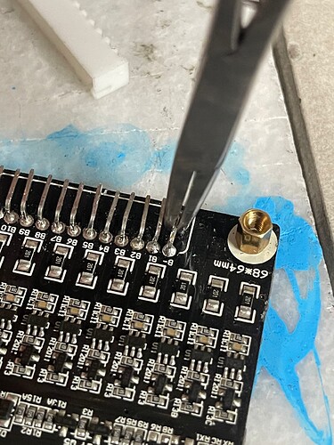

I plugged in the balance lead with reversed polarity….twice. :triumph::roll_eyes:

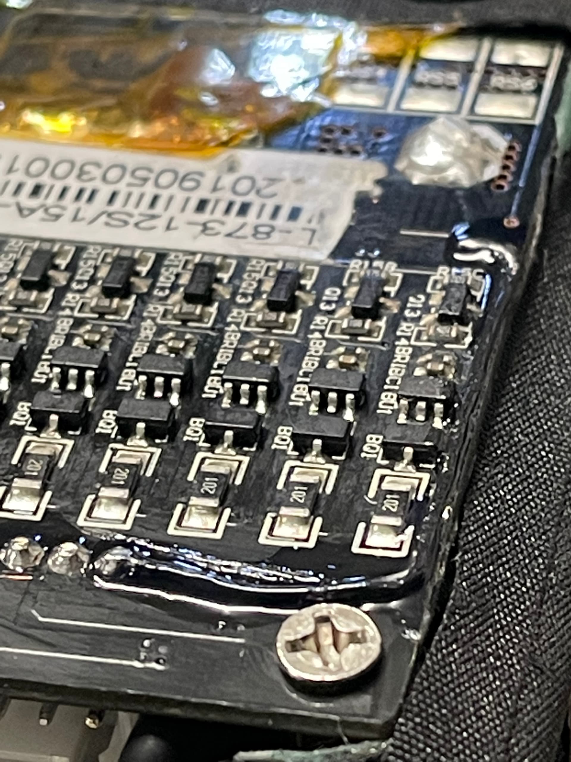

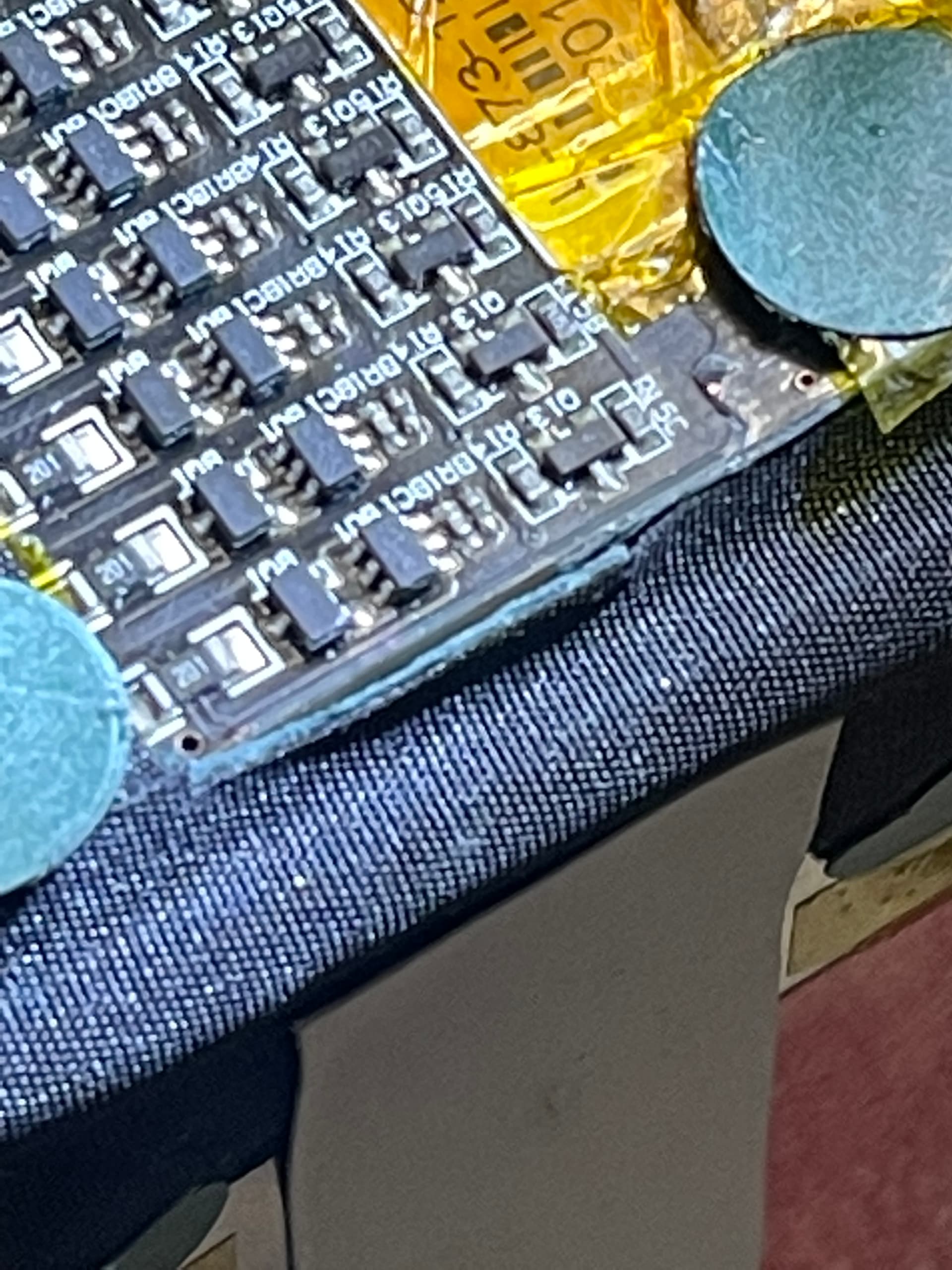

Repaired burned trace, swapped out new jst connector and burned pin.
Bms was wrapped in fish paper and kapton. I assumed the polarity of balance leads was like 90% of the other bms’s I have encountered. I was mistaken.
Lesson learned:
Verify bms input labels on the actual pcb markings.
So frustrating. :face_with_symbols_over_mouth::face_with_symbols_over_mouth::face_with_symbols_over_mouth:

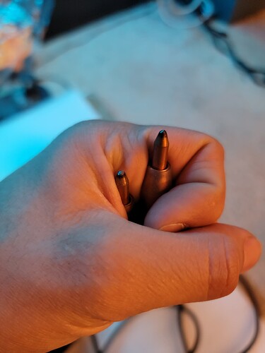

How pointy are your tips?
Not too crazy
I usually file off the blackened part before welding
Damn son, you need to sharpen dem tips
Really? Mine look like that too, and they weld fine.
I used to weld with tips like that with minimal issue, but the welds seem to go down better and more consistently with sharper tips
I get mine about as sharp as a marker, and it’s good for about 20 cells before they need a cleaning

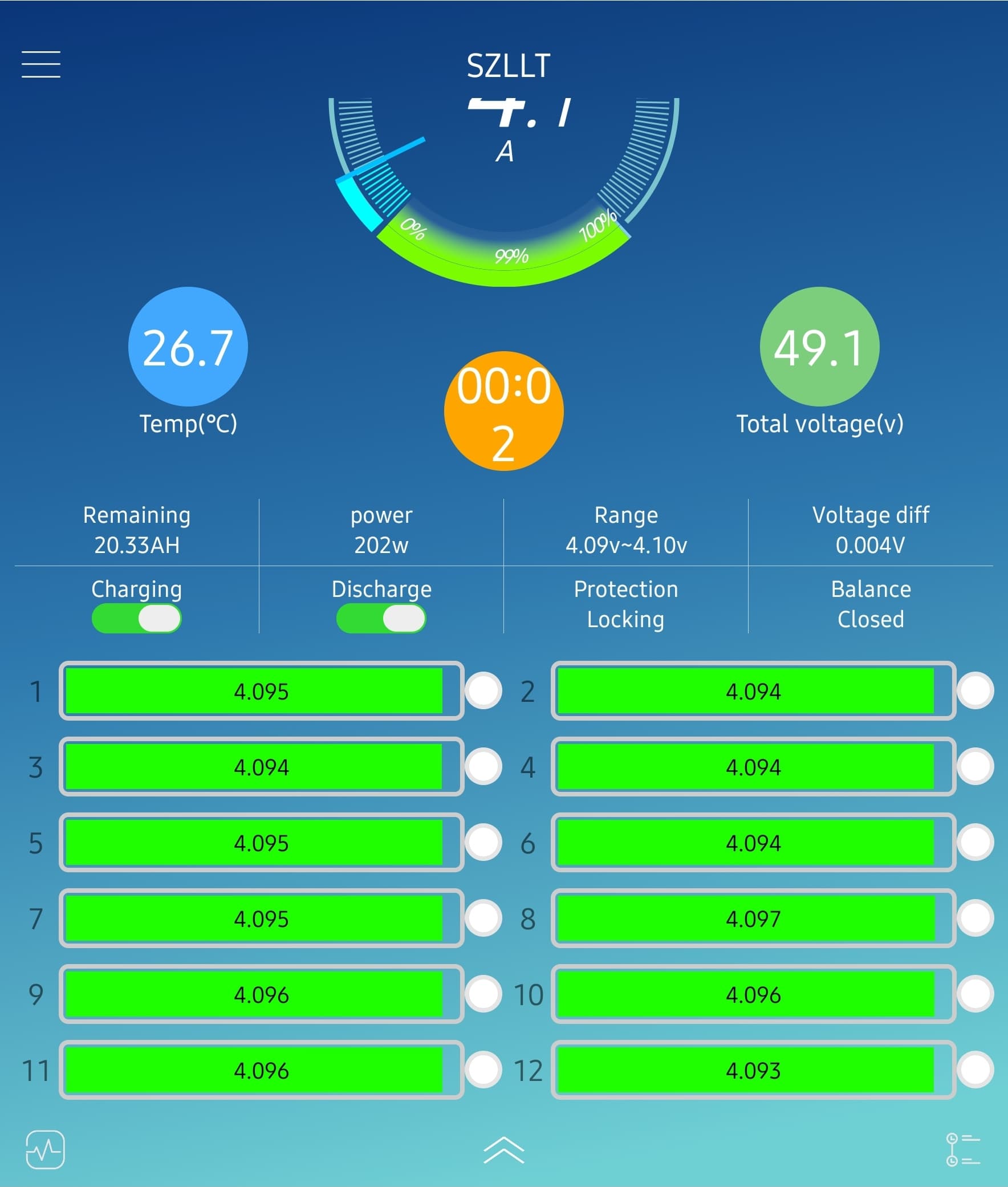

I’ve never had a battery this well balanced. All groups sag together with no mismatch alarm. I’m going for another ride bruh🤙🏿
