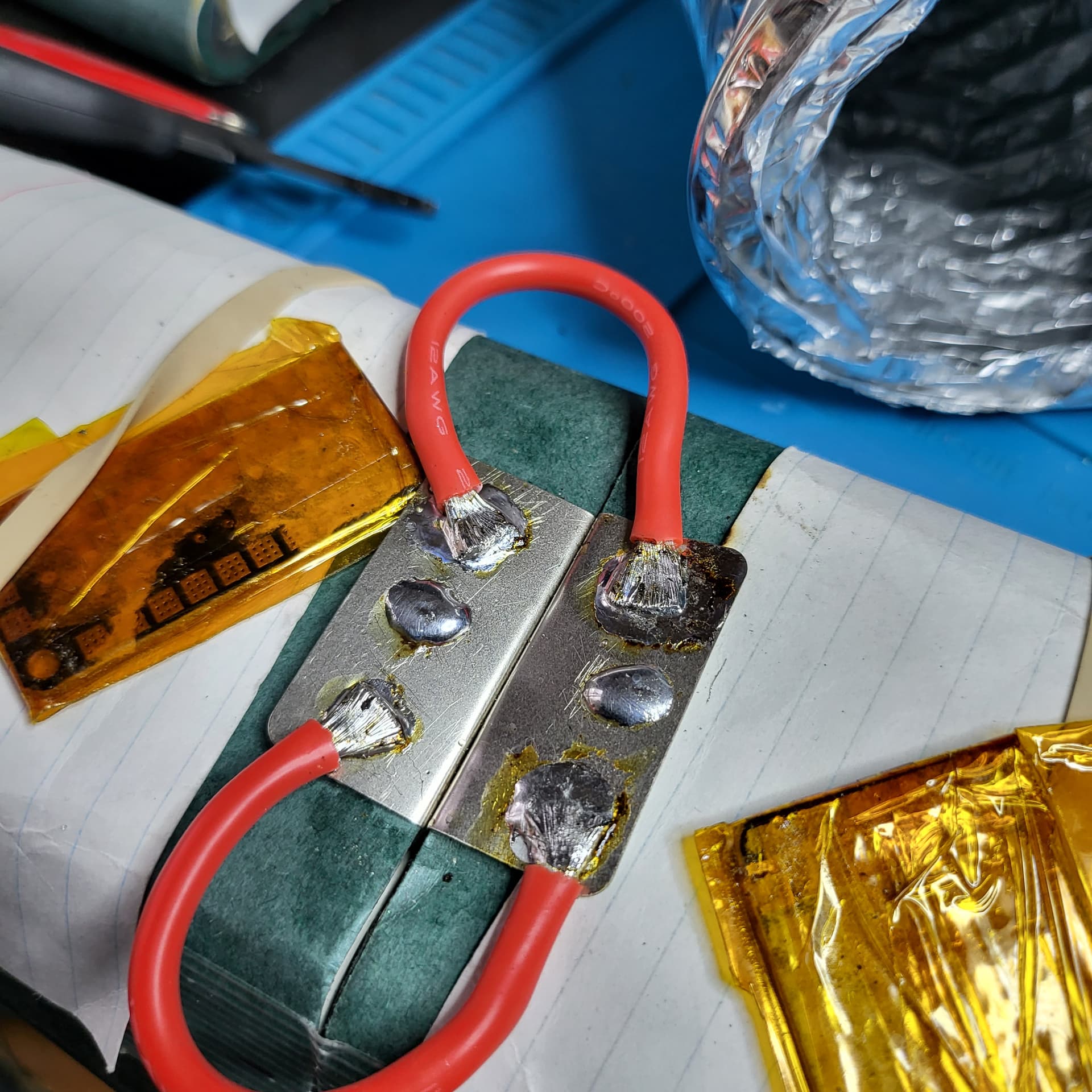

Two 12awg will do close to 120a ~ok~. Imo it should be fine for that use, just mark the outside of the pack so you remember if you repurpose it later .
The extra solder wont hurt anything as long as it’s not in your way or anything. Just doesn’t look as clean but that’s why we are here, learn and make kick ass skate batteries

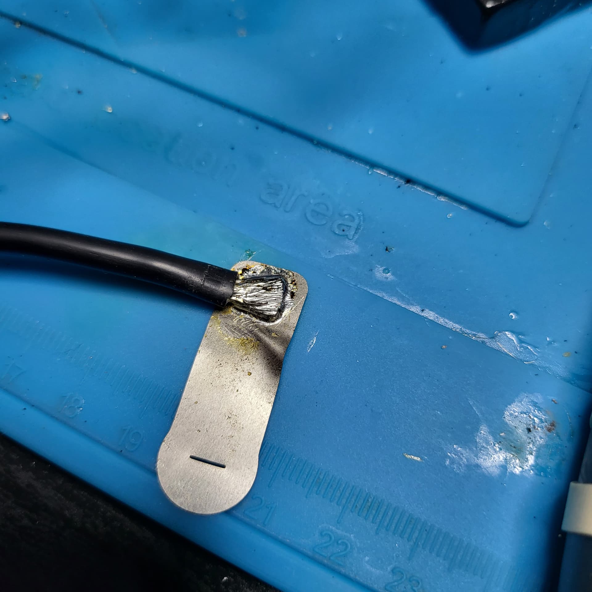

Thx, longer wire helps. I’m still ending up with too much solder in the wire. I better order some more 12 awg wire😬. I’ll get it right sooner or later.
Did this today. It gets easier over time. The key is to not let the solder seep into the cable I think.
Dont let perfect be the enemy of good, if it has good flexibility left and it sits nice enough call it good. My goal is vibration resistance and solid solder joints so that pack flex doesn’t break the welds on the nickel - i try to make the copper wire as long as i can then give the pack a little flex to see if the nickel gets moved/deformed. GL
i find repetition with improving my workmanship in mind a better teacher than trying for singular perfect execution. Ymmv
That’s niiice…i’ll get my shyyt together sooner or later😁
Not enough solder now. It’s getting better, Looks like it’s gonna be a long night for me.
That looks quite good already. Except for top right they look like they have good bonds, just no excess puddle around.
As hot as it will go, just max the dial.
Another good trick is to get a pair of hemostats or similar (needle-nose pliers with a rubber band on the handle will work in a pinch), and pinch the wire just above the end. That will suck some heat out of the wire and help prevent heat (and thus solder) wicking up the wire past it.

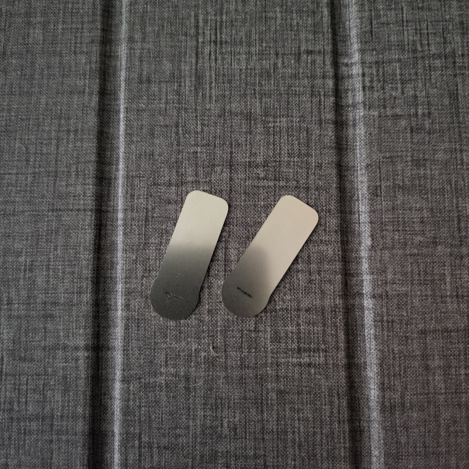

Cool, no way I’m using my extra pre-cut strip I got from you.:grin: I have some 1p strips… would these work?
Good enough to practice on for sure
