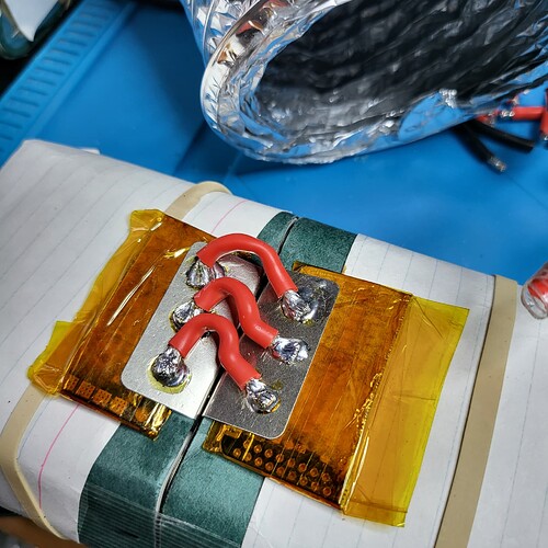

I’m having such a hard time with series connection wires…they suck big time and the wires are stiff AF. Watched all of the solder videos @ShutterShock and @PixelatedPolyeurthan whiched helped a lot but I just can’t seem to get it right. This pic is after 5 attempts. Frustrated AF.
3 and 4 group done…wires are stiff. I better stop now until I can get this figured out huh?
I feel your pain, im not great at soldering but here are a few things i do that might help.
First put your pre soldered spots on the nickel as far apart as possible. make sure you use put down enough solder for the connection, a nice big puddle. Then precut as long of a wire as you can fit for the connections.
Use paste flux on the wire and mash it into the strands and massage it in a bit and wipe all the excess off and kinda shape the strands into a slight fan shape. now pre tin them with as high of a heat as you can for as short of a time as you can. you want to just wet it to grab all the strands and no more. as soon as it wicks up the solder stop and let it cool. you can check to see how far the solder has wicked once its cool and if it did something weird or pulled it in too far you scrap that one and do another. you can pre tin all your cables at once like an assembly line once you get one to do it right - figure out how much flux and how much solder to add before you cut and setup all of them. if you pay attention to how much solder you add to the wire you can gauge if it is too much or just right.
then when you go to do the connection, melt the puddle on the nickel and let that heat up the wire. as soon as it wets out stop heating it. let the wire cool before you do the other side. good luck!
How hot should the iron be. Currently I’m at 371 •c
I have a 75w hakko with a fat chisel tip set to 450c… I don’t think I’ve ever turned it down from max lol.
I have a Hakko FX-888D. Im changing to this tip and give it a go.
Make your life easier, cut the wire jumpers longer
Awwh ok…12s8p p42a 2x 12awg wire would be enough huh? I don’t think I’ll ever pull 200+ amps. If so do I have to wick up the extra solder pools?
