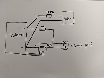

Built a few packs but still not clear what the loop key xt90 is used for? I see it being used in tons of builds, and tons of builds where it isn’t used.
My 18s pack is wired up like this except for the ‘150a’ part that goes into the ESC. The Stormcore takes the XT90S straight from the battery, with a blade car fuse on positive for charging
7aee827197f10177f82af4ca8932b31dcd5a8b99_2_333x250
Loop keys are for builds without antisparks. Your stormcore has one built in. For builds without they allow you to turn the board on by precharging the caps (via the resistor in the xt90s) without a sparky

Loop keys are also used on boards with antisparks as an externally accessible circuit breaker. With the current state of our ESCs, i’d recommend every build have a loop key.

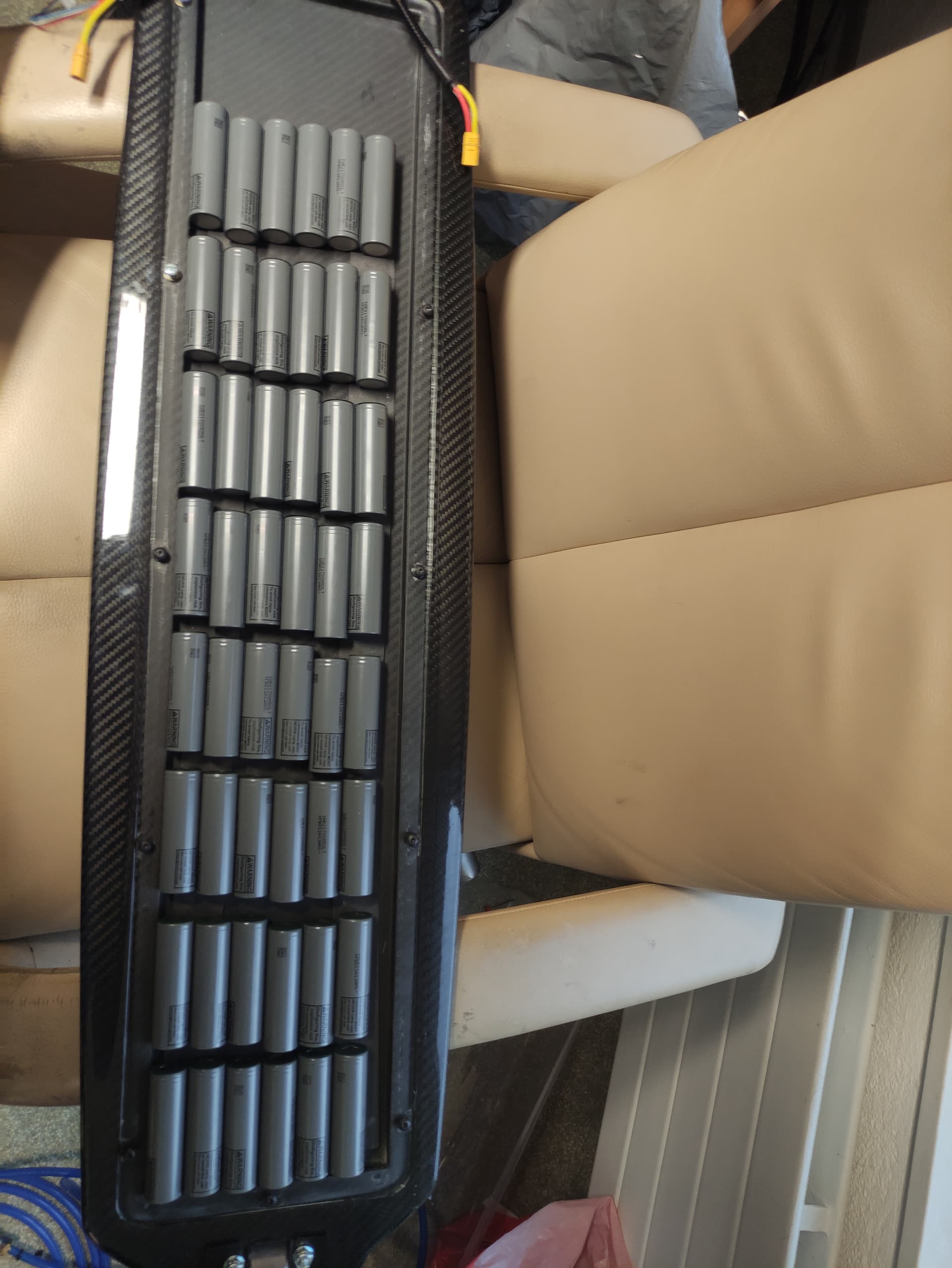

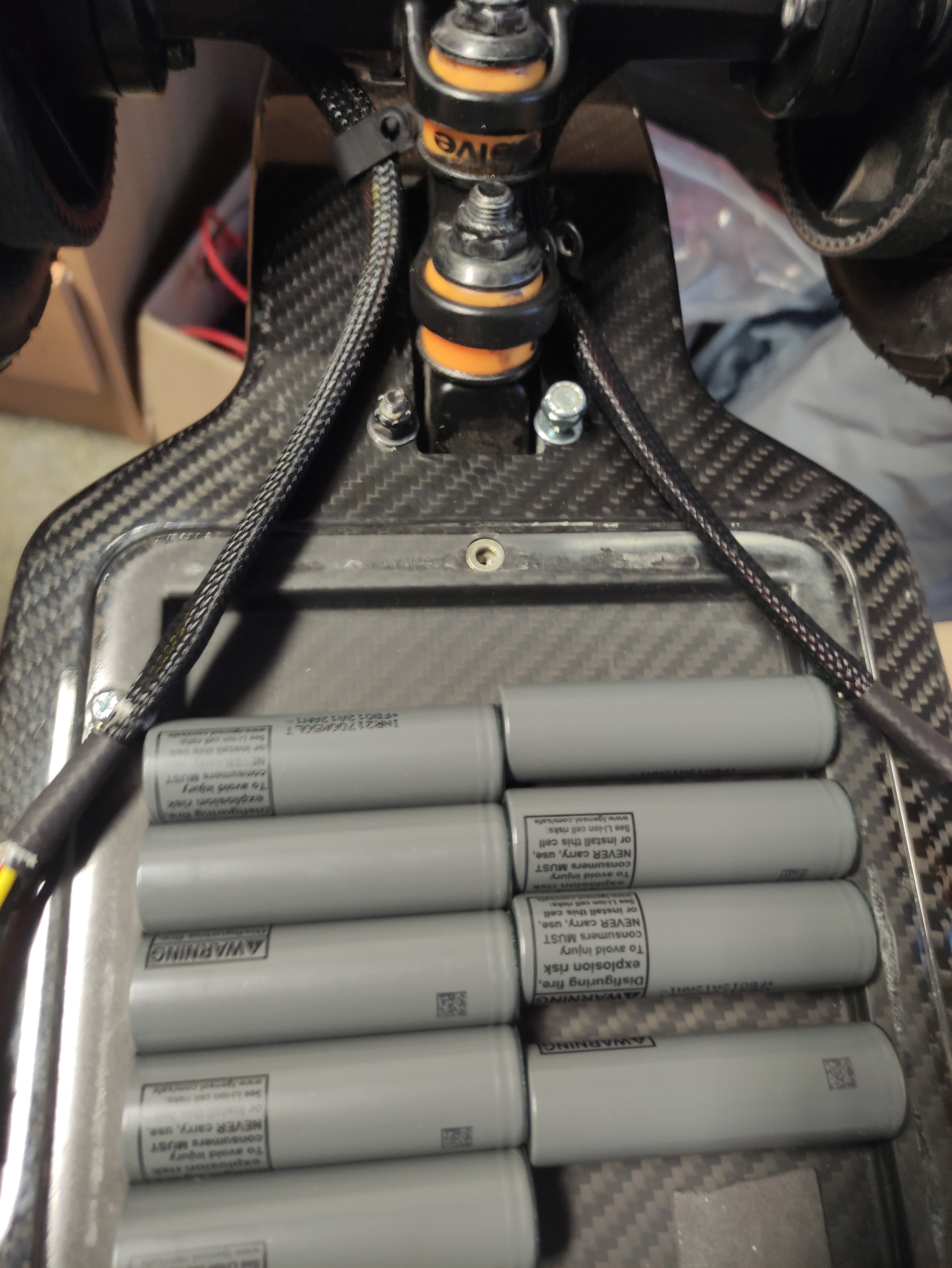

Hi guys I have a Evolve Carbon 1 generation which I want to rebuild with 21700s.
I was thinking of this Layout (12s4p) but 6 cells is not optimal for connecting.
Any ideas to improve?
The other way of cells is too tight but i could theoretically fiit more cells.
I would do 16s3p in this layout.

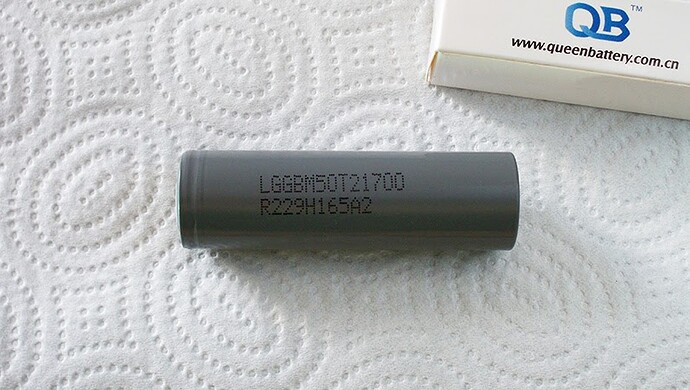

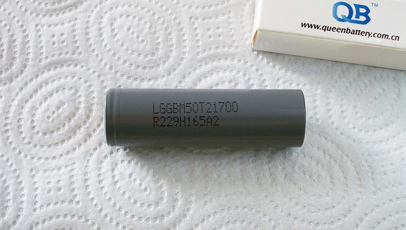

However, those LG M50LT cells are not going to make a very good pack. They are an energy cell, not a power cell, and will sag pretty bad at even 10A/cell. That means a 16s3p will be limited to about 30A discharge with sever voltage sag if you exceed that. Since you would likely be over-stressing them, they will not run efficiently enough for their high capacity to matter.
You would get a much more enjoyable pack (with likely higher range) if you use a power cell like the P42A.

Are they connected in parallel?
Yeah
The owner wants 12s he is also using the small original motors. I will have to make this work with those LG50s. The price to ratio was good.
They have still 4600mAh with 15 Amp discharge (I know not recommended)
