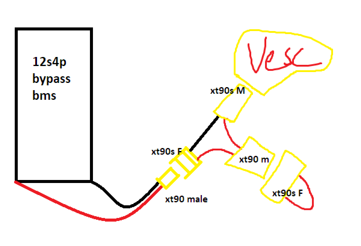

Is this safe? wary of 50v direct connect over the loopkey. or if I do this will I fry my vescs
All good, that’s a standard setup.

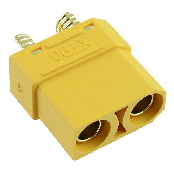

The female xt90 should be on the battery
Based on the way yo’ve drawn those XT90s, what you think is male is supposed to go on it.
To clarify, THIS ONE
Is the direct battery output.
Whys that? Antispark on battery side? Prevent loopkey insertion into battery?
Prevents screwdriver insertion into battery.

Tbf you don’t need an antispark on the battery if you are using a loop key.
Female goes on battery side because male connectors pose a short hazard

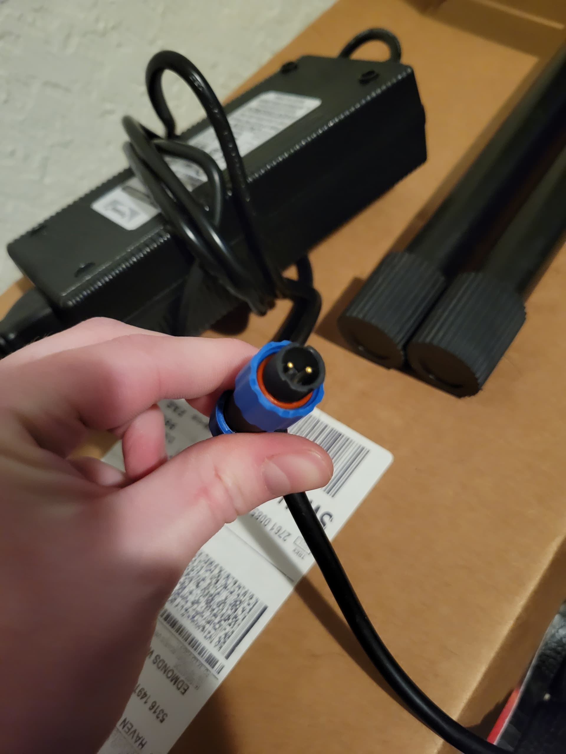

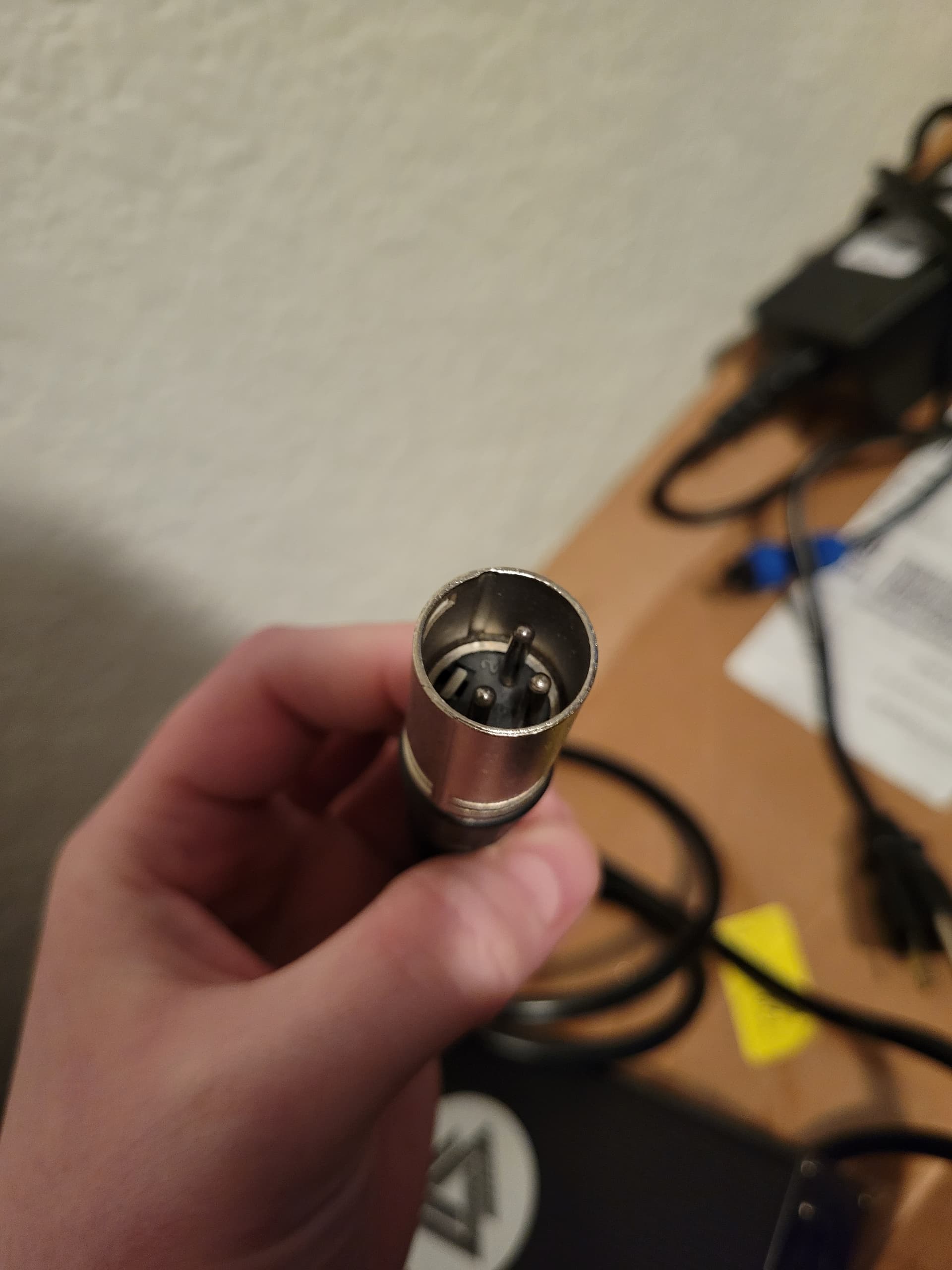

I have this chibattery 10a charger with what I think is an XLR(?) plug. I’d love to switch the plug to work with my existing charge port and match my 4a charger (2nd pic)
Is this easily doable? What’s the name of the plug on the 2nd pic? Can that connection handle a 10a charge?

That looks like an SP13, and they’re rated for 13A IIRC.
Pretty easy, you pretty much chop off the old connector, determine the polarity and pinout of the charger cable and connector respectively, and then solder it together accordingly.

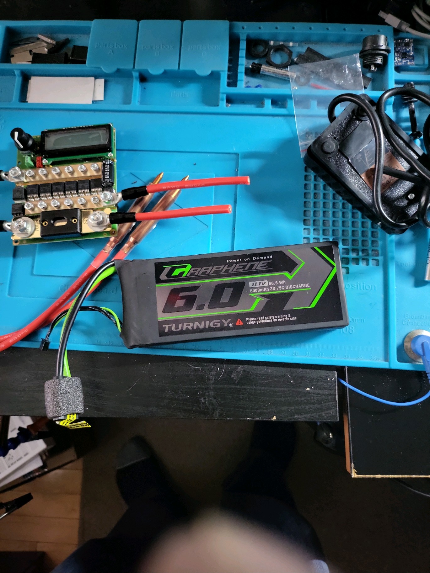

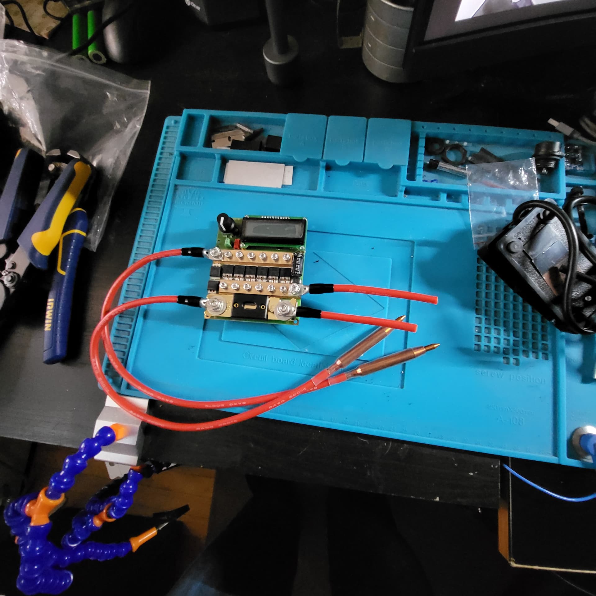

So do I solder an xt90 on the input cables. Will solder be good enough?
Either that, or you change your lipo to AS150s. It’s a bit of a bitch to get 8awg wire into XT90s cleanly w good joints. Those wires soak up a bunch of heat. If u have trouble, dm me and I’ll show u how I went about it.

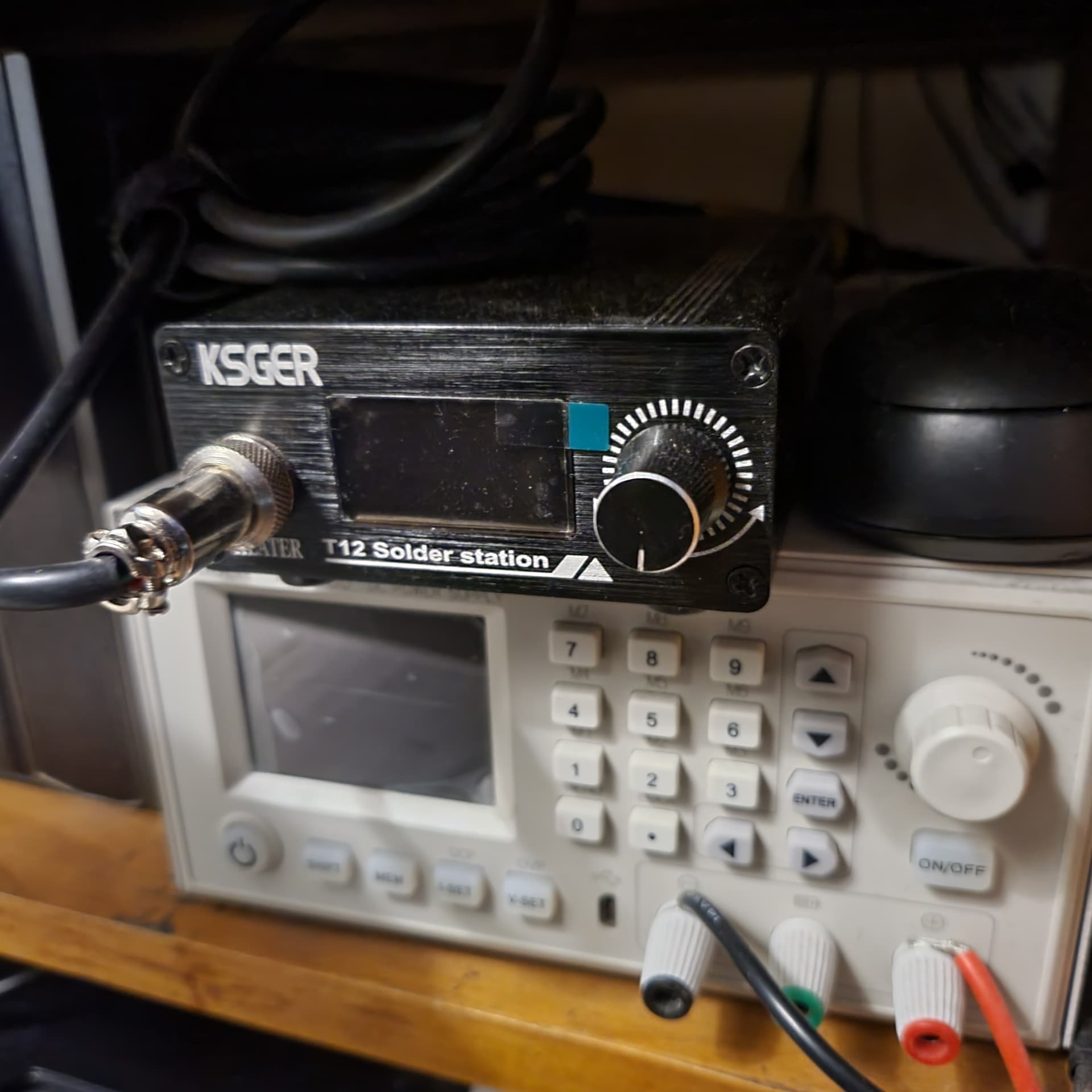

What soldering station do u have?
Edit- also, print or buy a case for the Kweld. Much safer to operate
Thx, Printing the case now it should be done sometime tonight.
That’s what I did and it’s a royal pain, don’t even attempt it unless you have a 100W soldering iron or better with a chisel tip or you’ll just melt the XT90
